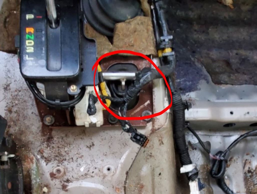

For interior my plan is pretty straightforward:
  1. Seal up the three rusty holes
  2. Clean the floor and apply butyl based sound deadener. Especially the transmission hump and rear wheel humps
  3. Install closed cell foam to help with road noise
  4. Get the original carpet and panels back in
  5. Refinish the seats with the crack filler and dye and conditioner
  6. Maybe
    1. Refinish steering wheel
    2. Swap out the leather shifter with the wooden one
    3. Pull door cards and add insulation to the door skin
Exterior is probably a little more involved and I am still thinking about it
Still waiting for the two body shops to get me an estimate on the fixes. Waiting is so hard!

As for the development on my truck, I have now ruled out exhaust leaks and missing heat shields. Which means to protect the passenger side floor from outside heat, I will just need to lay down some insulation on the inside.

Also, I really want to cover up the transmission hump. It is woefully devoid of padding and lets a lot of heat and noise inside.
Is any of the heat coming from the exhaust, do you think? I was debating some exhaust wrap near the fuel lines recently to help the gurgling at the fuel door and over-heating of the fuel lines. Wonder if it may be of some benefit to you here.
Also, I wonder if you're missing an insulation pad on the transmission tunnel. For some reason, I remember having something there on mine but I can't recall for sure. Regardless, yeah I think getting something on there will be a big help. Mine has a drink heater built into the cup holders that I wouldn't mind getting rid of...

That tranny hump looks pretty normal/OEM to me
