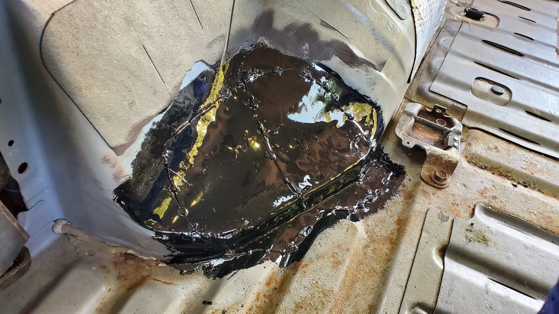

All rust holes are patched up. Time to get cracking on sound insulation and putting it back together.

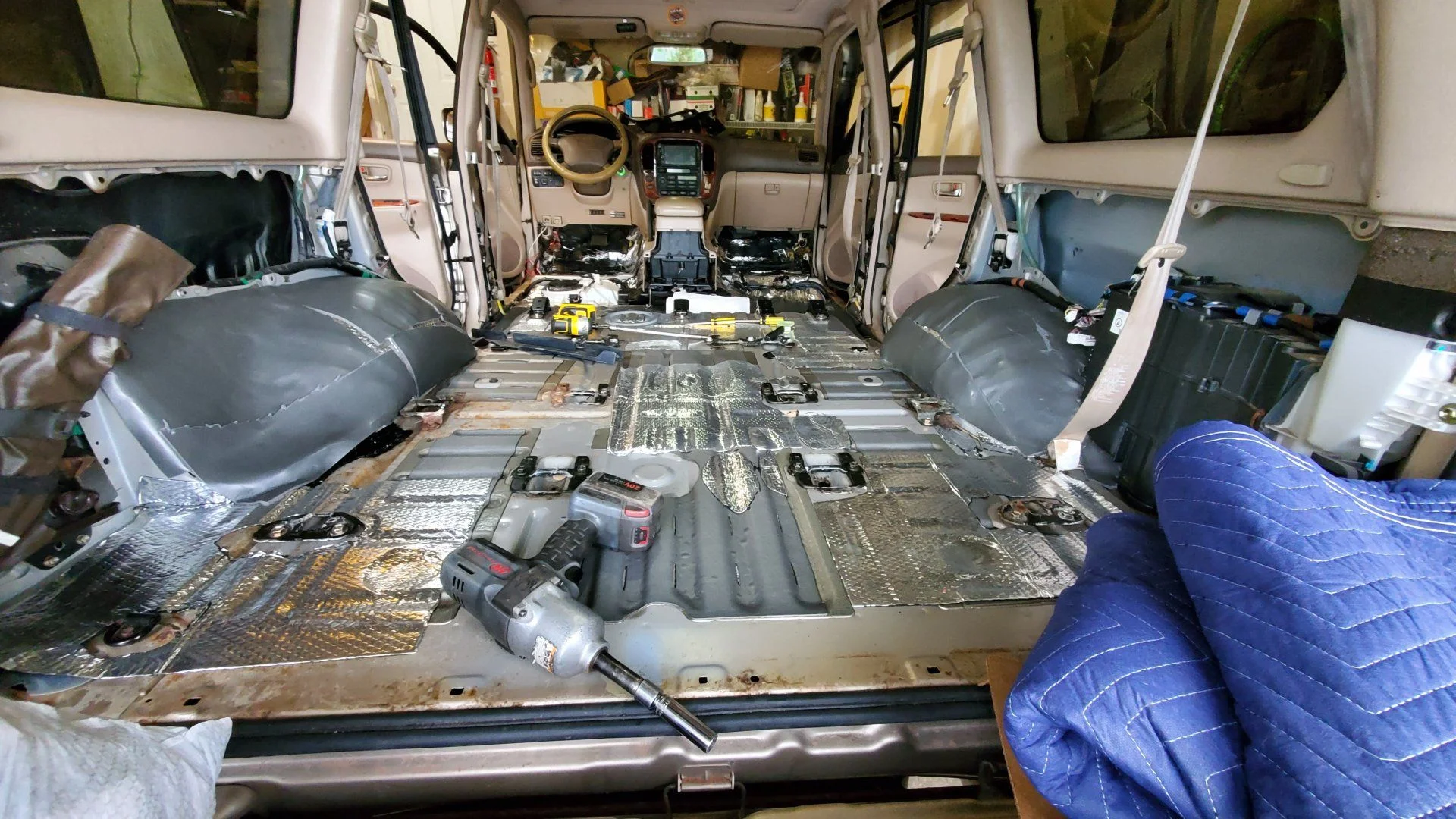

Whole interior insulation is a ton of hard work!
Had it all buttoned up and went on a short road trip with the kids. My 8 year found out that most of the road noise is coming from driver side rear quarter panel. He even said he can hear the water flowing (it was raining outside). So I pulled the rear quarter panel interior panel and realized that since I have taken the off the factory subwoofer box, the speaker grill is just not letting in all the noise!

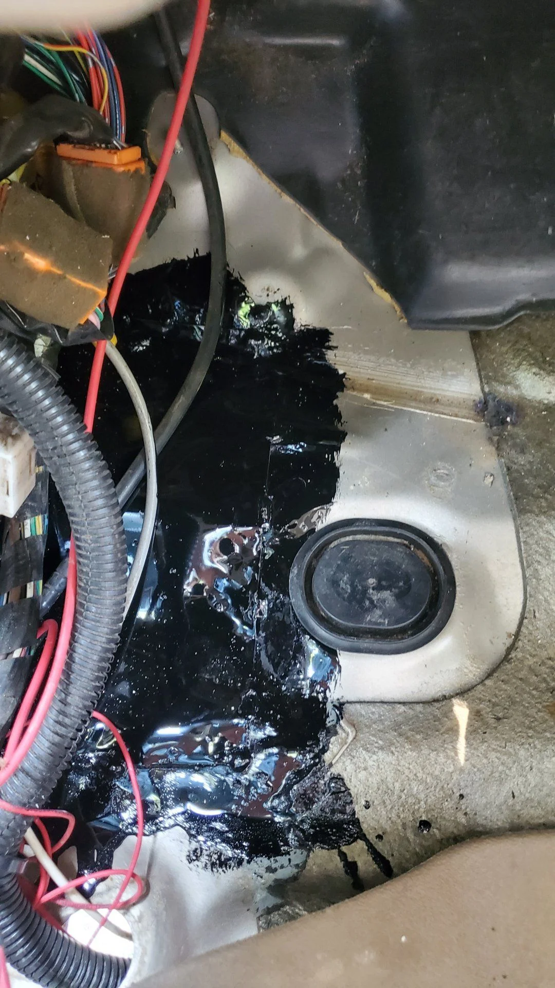

So I thought no big deal I can just seal that up but then I noticed water around the interior panel o_O'

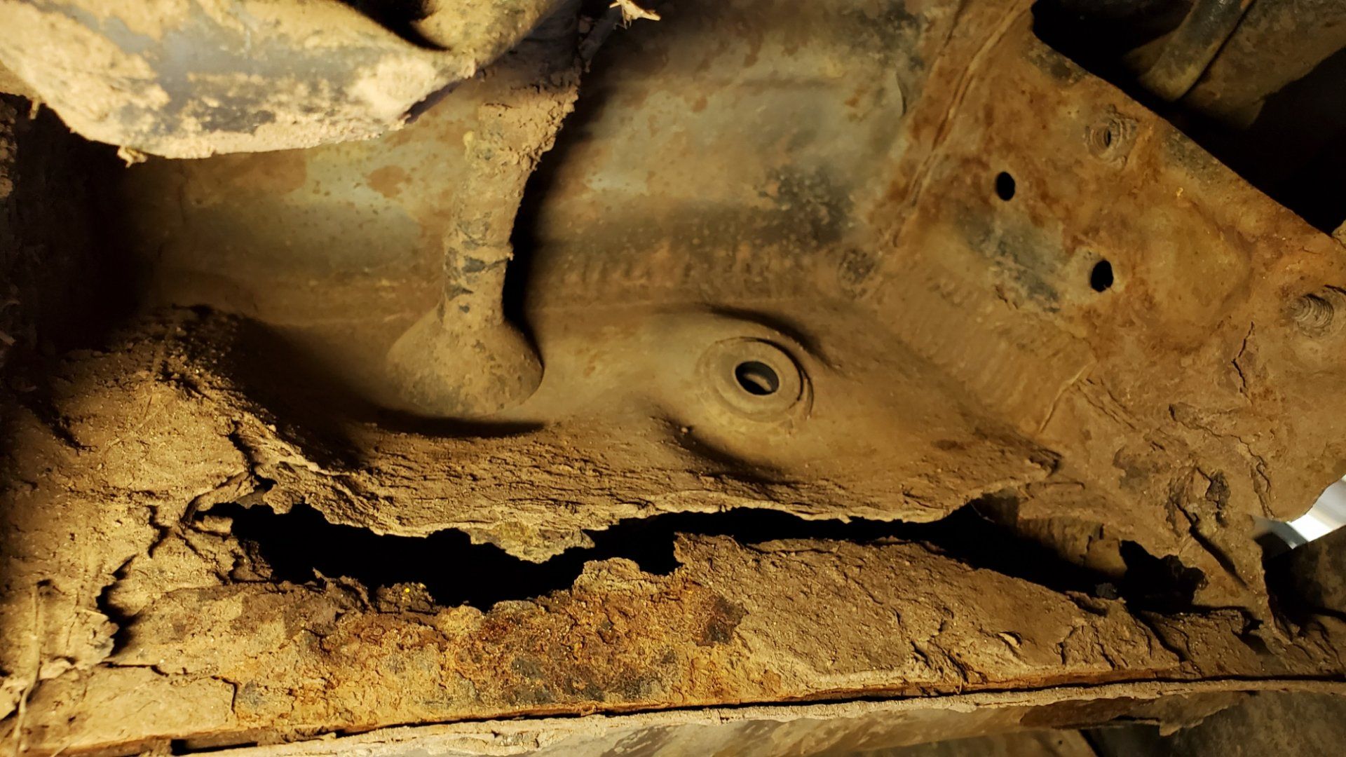

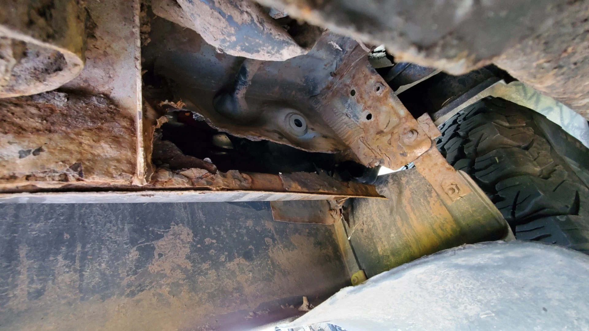

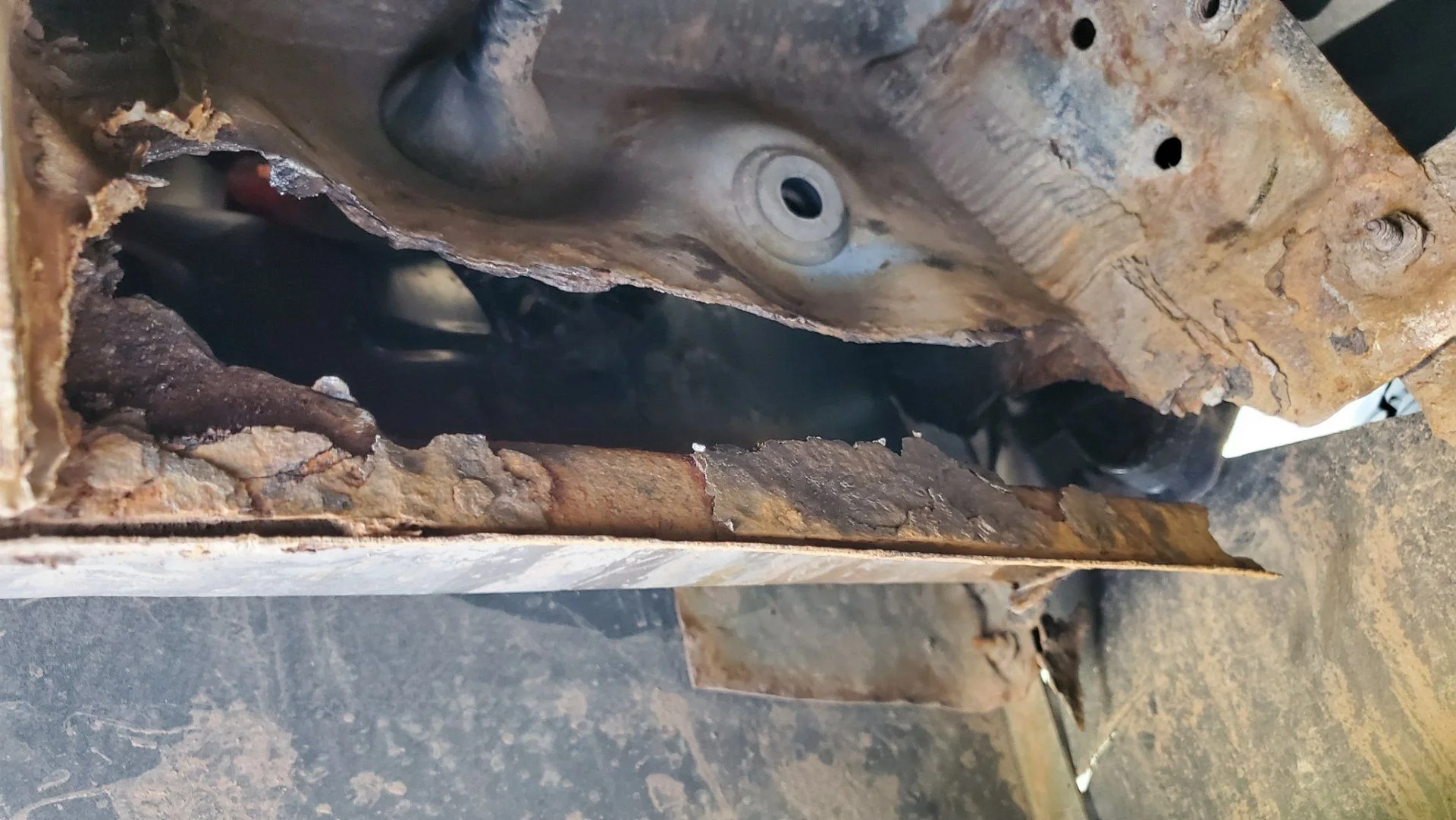

Crawled under the truck to see where it's coming from and found this gem!
A little wire wheel action and now we have proper large opening!
Jesus Christ man. I would say that is well above average rust even for the upper Midwest. Seems like you got a good grasp on rust repair at this point And I’m sure you’ll get this taken care of.

Showed it to a couple of body shops and everyone is basically recommending replacing the rear quarter panels at this point. Assuming I can even find new quarter panels the labor and other consumables and paint is going to be expensive.
I am starting to look into more creative ideas of taking care of these rusty areas in the rear quarter panels. Here are two that I have had suggested to me, both seems equally awful. Basic idea is to use a wire wheel to take as much rust off as I can and then douse it with Rust Reformer to stop further spread. And then
1) Either cut out some sheet metal and JB Weld it on,
2) Or, seal the open section with FlexSeal tape and fill it with expanding foam.
The offending areas are hidden behind the bumper so they don't have to look pretty.
I'd find a local welder to cut as much of that out of there and tack in some fill plates. They wouldn't need to be perfect. Then use a heavy dose of body sealer on the edges and prime and paint with something very durable.
Or cut everything out yourself, buy some sheet metal and a tin snips and make your own patches, prep the area and bring to welder to tack in.
A gas capable 120V welder, an angle grinder/discs, an auto dark helmet/gloves, wire/gas, and a trip to metal supermarket wire will get you a long way for $800 or so? Hobart Handler 140 is nice solid welder. I like Lincoln 4C helmets, enerfil 030 wire and 75/25 gas.
I vote for that, or moving.
