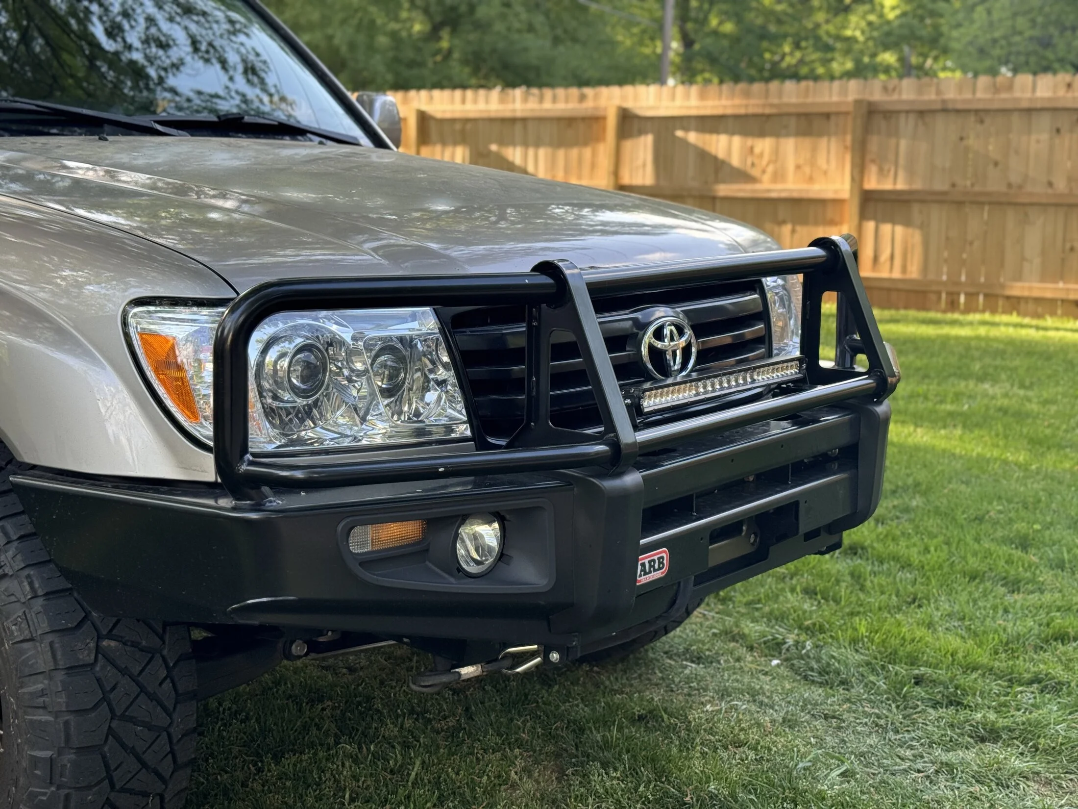

I run MLED 2.0's in mine, with their high beam projector on the inner sections like factory.

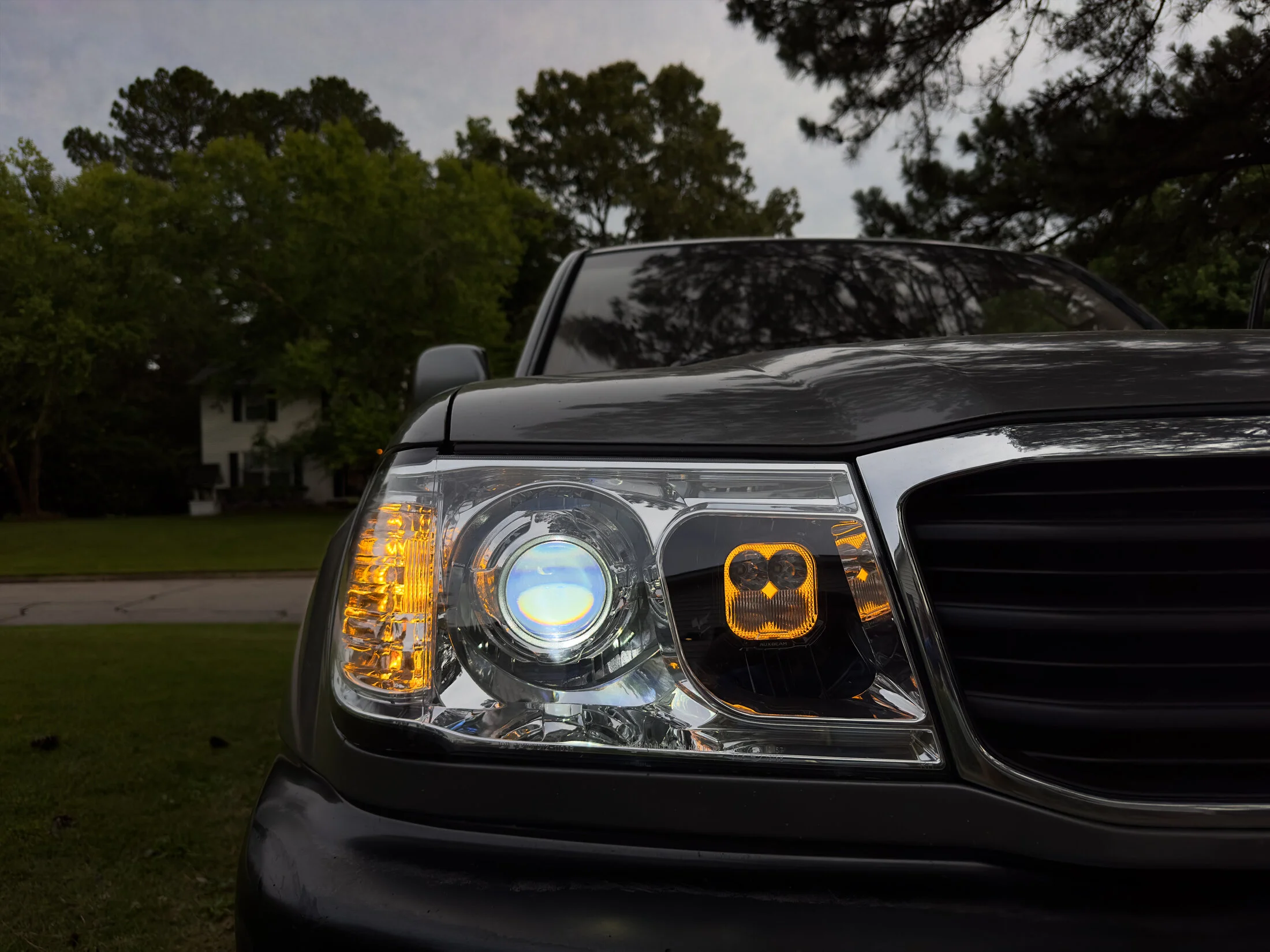

I went with 3” Auxbeam cubes in mine that have a DRL/Amber backlight function, ended up matching the amber to my side marker lights and Diode Dynamics ditch backlight.
