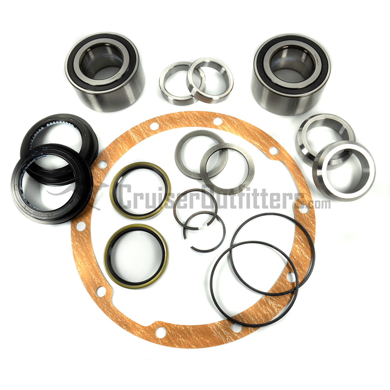

Rear bearings are sealed and they are a fair bit of effort to get to. We are seeing more and more of them needing replacement now that 100/470's are really climbing up there in miles and the way they are used.
We've put together a comprehensive kit that comes with all the necessary items to full overhaul:
(Part# RAK100SF - We'll have the missing parts to build a handful more kits in stock tomorrow or Monday)
