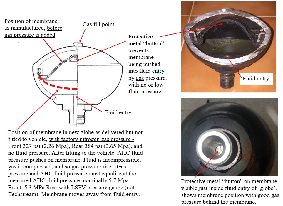

Or was it the 'globes' (formally called 'Gas Chambers') which actually were changed out?? These definitely are 'wear-and-tear' items, replacement is a much more common job and it would be unsurprising if required approximately every 10 years (sometimes longer, sometimes shorter) -- because the internal membrane eventually does deteriorate and the nitrogen pressure is lost.
Whatever the situation, there is now a LOT of air in the AHC system. This will require a major bleeding effort all around the vehicle via the bleed screws at each of the four Damping Force Control Actuators (to which the 'globes' are attached) as well as the bleed screw at the cylindrical Height Control Accumulator midway along the LHS chassis rail. It is likely that this effort will necessitate two, possibly more, 2.5 litre cans of AHC Fluid Part Number 08886-01805 -- don't let anyone use substitute fluids and especially not brake fluid which can destroy seals in the AHC system.
