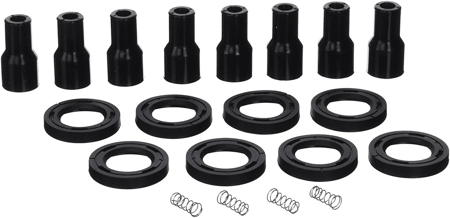

On a side note: Denso P/N 671-8184 provides the ignition coil boot set. These are now made in China and not Japan.
@2001LC I bought them off amazon. At the time no local parts place had them in stock.

@AlpineAccess do you have a part number for those NGK boots?
@bamabrock that was my review on amazon!

Try this
Brand:NGK
Part Number:59009
UPC:087295590096
I didn't see any country of origin information on it until I received them in boxes.
I put mine on without any issues. Quality looks good. I bought mine through advance auto because they always have a discount code going online and I had some speed perks points to use. About $20 to do 6 as I have two newer coil packs.

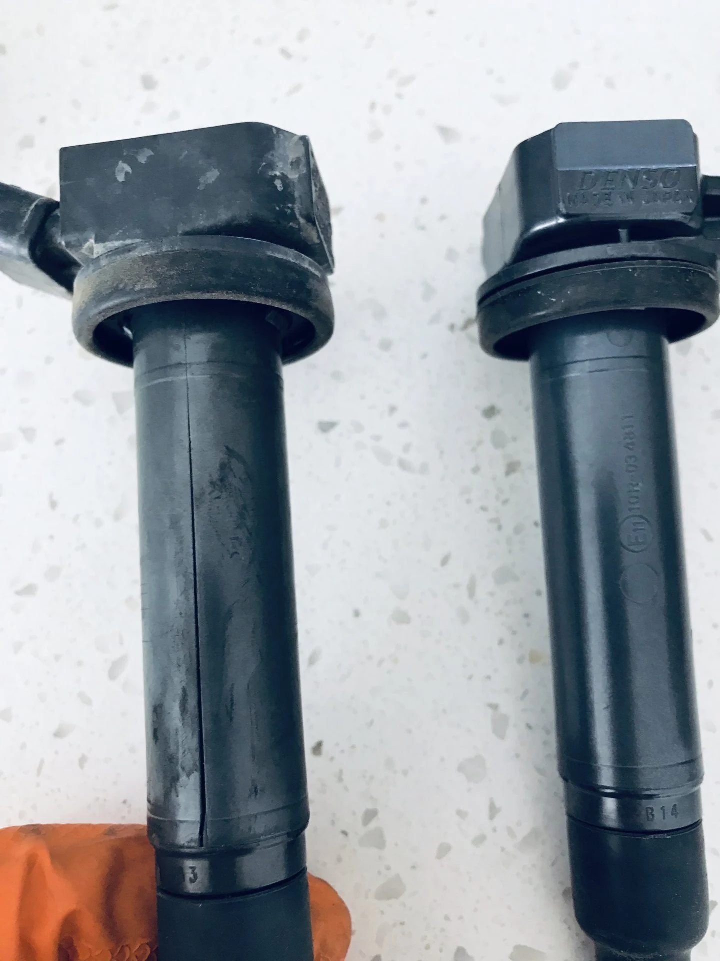

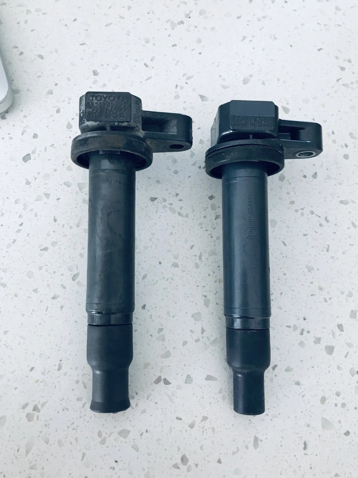

Adding to the data...
MY: 2000
Miles: 239k
Coils: Original as far as I can tell. Toyota part numbers on them
Plugs: Denso Iridium SK2011. ~50k on them.
Symptoms: None really. "D" vibration. PM prior to Alaska trip this winter.
Replaced with Denso coils as seen earlier in the thread and Denso Iridium TT spark plugs.
All 8 of my coil packs were cracked. Spark plugs all looked the same - dark/burnt looking threads and point, smelled of gas, except one had a brown ring on the white shaft. All had dried out dielectric grease on the plugs/coil pack insides.
Brief test drive: "D" vibration seems to have disappeared. I guess it has more spunk... slightly quicker response. Will see about any MPG changes.
I have checked mine one as a slight crack on it, but no codes and car runs fine so in time I guess will go out.
