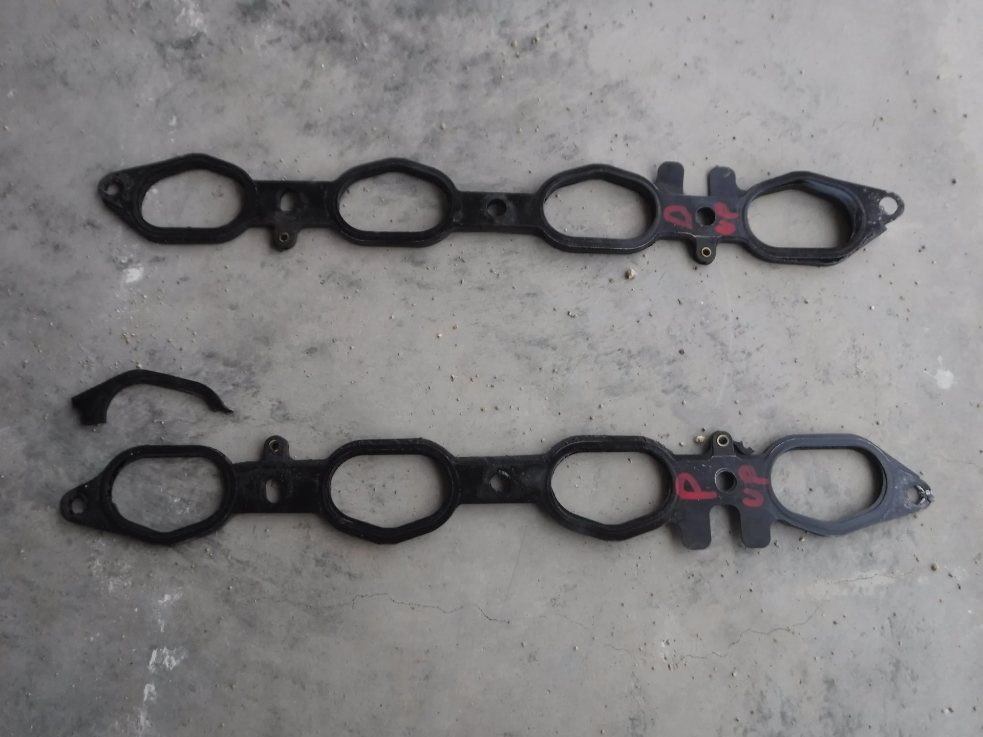

has the starter been replaced? I had a rig where the intake gaskets failed, they were aftermarket, well after a starter swap.
found it by using starter fluid lightly around intake
