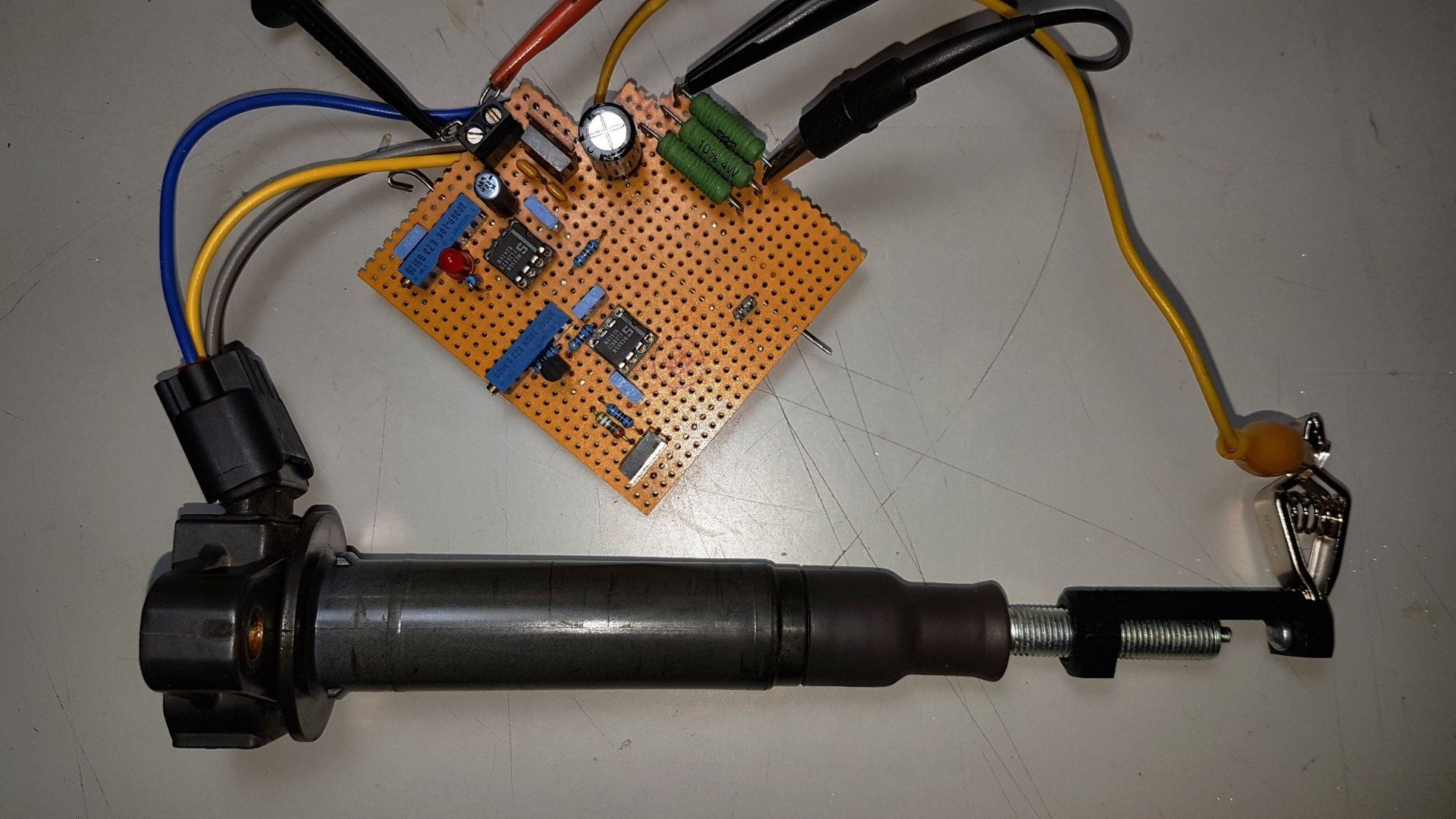

Ever since OP started this thread, I have been thinking about building a coil tester. But not having access to a 'bad coil' makes it difficult to set the criteria for a good/bad coil. Well finally it happened, I had to replace a coil. No more excuses not to build a tester.
Here is what I came up with:
It is a very simple circuit that pulses the coils as normally the ECM would. To test the output of the coil, I'm using a Lisle ignition tester that can be set to a wide variety of gaps. The connector + wiring came from Ebay in a 6-pack.
Here are my first observations of the marginally failed coil at 214kmiles / 17 year (from a 3UZ-FE with slightly higher compression ratio, but it shouldn't really matter too much).
The failed coil pulses fine at 10 Hz (1200 rpm) up to around 7.7mm gap. If I set the gap any wider the pulsing becomes erratic / unstable. Per FSM, the max spark plug gap is 1.3mm. But under compression the actual gap that can be bridged is smaller because of the higher pressures inside the cylinder. So for the coil work in an engine, it needs to be able to arc across at least 7.7mm at 10 Hz on the test bench. At 12mm gap, I can hear this coil short internally and there is no arc visible.
I verified another working original coil with 214kmiles from the same engine and it has no problem firing at 12mm. I will try to do some more testing to see how much more I can increase the gap before it starts failing (edit: coil arcing fine at 20mm as well). Ultimately, I also want to test a brand new OEM coil. Maybe even compare it to a Denso, to see if those are less powerful than OEM Toyota.
Other things to test are effect of pulse rate, temperature, etc etc. The list goes on.
Assuming the deterioration is gradual, this could be a simple test during a tune-up as PM.
A good coil at 12mm, 10 Hz (camera does not capture all sparks, note the consistent sound):
The failed coil at 7.7mm, 10 Hz (note the inconsistent sound):

PM sent. It would be very interesting to look at your coils. This will help establish proper criteria for a 'good' v.s. 'bad' coil.
Once we define what a good coil is, it would be rather easy to use a low-cost coil on plug tester (such as the Lisle 20700) to test coils in the vehicle. Just set the gap of the tester, insert in the coil and crank the engine (EFI fuse removed).

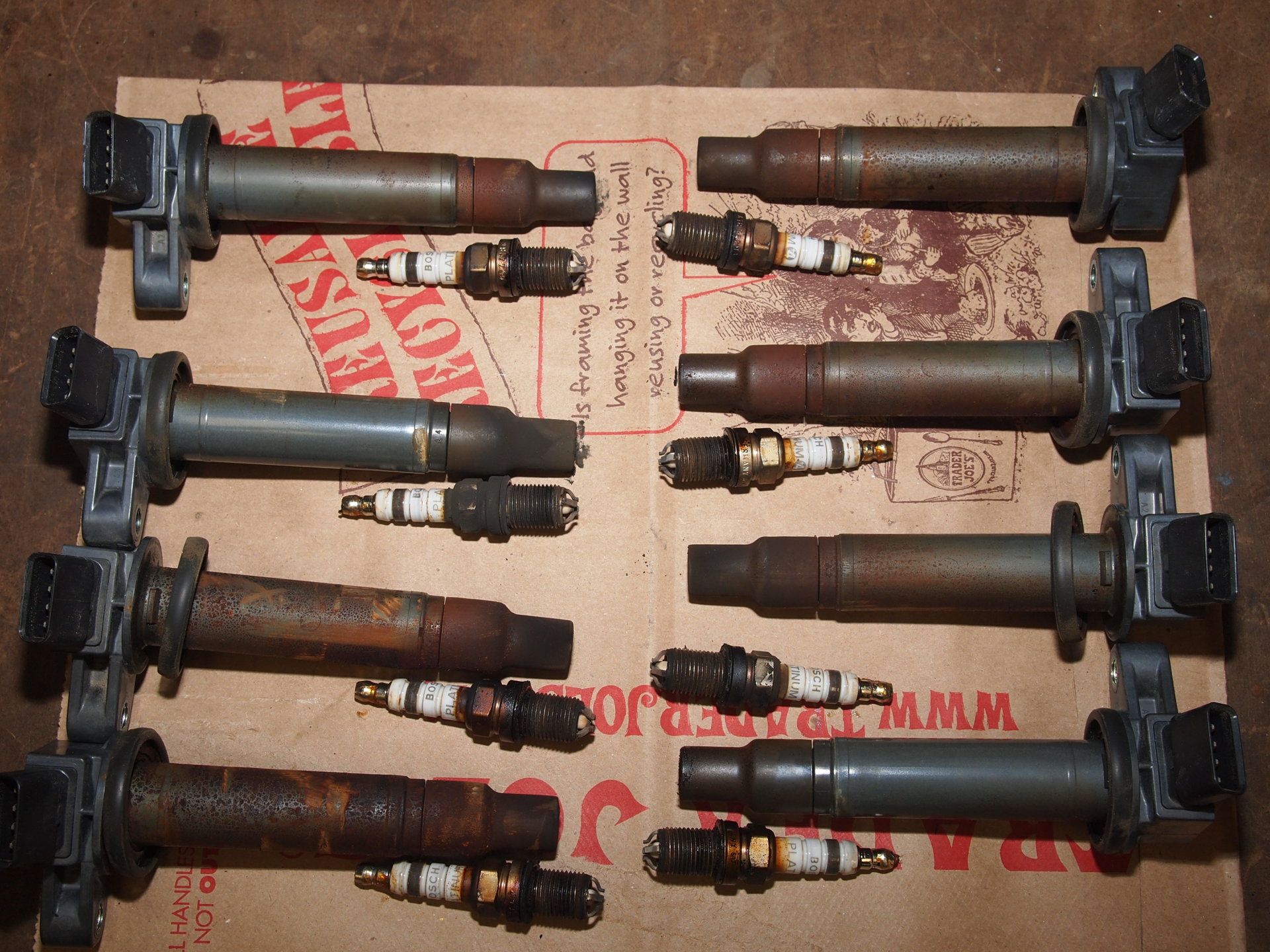

Whereas split coils may still operate and not show misfire. The split is sign of running excessively hot. Heat is the enemy of coils. Two main reason for excessive heat being created in coils IMHO is:
1) Gap of spark plug is out of spec (new is 1.1mm, at 1.3mm they must be replaced). The larger the gap the more current delivered from the coil. The more current produced by coil the hot it gets internally.
2) Spare plugs walking out. The hot gasses escape from combustion camber passed the spark plugs (SP) thread into the SP tube. This heat coils from outside. Additionally as plugs walk out (loosen) they seal (expand from heat) as engine reaches op temp. But once plugs become to loose it no longer seals. Then hot gasses escape even at op temp. As SP electrode (tip) moves further away form optimally firing point and enters thread area of head, the coil keeps delivery more power. This not only overheats coil. But it will blow the spark plug out of the head. A search in mud, will produce pictures/accounts of Spark Plugs blown out of the head.
Spark Plugs that have a brown halo are "typically" slightly loose SP, that expand and seal at OP TEMP. The boots of coils brown and harden.
Spark plugs and coils boots that are blackening, are those that "typically" are so loose they don't seal be expansion at OP TEMP.
#3 coil was the loosest. Notice the blackening of plug and coil boot. This one was very close to blowing out of the head.
Coils and spark plugs (junk Bosch platinum, I'd never use them) are in order. With #1 in upper LH corner and #2 in RH upper corner. The tube oil seal where not leaking:

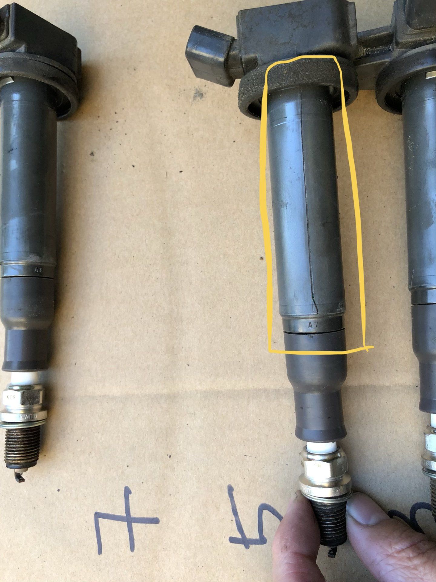

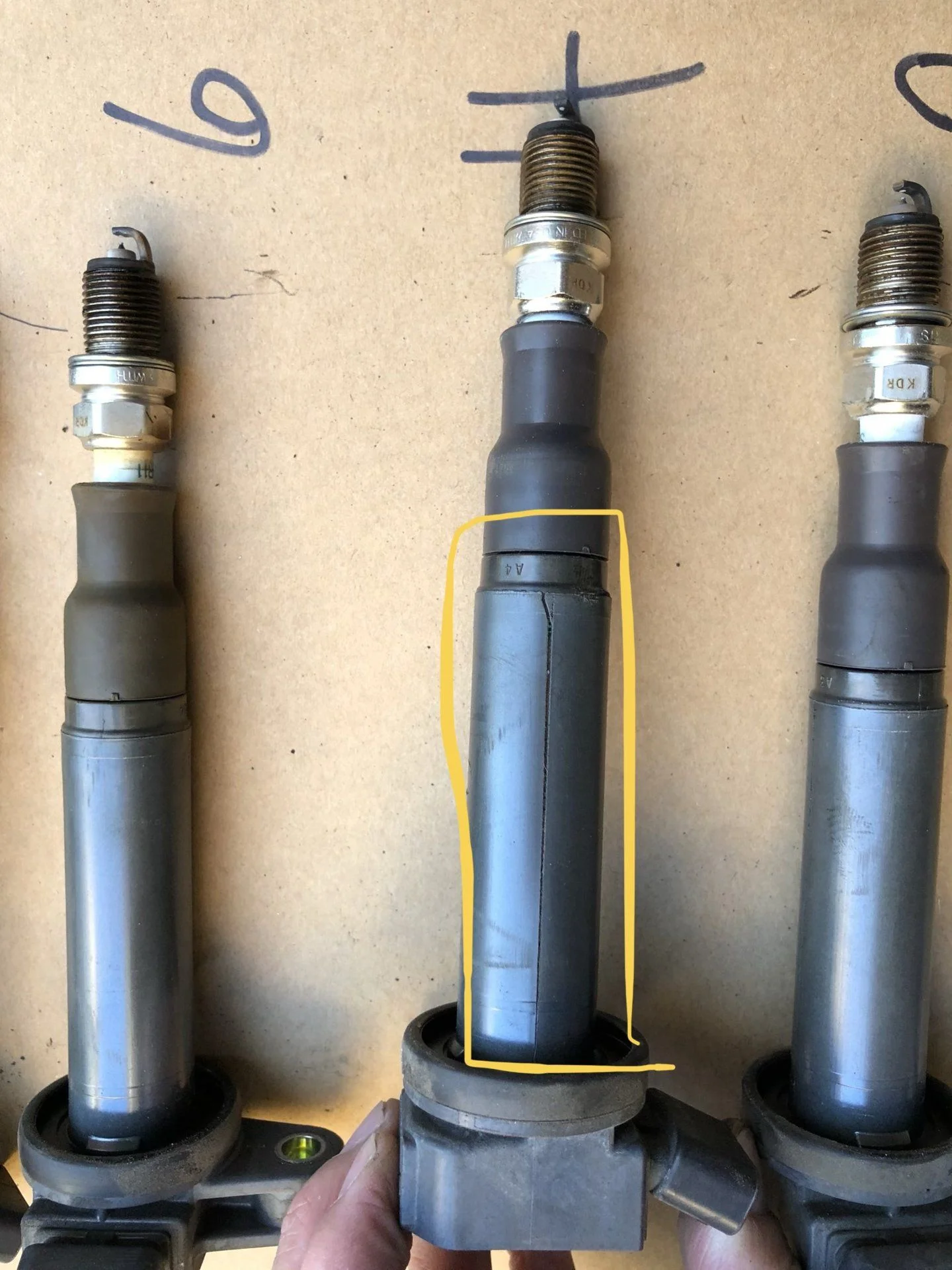

In the spirit of sharing!...Been in the other thread fixing my rough idle/RPM jumps/jerking and acceleration hesitations. I believe it was 2 cracked coils. Here's the stats:
Year: 2001 LC
Miles: 177,000
Previous Coils: Original Toyota (never replaced)
Previous Park Plugs: Denso SK20R11 replaced in 2014 @ 137k miles
Areas of Issues: #4 and #5 coils cracked
Symptoms: It all started one day...it didn't get progressively worse. In standing "D" or "R", it RPM was jumping up and down. "Park" seemed more stable. Starting to accelerate (pressing gas pedal), not always but sometimes, it was jerking/shuttering initially and smooth out at higher speed. So, I thought initially, it was only when idle. But then, when pushing the acceleration harder (going uphill), it would jerk/shutter little more like it was starving for gas or air.
Resolution to Fix: Replaced with 8 new Denso SK20R11 plugs and 8 new Denso coils. I figured if 2 is cracked now, its envitable that others might crack right behind it. Besides, I was going through a checklist and been spending days on this so I wanted to just end it for awhile and call it a PM for the next 150K miles if I need to justify it.

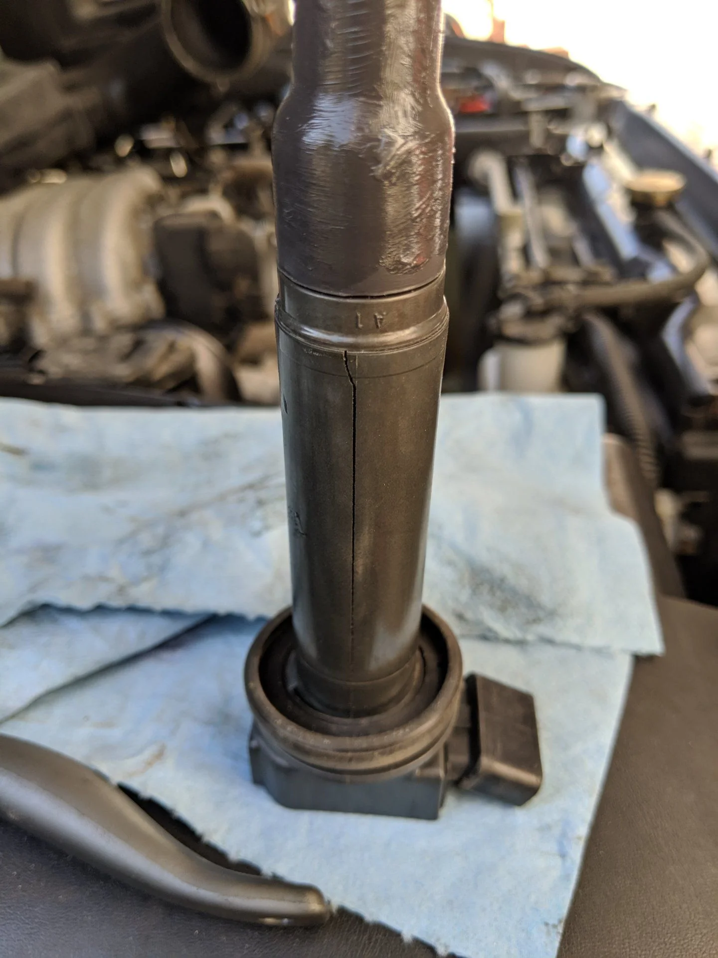

I noticed a cracked coil when I changed my spark plugs this weekend. I have not received any CEL and the truck seems to be running fine. Is everyone else replacing only based on symptoms? Is a cracked insulator cause for concern?
I would replace with Denso or Toyota (pricier Denso). You'll likely get misfire under load. I'd not grease the boots, may retain more heat.
