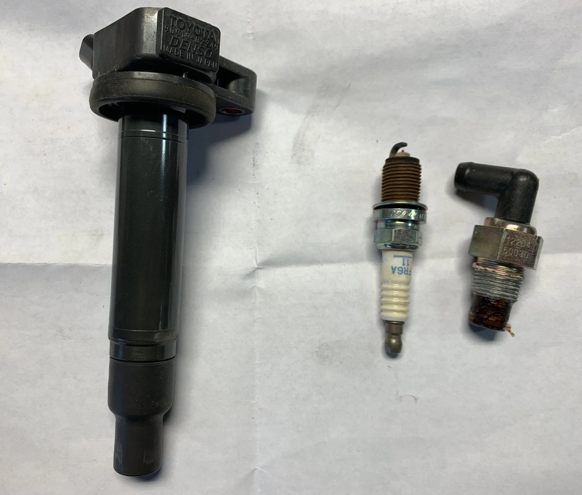

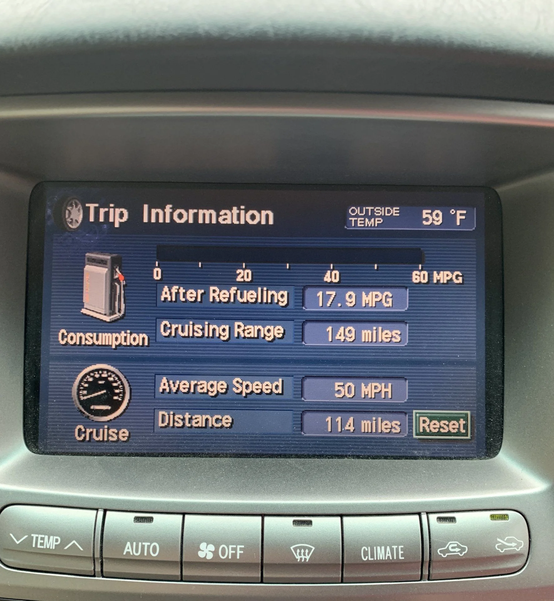

Finally got around to replacing the coils and plugs. Truck is a 2005 with 150,076 with no known issues. Idling at a stop light isn’t always super steady but not rough or bad sounding either. This was more of a PM replacement as I wasn’t sure on the age of the plugs. I’m assuming the plugs have been replaced at some point by the PO as they were NGK plugs. Truck seems to run a bit smoother but the Scanguage is showing similar numbers to before the replacement. The first tank of gas seems to be better though. I’ve been averaging around 16 to 16.5 for my everyday use and hit the half tank mark at 160 miles. First tank was at 175 miles at the halfway mark and I’m over 17.5 mpg. I’ll take whatever improvements I can get.
Want to add a bit more info.
All 8 plugs looked good and were between .042 and .043 inch gap. I know I could have reused them but for the price, I couldn’t see going through the hassle just to put in used plugs.
All 8 coil packs looked almost new. A little bit of brown up inside the boot but the boot was otherwise like new. No discoloration or cracks and they were just as pliable as the new ones. My dad and brother both have 4.7 powered Tundra’s with over 150k miles each so I’m sure they will get used at some point. Good to have spares.
@jlm43 what is that third item, on the right of the spark plug?

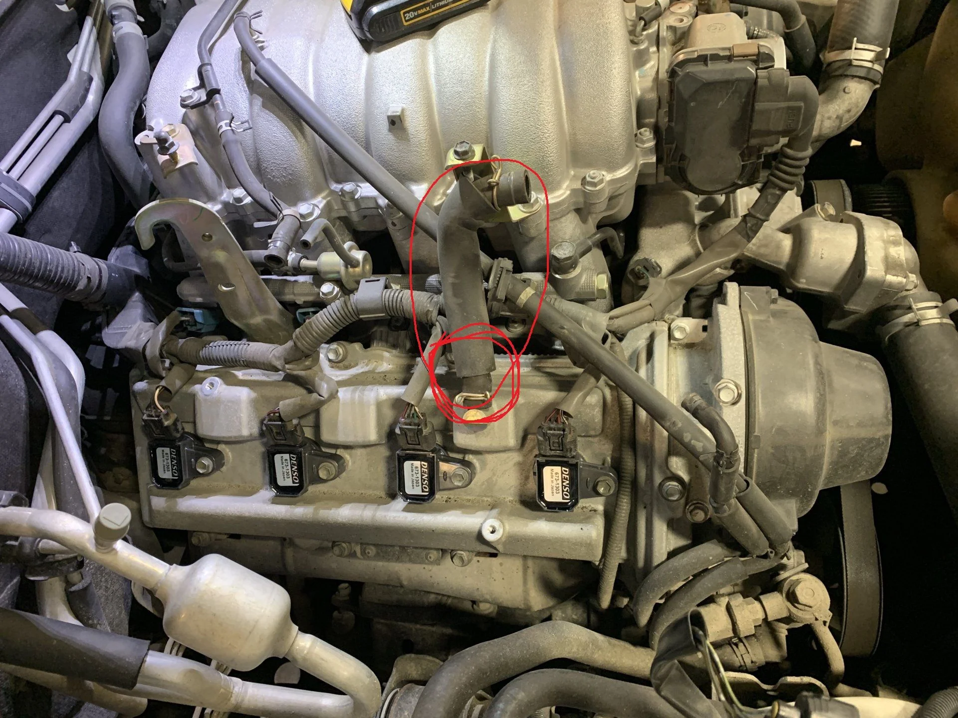

When I removed my air intake I noticed that the bottom end of the hose encircled in the picture below was cracked. What is this hose function?
RH PCV hose. Both RH & LH hoses seem to be first hoses to "crack" (dry out) and leak vacuum. These vacuum leaks cause problems in operation of engine and affect long term health of engine. I always replace if dry and cracked.
Thanks @2001LC now to get the part numbers and order them.
