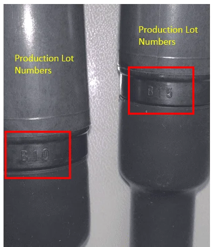

As promised I am posting some examples of Denso coils with the unique testing lot numbers and markings that I have found to be a consistent indicator of authenticity between Denso, Aisin, and Aisan (e.g. Toyota owned) parts.
Unfortunately, I do not have any counterfeit coils products to compare. I will need another member to chime in. However, I do have examples of OEM Aisan counterfeit injectors with these same type of lot number markings that I can post in a thread that is dedicated to identifying authentic vs. counterfeit parts.
Note that production control testing trace numbers can be found virtually all Toyota parts. This lets Toyota trace the part back to specific lots from a given OEM parts supplier.

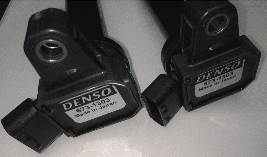

So here goes. Denso part number 673-1303 - Made in Japan.

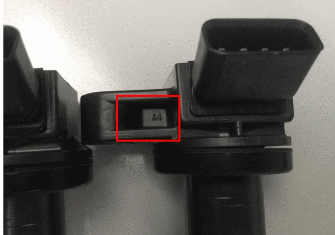

Unique (B10 and B15) production lot numbers on the coil boot.
Production lot numbers on the coil body.

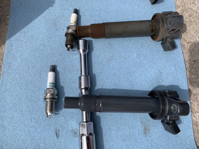

Interesting. Replacing my set during down time at home and I noticed my old coils (Toyota parts) had flared tips on the rubber gasket but the new ones from Jegs don’t. Anyone else notice that? Should I be concerned?
Just different style. Makes no difference flared boot or not..

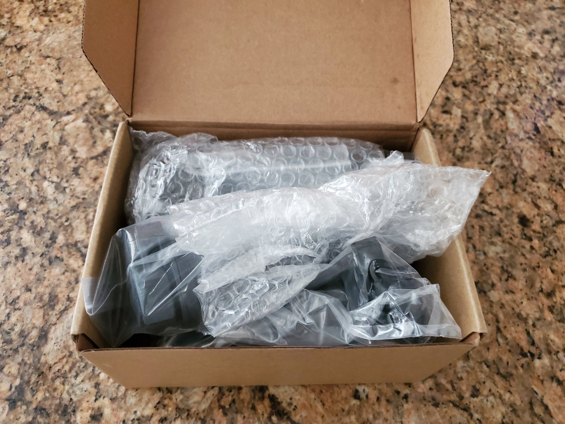

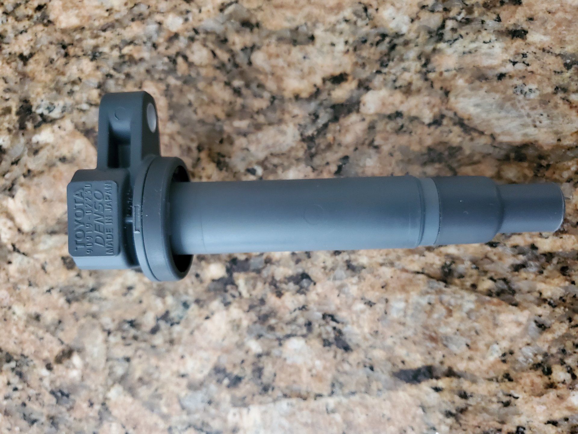

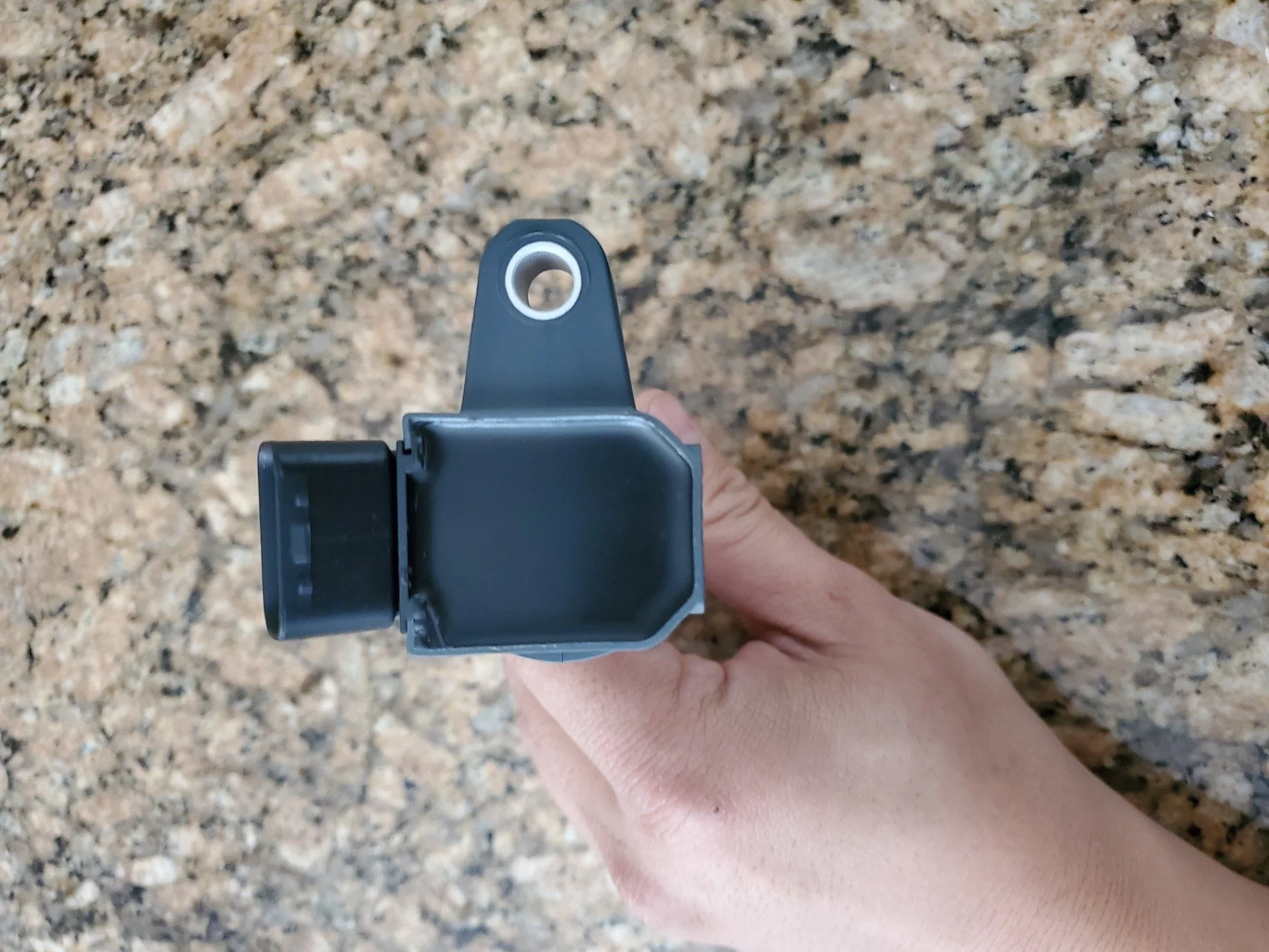

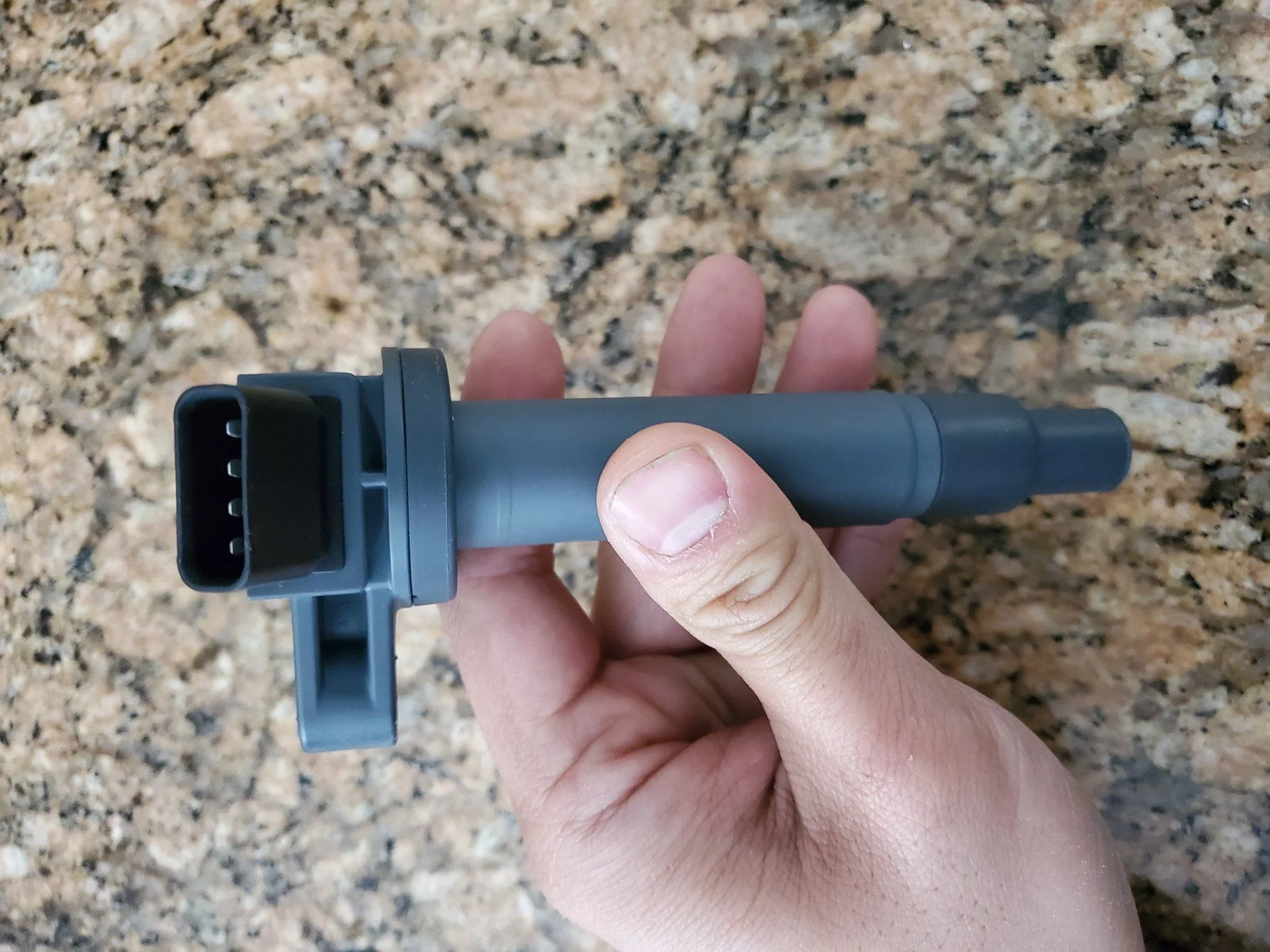

I just received a package of 8 'Genuine OEM' Denso coils from EBay. I was so excited. Only spent $135 on them, a US seller.
When I got was a box with individually bubble-wrapped coils. I inspected the coils - turned out to be very good counterfeits. The plastic did not feel right. It does not look like normal Denso quality. The plugs do not have the Denso part number sticker on top.
I asked for a refund. And the seller kept trying to get me to 'just install them, - it has the part number right on the coil, it was just a bulk package so it does not have a Denso blue box, etc.' I told him they were counterfeits - give me my money back. His responses were mistyped and had spelling errors.
I am getting my refund. Just be aware. These fakes are really convincing.

Good eye MongooseGA. That's the one I bought, for the seller you quoted.
These are the responses I got.
I requested a return request under the category counterfeit:
"This item did not come in an official Denso box or part bag. There is no Denso part sticker on top of each coil. I would like a full refund please."
Seller response:
"Dear buyer, This item is genuine oem part without original pacakge. You can see that their is a denso brand marked on the part. Would you pls have a try?"
My Response:
"I would like to return these for a full refund please"
After that I did get a refund.
Things to note: Who responds in a formal message with 'pls'? And the seller used the wrong word, 'their' instead of 'there'....
Lastly. The the order placed with USD. But PayPal charged a foreign transaction fee, because it converted dollars to Chinese currency to a Chinese name seller. So this seller is even more shady, cannot even have an account defaulted to USD.
I did not leave negative review... I should have. Could have saved another Mud member for buying these fakes.
