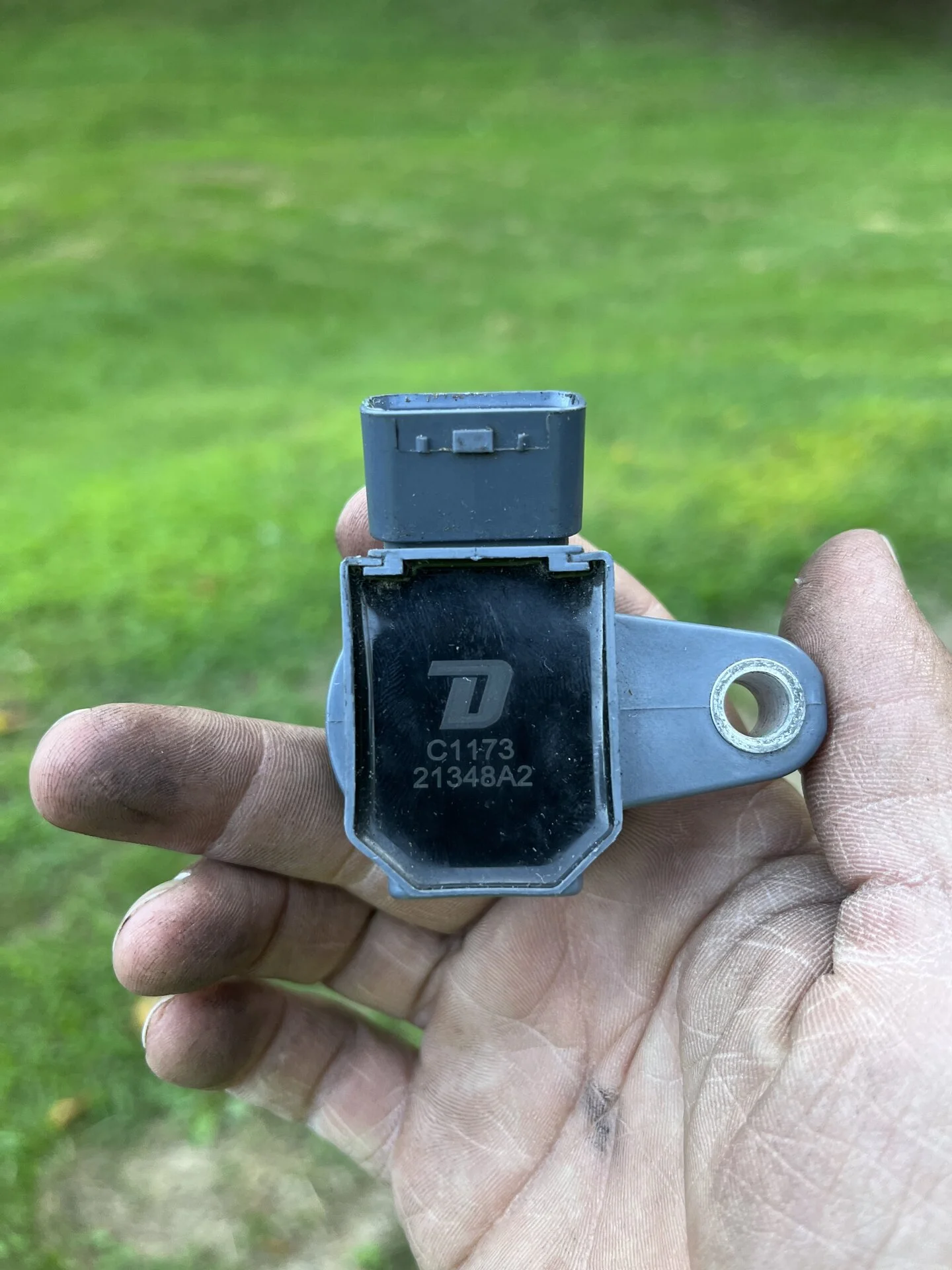

I just replaced 2 coils that had pending codes for random misfires. I believe the one is possible a fake denso? I noticed it looked different when I rebooted the other coil packs and put it back together said wait for it to give me a problem. Didn’t take long.
Plugs were done about 1k miles ago. Will replace the other 6 later this weekend.
Where did you buy them?
That was the one I pulled back out from PO. My new ones are oem from PartSouq

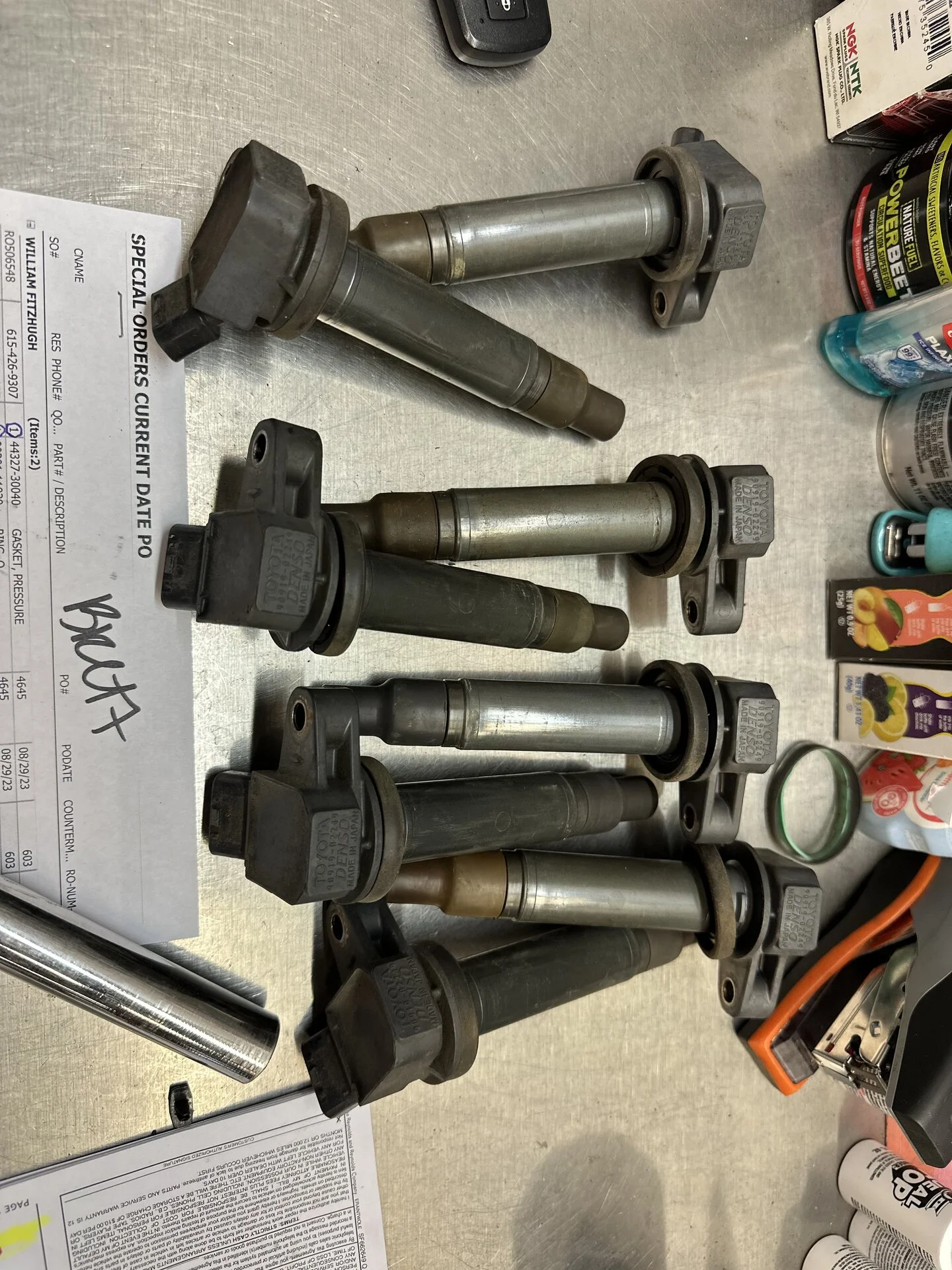

I have a 2004 and currently has 320,000 miles on it. I replaced them out of prevention and got Toyota parts from the dealer. Here is the pic of the 8 that came out:
While there were no codes, the LC ram noticeably better at light throttle.

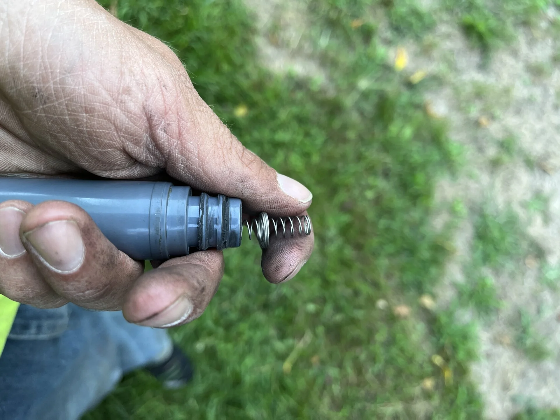

Just found a non Denso coil on mine. Turned out to be the problem of a cold idle issue. These things can swell up and seal the gap, once they get warm, I suppose. I was surprised it never gave a CEL. If you have a good reader, or Techstream, you’ll notice an ‘intermittent’ misfire on a certain cylinder.
The lesson for me, I think, was a reminder of my old street racing days… It’s almost always IGNITION.
