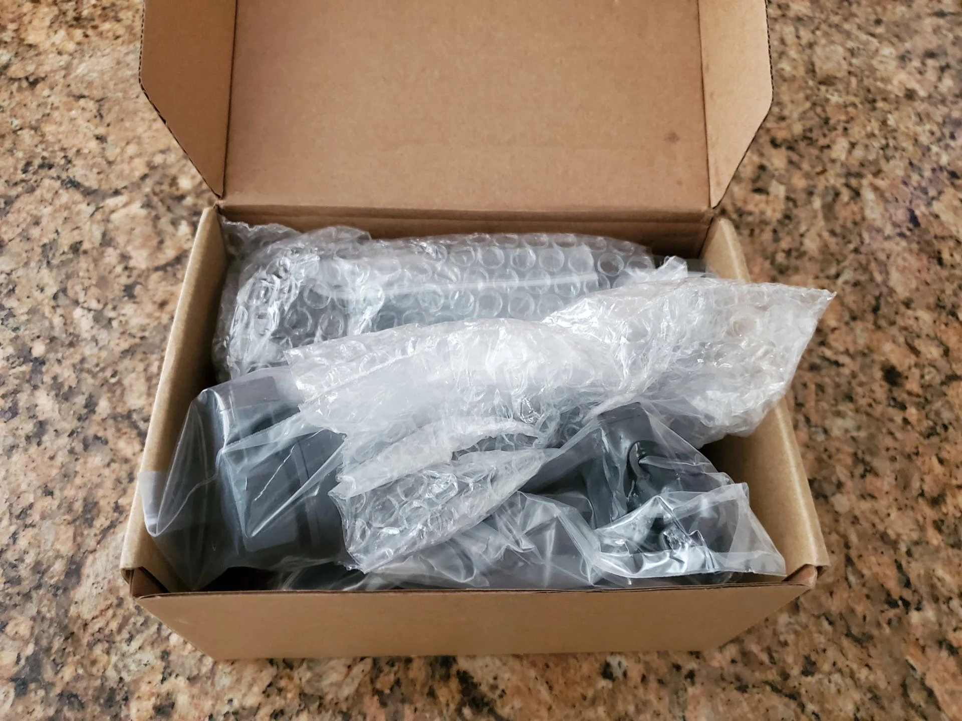

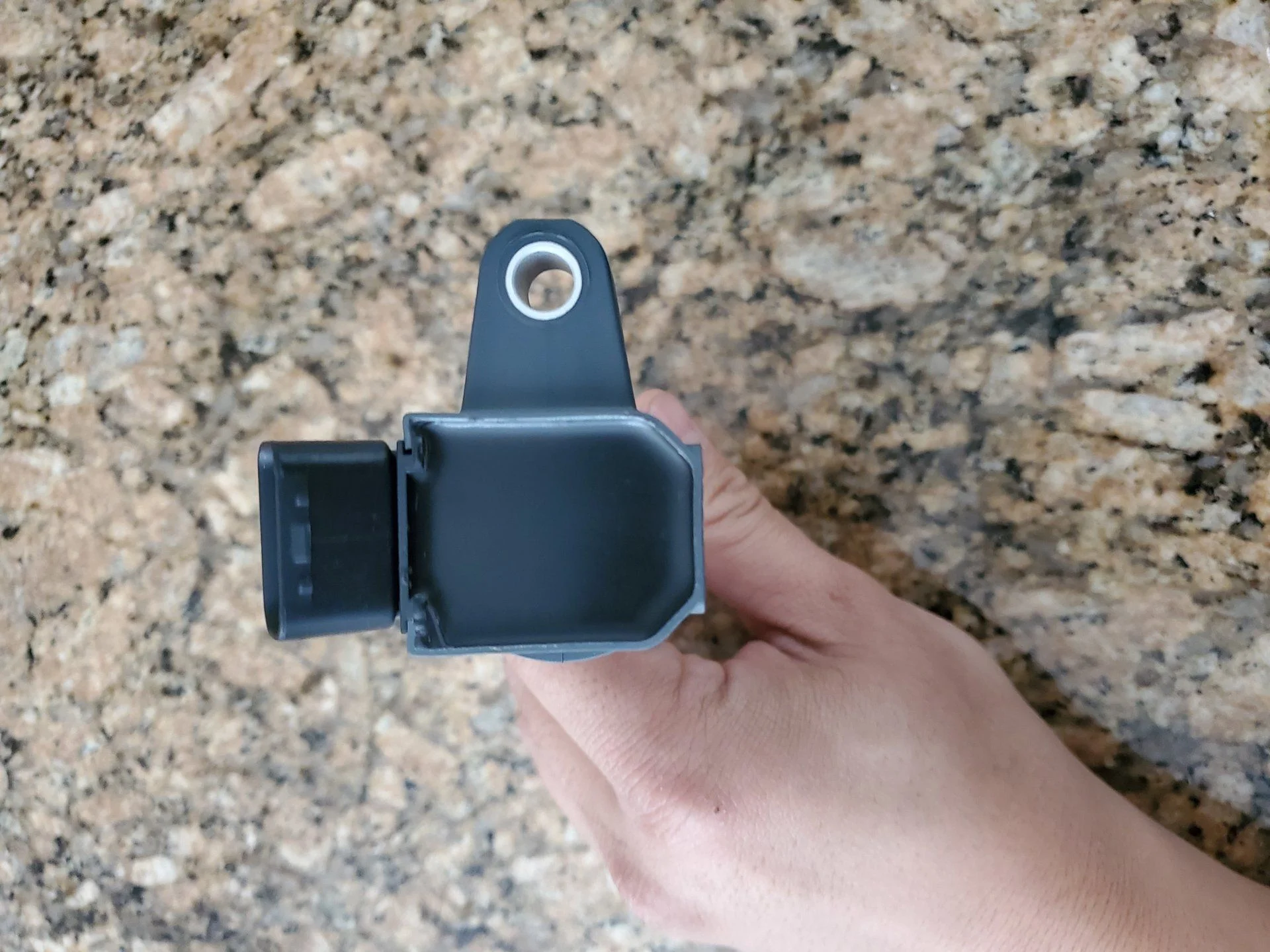

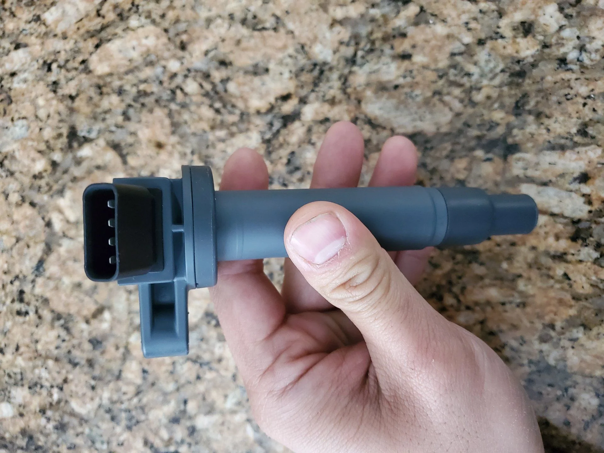

I just received a package of 8 'Genuine OEM' Denso coils from EBay. I was so excited. Only spent $135 on them, a US seller.
When I got was a box with individually bubble-wrapped coils. I inspected the coils - turned out to be very good counterfeits. The plastic did not feel right. It does not look like normal Denso quality. The plugs do not have the Denso part number sticker on top.
I asked for a refund. And the seller kept trying to get me to 'just install them, - it has the part number right on the coil, it was just a bulk package so it does not have a Denso blue box, etc.' I told him they were counterfeits - give me my money back. His responses were mistyped and had spelling errors.
I am getting my refund. Just be aware. These fakes are really convincing.
