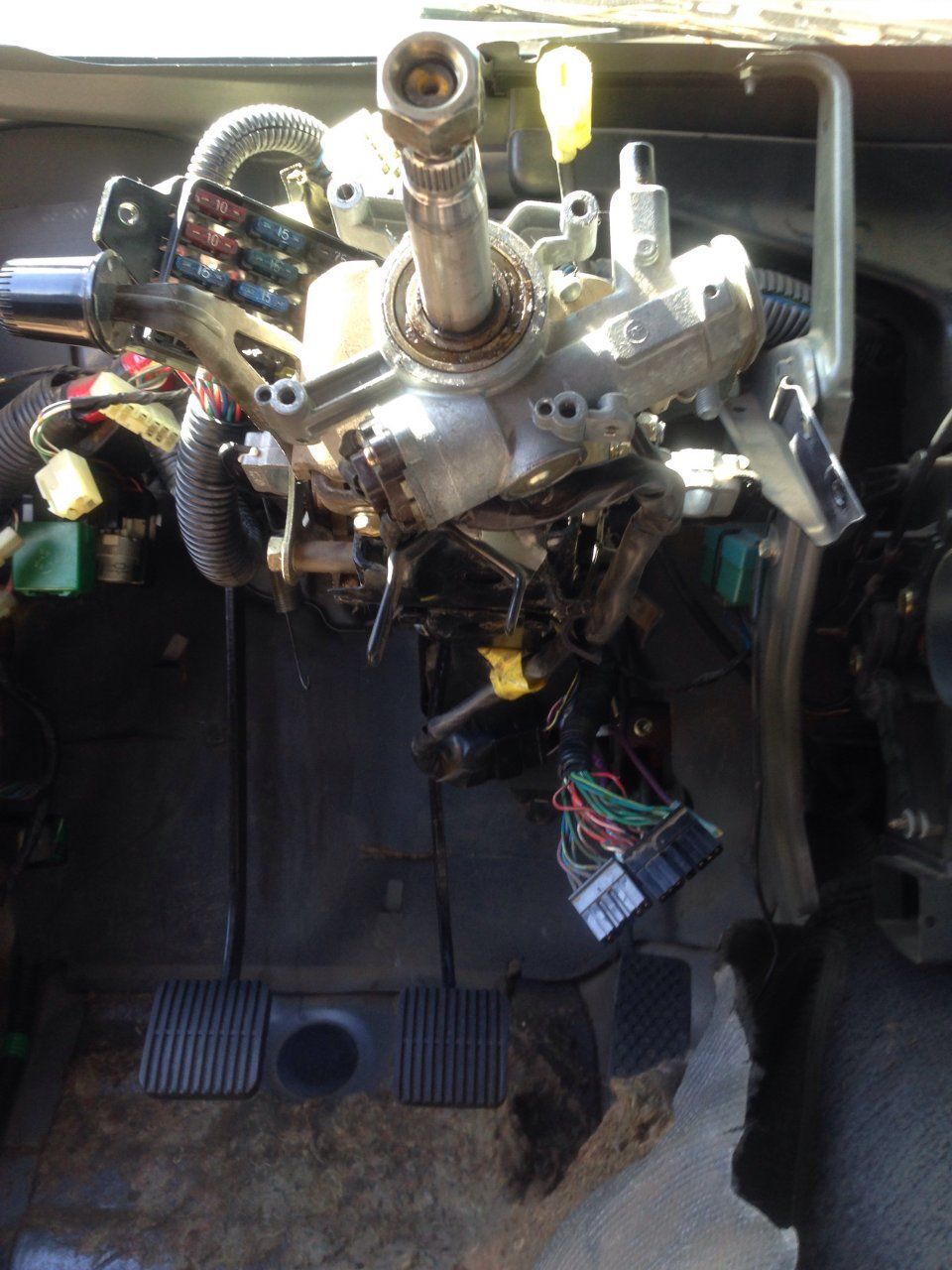

Then on to the nitty gritty work. Figured while I have everything apart it would be good to replace essential electricals:
1. Wiper switch
2. Light switch
3. Horn pin
4. Ignition switch
Set-up a clean area to do the work since there are a lot of small screws/springs/detent balls. This was s good time to inspect everything, clean wires, redo wire wrapping and zip ties.

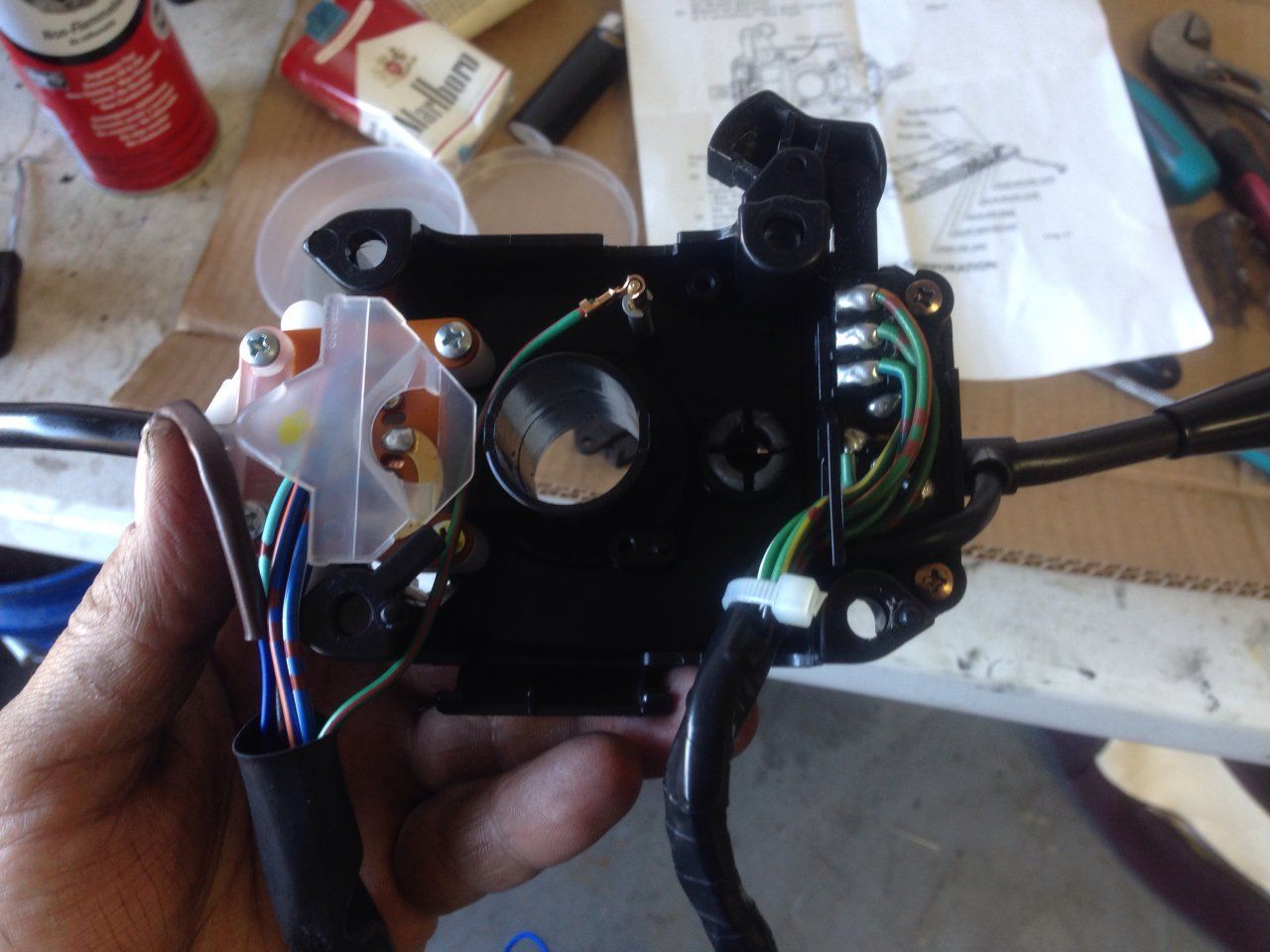

Switches:
Dealing with the light switch/wiper switch was tedious because a couple of the 30 yr old soldering broke which meant cutting the old solder off, cleaning the plates, and re-soldering. Ugh.
Just some pics of the operation. You do need and electrical pick set to do this since you are de-pinning connectors and weather pack wires.

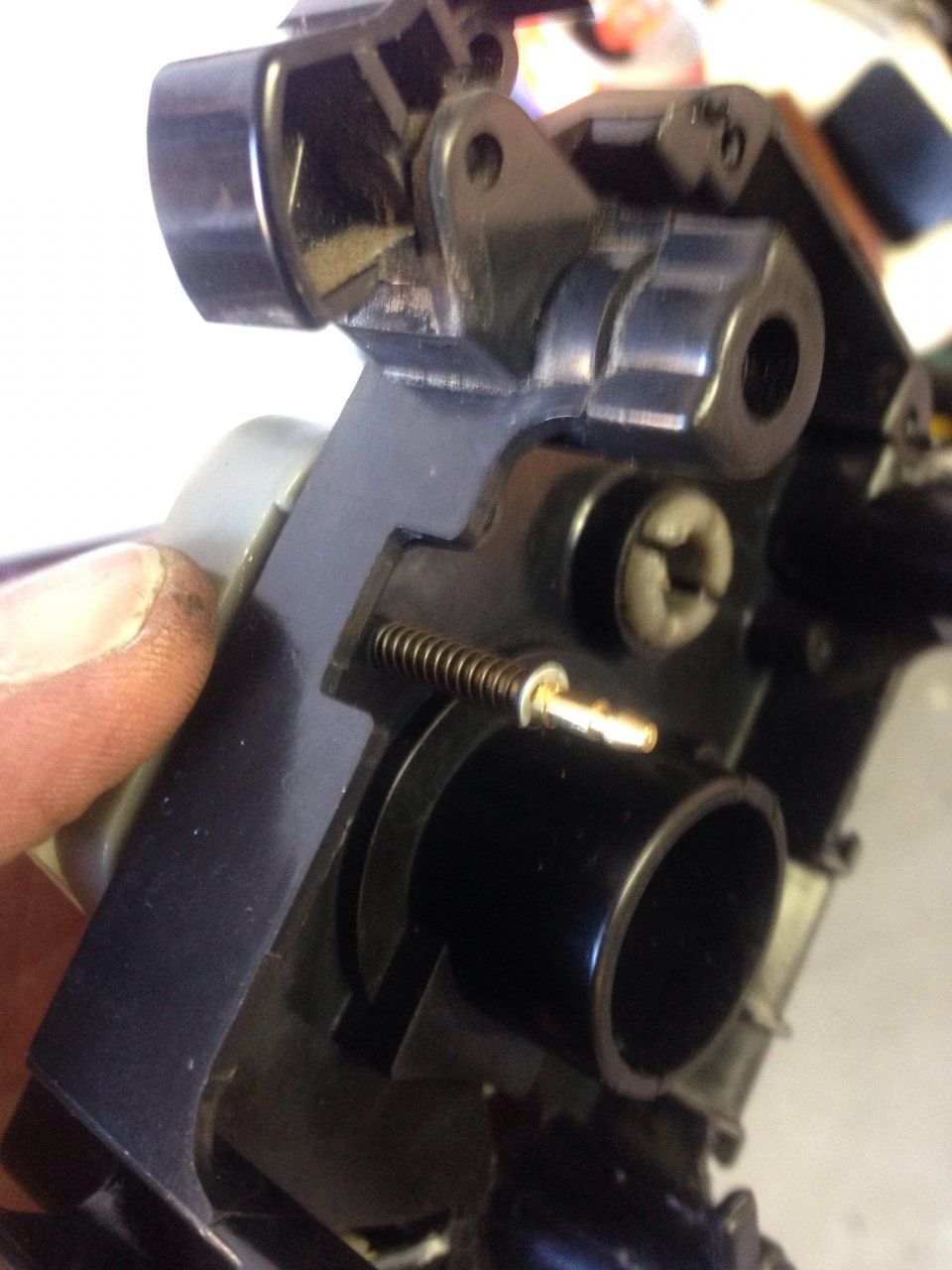

It is important to clean the nasty dirt and factory body grease off. On reinstallation I used SylGlide on all of the detents and springs, as well as any of the moving pieces.

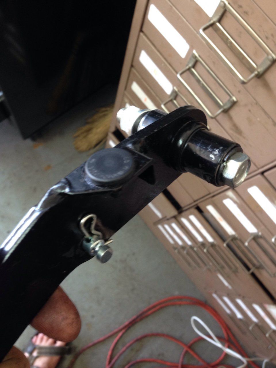

Old and new horn pin/spring and clip:

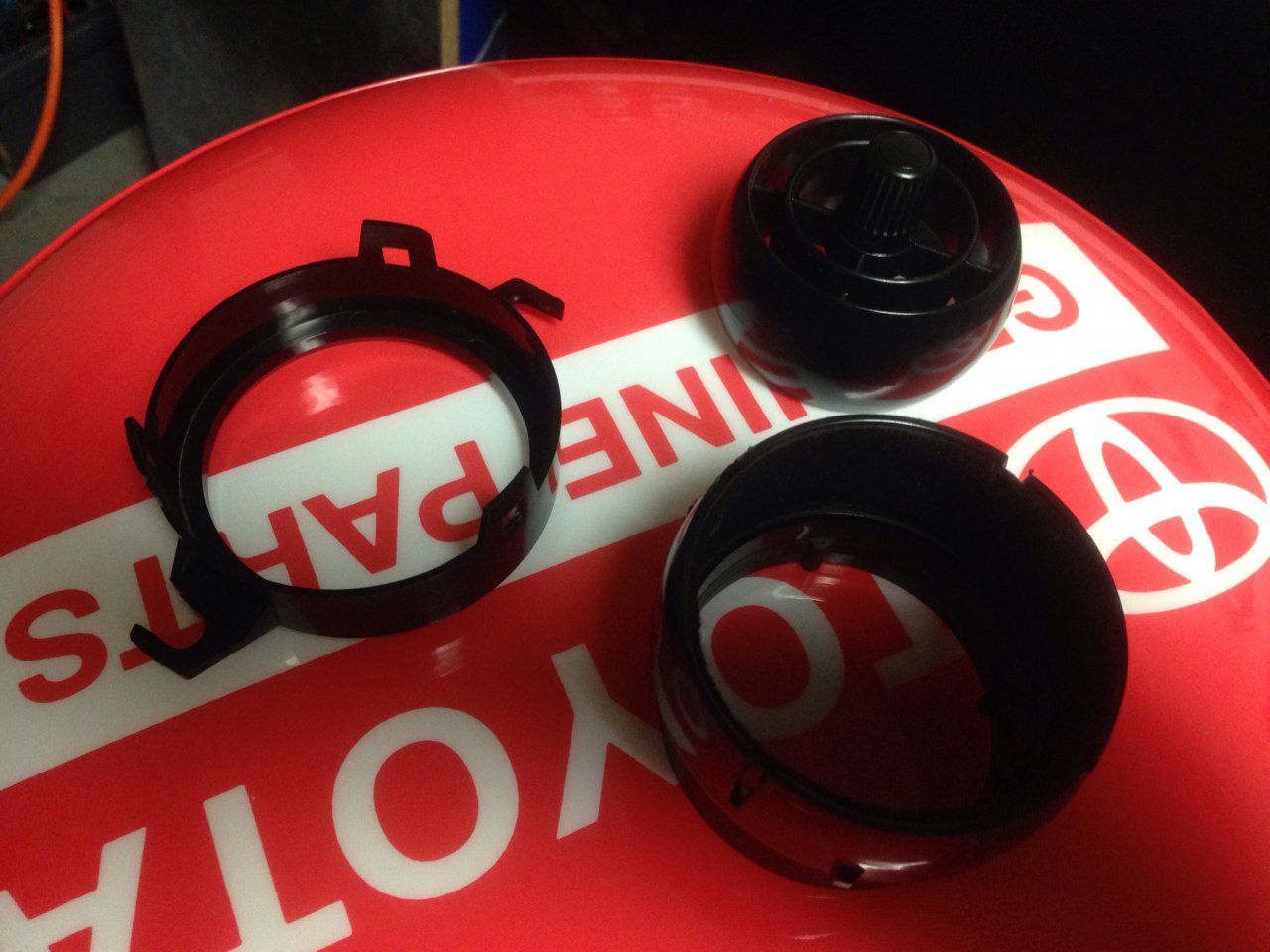

Then onto some HVAC. All of the ducting was cleaned using a industrial plastic cleaner and man they look great.
The registers had 30 years of dust on/in them so they were all removed from the dash, taken apart and cleaned. They look phenomenal now.
