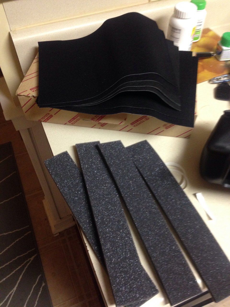

So after pondering for a few days I decided that the Lowe's HVAC seals weren't going to cut it on a Land Cruiser.
I pondered and pondered and thought that there had to be a way to get the stuff that Toyota Gosei originally used in manufacturing the ductwork and registers.
The answer came to me when a technician came in and needed to use the "noise kit" that Toyota supplies to dealers to suppress rattles and "noise related concerns." Pulling out the kit, it fell on the floor and the contents dispersed. And out came glory and epicness to my query and quest to keep it true...
Noise kit is made up of self-adhesive foam and felt in rolls and precut pieces....
I touched the foam and it had the same consistency as the stuff on the HVAC system (except newer of course).
So I ordered a kit and tried it out tonight and by golly it is perfect.
Check out the results:
The adhesive is MUCH stronger than the Lowe's crap and the foam feels so much more substantial.
Very happy with the results. The felt squares will also be used and will "wrap" the plastic HVAC component housings and act as a noise reducer on this components.
Very stoked at this serendipitous find.
Here is the part number and some of the kit components:
Those are just a sampling of what's inside of the kit. I think this stuff is going to work perfectly!
That said, before anyone goes running to your local Toyota parts dept to get one, be aware that the kit lists for $190 or so... Even with discount you are well over $100.
Not for everyone but a very nice touch for the purist.
