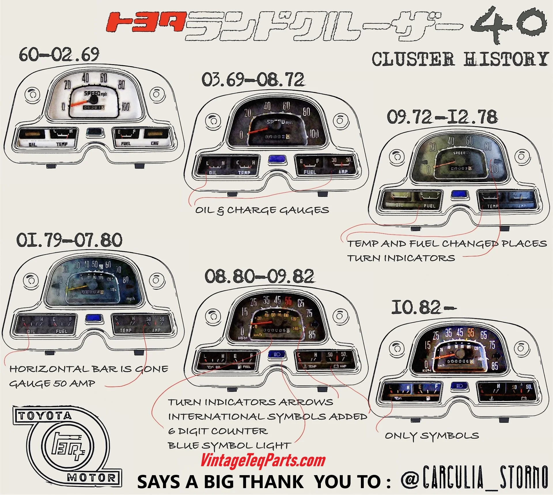

b242b27a-700c-4659-a424-fd27ff000582vintagetewp-arts-jpg.2835110

"The 1980 with the 55mph highlighted is the rarest in my opinion."

Matt, I think the cluster history is off alittle, the grey speedo went away in 1964? 1963? being the last year of the grey speedo and the oil and charge lights
Paul
Paul
Not exactly paul
Your both right and maybe indeed off a tad too with all do respect
Keeping in mind I did not crate this killer kool
Work of art and am posting it with the permission of my fellow Artist …fyi
@pardion and I concluded a few years ago the FJ45LV Panel
Van / wagon still kept using the silver guage face and indicators type warning lamps a model
Year or 2 only longer then a Fj40 ….or a FJ45 pick up
If anyone can confirm, or otherwise add to this unique fact please chime in ..
Paul , I have lost touch with the original ARTIST ?
If anyone knows who or where to contact him please PM me ..?
As a general rule of Artist,s professional code and ethics I can,t simply
Photo shop or alter his original work in any way …
It’s a mutually acceptable common sense respect thing too ….
I agree the silver face pro date is off a Tad as well at least USA spec. ?
However the origina artist is located in the NON-USA far away region so that can play a part here too …
Thanks Matt
