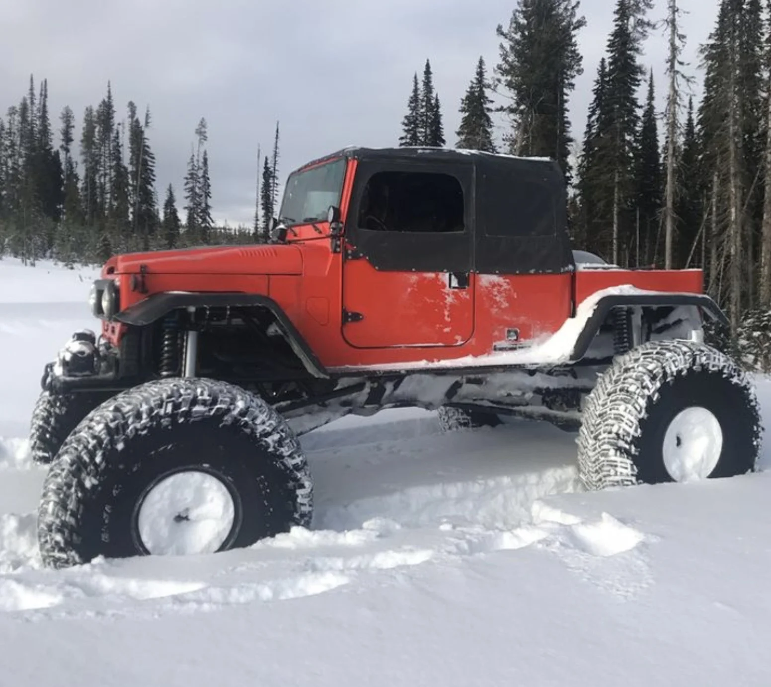

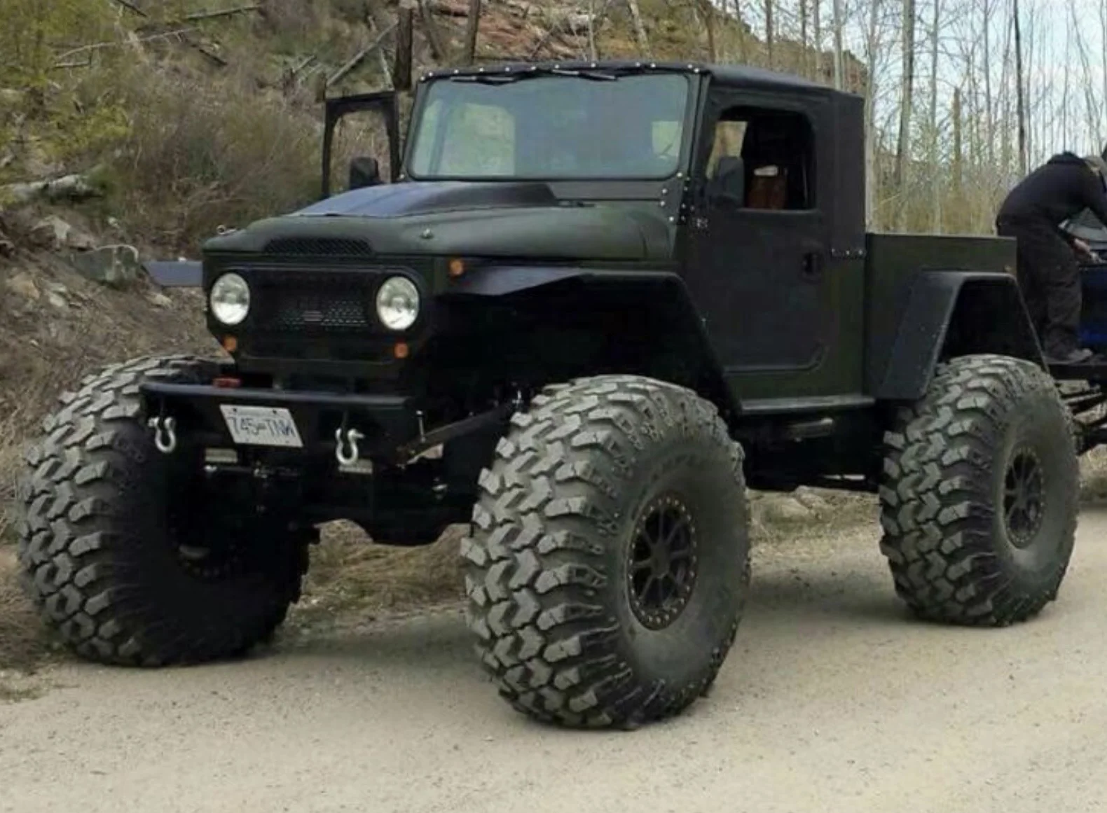

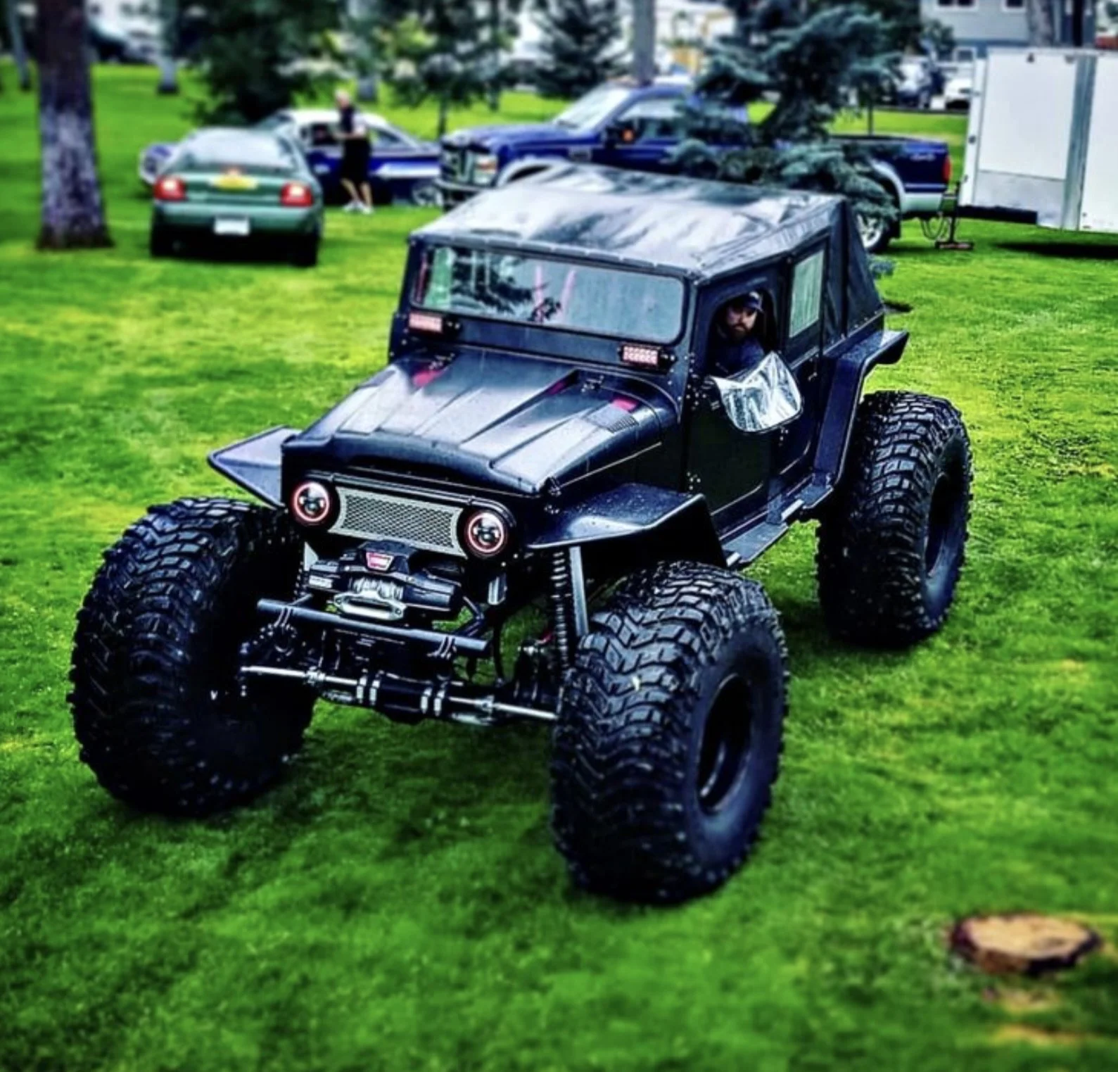

Here’s some rigs from Kelowna home of Aqualu. I know fsr from stock. The ICON also is all Aqualu. Pics for fun of some Kelowna rigs.
A 4 wheeling group called Kelowna Snow Wheelers
Small highjack. lol there rigs seem to survive Canadian winters. Cold in Kelowna
