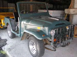

Any details would be appreciated.
are you referring to the fork lift grill guard?
Absolutely nothing just ship it to my front door and I will dispose of it..I may take the trailer lights off it for my trailer.
Give us some details year,mechanical,location,rust,mods other than the forklift guard.
Not mine. Just curious.
I just saw this on CL & wanted to know something about it. Ad states 1969 land cruiser 2WD. Your thoughts?
Steering wheel is put on wrong, have him fix that before you get it.
Looks like a FJ40 front with a postal jeep rear. Dash looks jeep to me. I would run.
looks FJ25-ish to me - round wheel wells, door opening that could have used to have been the rounded door opening...
That was my guess as well - FJ40 front clip on a DJ frame and hacked tub.
2WD, RHD, skinny leaf springs, round wheel wells, jeep dash (and windshield?)
This looks like a postal jeep with an FJ40 fiberglass front clip. It actually looks like the front bib, fenders, side skirts are all one piece. I would stay away from this...
I would agree fj40 front clip on a 2 wheel drive jeep. A postal jeep would be a 4 banger and automatic right hand drive. The title would have to say jeep. No one in their right mind would try and run a heavy fj40 with a 4 in it, unless they had some friends to help push up any hill.
