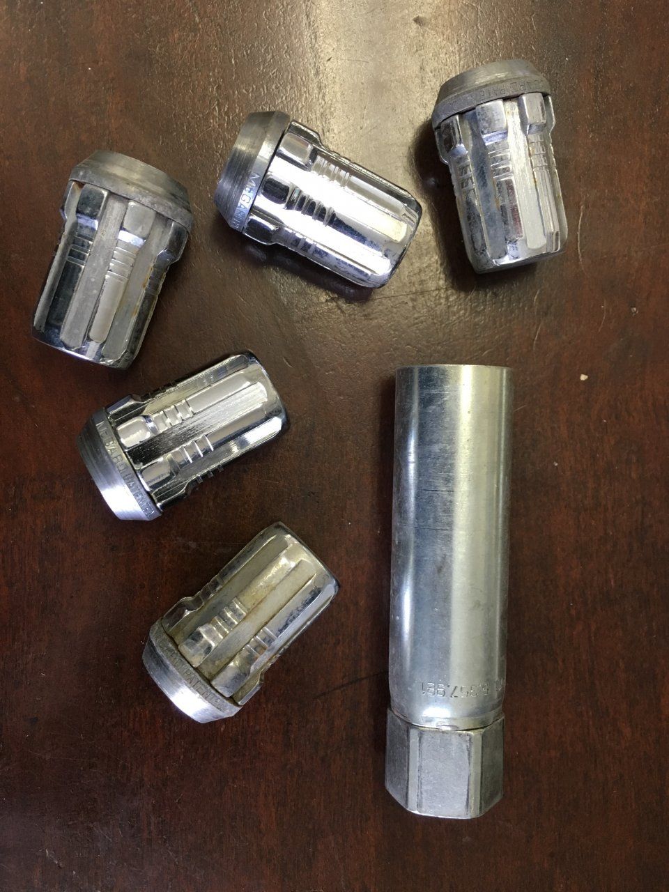

Yes, those are the spline drive lugs required for the TRD wheels.

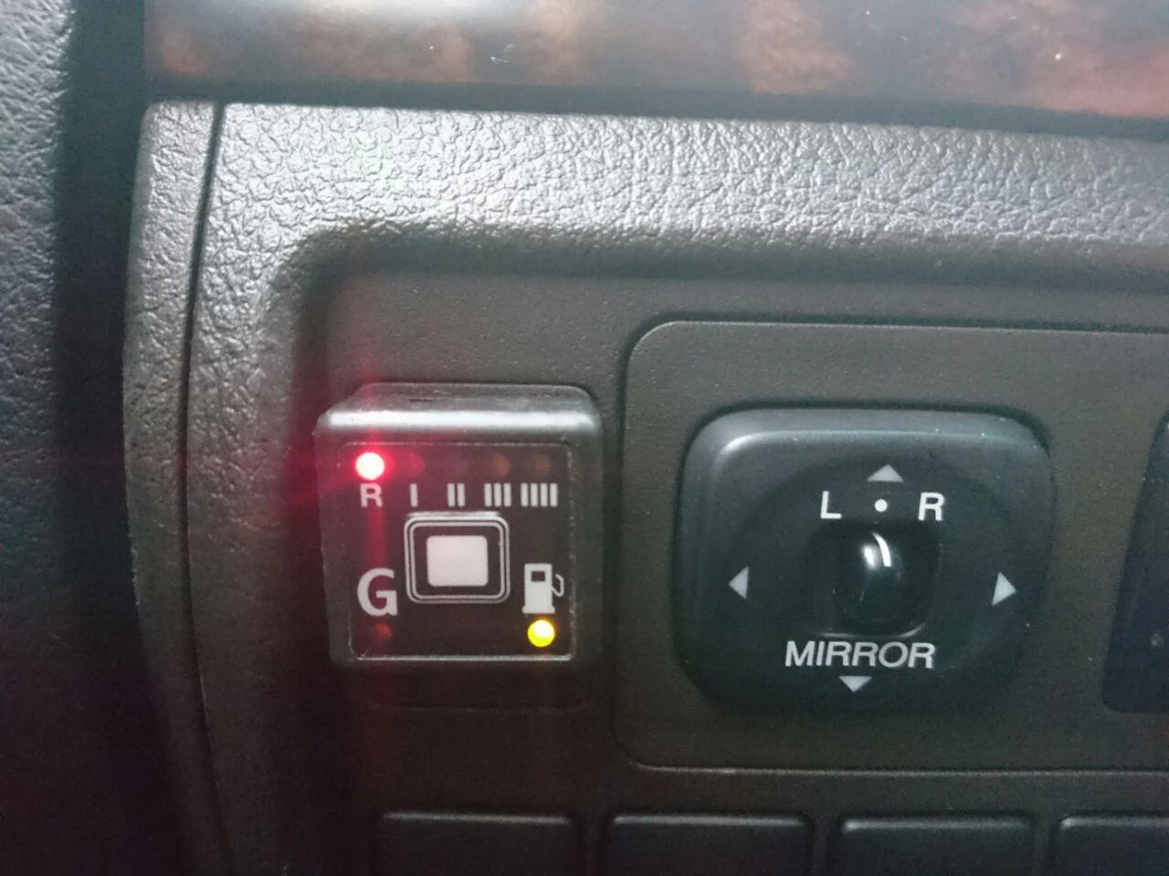

Continued.
Here's the button to change fuel type. It also has indicators of which fuel type I am using right now and approximately how much LPG is left in the tank (doesn't show it that well though, due to nature of LPG). I can change fuel type any time, at any speed, I don't even notice when it switches. The car itself always starts on regular gas, then switches to LPG automatically when engine temp reaches about 70 degrees Celsius. I can start the engine on LPG if I need to (like if I ran out of gas), but it's not recommended. I can also turn off the LPG system completely, and the car will just run on gas as usual.
The car measures average fuel consumption as usual, though not as precise as on gas.
Overall, the system is great. The stock fuel tank is quite small (around 90 liters I guess), so I wanted second tank anyway. This way, I get the second tank, the increased range, and the choice of fuel I am using. The quality of gas is quite bad in my country, so running on LPG is usually better. Like, the engine itself works much better, there's no detonation at all (LPG's octane is about 100 AKI). There is slight power loss, though you can't really feel it 99% of the time. Fuel consumption is around 10% higher on LPG. The price of LPG is about 2.5 times lower than gas here. It was around $1100 to install (parts and work included), and I'll get that money back on the price difference in about half-a-year to a year.

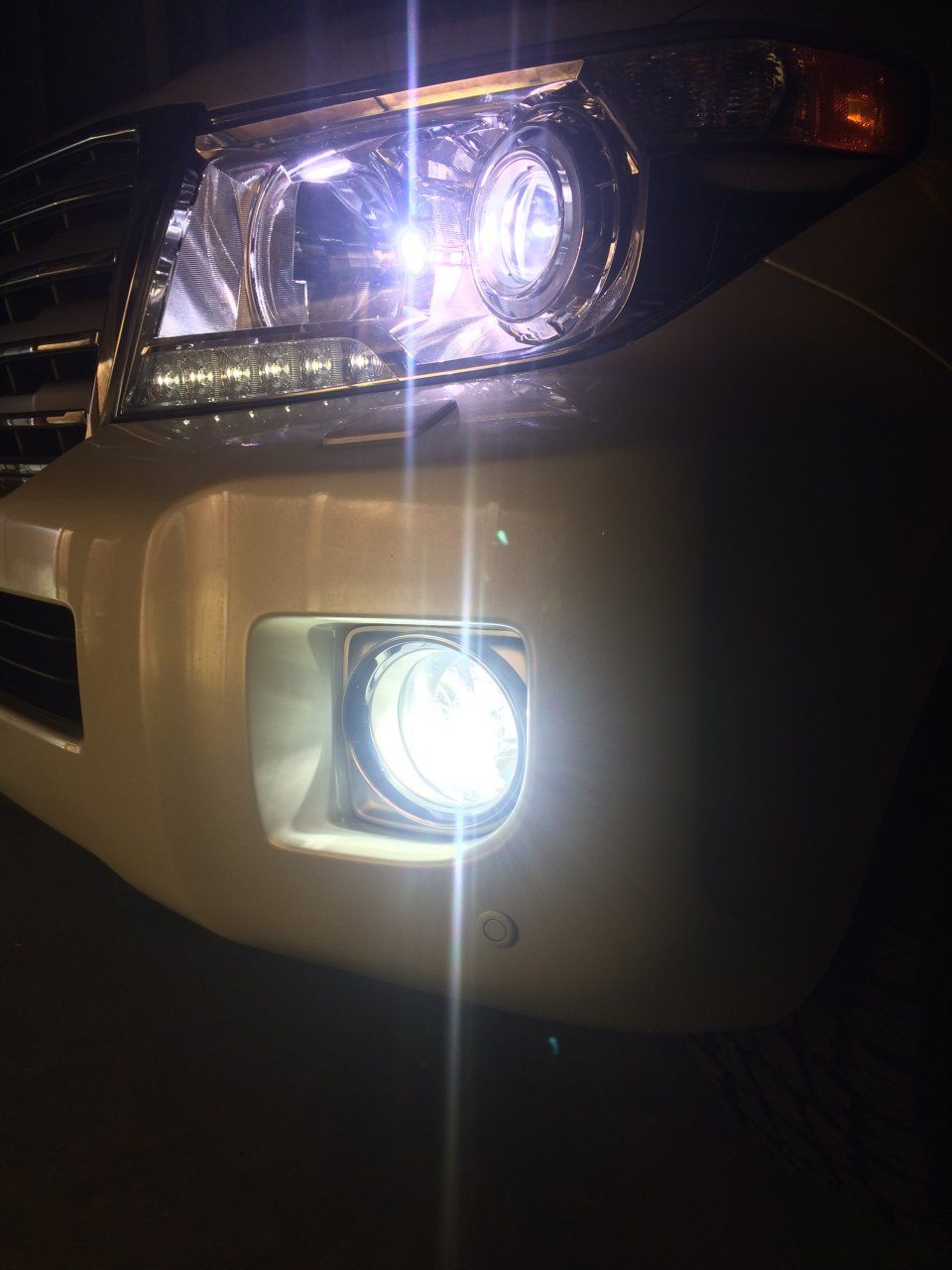

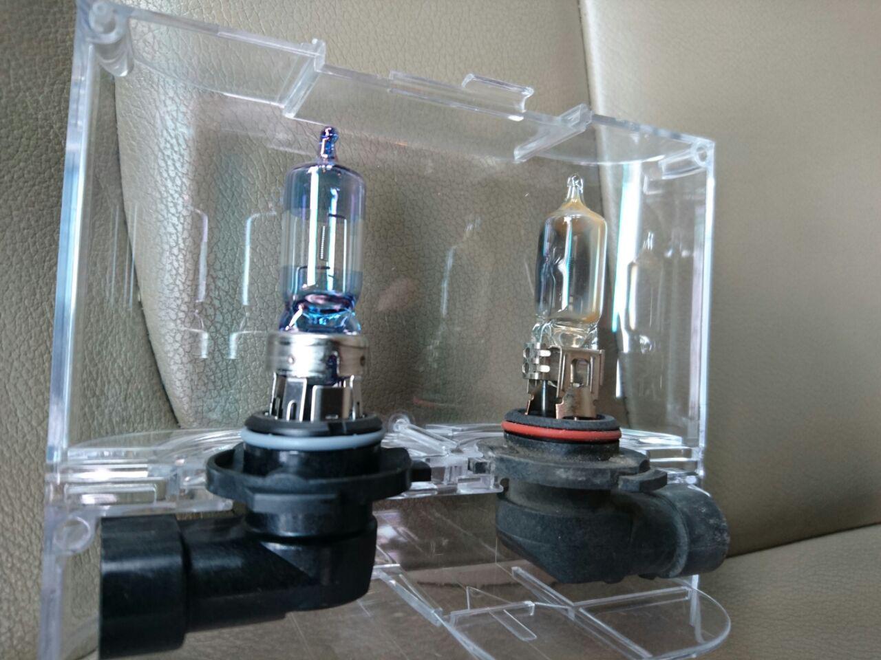

Since I'm writing about what have I done to my Cruiser last week, I've also replaced high beam bulbs, here's the comparison of new to old.
They are at least twice as bright.

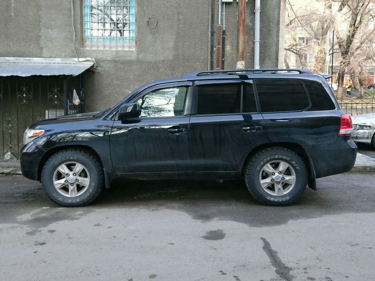

And here's the pic of 33" Cooper Discoverer S/Ts I've installed a few weeks ago. So far I like them, hope to test them more soon.
Which replacement bulbs are those?

[="Markuson, post: 10261438, member: 35751"]Those are spline nuts?[/QUOTE]
I was about to order new TRD Kit when seller dropped by my office.
I love ethical sellers!

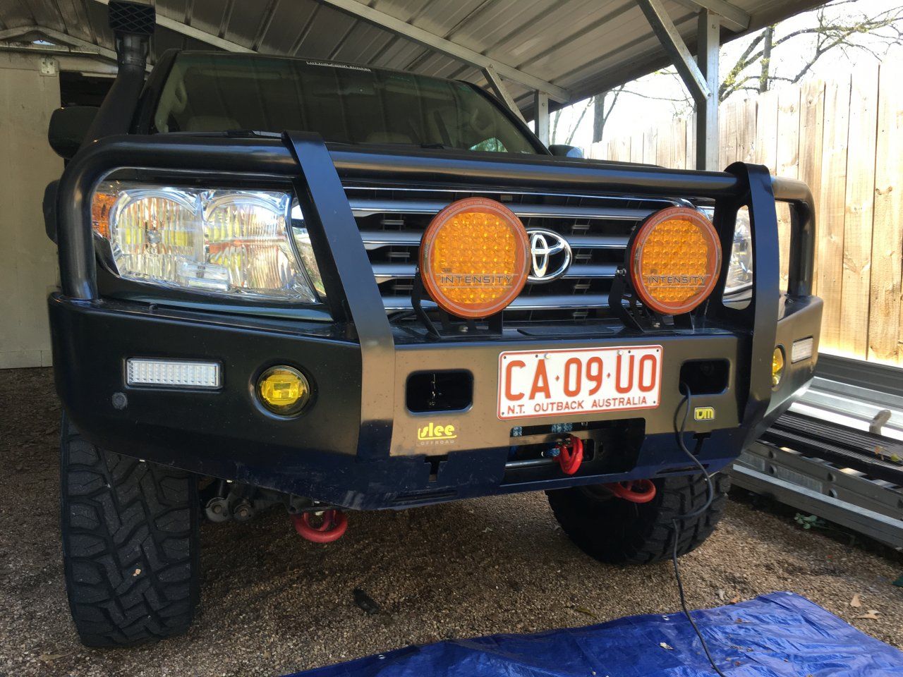

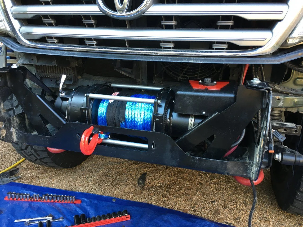

Got a little done this morning. Warn M12000 install
Still waiting on my fairlead from Slee
