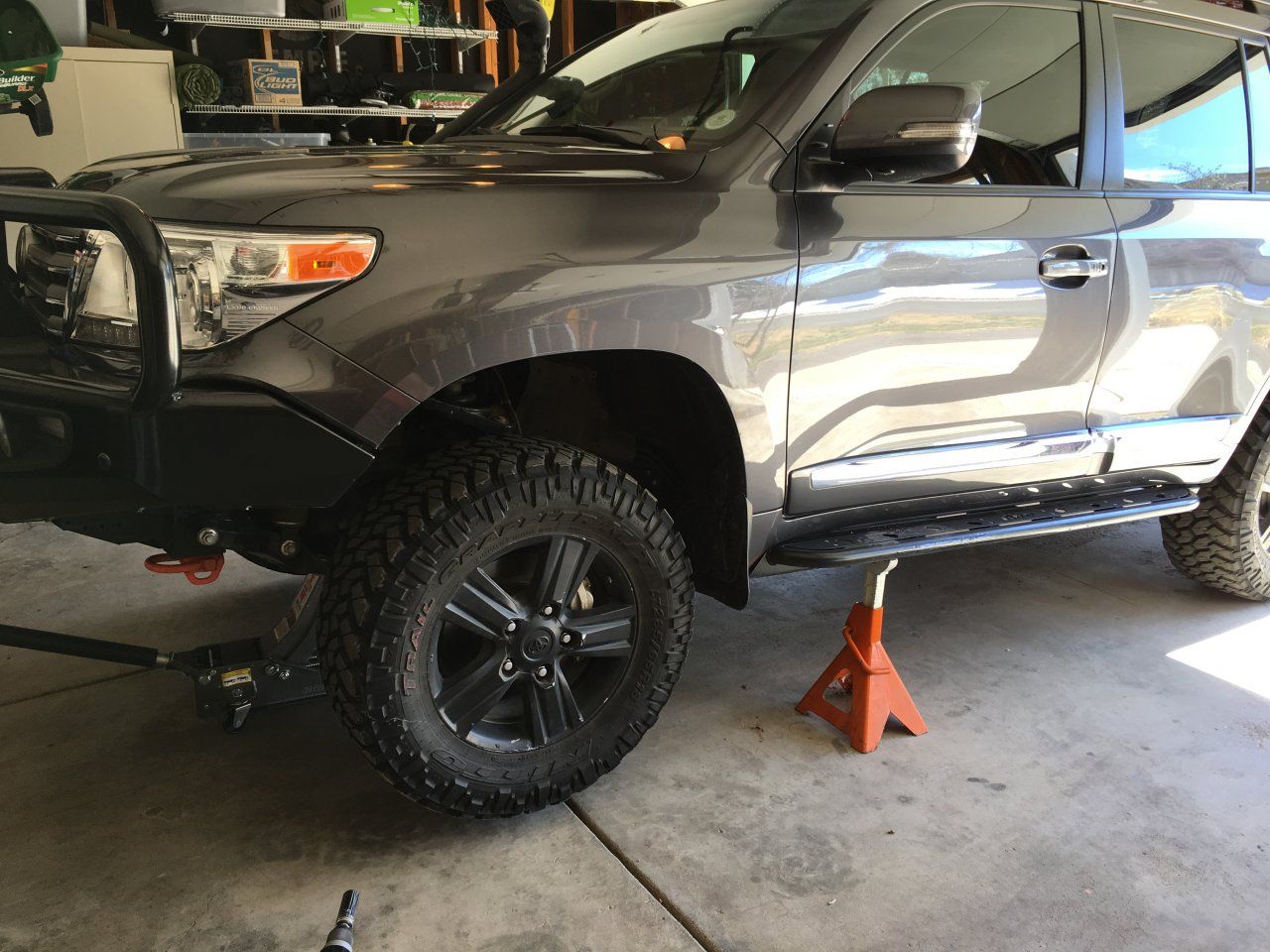

I've briefly mentioned this in other threads but I've never done a write up. I recently had to change one strut and I was able to do it without breaking the steering tie rod or UCA ball joint. It was the fastest I've ever changed a strut. I got the idea when I swapped out my LCAs. Here are two pictures with what to loosen. I don't have time to give you the long story but if you remove the two bolts from the bottom of the steering spindle, remove the swaybar bolt from the LCA, Support the steering spindle and brakes, loosen the LCA bolts and allow it to swing out of the way and the struts can go in and out from below.
I've you're doing this as part of a full install and have the change to UCAs then you'll have to break the ball joint but that's not too hard. Breaking the steering is a beeech. (don't hit the brake guard.
Does all this make sense? Ant
(obviously you'll need an alignment immediately)

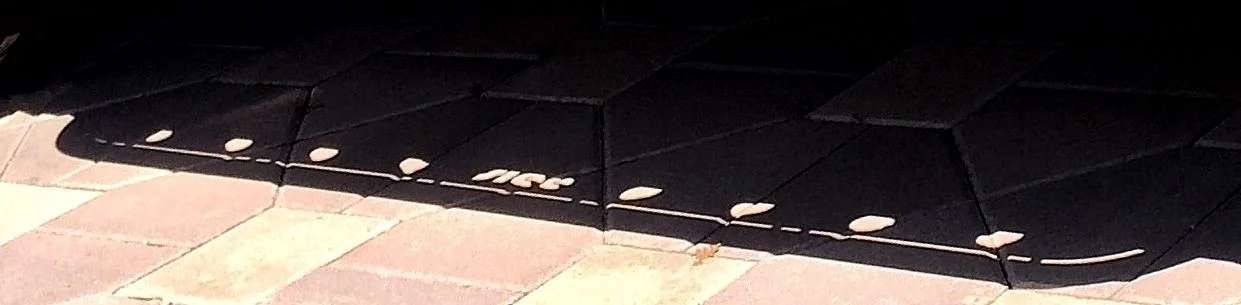

Sun painted a cool shadow of Slee's laser-cut logo...hinting at what I added this week... ;)

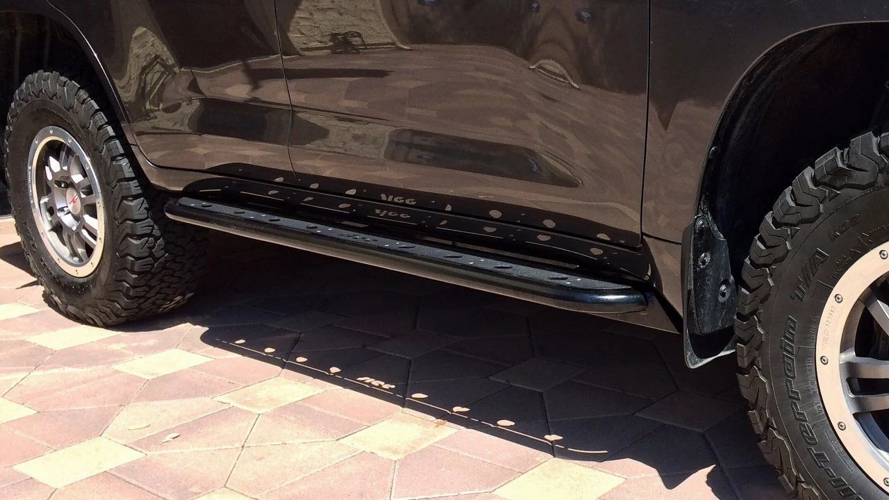

In a 4000 mile road trip with the wife that included Nevada, Arizona, Utah, New Mexico, Texas and Colorado...I had the chance to stop at Slee for some rock protection. Absolutely love Slee's S-T-O-U-T products. Sadly, we had so far to travel that wheeling wasn't really on the schedule...but had a great trip visiting relatives anyway...
Here's a wider shot:

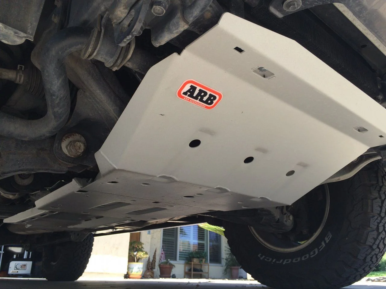

Also added skids while at Slee on Friday...

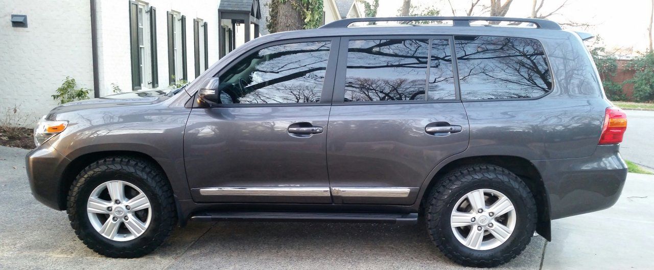

I bought a 2013 last week. 62k miles, clean inside and out. Love it! Huge difference in ride and comfort from the '98 I owned about 7 years ago. The bfg's went on immediately- I am a big believer in these tires and have owned them on all my vehicles. This is my first set with the new version of the all terrains... looks like a mud tire from the side. I was tempted to get the white letters facing out but no regrets. I removed the front mud flaps and plan on taking a dremel+sander to the rear flaps this afternoon. I don't want a huge gap in the wheel well that removing the entire rear flap creates. This forum has been a great learning tool.
What tire size did you go with?
Just in case you were referring to my photo... My BFG's are 285/70/17's, which fit fine with or without a lift on both LC and LX.

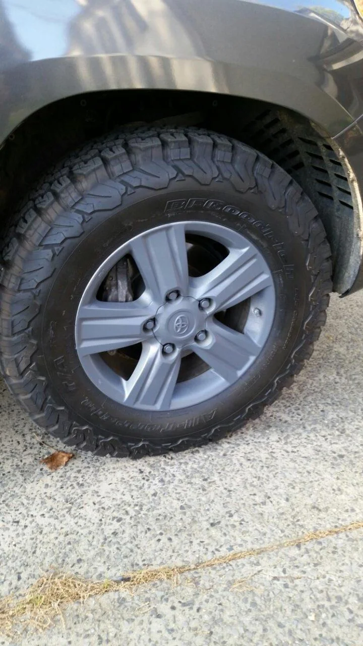

Plasti - dipped one wheel today. I'm going to test it for a couple days before doing the other wheels. I wanted something other than black.
My bfg's are 275/70/18.
I bet I'll want to go slightly bigger once my dang kdss valves get unstuck and the ironman fcp lift goes on. We'll see though.
I've been curious about plastic-dipping for a while now, but always had the impression that it would end up looking pretty shabby due to scraping off in brush, bushes, twigs, or rocks, etc. If you go wheeling in any areas like that, I'd love to see a follow-up post showing how it holds up. I know that you can remove it, but I wouldn't want to have to keep re-doing often (call me lazy)...
