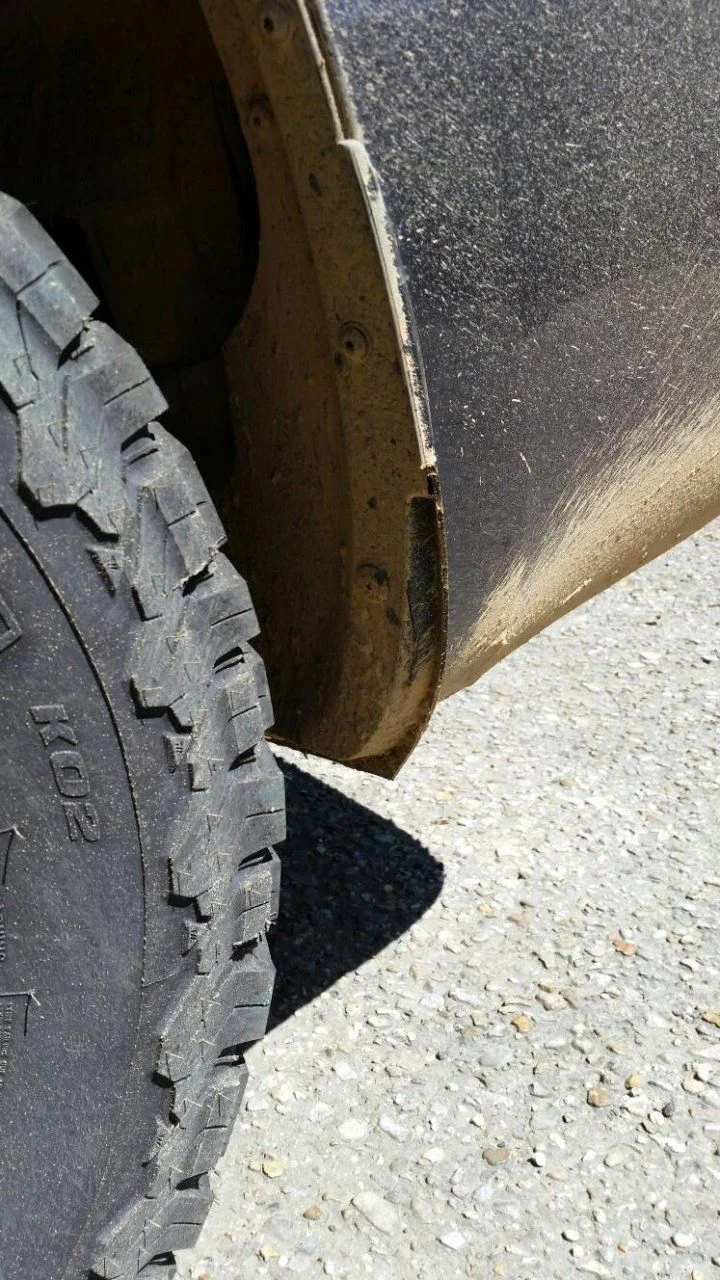

Took a dremel to my rear mud flaps. Still need to sand them up a bit.

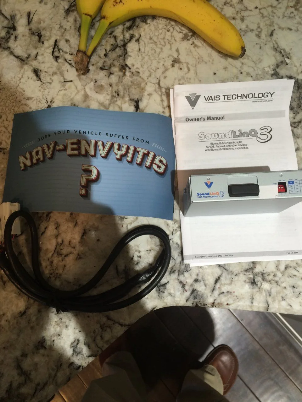

I will be streaming music by end of today.
08's (not sure about 09's) have Bluetooth for phone calls, just not music - twisted world, I know.
I'm fixing it. Yes, the pictured device will allow me to stream Pandora or whatever. There is also a USB port on the back of the device which I'll run my newly purchased black iphone cable out somewhere (around my ashtray) for charging only - pretty slick. I found this link which made me aware of the USB deal.
https://forum.ih8mud.com/threads/adding-an-aftermarket-bluetooth-interface-to-factory-stereo-nav.820658/#post-9784173
Agreed - it's a nice pick up
I took a bunch of photos and will do a write-up for those who purchase a 2008 and want to stream music. There is more to it than the thread I referenced above.
Nice, the 13s have both abilities luckily. I did put in the video and nag bypass from the prestigious society. Primarily for the Nav override. Watching family guy while sitting in traffic has never happened.
They do make a module that allows you to stream video from your phone also.

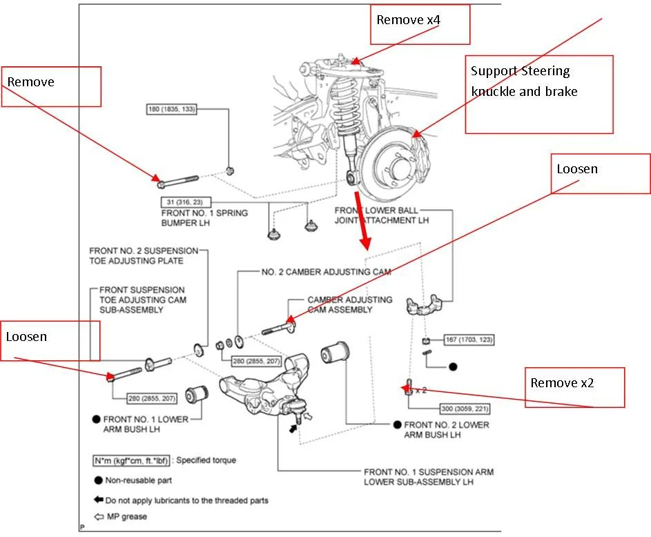

I've briefly mentioned this in other threads but I've never done a write up. I recently had to change one strut and I was able to do it without breaking the steering tie rod or UCA ball joint. It was the fastest I've ever changed a strut. I got the idea when I swapped out my LCAs. Here are two pictures with what to loosen. I don't have time to give you the long story but if you remove the two bolts from the bottom of the steering spindle, remove the swaybar bolt from the LCA, Support the steering spindle and brakes, loosen the LCA bolts and allow it to swing out of the way and the struts can go in and out from below.
I've you're doing this as part of a full install and have the change to UCAs then you'll have to break the ball joint but that's not too hard. Breaking the steering is a beeech. (don't hit the brake guard.
Does all this make sense? Ant
(obviously you'll need an alignment immediately)

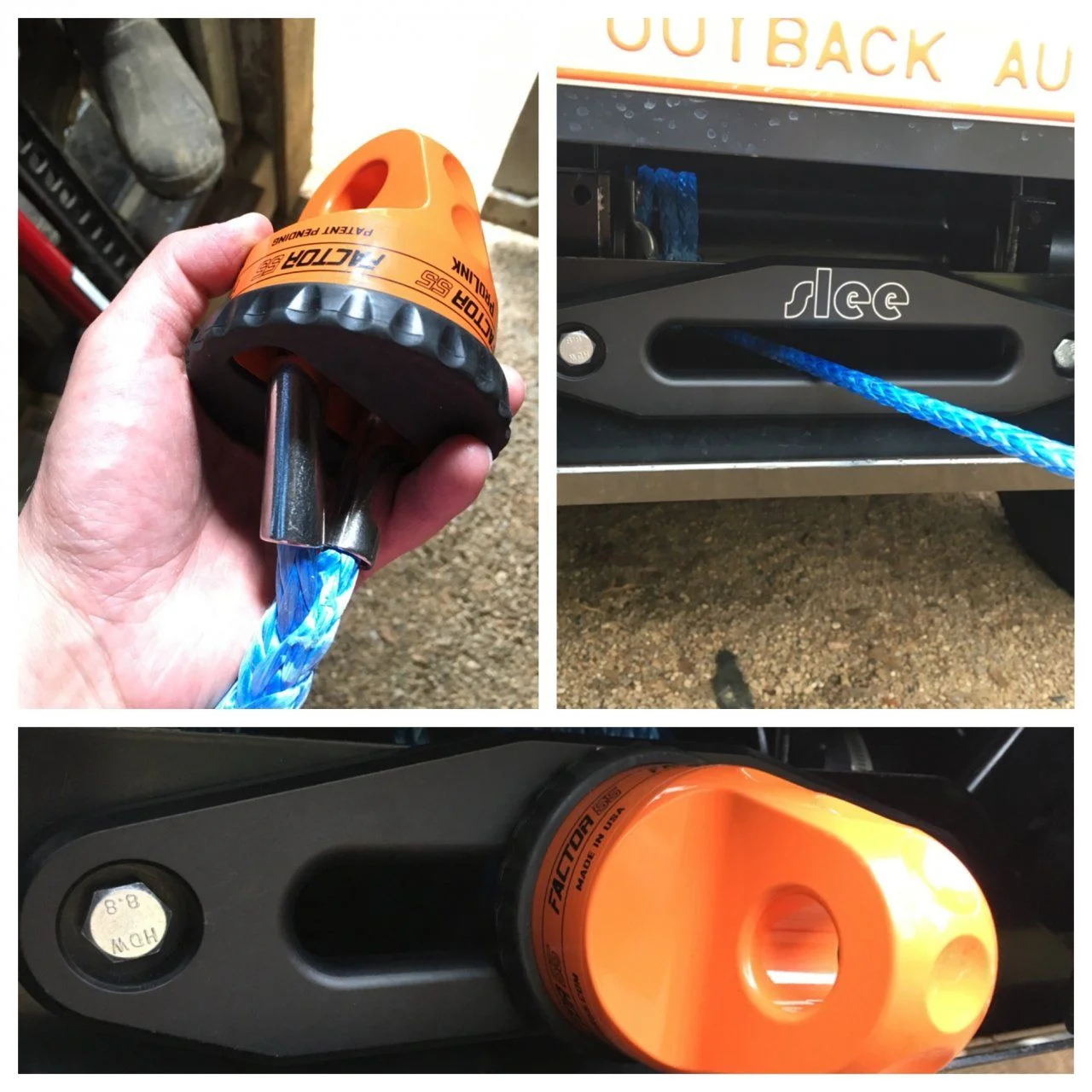

Installed a Factory55 Prolink and a Slee Hawse fairlead this afternoon. My winch install is now complete.
