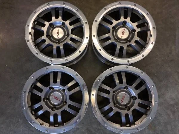

nice find and with the TPMS sensors - good on you
yes - you need the conical lugs - several outlets online for sourcing those. I picked mine up through trdparts4u.com
congrats
congrats
Wonder if Beno can source these?
What year Tundra am I shopping for?
Do I need different lug nuts for these?
Yes, as others have pointed out.
Here is what the Toyota TRD lug nuts look like:
Note that the mating surface that contacts the wheels is designed to rotate - thus avoiding scuffing up the wheels. This is a feature not found in the generic substitutes.
Toyota recommends this wheel for the Land Cruiser. Here is page 1 of the tech sheet Toyota publishes for these wheels:
Please note under "Additional Items Required For INstallation" the Part Number for the lug nut set that includes 16 x splined lug nuts, 4 x lock nuts, the spline tool and the lock nut tool.
One source for the entire set is here: Wheels, TRD Wheel Installation Kit 14mm PTR27-60110
HTH

Yes, those are the spline drive lugs required for the TRD wheels.
