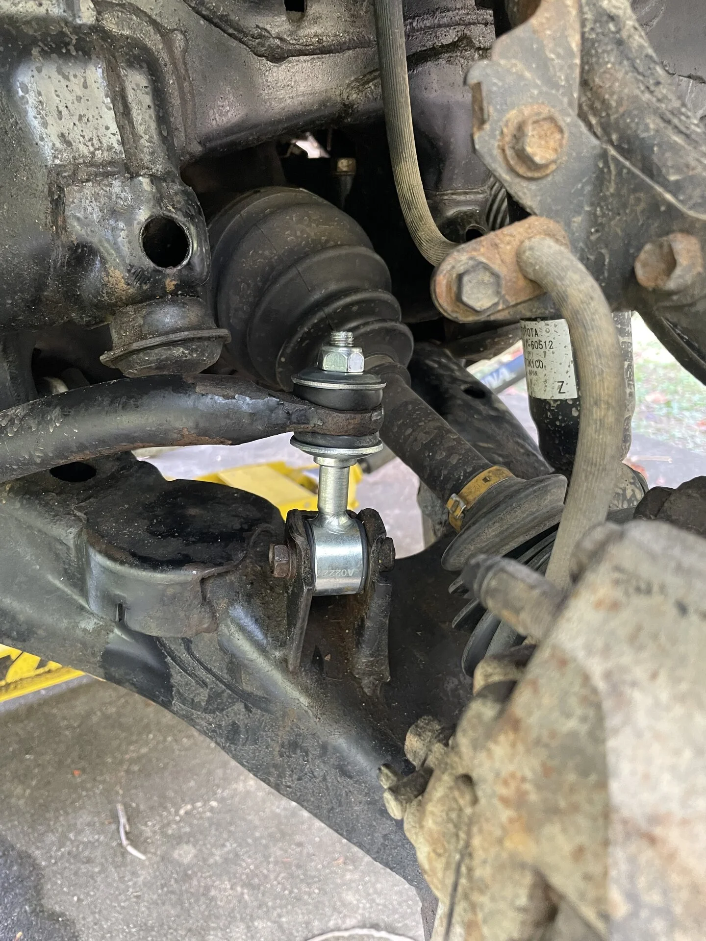

I know this will cause chest pain for the oem purists, but...New Mevotech sway bar end links up front today from Rock Auto. I'll report back if they fail in short order, but the quality seems good and for $24 for the pair for a non-critical part I figured what the heck.
I’ve had them on the rears for about 2 years and they are still rocking!

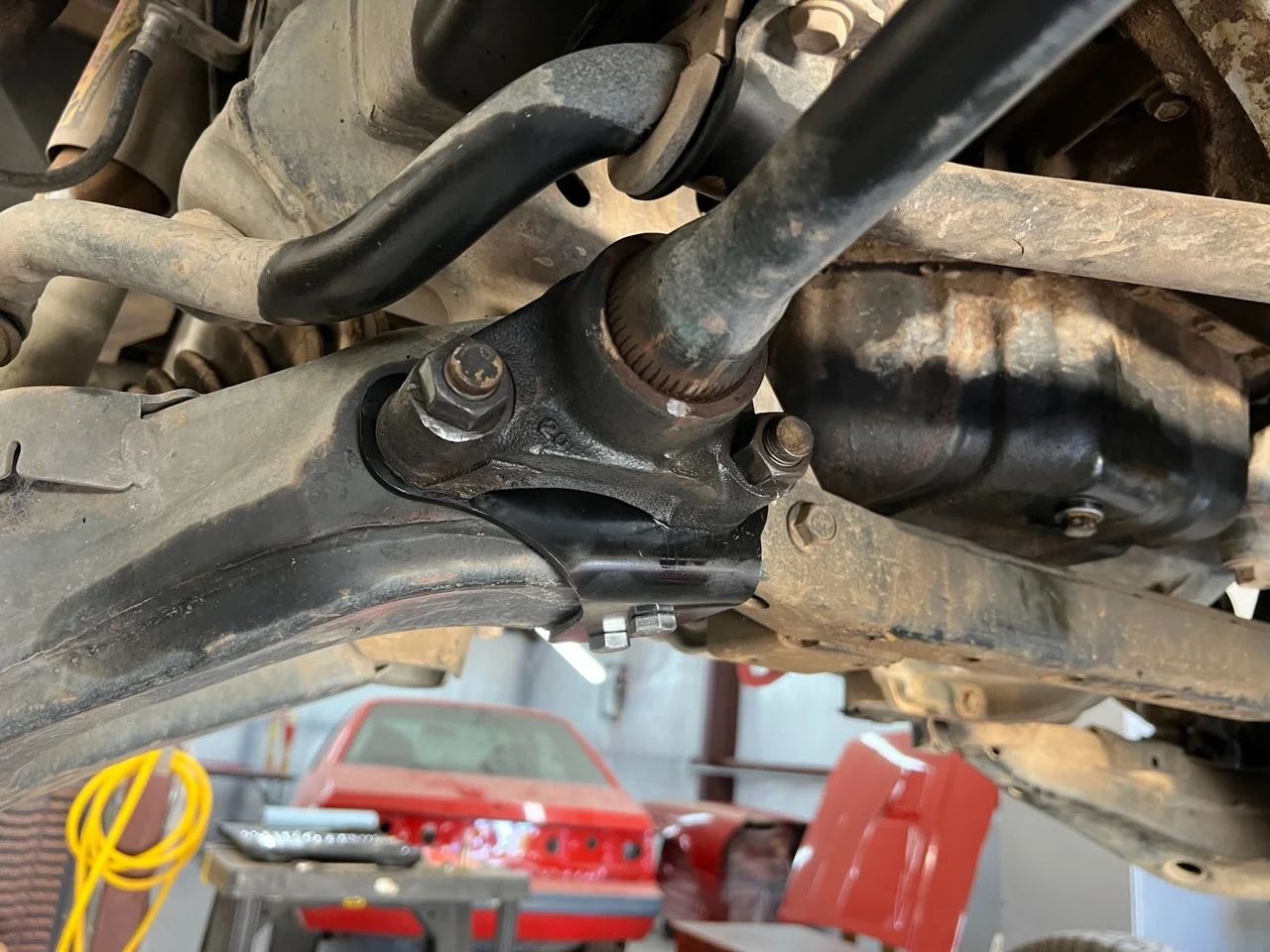

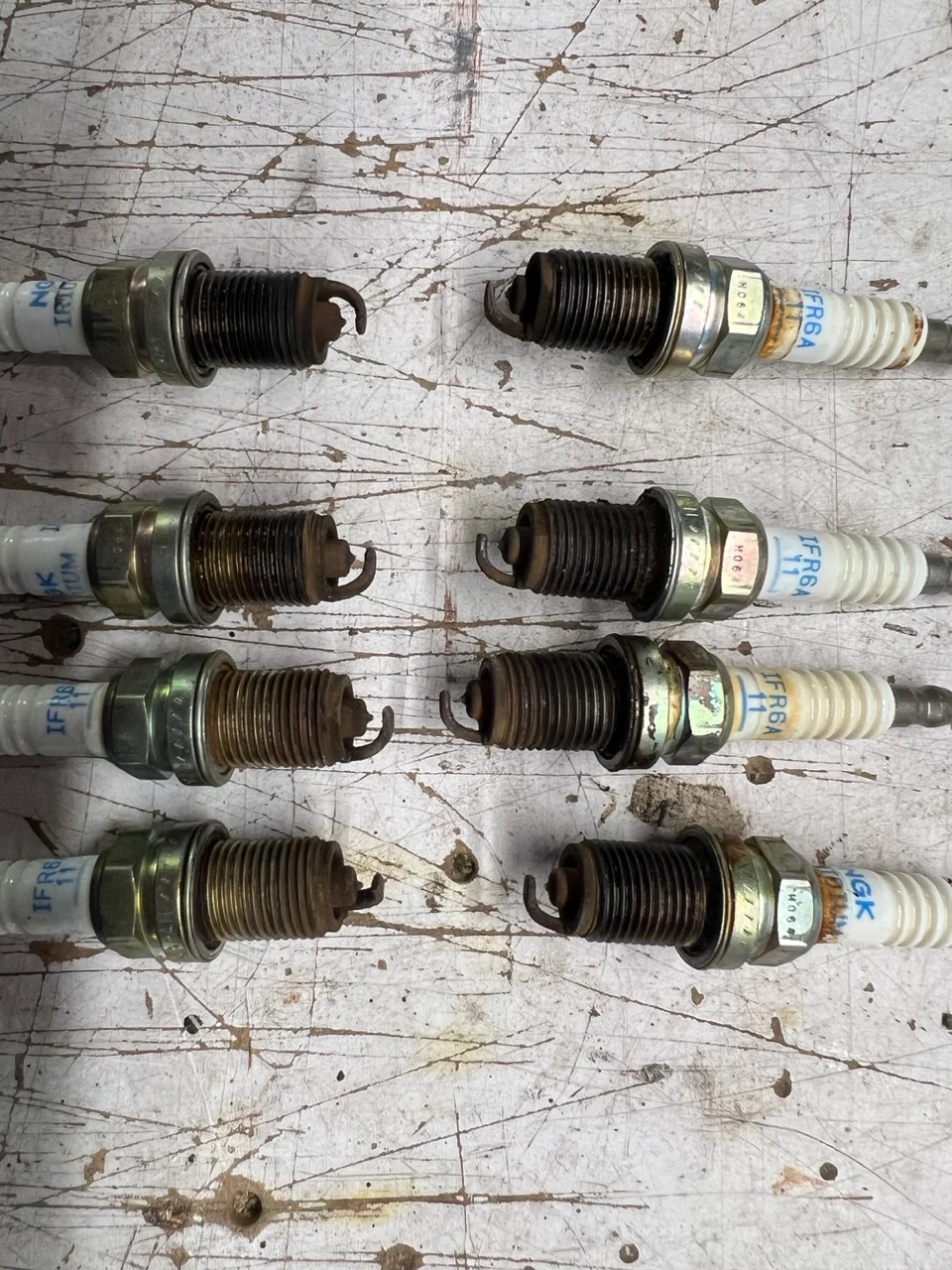

308k mile service. Changed oil, filter, greased everything, cleaned throttle body and mass airflow sensor, rotated tires. Also changed plugs with NGK. Old ones I guessed had 100k on them, but they were definitely worn out. Also installed the lower control arm torsion bar reinforcements that I’ve had sitting on the shelf for the last year. All ready for Southern Cruiser Crawl next weekend!

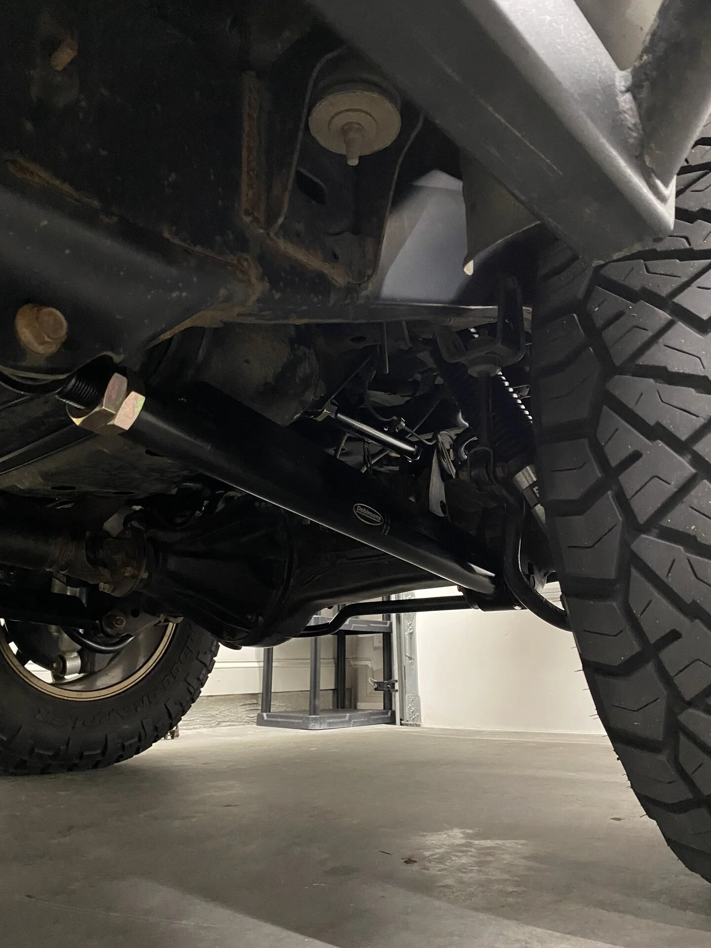

So, to do those reinforcement brackets, you had to remove the torsion bars? Or did you just remove the bolts and slide em in?
(At full droop I would imagine) How did all that go?
You’ve got to unload the torsion bars and slide them back…
The YouTube video shows an incorrect sequence of bolt installation… follow the attached instructions.
These brackets definitely beef up the LCA structure.

Forgot to say…
My kit came with 3/8” fasteners… I did not use the ungraded 3/8” SAE hardware that came in the package.
I sourced my own grade 8.8 metric hardware… 8.8 grade flanged bolts and 8.8 flanged washers... blue Loctite on the fasteners.
As others have said, you have to lift it and back out the torsion bars. The inner bolt cannot be removed, at least not with the LCAs hanging all the way down.
I have a lift, which I’m sure makes this a lot easier. Being in TX and not having any corrosion is better yet. I used a step bit which always makes the drilling easier. Also, make sure you clean and lube the adjusting bolts before you take it apart. They are fine thread and under a lot of tension. It would be easy to bind or strip the threads if they are dirty.

Got a chance to drive this morning, and the new plugs definitively put more pep in her step. I had pulled two plugs previously to check condition, and I apparently pulled the best two. Only two plugs were under .051 (max gap). The others were close to .057. I guess my intel on when they were last changed was bad.

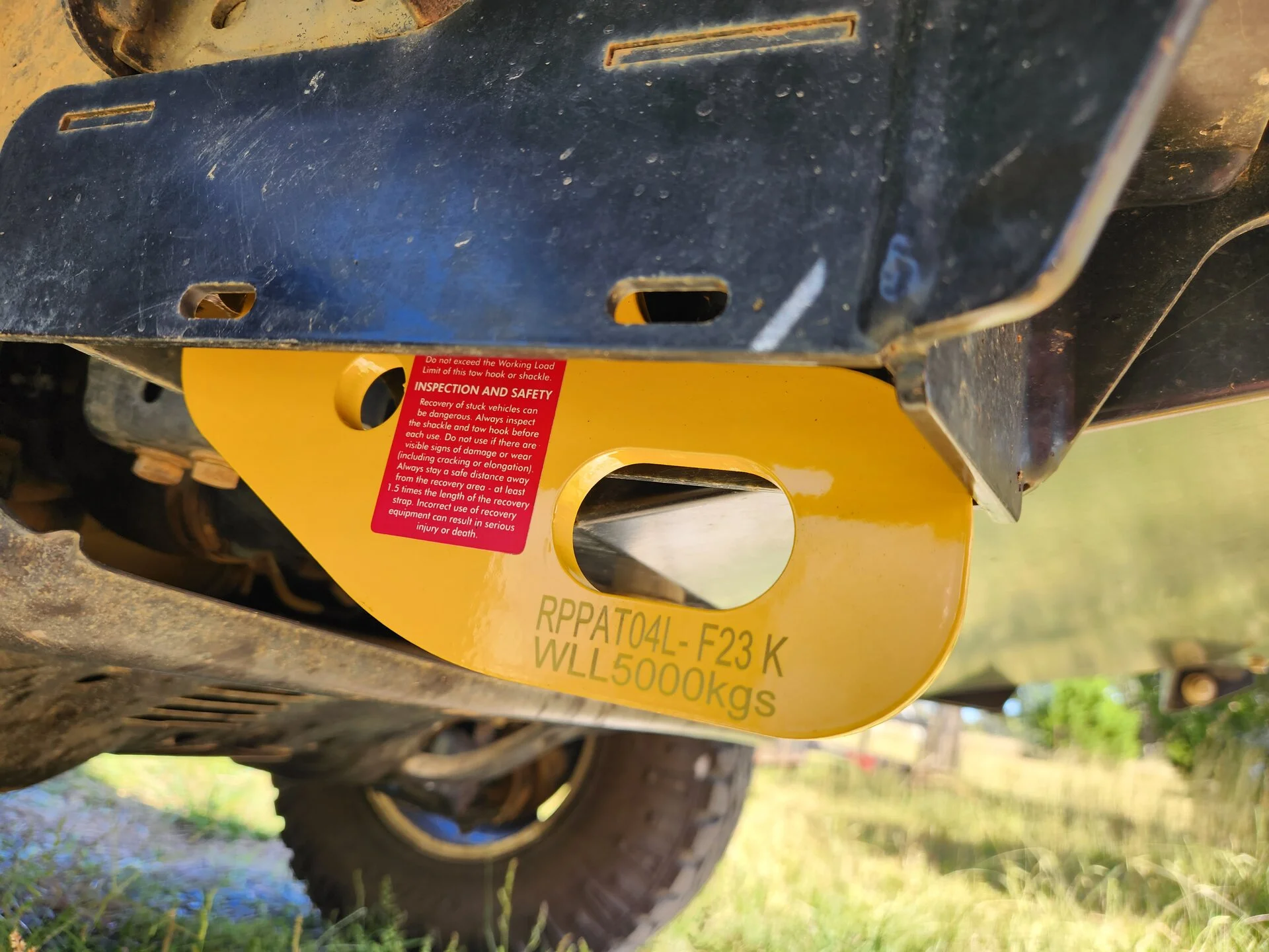

Installed Roadsafe recovery points in the front. :banana:
Fit snug, no persuasion required. Torqued to 100 ft lbs (couldn't find a good spec, so...)
