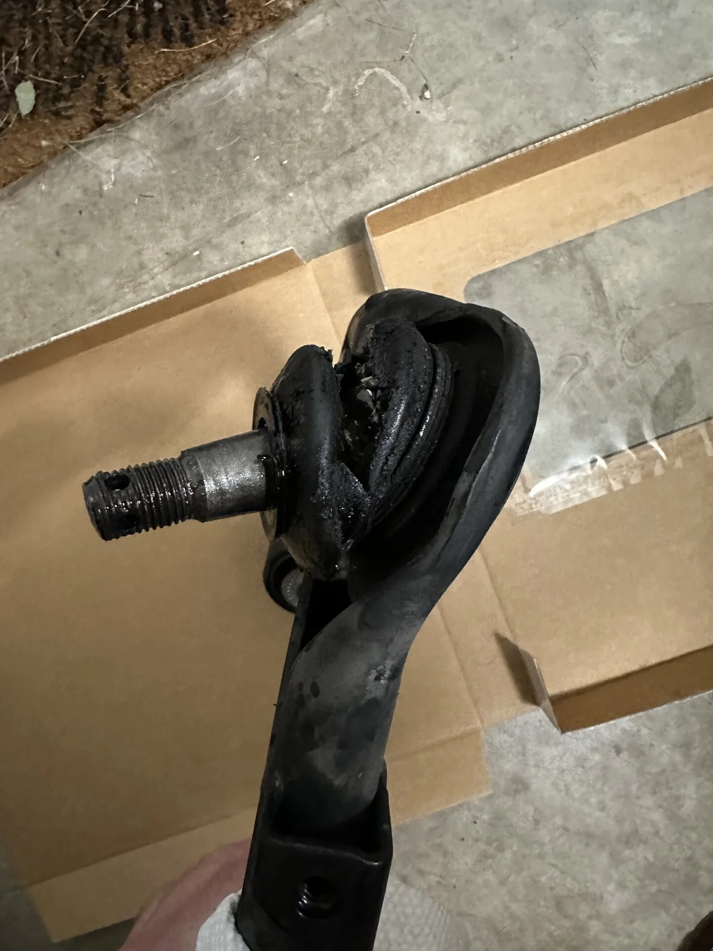

Started my front end refresh. Does anyone have a trick for popping the upper control arm ball joint loose? I watched Chows YouTube video and his method of hitting the sides is not working for mine.
Hit Harder! Serious that’s the best method if you’re keeping the UBJ. You gotta hit it real hard in some instances. Otherwise if you’re scrapping the joint just pickle fork it

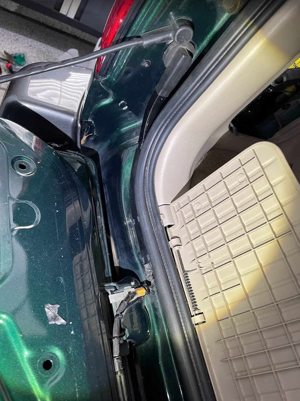

Backup camera mounted behind the license plate frame using the same bolts as the frame.
I had to drill for the backup camera, behind the license plate. I sealed the hole after routing the wire, then followed the same path as the other wiring on the driver's side. This took a long time, but keeps everything water tight.
