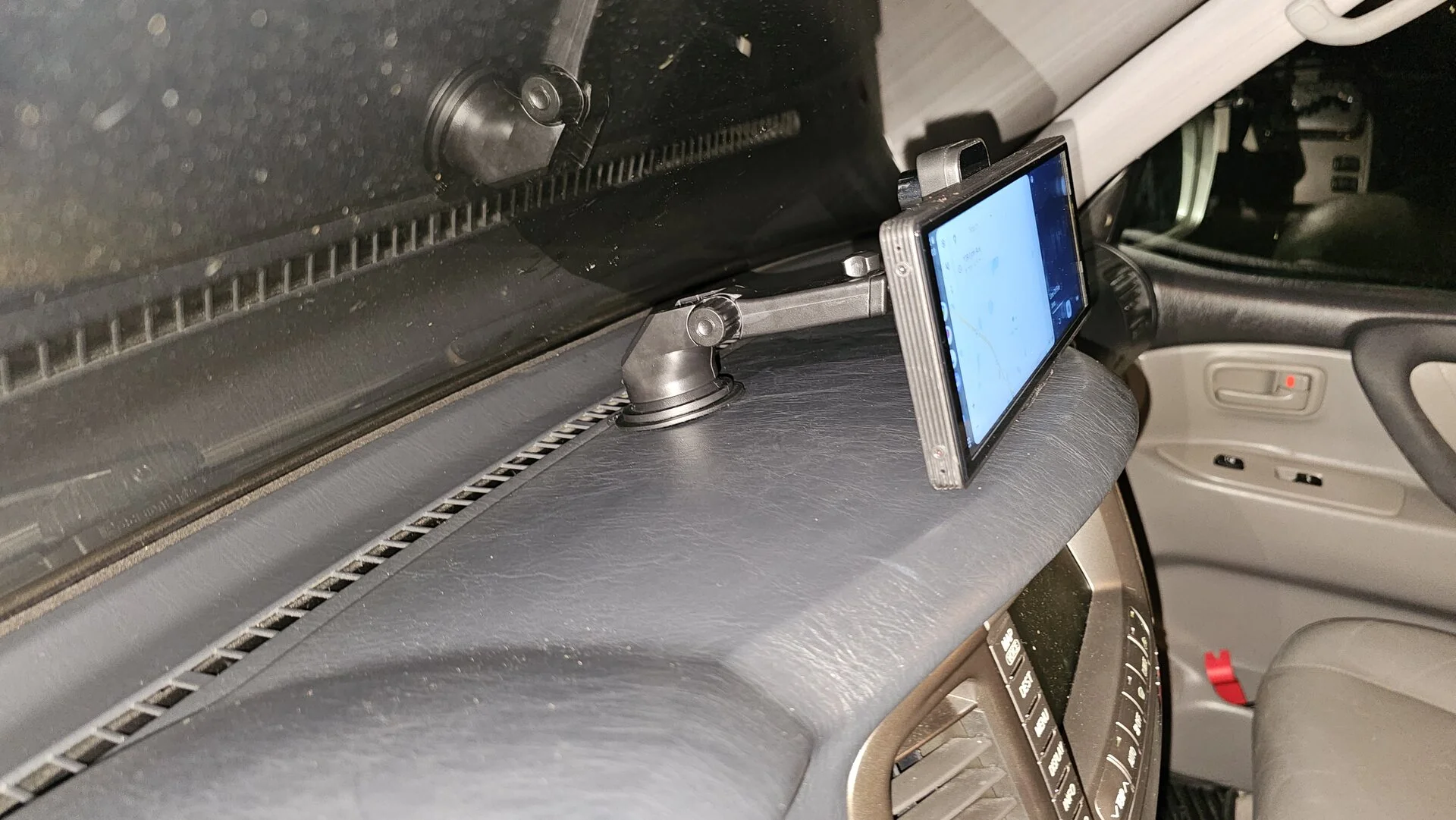

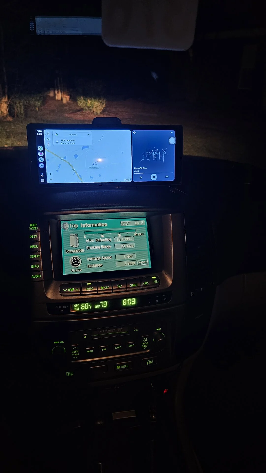

It works really well. Only problem is that my add-on Bluetooth module replaces the CD changer. Nothing wrong with that, but the Android head doesn't recognize the CD changer as an official phone module. So the music plays to the radio, but phone audio goes through the head unit. I'm working on a software fix with my phone.
