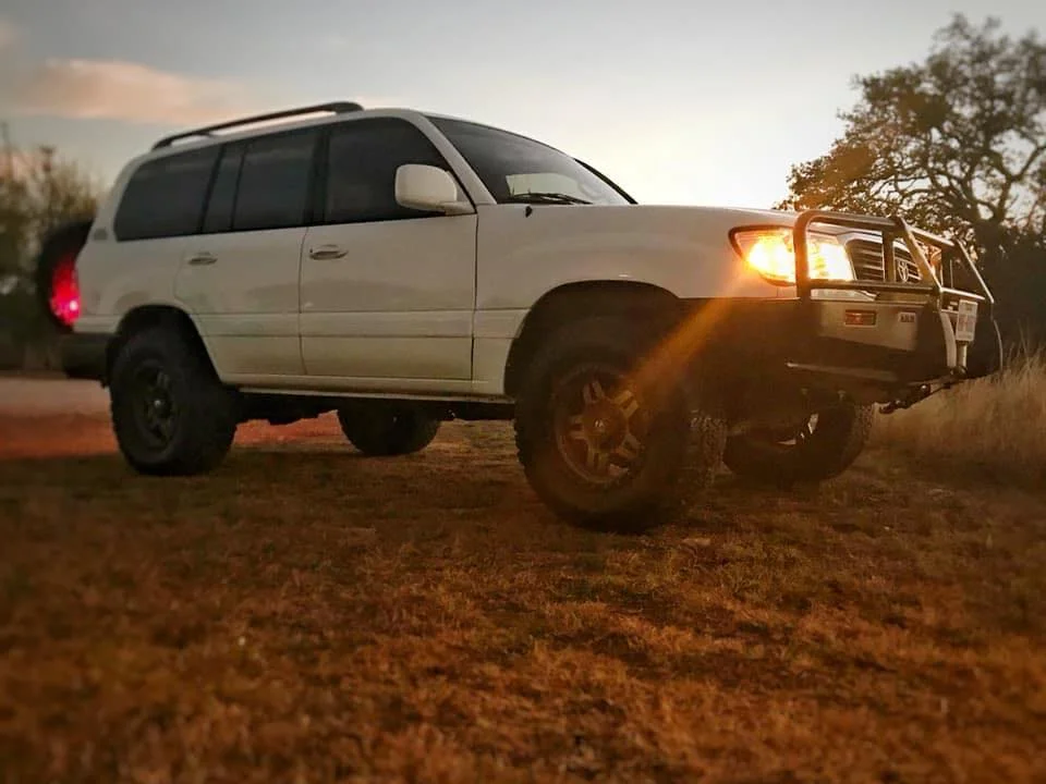

Been a busy couple of weeks for my LC 100. Last week a couple of buddies and I tackled the entire front end. We replaced the UCA's, LCA's, tie rod ends, CV assemblies, rotors and disc, and repack wheel bearings. The ball joints gave us hell, but after scoring a cheap (Harbor Freight) ball joint puller, which had to be modified we made quick work of it. Also adjusted the torsion bars to level the ride and get rid of a annoying tire rub issue. After a new alignment she drives like a new vehicle. Total labor was 6:00 hours.
This week we tackled the dreaded starter and while we were at it we decided to replace the timing belt, plugs and coil packs. The starter was a pretty straight forward process because we had pulled the fan and fan shroud on all the front covers. We were able to climb inside the engine compartment, which is way easier than leaning over a rig with a 3" lift and 35" tires. The rig only has 115,000 miles and since I bought it used I was not 100% that the timing belt, tensioners and water pump was done at the 100K mark because there was no sticker or electronic record that I could locate. Sure enough, once we opened it all up the timing belt had been changed — that was the good news. The bad news was that they had used cheap Chinese parts that were already showing wear and tear. We said screw it and replaced everything with proper OEM/Asin parts. Spent a little extra time cleaning injectors and chasing down a fuel leak — had to reseat an injector. Total labor was 9:00 hours
The IH8MUD forums and YouTube videos were a huge help. When you and your buddies do the labor you can save a ton of money. My friend Daniel Happily who owns Hill Country Cruisers (Wimberley, Texas) has great rates on labor ($50 per hour) if you want to go that route. Also, you read it all the time on IH8MUD — DON'T BUY CHEAP PARTS, STICK WITH OEM! In the long run it will have you money. Now I can start thinking about designing and building a killer roof rack— stay tuned.

I run load rating E KO2's at 285/65/18 and don't notice a "jarring" ride. I'm in an LX470 with AHC so not sure if that changes anything. since it's essentially stock versus your lift but OME is suppose to ride well. What PSI? I believe I'm around 36-38.
I imagine load range C would ride nice too, but do you experience any punctures on the trails?. I run 285 75R16 BFG KO2 in load rating E because I was told that's what I need for puncture protection. Unfortunately they make for a very jarring ride.
How much pressure are you running in your tires? I'm running the same tires on my stock LC and find the ride to be quite pleasant. I'm running 38psi.

I run 38-40 psi. My suspension is comprised of LC OEM TBs, OME 2865 springs and Tough Dog Cell foam shocks.
I feel all the cracks in road surface and expansion joints. Larger bumps and pot holes are dampened much more nicely but the small stuff all pretty much just comes through

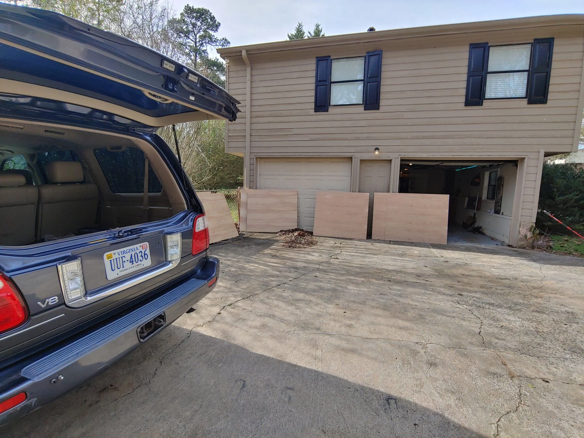

I loaded mine up with a new set of cargo drawers. Kind of...
