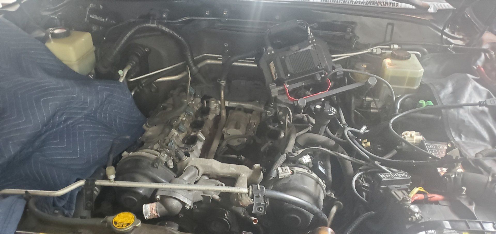

And so it begins. 2002 LX w/207k miles and it's time for the following.
Heater t's, timing belt, water pump, fan clutch, radiator, starter, gaskets, hoses, etc.
Pray for me.
Pray for me.
Dude, you got this. You will find everything you need in mud. I bought mine and committed to do all work myself from day 1. Did T Belt with just about every hose, belt, and spinning things, cam and crank seals done while I was in there. Also tackled heater T's and all hoses. And much more. Justified buying tools to do those jobs with all the money I save doing it myself, and was still ahead of the cost of dealer/mechanic. Took my time doing it as carefully and accurately as possible, which no (or almost no) mechanic will do. Maybe tough, or frustrating along the way, but WELL within the average person's abilities. Good luck!

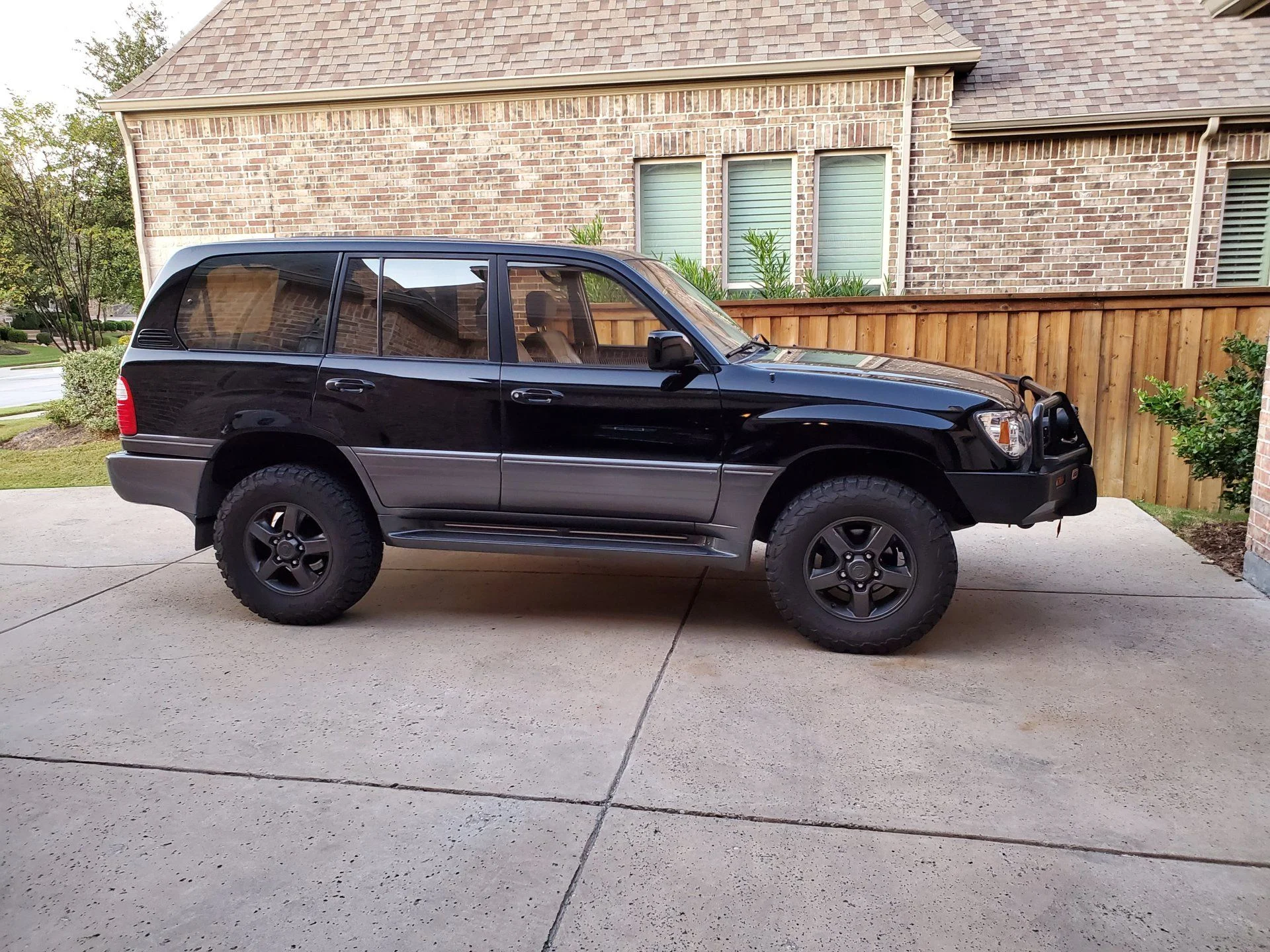

Today i'll be stepping down a tire size, and switching brands as well. Currently running 305/65/18 BFG KO2s, i'll be switching to 275/70/18 Wrangler Duratracs.
The Duratracs weight 9lbs less per tire, is thinner so i'll get back some of that MPG and acceleration. I love that size KO2 but when i stuffed it, it rubbed a little plus they felt so heavy. With 275s and +30mm wheel offset, it should stuff without any issue, i hope.
275/70/18 is the popular tire size as you know. They don't feel heavy at all on my truck with the KO2s.

This is my 3rd go around with the timing belt job on these 4.7L behemoths. I understand the punishment I have been assigned :)
I will say that the starter replacement is a pain in the ass.

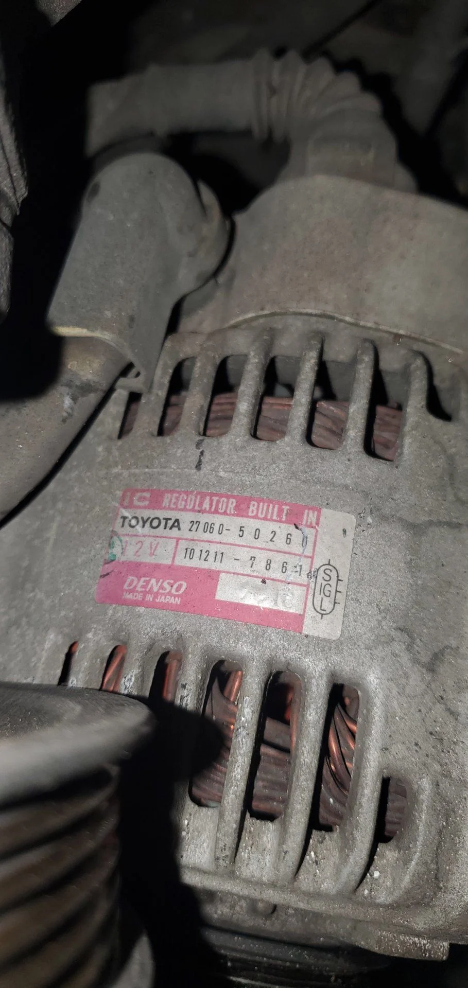

Question: I can't find in my records that the alternator has been replaced. With full blown " while you're in there" raging I'm trying to figure out how old it is. Is the date stamped in the silver part of the tag on the bottom of the label? If so I think it reads 2016???

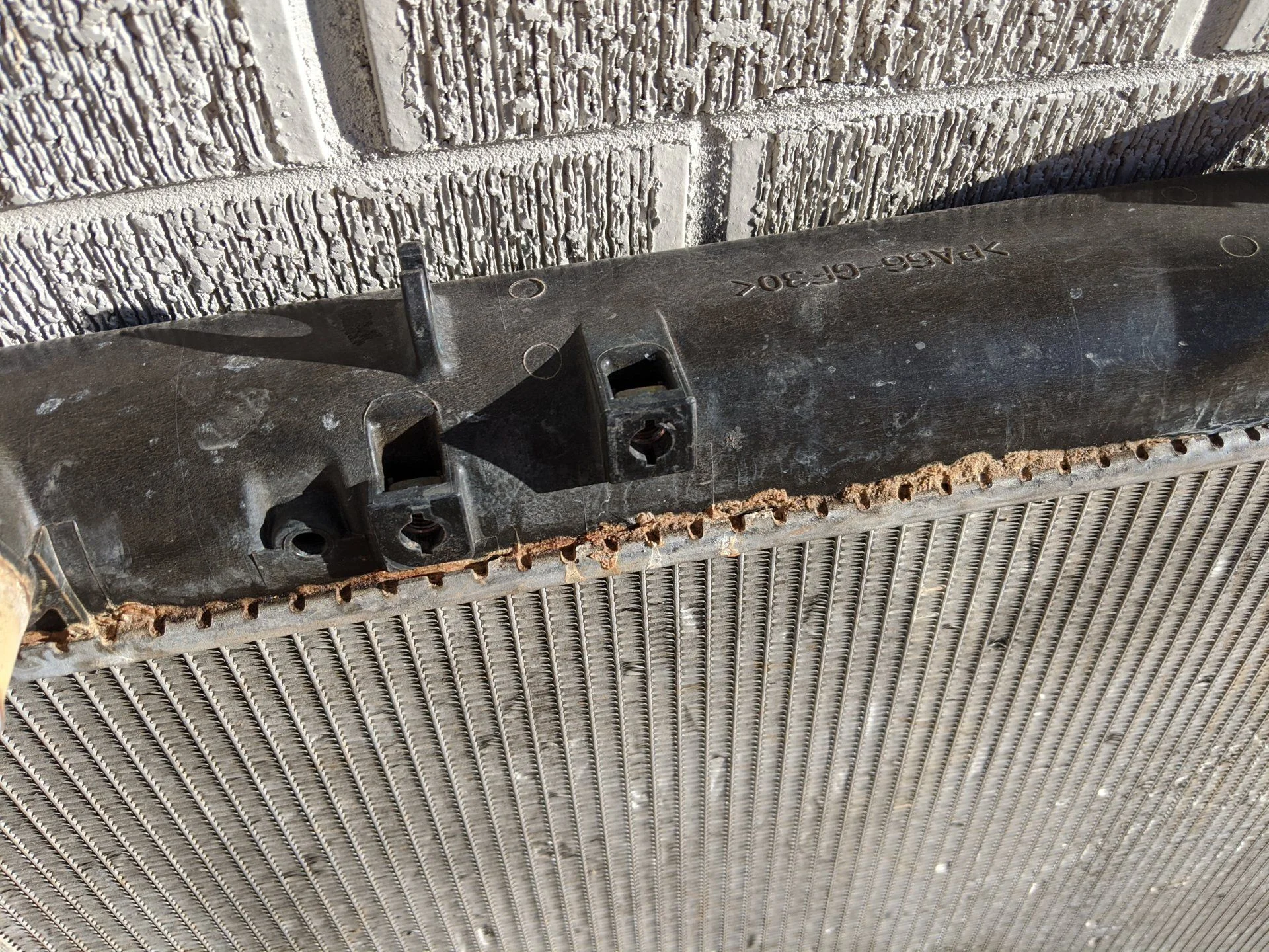

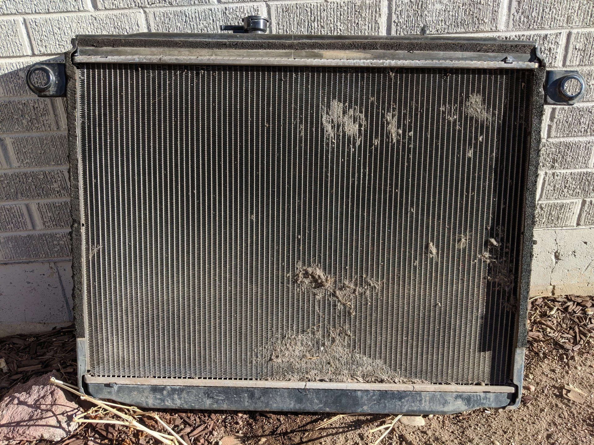

This is more of a what have you done over the last month post...but had the time before starting a new job to get some big items checked off.
-Switched from 275 70 18 to 295 75 16 (ko2s). This is the biggest size I would want to go without a regear. Truck sees a lot of highway miles at high elevation and it frequently drops down to 4th, even on the flats.
-Painted 16" LX wheels in a gunmetal color (could have done a better job here, but was in a rush)
-Installed 2x KC Pro6 sae driving lights (didnt love the beam pattern at first, but they actually work pretty well in practice considering they are street legal. I've been treating them as high beams.)
-Installed switch for lights in BenCC's make 6 with 2x powered usb's (wired directly to battery with on/off power switch). Love the location as it's easy to find quickly by feel.
-Replaced Rad, hoses, thermostat, and flushed system. Used CSF rad as recommend, purchased locally from Advanced Auto.
