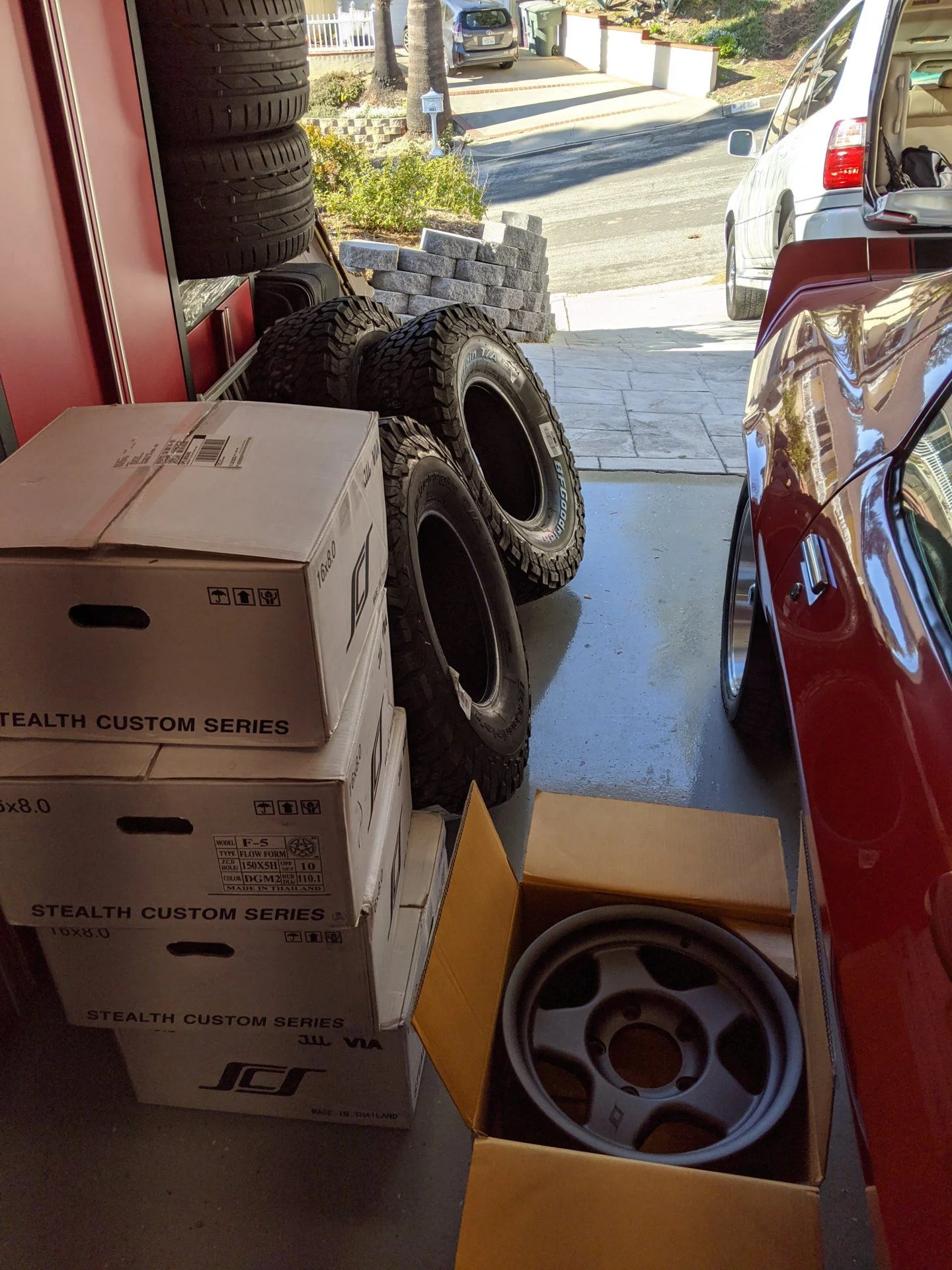

@MongooseGA, @ERMB and @ClassyJalopy, thanks for the feedback guys. I am currently on 265/75/16 with OEM wheels. Since I took ownership of my '98 LC a little over a year ago I have put ~$5-6K into it replacing all major suspension and engine components, it's basically a new rig (mechanically). I have FOX 2.0 shocks F/R and 30mm rear spacers. I have adjusted TB to give me about 1 1/2" rake and around 2-2 1/2" droop. The ride is great. I do feel some of the cracks and things in the road, but it's not too bad. Maybe I'm just used to it. I just picked up some 18" Tundra wheels that will be going on with 275/70/18 BFG KO2's and MetalTech adjustable rear upper and lower control arms and some 50mm rear spacers with a TB reindex. I'll leave the FOX shocks on with this setup and see how it turns out then go from there. I do have slight body roll and a little road wander, I'm hoping the new rear control arms with help with this.

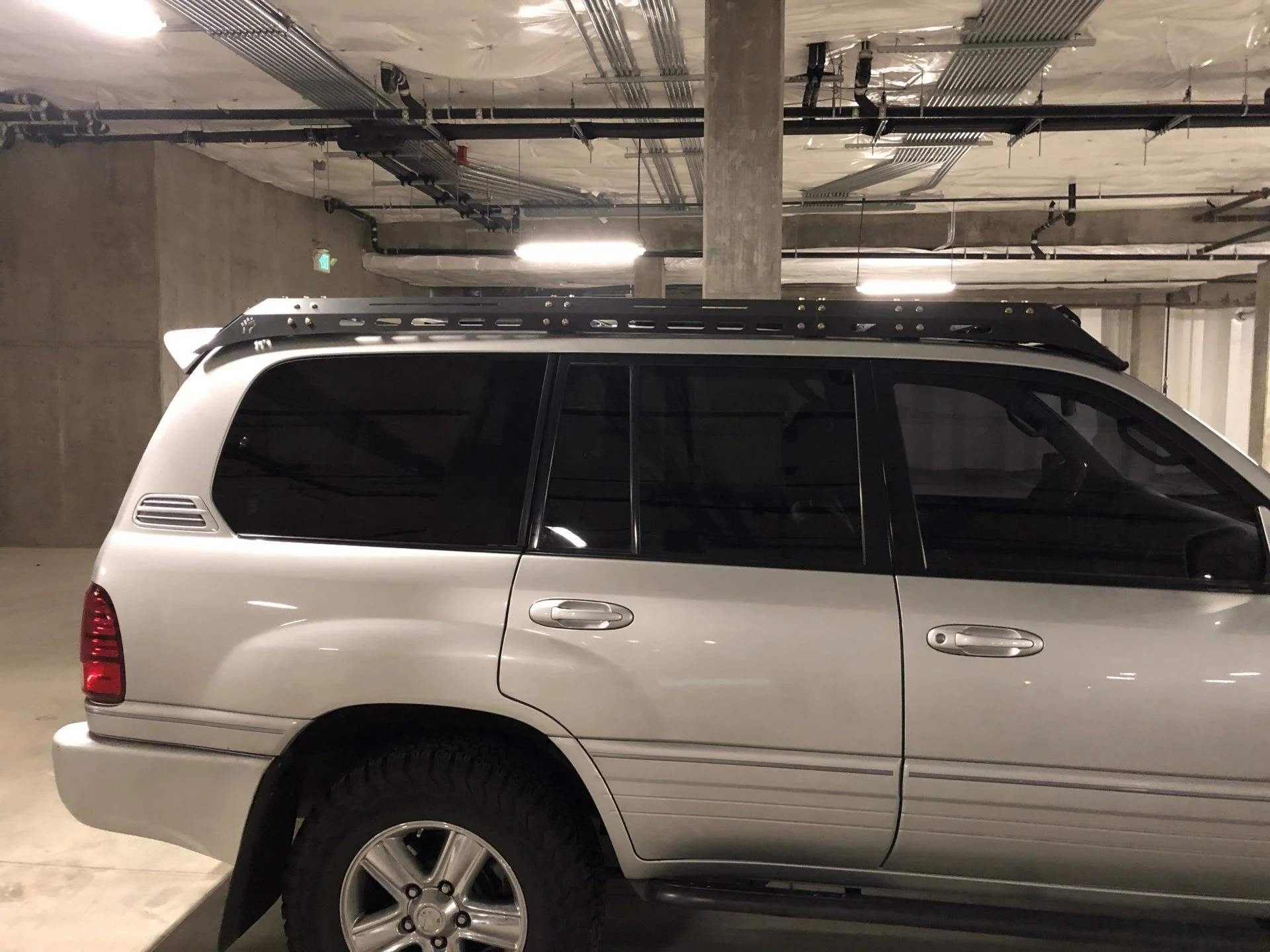

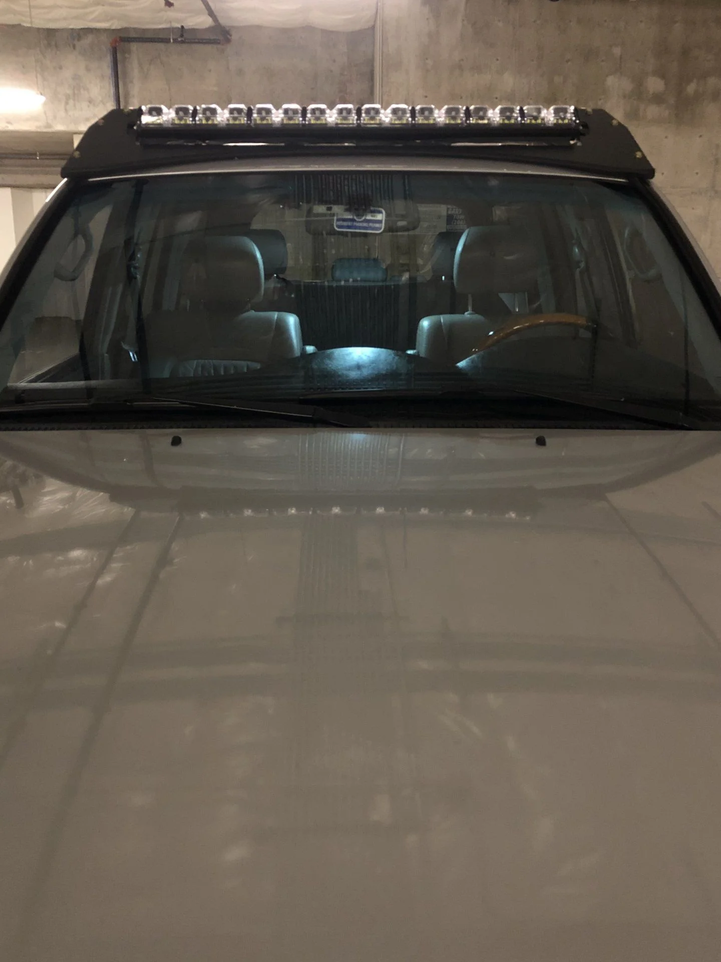

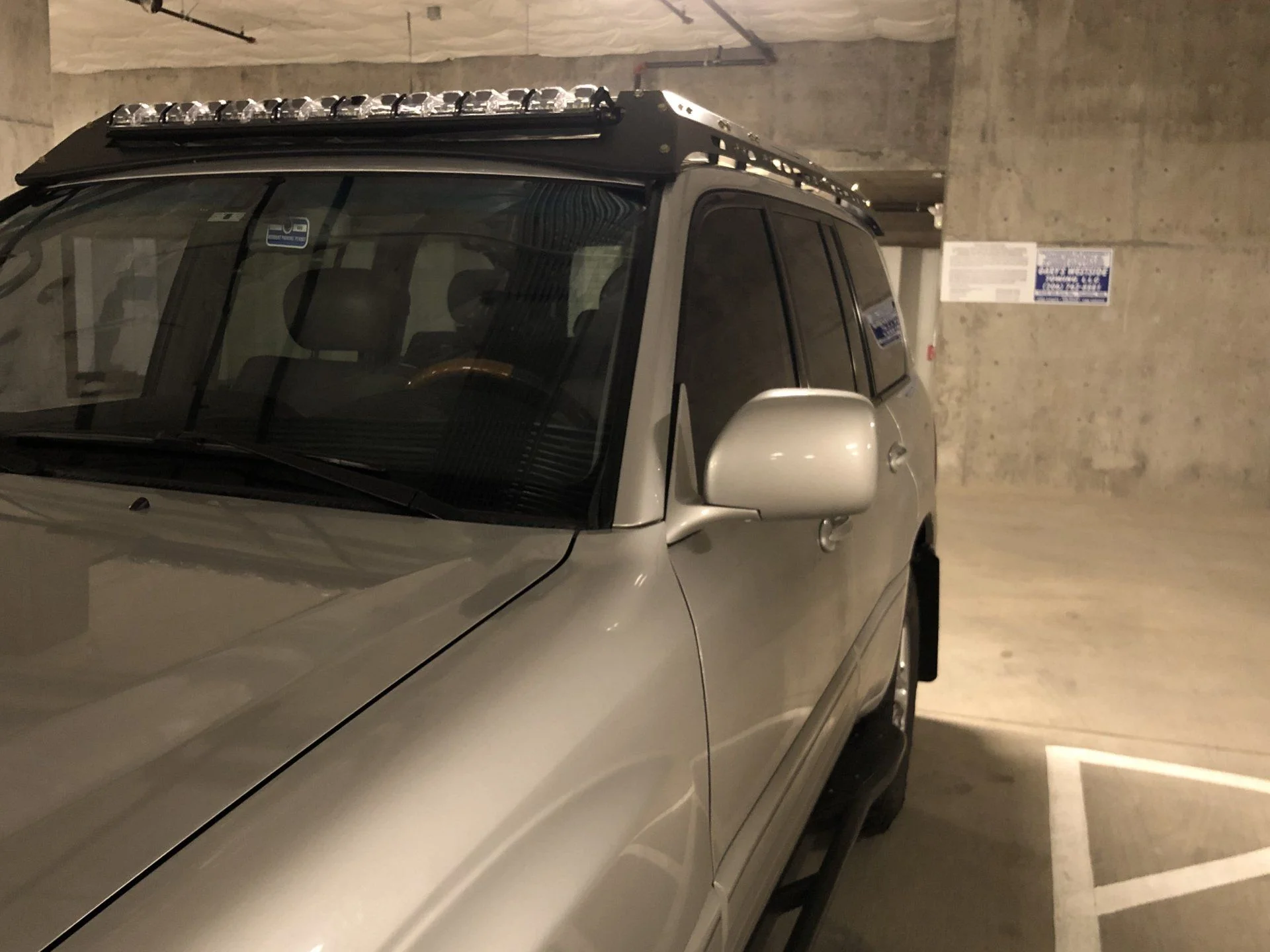

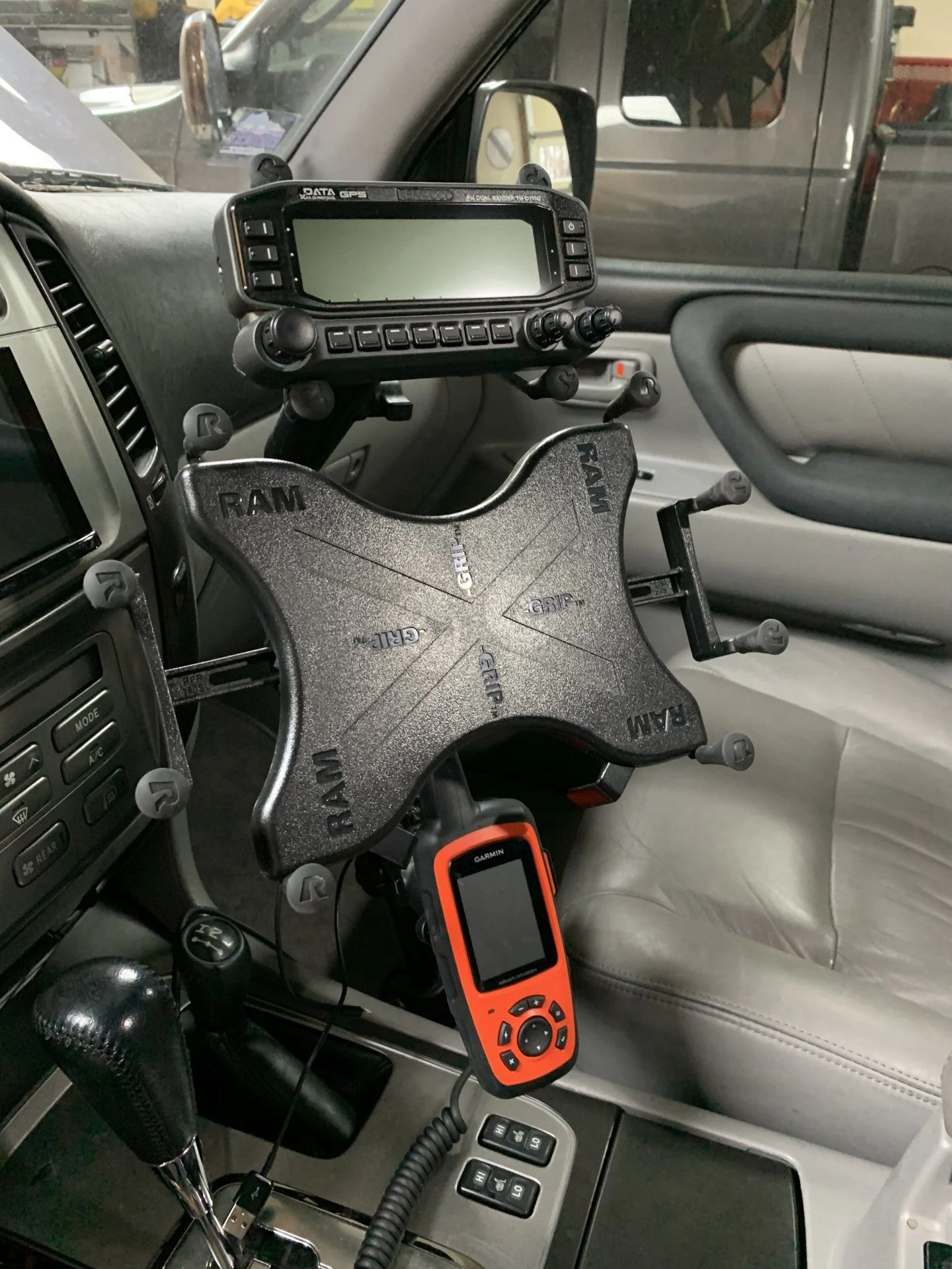

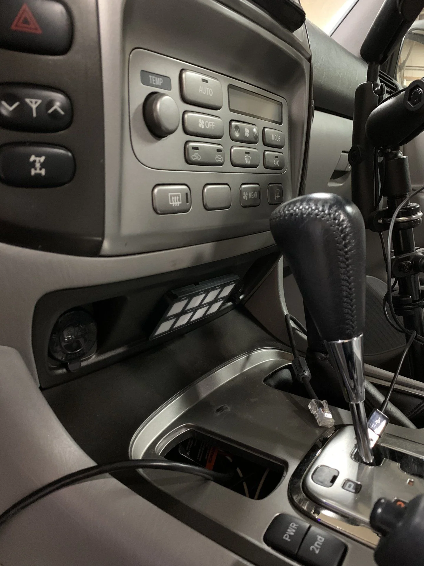

Installed a Dissent roof rack and. Cobra CB radio.

I have run these tires with OEM shocks and with the TD ones. Toyota shocks were ok - pretty decent at highway speeds but TD are way better! I have yet to try them off road but they tend to soak up rough stuff a LOT better than Tokico ones.
I am convinced that the E-rated tires are to be blamed for the small cracks (just as @MongooseGA mentioned it). I have been searching CL and FB for a wheelset with Michelin LTX tires for a while. I think they will eliminate the harshness I experience in city/hwy driving and I will keep my KO2s for rougher stuff.
Or perhaps, I can just find KO2s in D range load rating and use them for all around?
Just upgraded to 270 75 18 KO2s this week from 275 60 18 Michelin Defender LTX, which were on my LX from the PO, and the ride quality is significantly worse. KO2s are far better for the snow and mountain driving I’m doing, but the noise and jarring ride with take some getting used to.

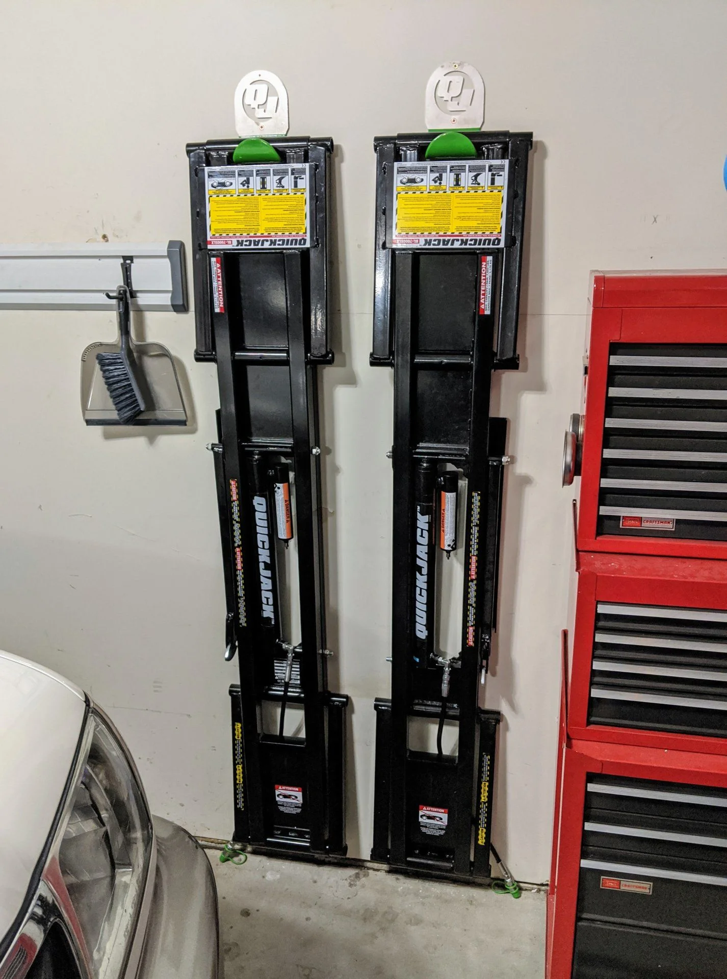

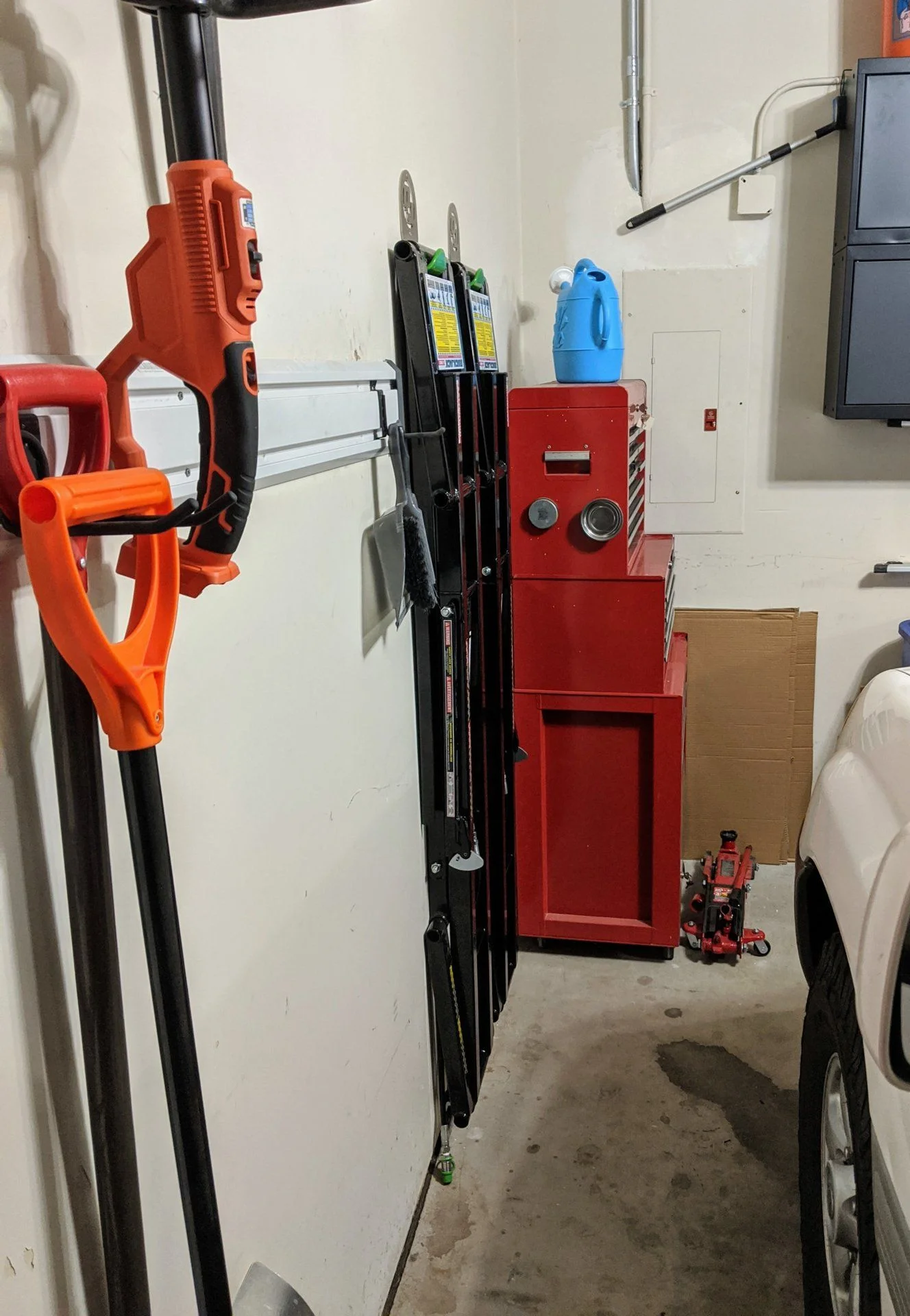

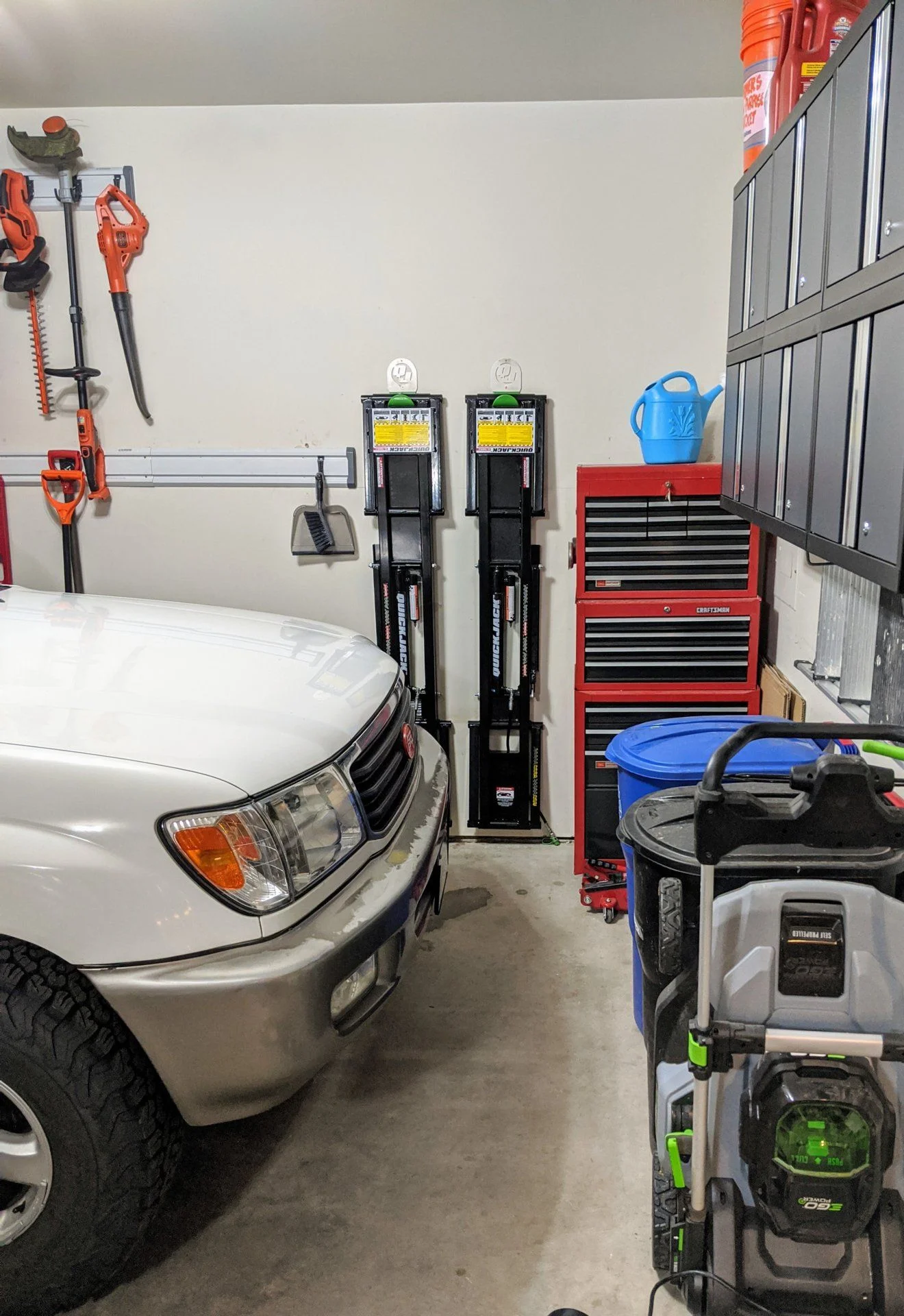

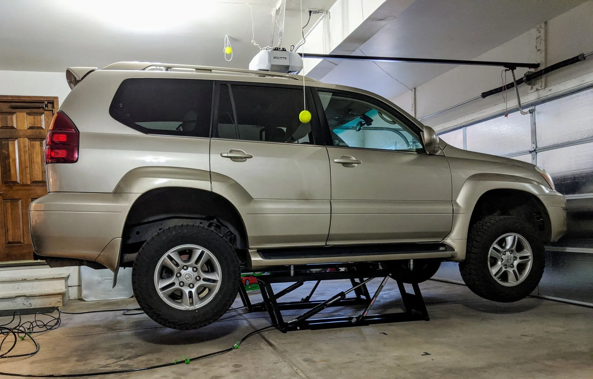

Is this the same as the one in costco? The one I saw had a 5k lb capacity. Not sure about the gx but the 100 series weighs more than 5k.
I got the 7000 pound version directly from QuickJack.
They had a holiday sale plus you get $100 off for signing up for their mailing list. Paid $1550 (instead of the normal $1850) for the QuickJack, SUV/truck adapters, and wall hangers.
