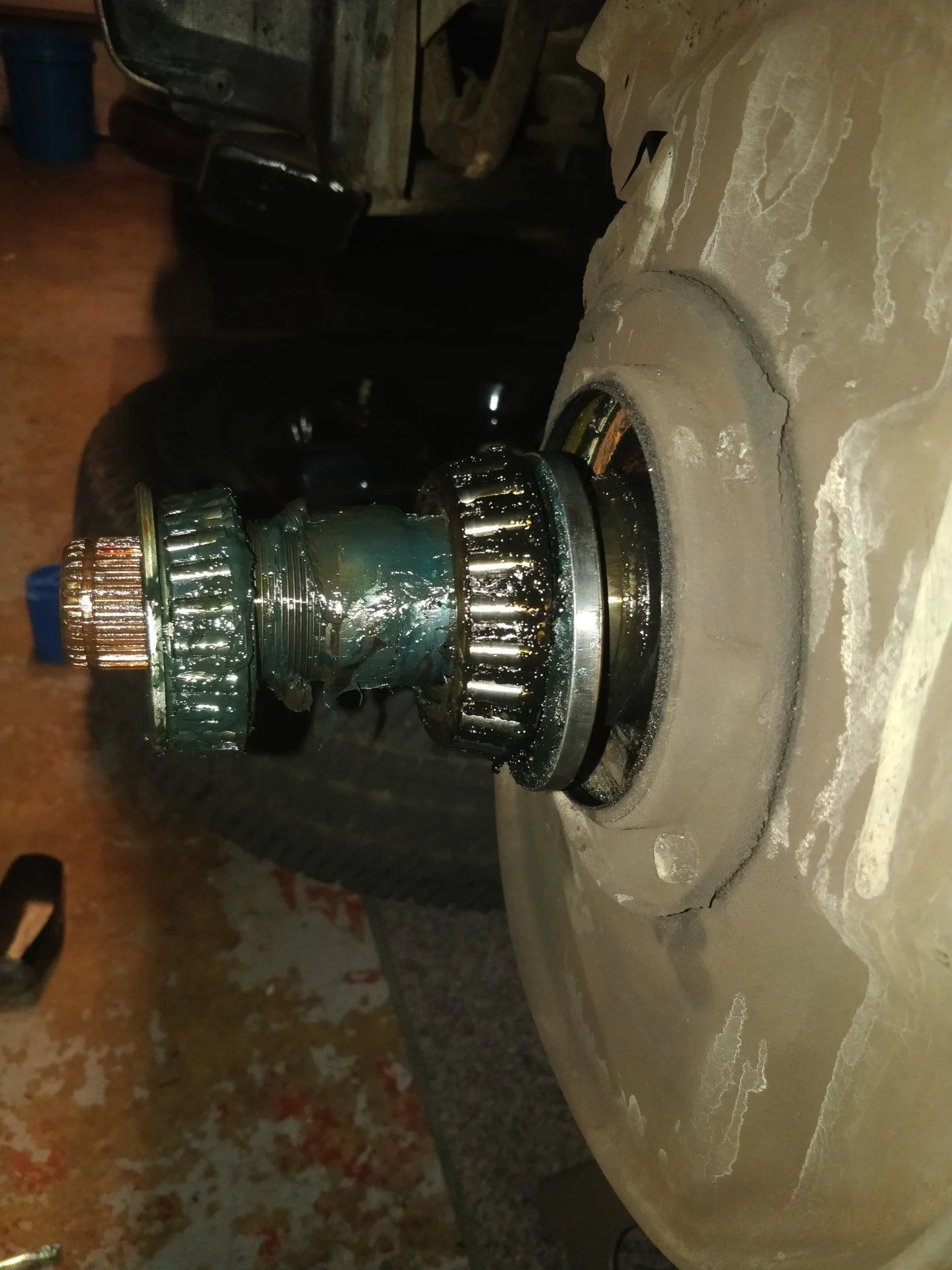

Repacking my 🐻ings and installing dba rotors in front, centric rotors in back. Oem pads all around. This is my first time working old school bearings that are serviceable. I cleaned out the hub and bearings and packed 1/2-2/3 of a can of mobil 1 synthetic grease in both the bearings and hub. I figured id set the preload on the one side i did and then start the other side while i wait for hub flange gaskets to arrive.
Whellppp.... Something didnt feel right. When turning i felt resistance in a section of each turn... Initially I thought that ive packed too much grease in there and had an air pocket or something. But after wasting 30min loosening and tightening whilst turning... I decided to unmount it and inspect. Good thing i did. Picture explains it all. Looks like new front end bearings are in order. About to be 'on' order.(hopefully from kurt from cruiser outfit @cruiseroutfit )
No idea what i did wrong. These bearings were fine as i was packing them.
Edit: ordered new bearings and they got to me lightning quick. (Ordered from @cruiseroutfit monday morning and my package arrived in the bay area on Wednesday morning) After tapping in the new bearing races i know for sure that i had my outer bearing backwards when i popped the outer bearings race when seating/tightening. Good learning experience minus the frustration/time/money though.
Wait what..? Roller bearings don't just pop out of their races that easily, I don't even understand how that could happened. Might be something worth talking to Kurt about to avoid doing whatever it is you did on the next service.

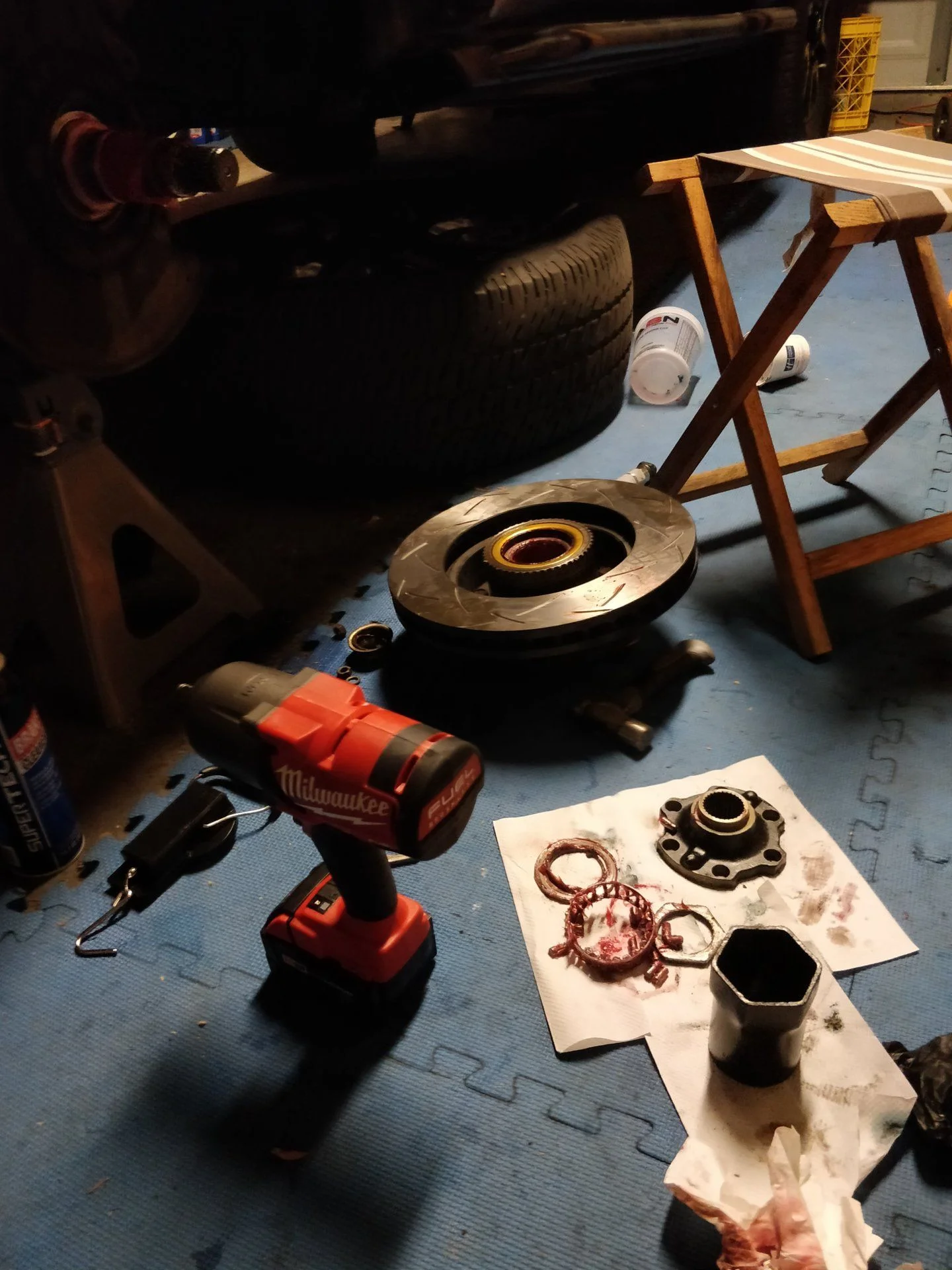

i JUST disassembled the other side before reinstalling the bearings to ensure i didnt flip them 180° and make sure my rear seal was correctly orientated. I know i did something wrong but cant put my finger on it. Reguardless--new bearings for me should last another 200k. And learning as i go. The only thing that i think i could of done is install them 180° flipped from where they were supposed to be orientated. (And its taking alot of man-card surrendering to say that... Im a aircraft mechanic for goodness sakes. Why am i striking out on automotive hurdles). To my defense i was buzzed while wrenching.
Edit... To be clear. I dont think i actually had them 180°flipped to cause it... I am 'almost' positive i double checked... But with slight intoxication and the fact its my first time wrenching the job... Im saying its a possibility.
Attaching a picture of the other side im about to start working to show you the orientation i assembled them in.

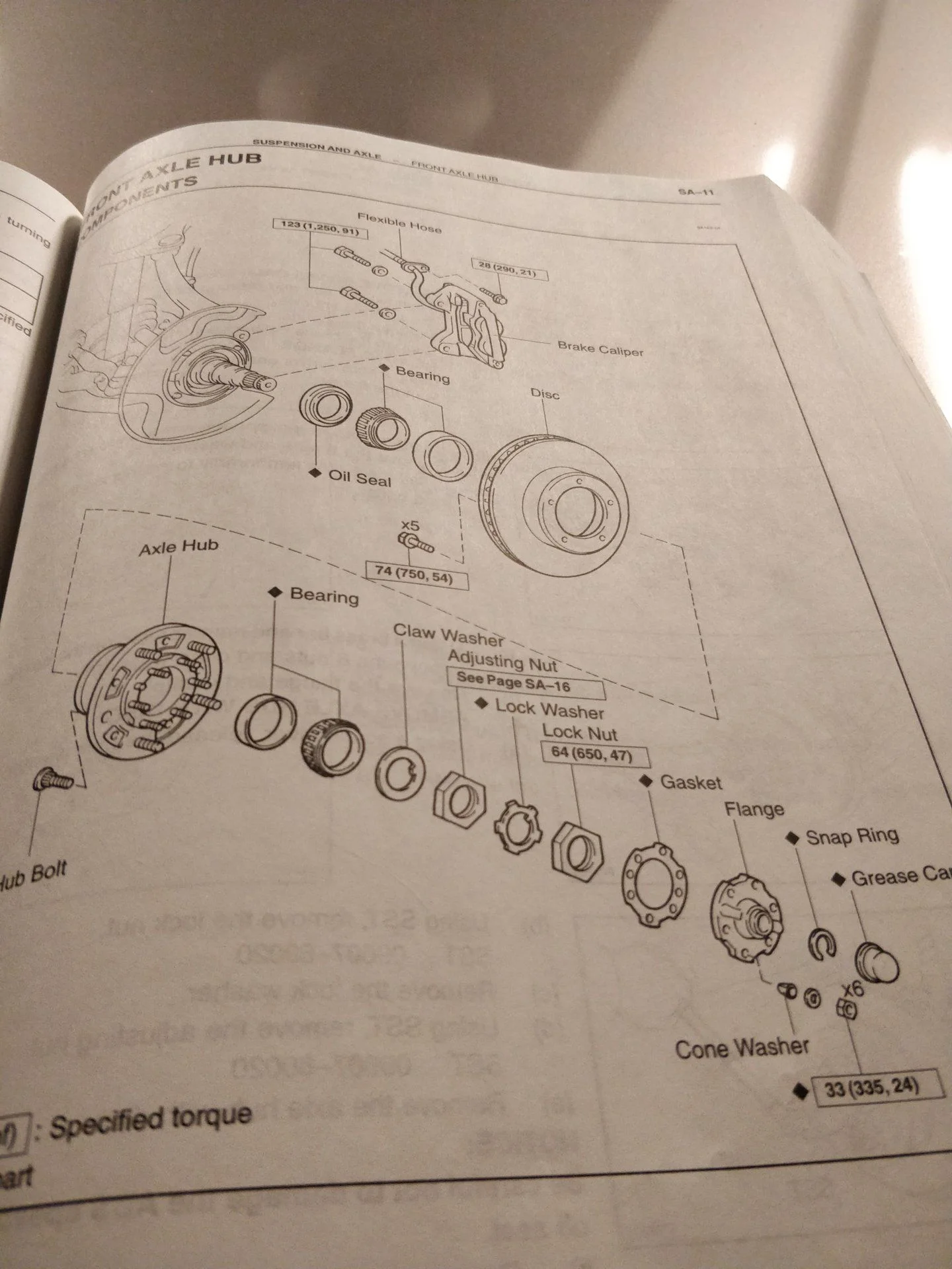

I bet i am suppost to have the outer bearing 180° from the way it is or something. Pg sa-11 on the fsm is definitely clear on the inner bearing. But for dummys like me, convoluted in the attached picture. Idk. Ill figure it out when the new bearings arrive and after reviewing some homework from 2001lc's threads on this service.
That looks correct from what I can see when I did mine a few weeks ago. Follow these (2) videos step by step (you might need to reference one another - I feel like one or the other missed a step that the other did cover) and you should be golden.
Ive been following those videos, (great resources along with 2001lc's posts) but at this point i think i overlooked something simple. If i figure it out my mistake ill post it up.

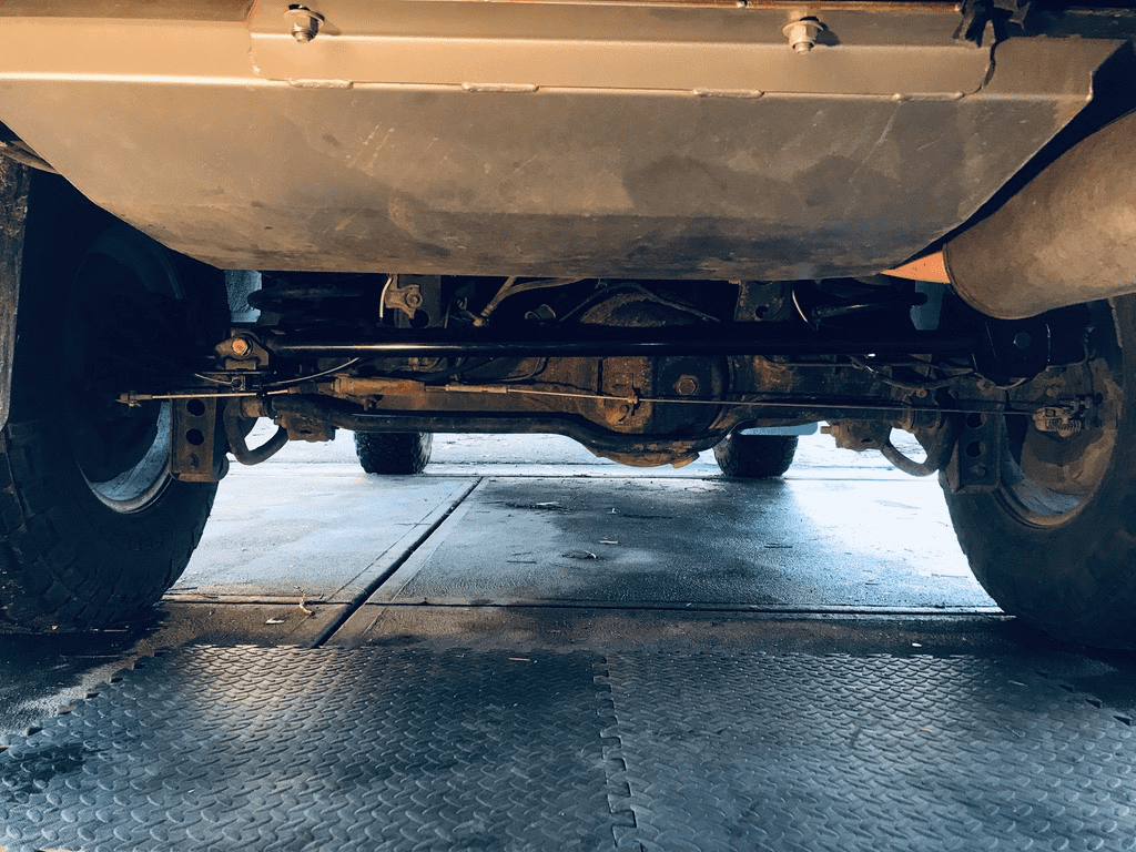

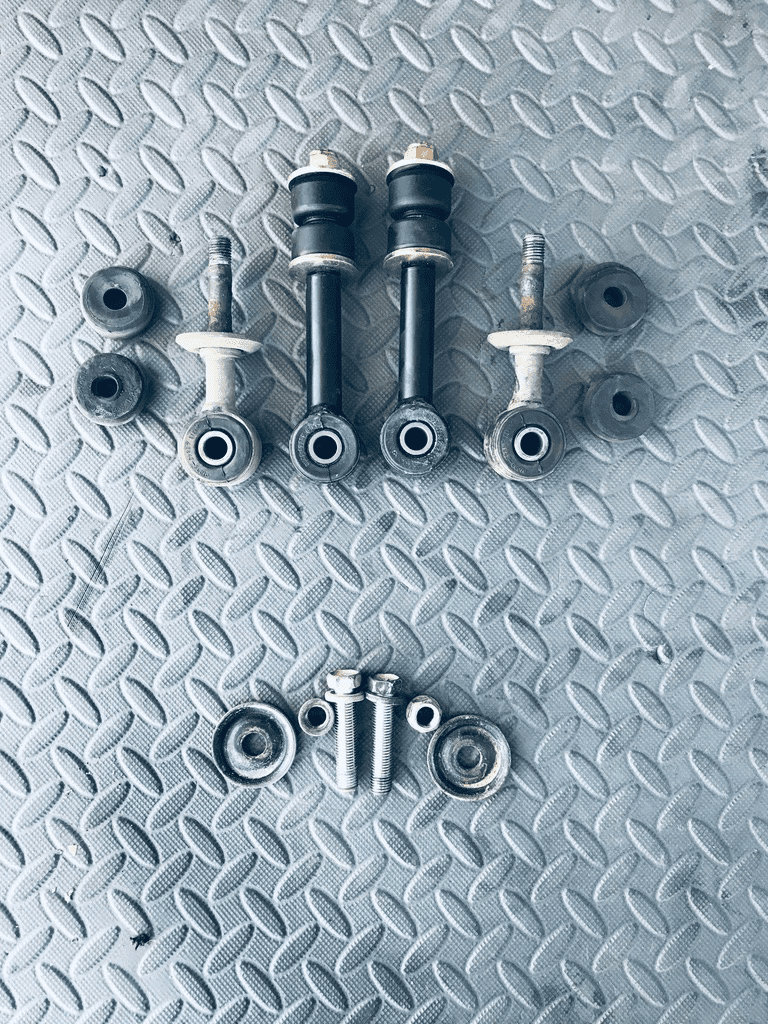

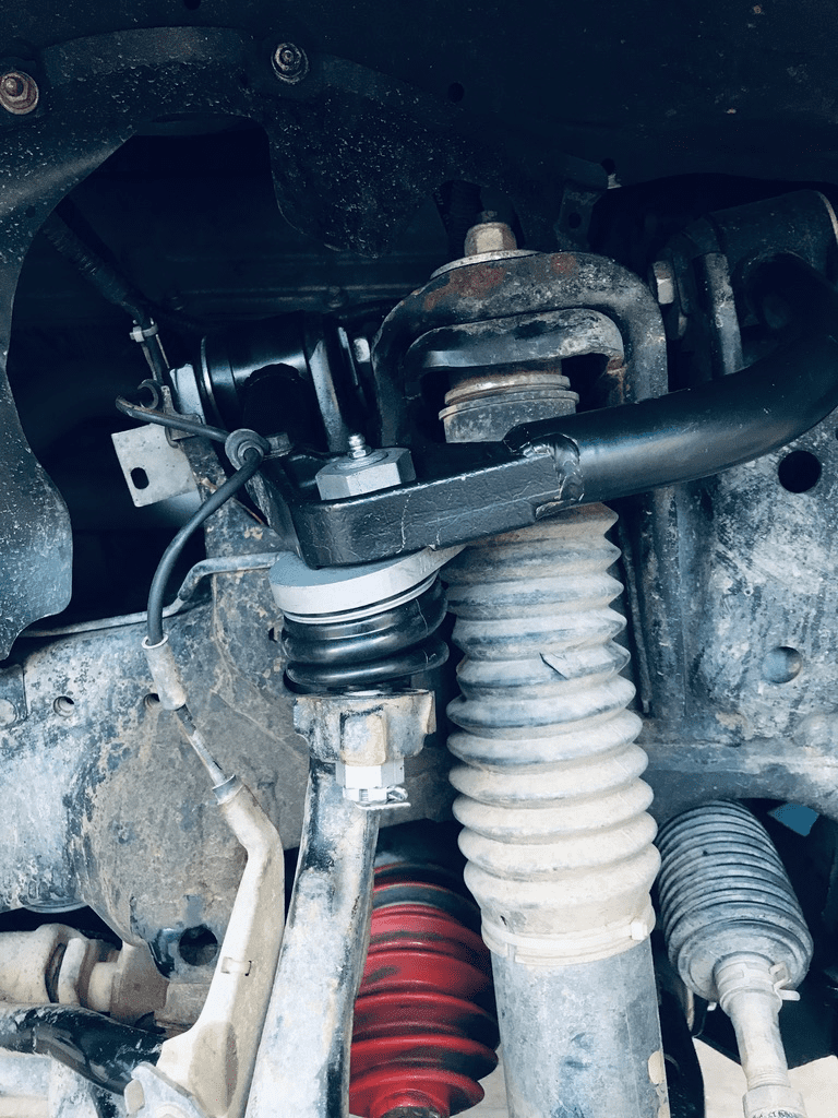

Ordered a @pfran42 light kit to put in next weekend, put in new headlight bulbs (one low beam looked FACTORY and I'm at 204k!!!!) reclamped a power steering line, greased zerks for a little clunk in drive shaft, cleaned interior after these 2 mongrels got it dirty, checked heater T's and did some general tightening, removed the broken foot pieces from where my rear spoiler used to be, started a list of suspension upgrade/refurbishments, hauled kids all over creation.........love this truck.

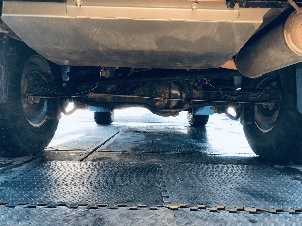

More Alcan 5000 prep:
  • Replaced bad SPC ball joints with their new ball joint kit
  • Installed the Delta Systems panhard drop I got at HIH.
    • Dropped 3" - nearly level now
    • Once loaded with gear and 50gallons of gas it'll be level
  • Replaced front sway links with Trail Tailors extended version
View attachment 2141386View attachment 2141387
View attachment 2141388View attachment 2141389
Besides the obious "it's level now", what benefit is there to the panhard drop? As in, in actual effect? That'll be the last piece of my complete suspension not replaced, wondering if it should be done.
For starters, on a suspension lifted truck, the rear suspension won't have the tendency to load/unload left-right when going over bumps. That was the first thing I noticed and I didn't like after raised the suspension on mine years ago. I'd like to add this panhard drop kit too!
Besides the obvious "it's level now", what benefit is there to the panhard drop? As in, in actual effect? That'll be the last piece of my complete suspension not replaced, wondering if it should be done.
Taken directly from DVS's 80 series panhard lift and edited, "This drop bracket levels out your panhard bar after you have done a lift to prevent the typical wandering of the backend. It is common after a lift in the Land Cruiser to get a ‘darting back and forth’ movement that makes you constantly correct your steering as you drive. The panhard drop bracket fixes this problem by re-aligning the panhard bar to its factory configuration."
I only have a few miles on it and I can say the rear end sway is much better over uneven surfaces - like crossing grooved lanes at speed!
