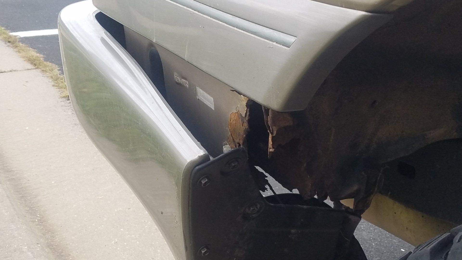

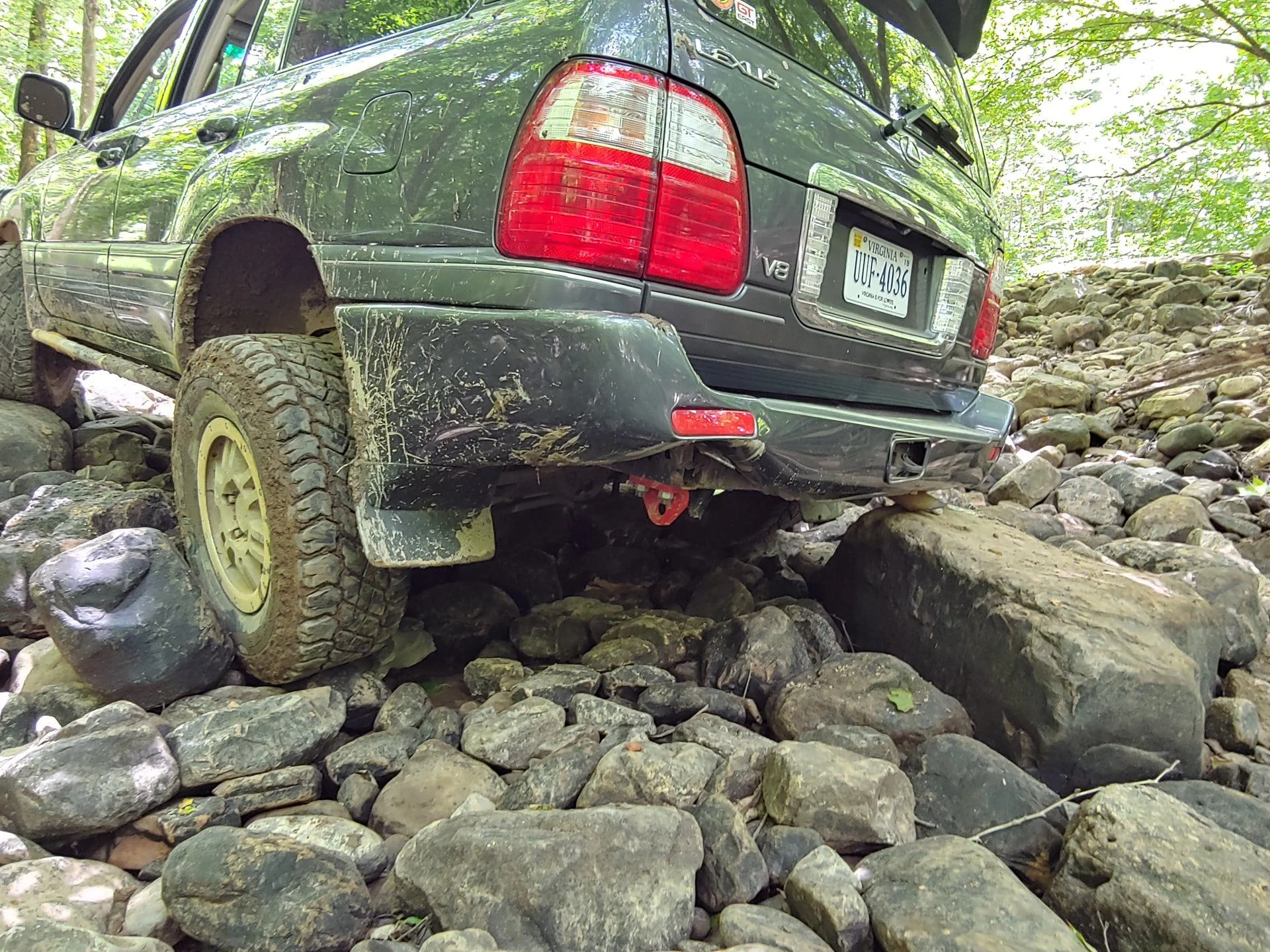

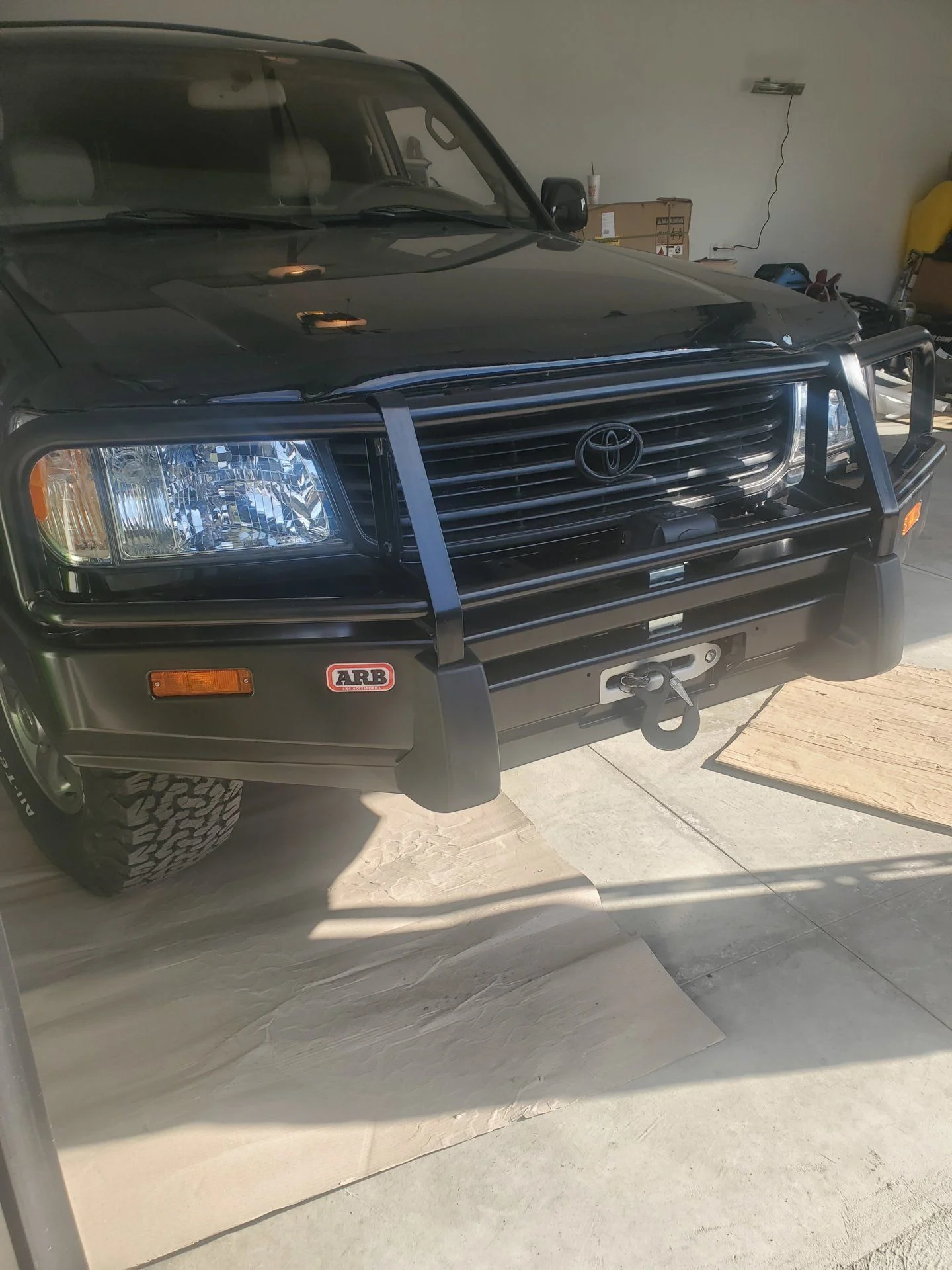

Lol sounds like you got the mod bug! If you have a front arb bumper, you need the rear to match or it ends up looking incomplete imo. Plus you don’t have to worry about slamming it on rocks, something you definitely can’t do with the plastic oem piece.
Sure you can.
It doesn't work out well.
But you can.

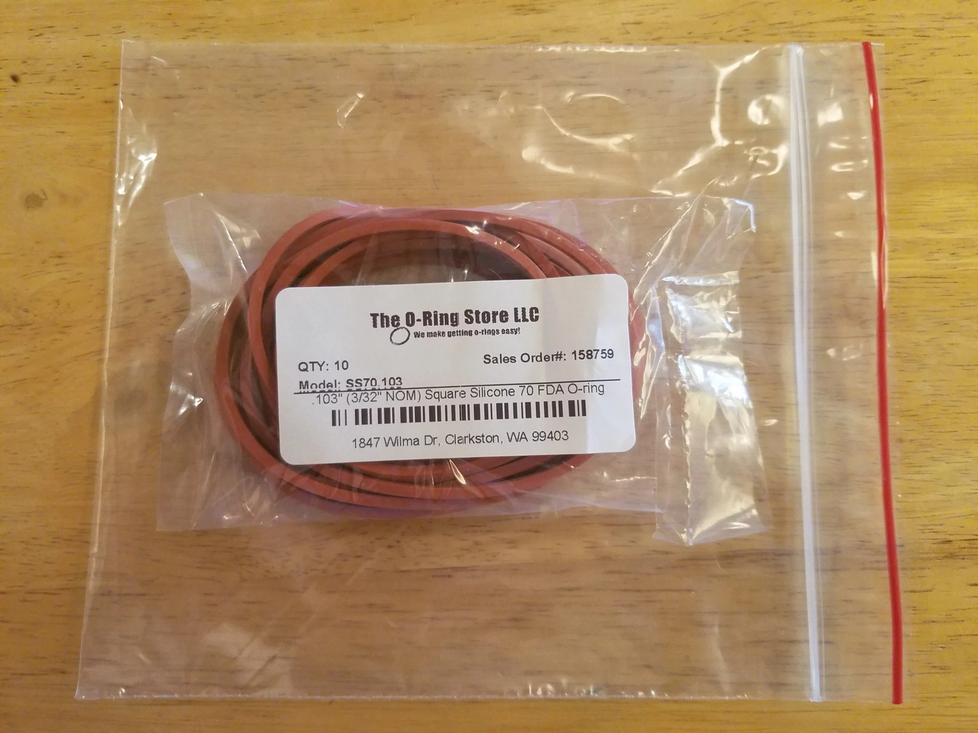

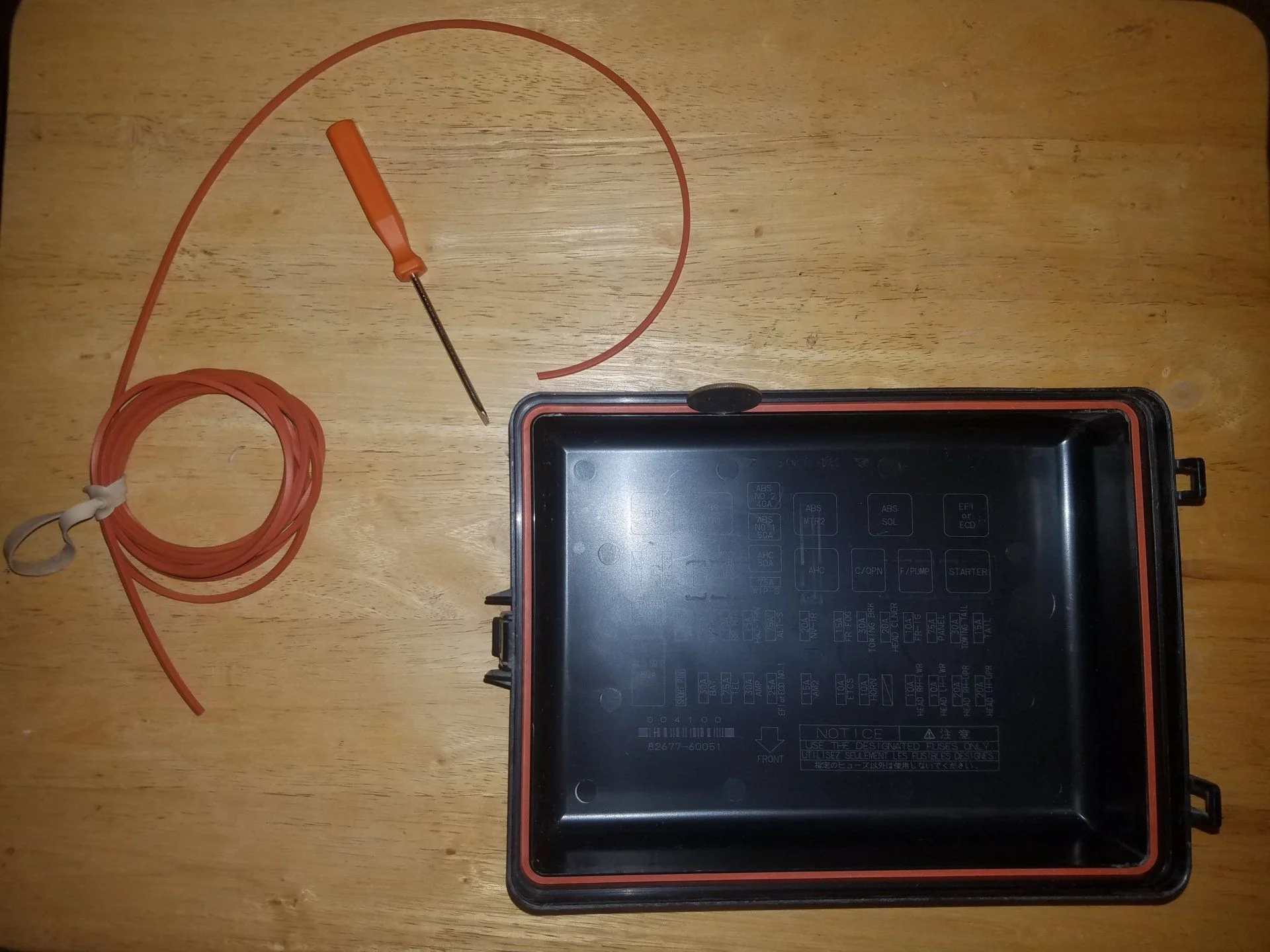

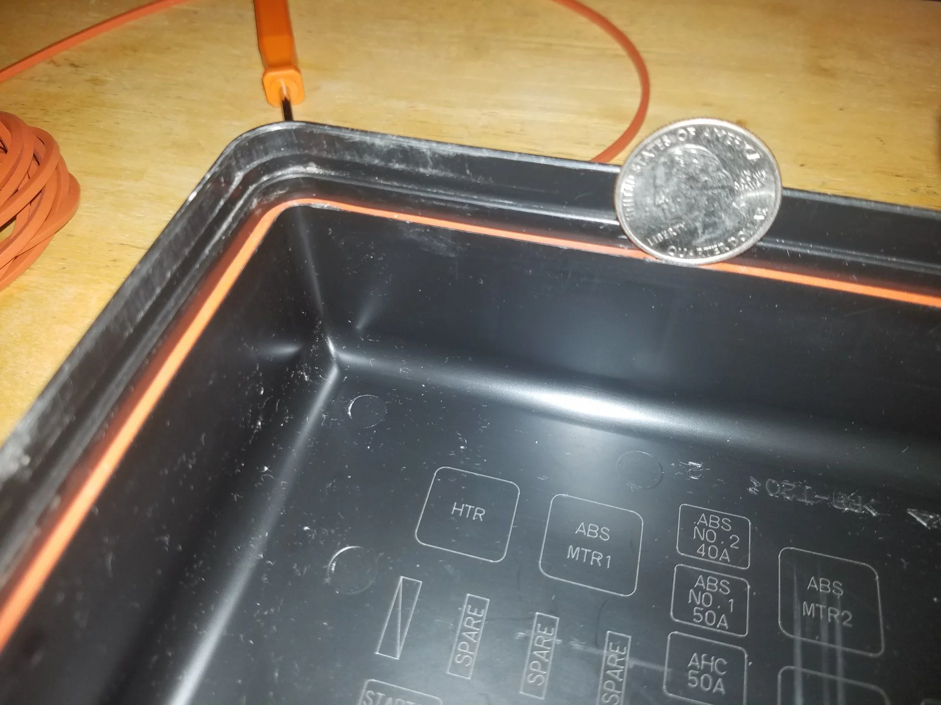

Finally changed out my (mostly missing) crusty engine bay fuse box gasket. Ordered 10' of the square gasket and have enough left over to do it again a few more times if I ever need to.
Cleaning the dust and crispy OEM o-ring fragments from the lid and inside of fuse box took most of the time to do this. I just rolled the new gasket into the cover o-ring groove with a quarter and used a small screwdriver to get it seated tightly in the corners. Fuse box lid is good and snug now...

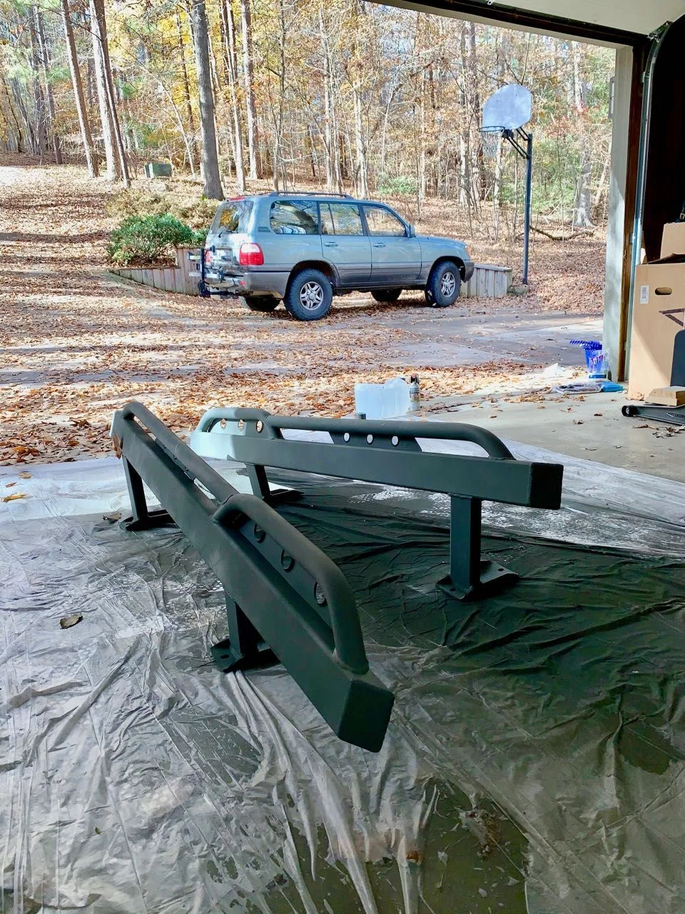

FINALLY got around to cleaning up and priming my Metaltech 4x4 sliders. Will paint and install over the holidays when my brother in law is here to lend a hand.
You buy them raw?
Was thinking of buying them during the bf sale
Yep Raw. Picked them up during the last group buy--was too good of a deal. I followed the directions here from MetalTech:
Only thing I did extra was wipe down with acetone and lightly sand before priming since thats what the primer said to do.

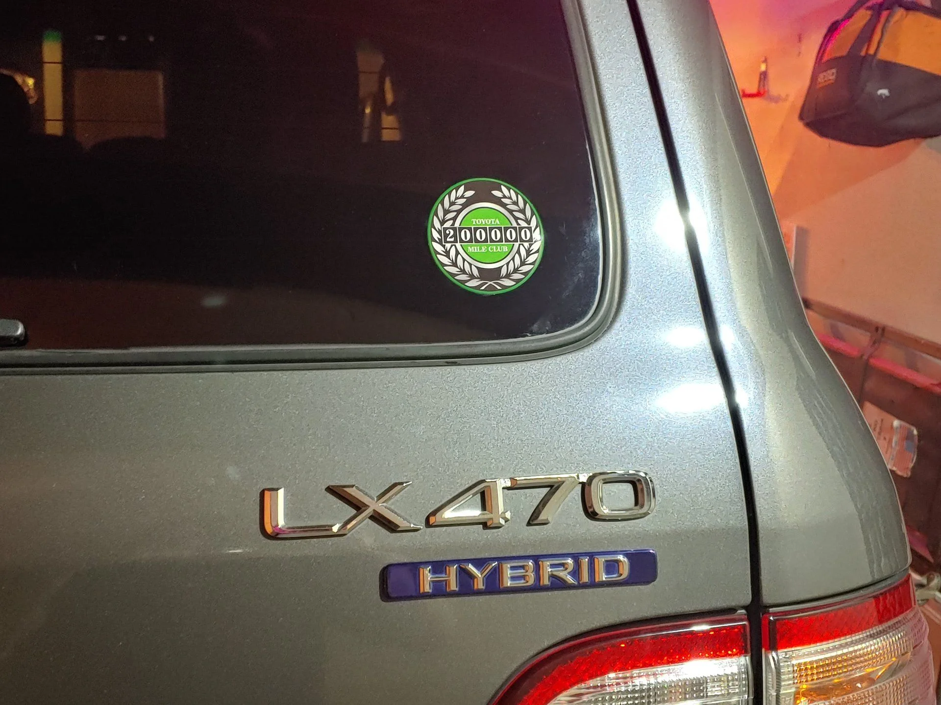

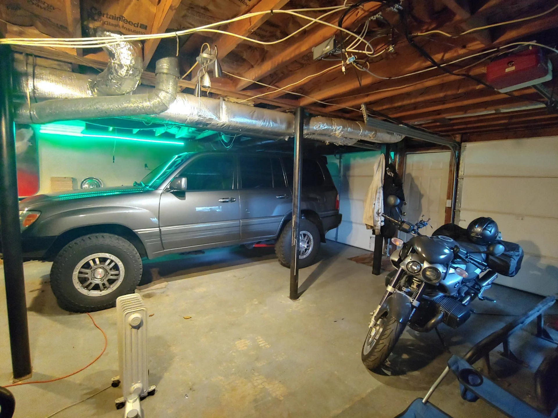

Oil change, 5 tire rotation, greased all 16 zerks my truck now has (4 u-joints, 2 drive shaft, 2 FUCA, 4 RUCA, 4 RLCA), chassis wash (easy when the wheels are all off), body wash, quick wax, window polish and sealant. Finished off with the new 200K high mileage club badge. This is about 45k miles late, and it'll likely only be another year and a half before she's ready for the 300k. (don't mind the smudges.)
She gets the garage tonight. Tomorrow she's back in the driveway and the W123 gets her spot back.
She's got a date with the doctor in 2 weeks for a partial front end rebuild (complete new LCAs and bushings/LBJ, rack bushings, TREs, diff bushings). Then @JT4runner and I are going to tag-team her for a paint correction and ceramic coating.

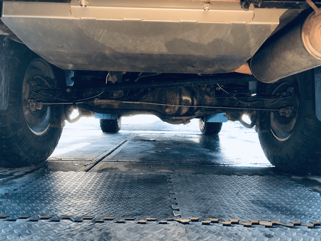

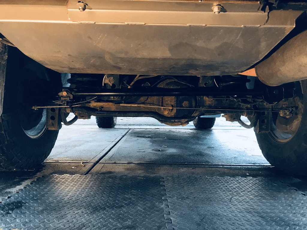

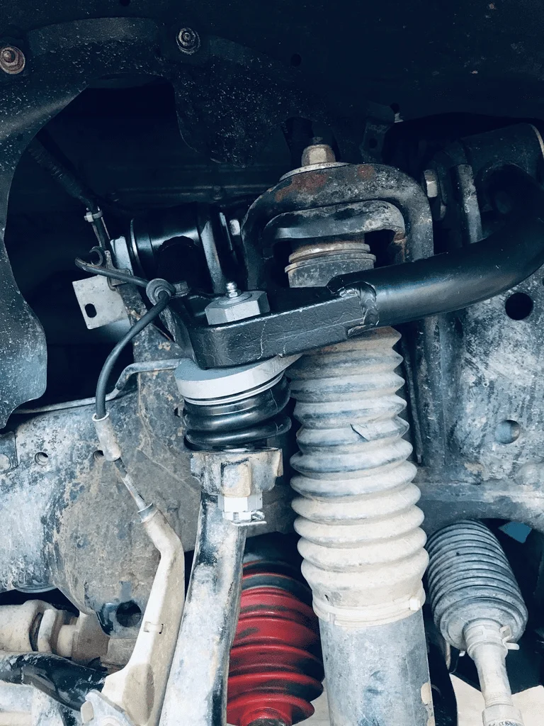

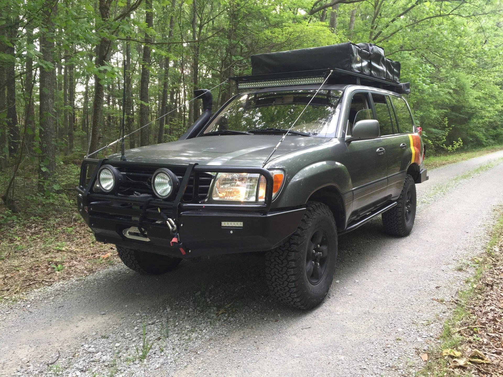

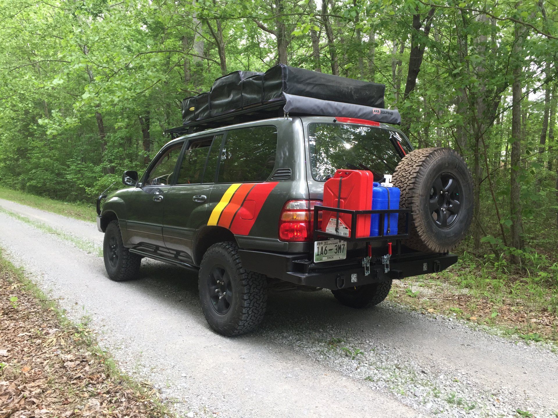

More Alcan 5000 prep:
  • Replaced bad SPC ball joints with their new ball joint kit
  • Installed the Delta Systems panhard drop I got at HIH.
    • Dropped 3" - nearly level now
    • Once loaded with gear and 50gallons of gas it'll be level
  • Replaced front sway links with Trail Tailors extended version
