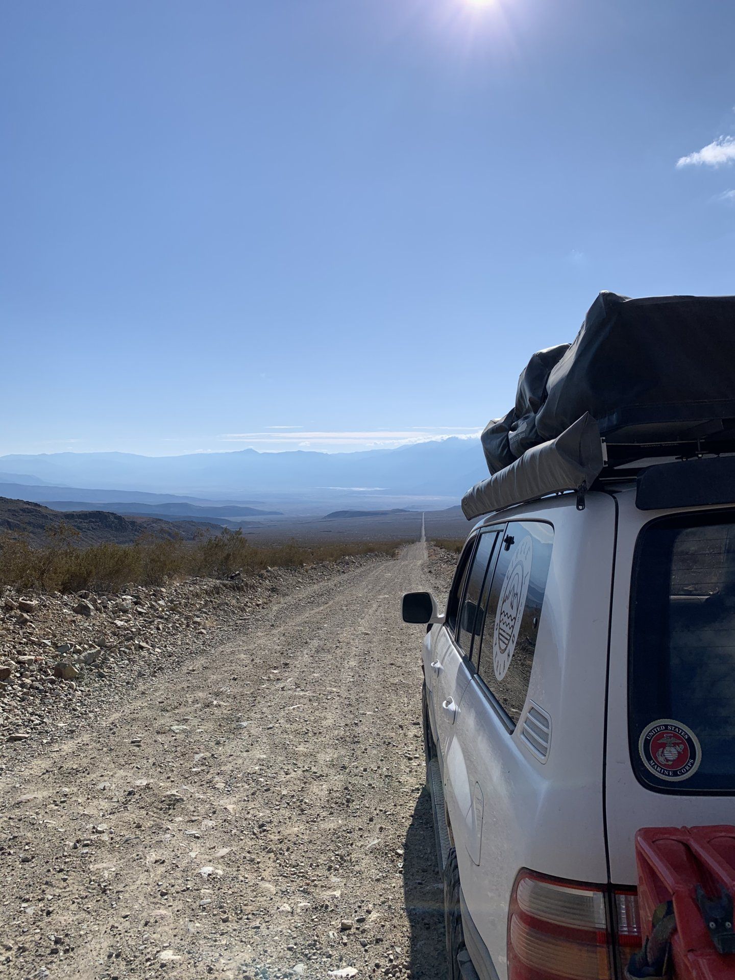

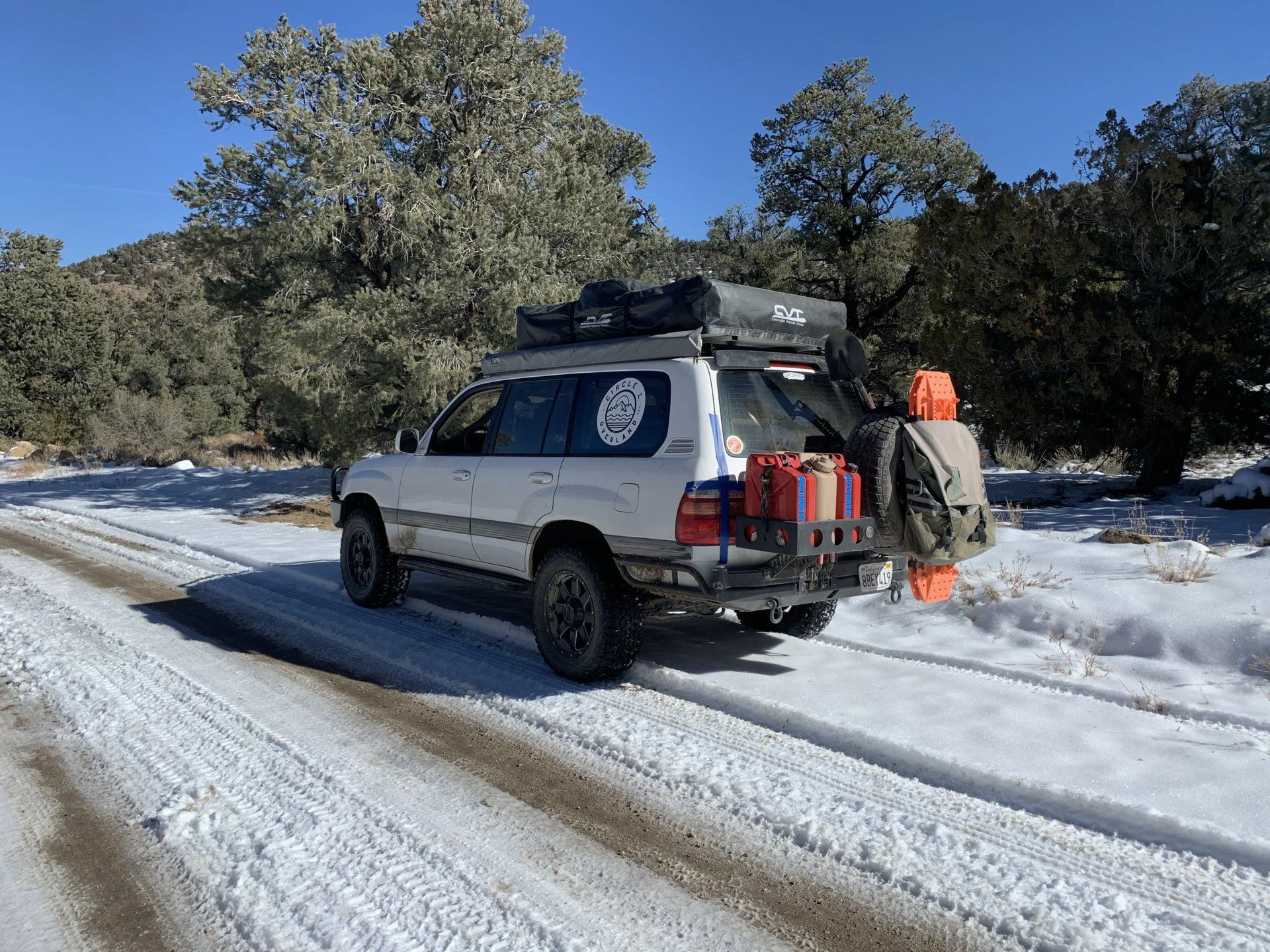

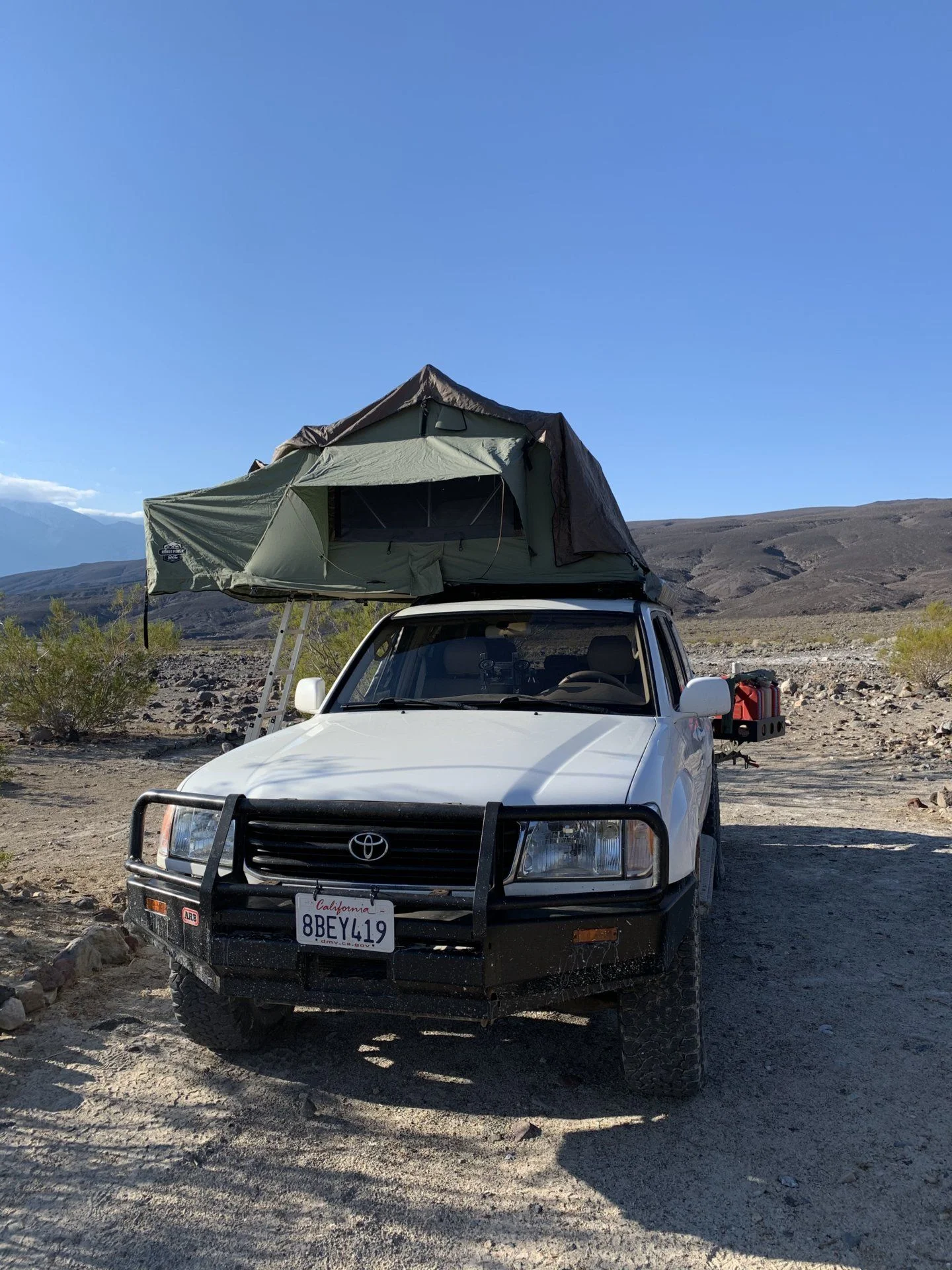

Used and abused it out in Death Valley

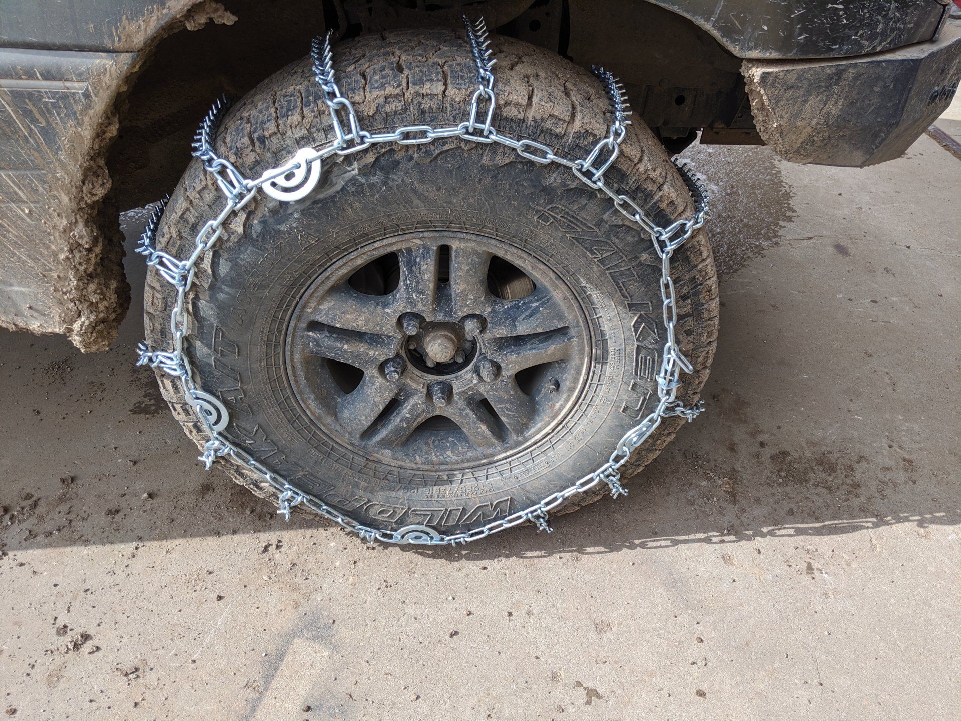

Had to put spacers on because I didn't have enough clearance between the tire and the control arm for snow chains. I like the way the wider stance looks, but hate the way the tires throw mud. I will take them off in the spring.
I really am liking how tight these cam type chains get. I will probably still use a rubber tensioner though.

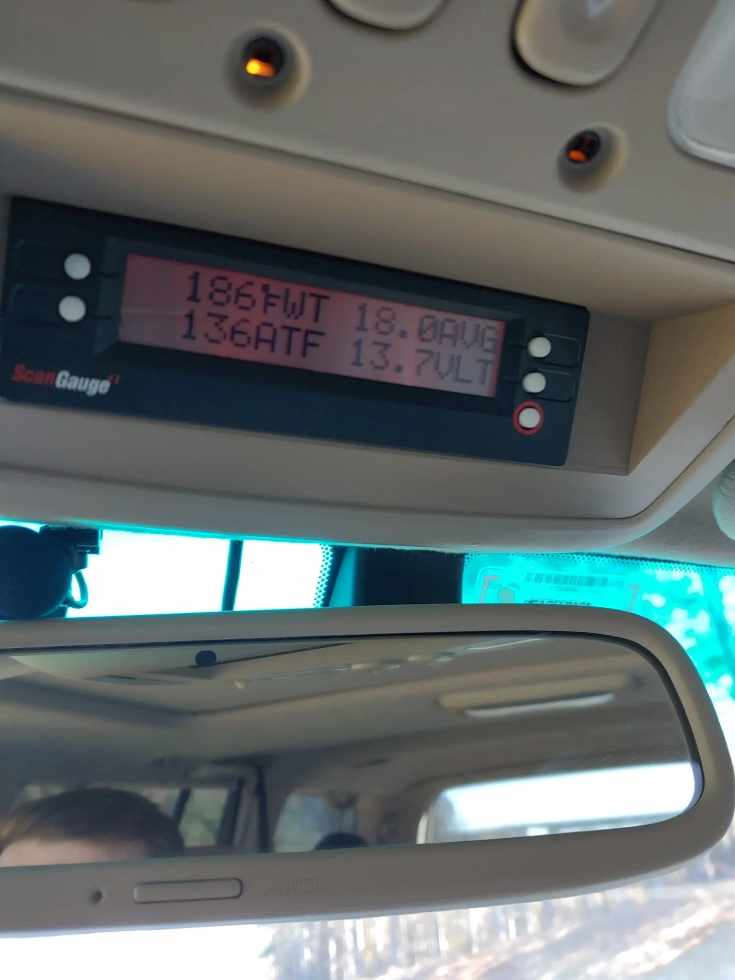

Road trip from Atlanta to Virginia Beach.
ALL HAIL GERRY! 👸 Spinning 34s at 75-80 on stock gearing for 9 hours and pulling some crazy mileage. *
*Realistically, I was finding 16.5 mpg calculating at the pump. But don't tell the truck that.

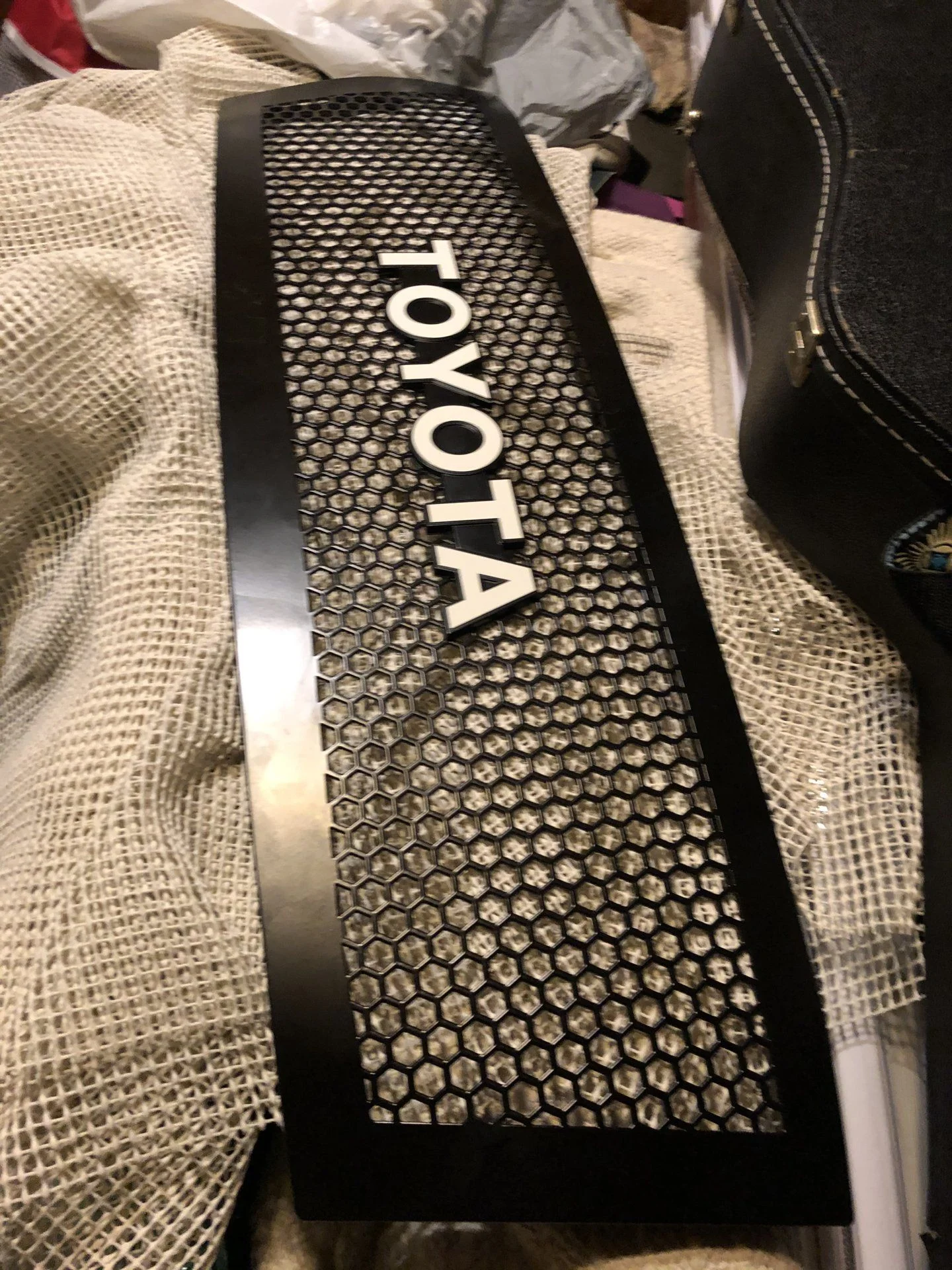

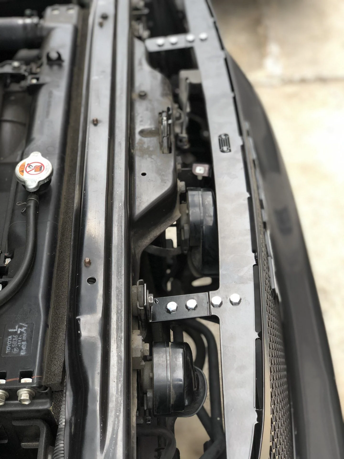

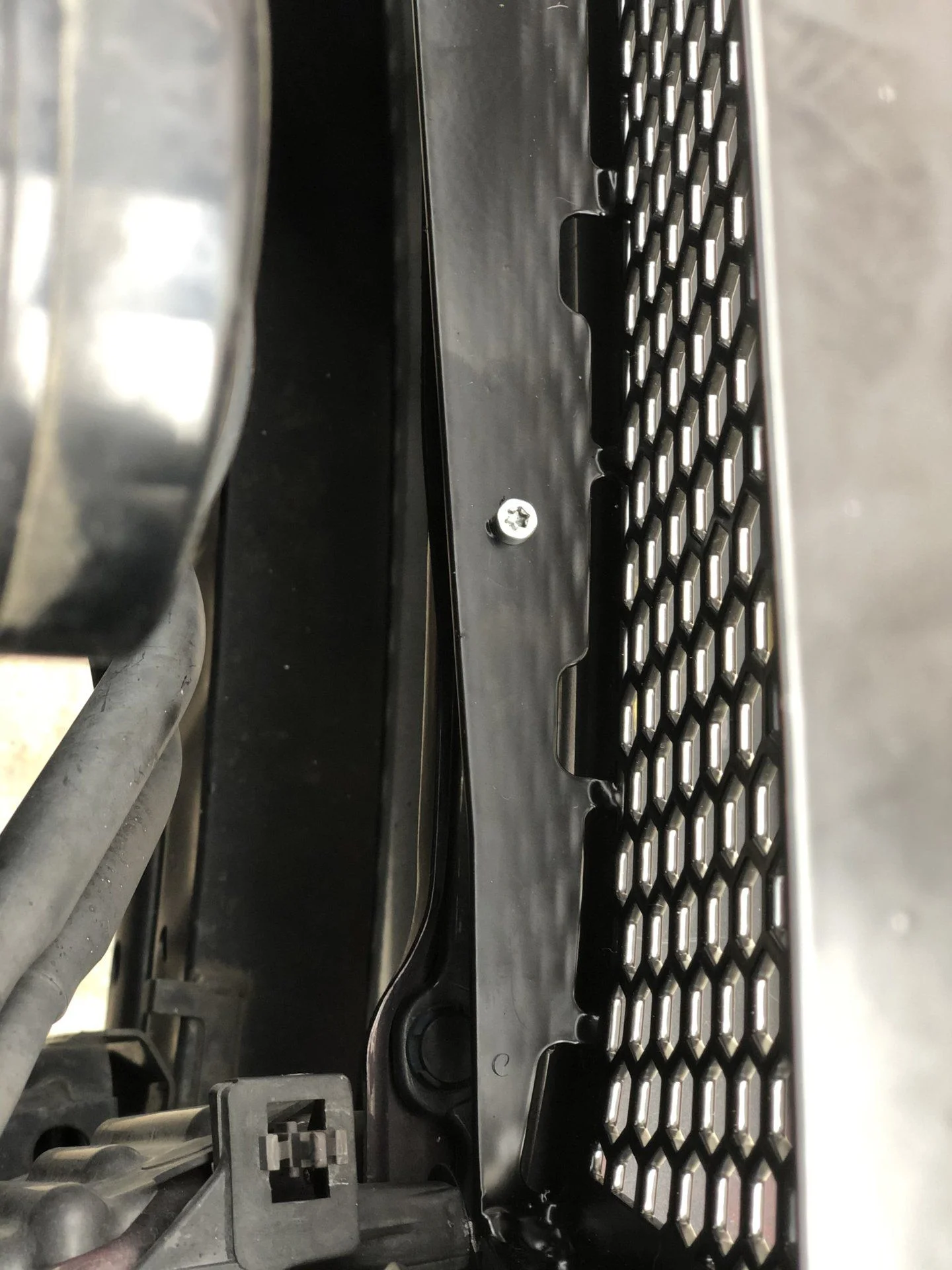

Yup, they are available now. Just haven't had a chance to update the website for 100 Series parts yet. Finally do have a devoted 100 Series section (for upcoming bumpers, etc), just have to start filling it out.
I'll keep an eye on the web site.

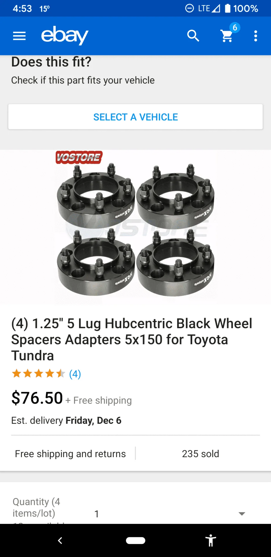

What kind of spacers did you use? I'm thinking of getting them for all four wheels to improve stance, but I'm wishy washy on it.
I got these from a buddy that had ordered them but never used them. They are 1.25".
I ran this exact spacers on my LC with no issues, no vibrations, the fronts will snag just a bit on the hub flange's bolts, im not gonna tell you guys how i made it fit because the 100 series nazis here will tell me it's unsafe. But i've wheeled with it and taken it on high speed runs home after eating at Chipotle. I'm still here to post on forums.
Here's how they sit with 275/70/18 tires on stock Tundra +60mm wheel. No rub

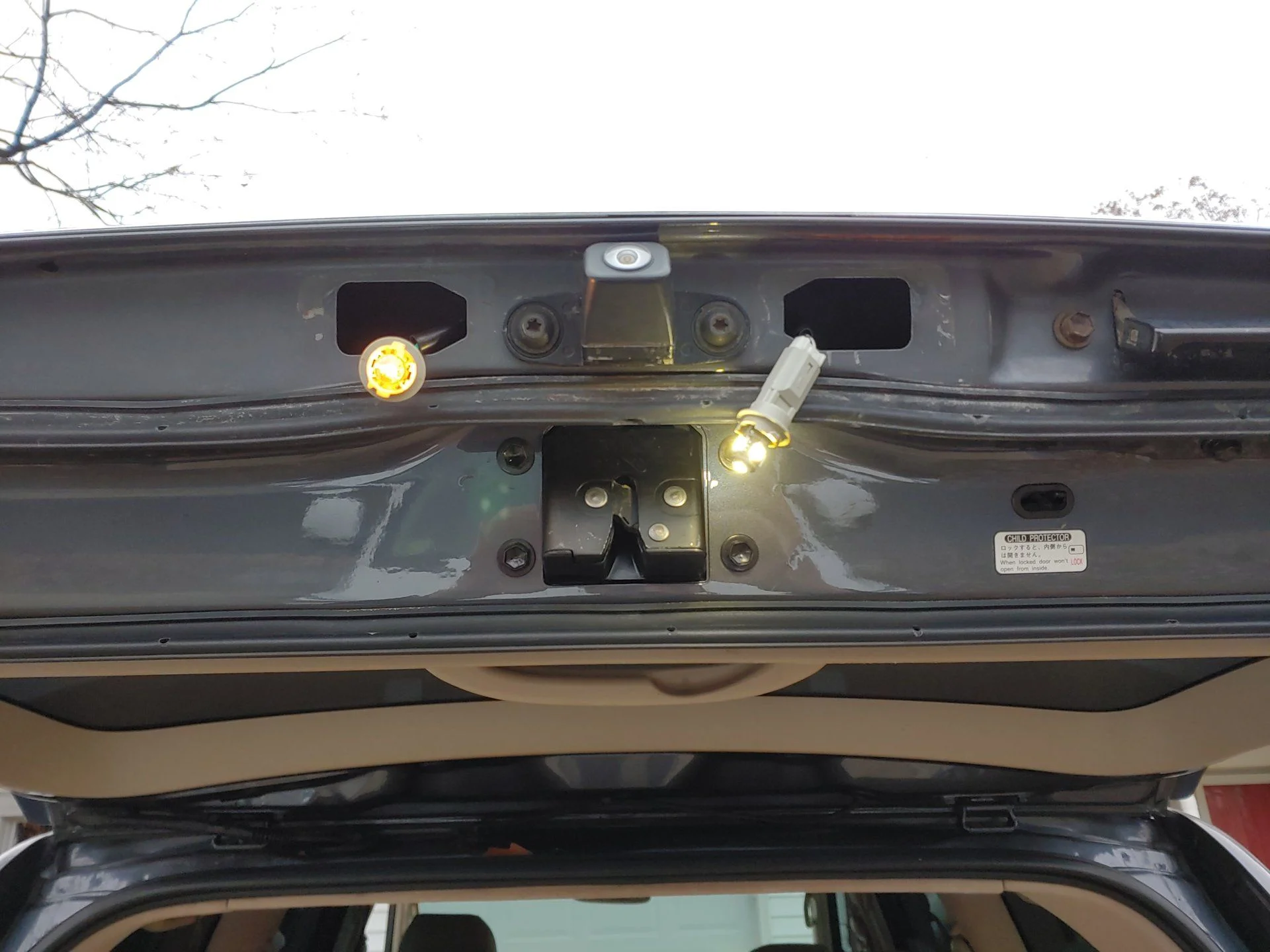

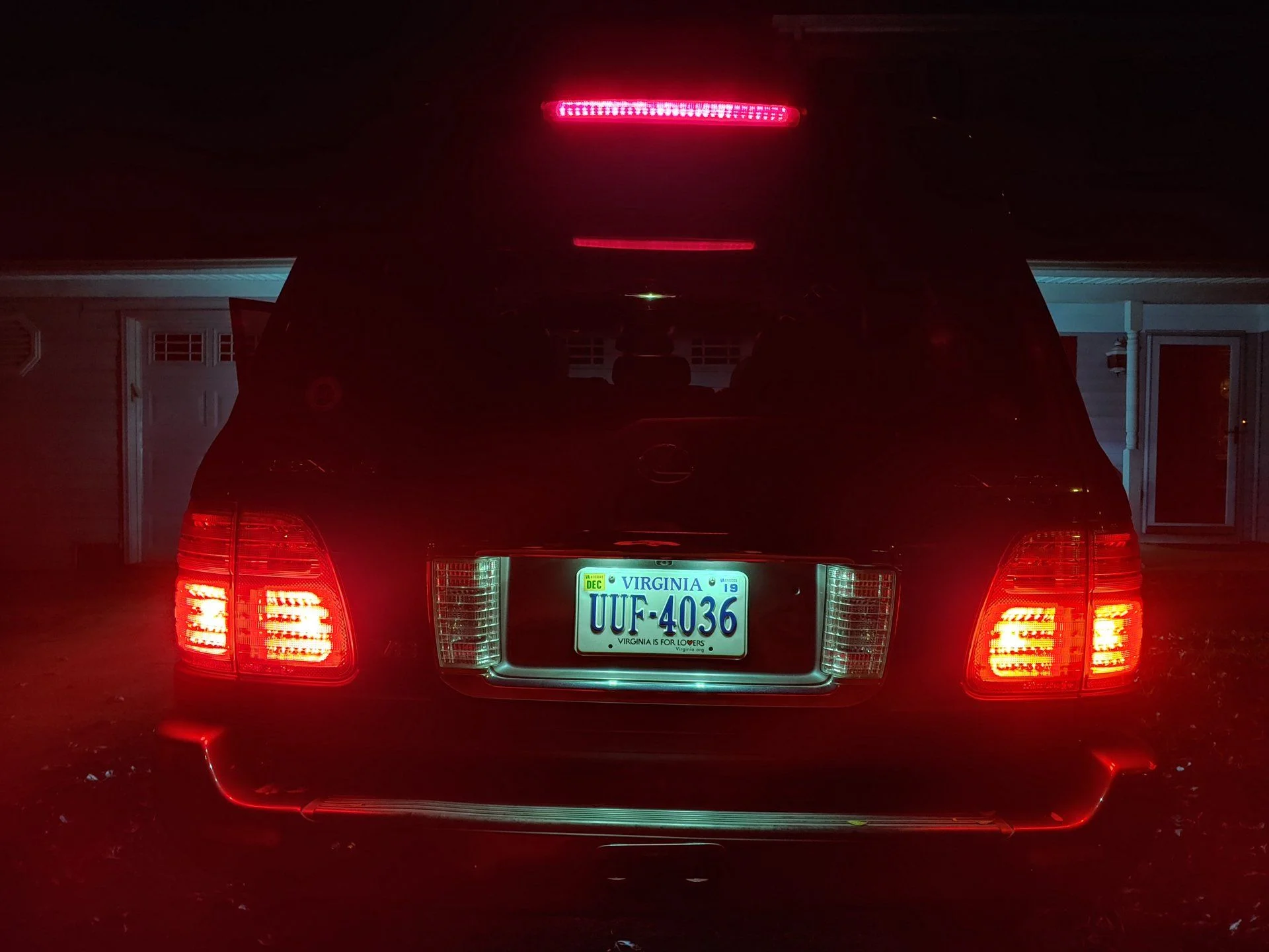

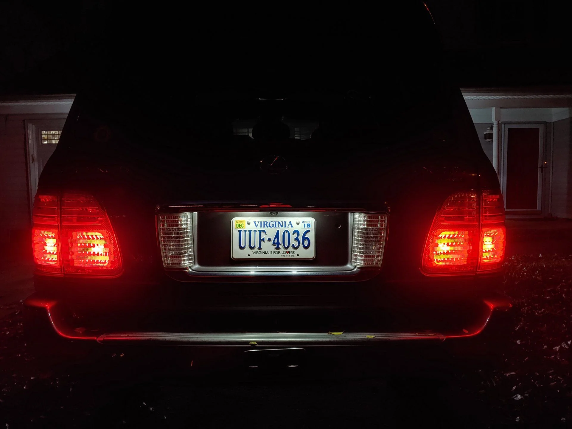

Took advantage of some downtime today and installed the LEDs that have been waiting at my parents' for a few days. I went through SBL. Also discovered the 3-pin relay I ordered is wrong, and won't have the proper 8-pin until I get home on Sunday. I'll be that hyper-blinking dork for a few days.
I did all of the rear end lights, though my reverse lights had already been replaced with JDm Astar.
A little disappointed with the brightness of both regular tail lights and brake lights. I was really expecting something more apparent as I've seen some that were nearly blinding. I guess that's a good thing, though. License plate lights were replaced with 'natural white' color LEDs as I can't stand that 'pure white' or 'cool white'; they're too clinical looking to me. Very happy with these.
It's kind of weird to me that there's no light in the spot above the inner brake light on the tail gate.

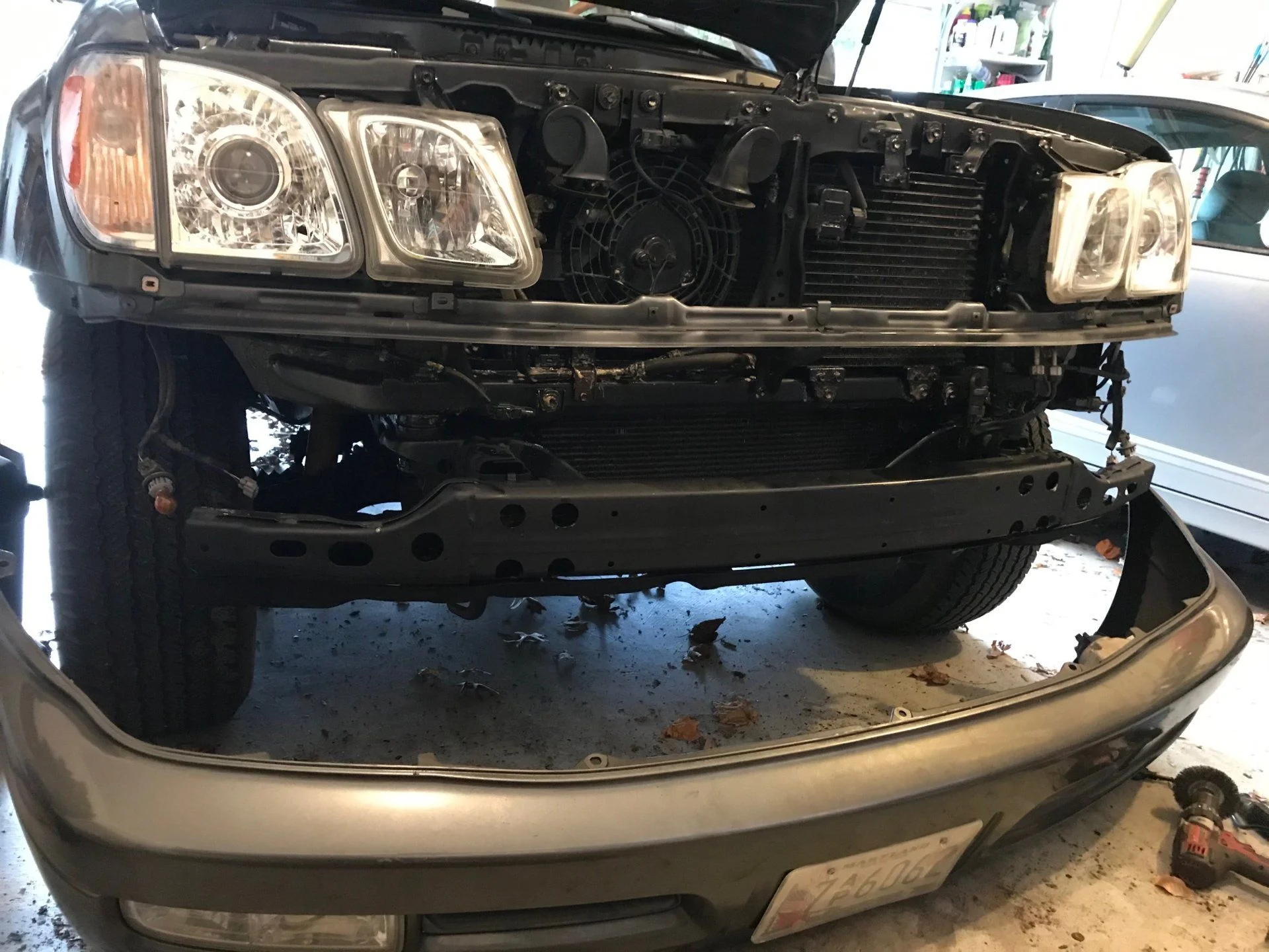

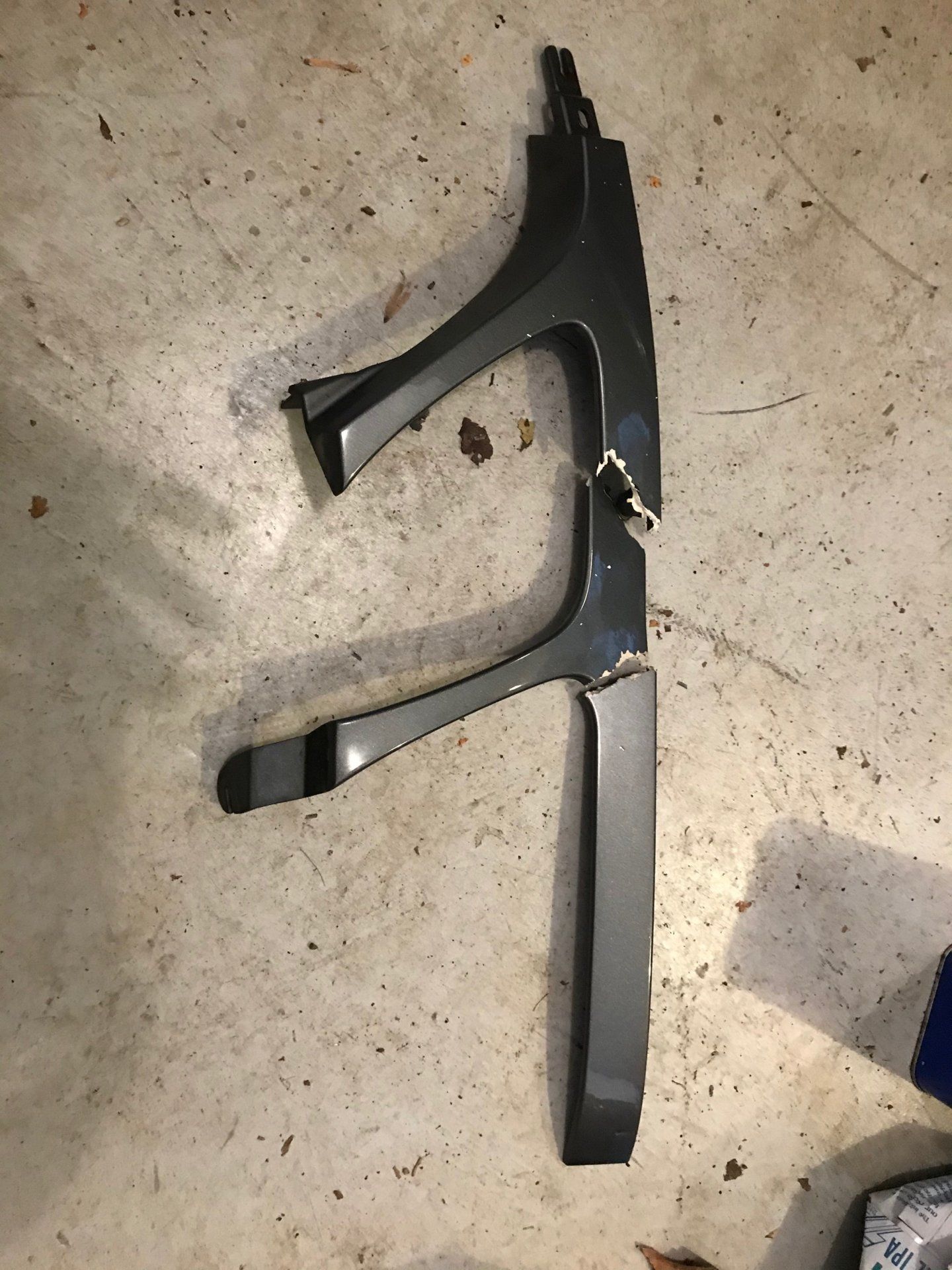

Took off the front bumper cover to see how the rust looked behind there. Wasnt as bad as I expected. Hit the metal with a wire brush and wire wheel where I could, applied some Eastwood rust encapsulator, and sprayed fluid film everywhere else.
In the process, sheared off 3 of the bolts holding the bumper cover, broke another part of the fiberglass trim piece, and the connector for the fog lamp on the passenger side.
Good times.
Good times.View attachment 2144593View attachment 2144594
the trim on my lx is broken as well, any idea where you're going to source new pieces?
