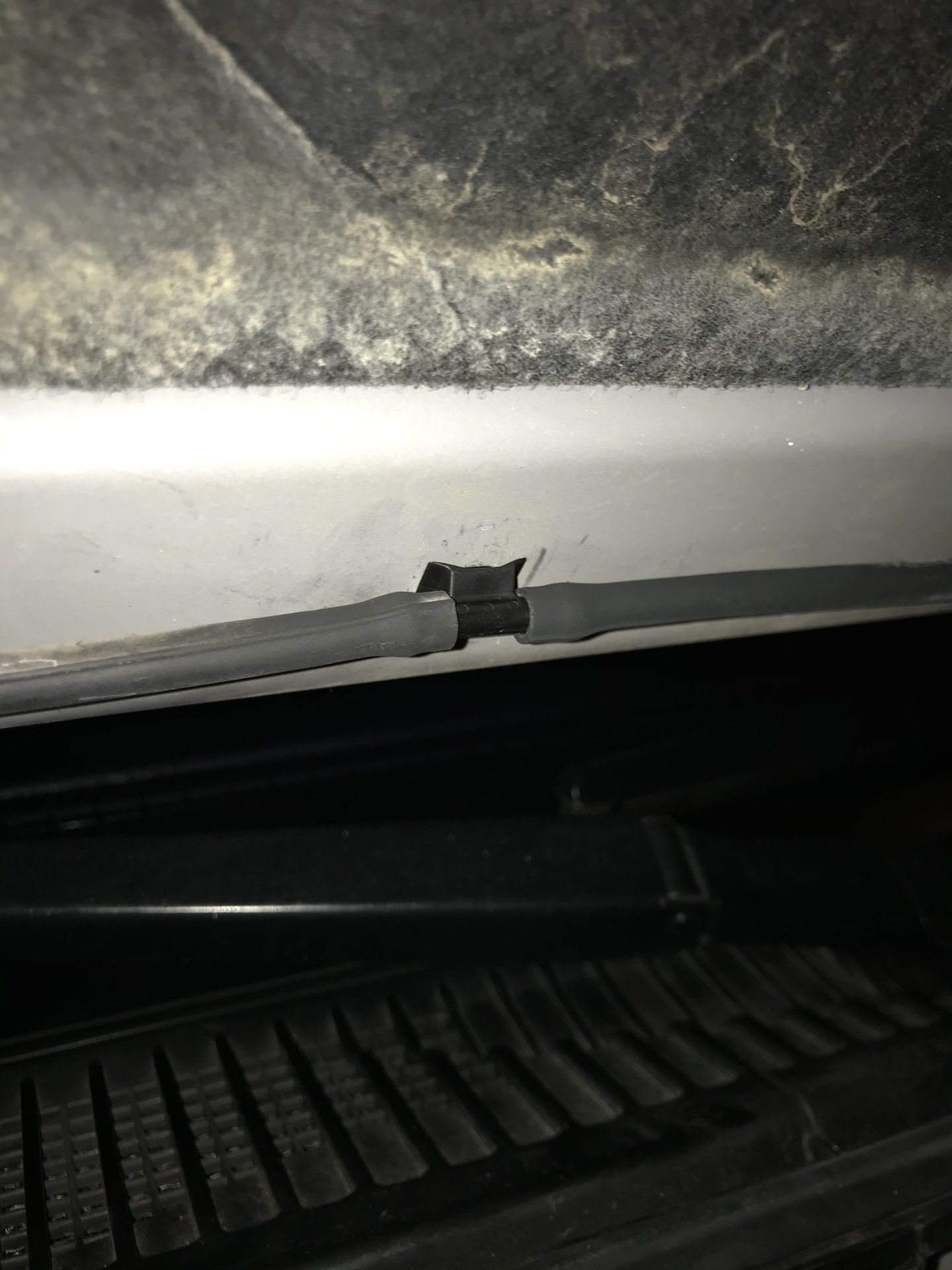

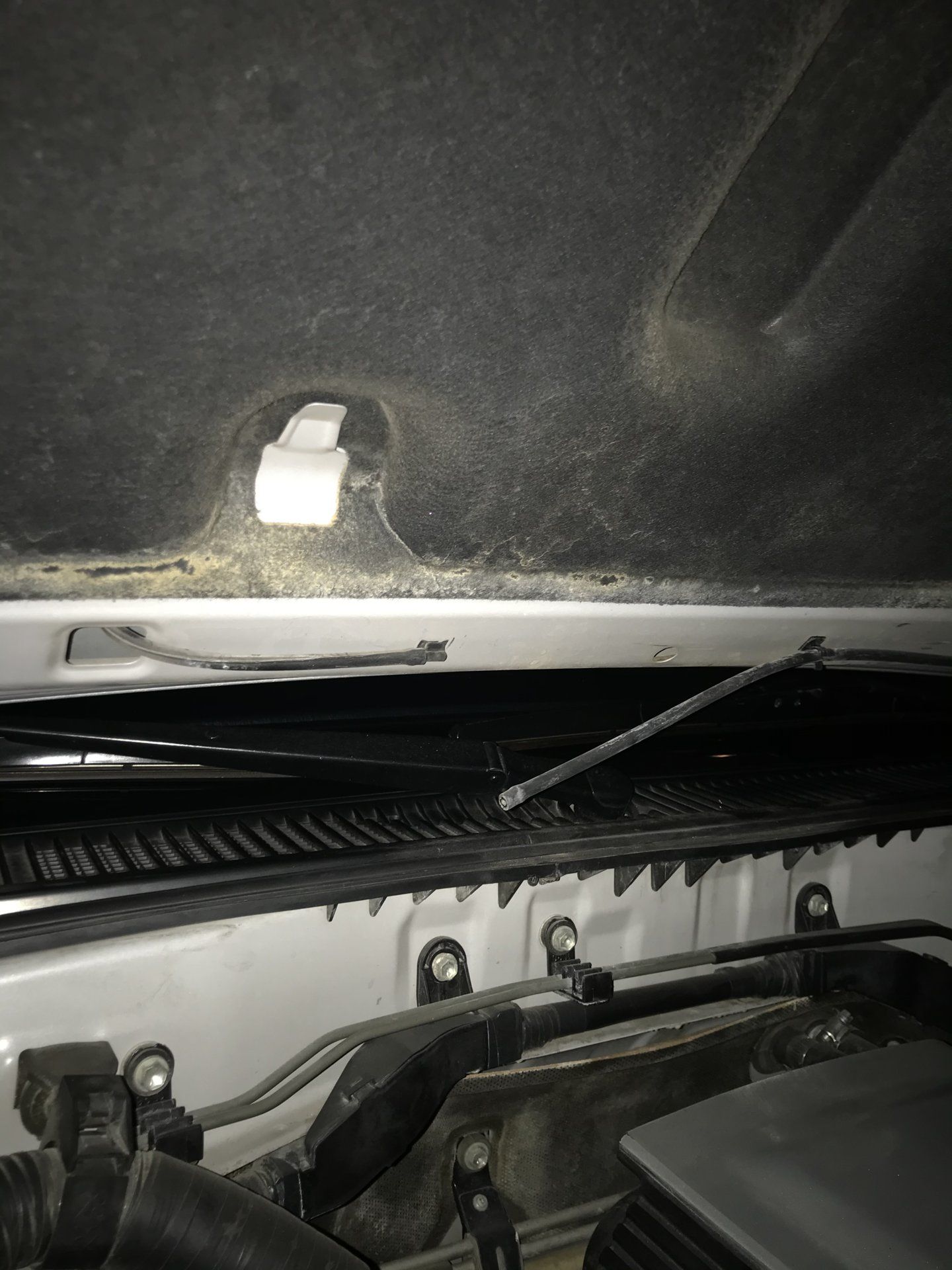

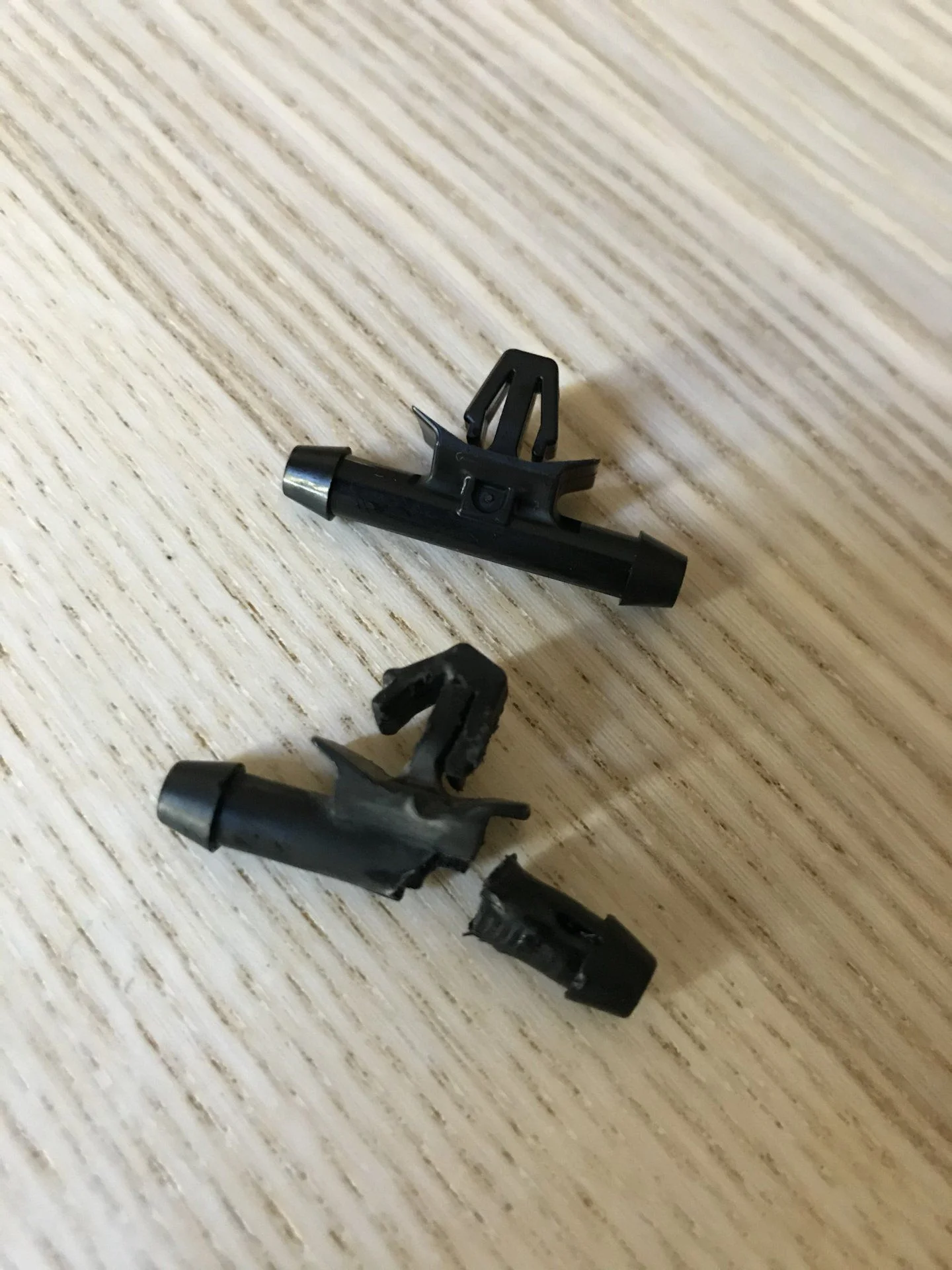

Broken water line for windshield washer:
Ordered from partsouq.com original ones, order 2pcs for spare:
BAU again:
Old and New

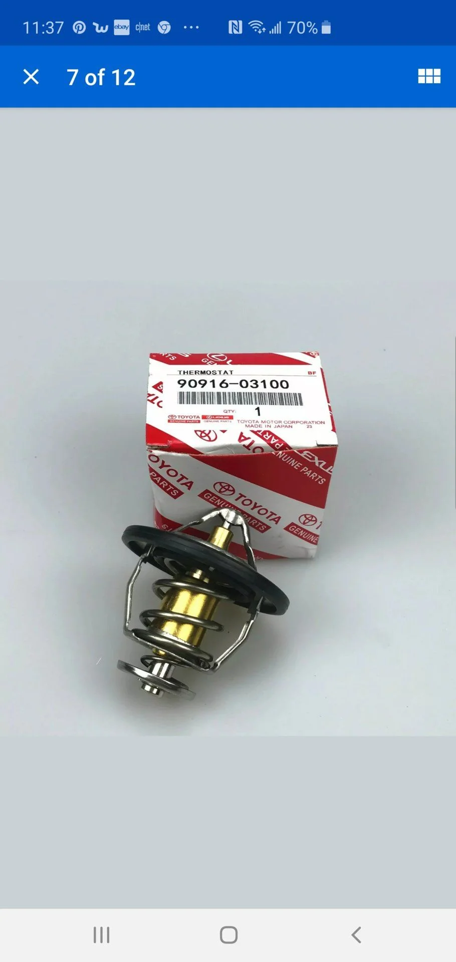

Make sure you have a Thermostat Gasket (16346-50010) on hand for your mechanic as I didn't see that listed in your parts. Also if you are going with aftermarket heater tees make sure that they are exact size as OEM if you intend to re-use the heater hoses/clamps. Many here included myself have switched to stainless heater tees to extend service life and reliability but some are slightly undersized and may leak if not changing hoses (and clamps) at the same time.

I will get the thermostat gasket. I figured the thermostat came with one. It looks like it has one. Please see the pic. Thanks for all other advice.

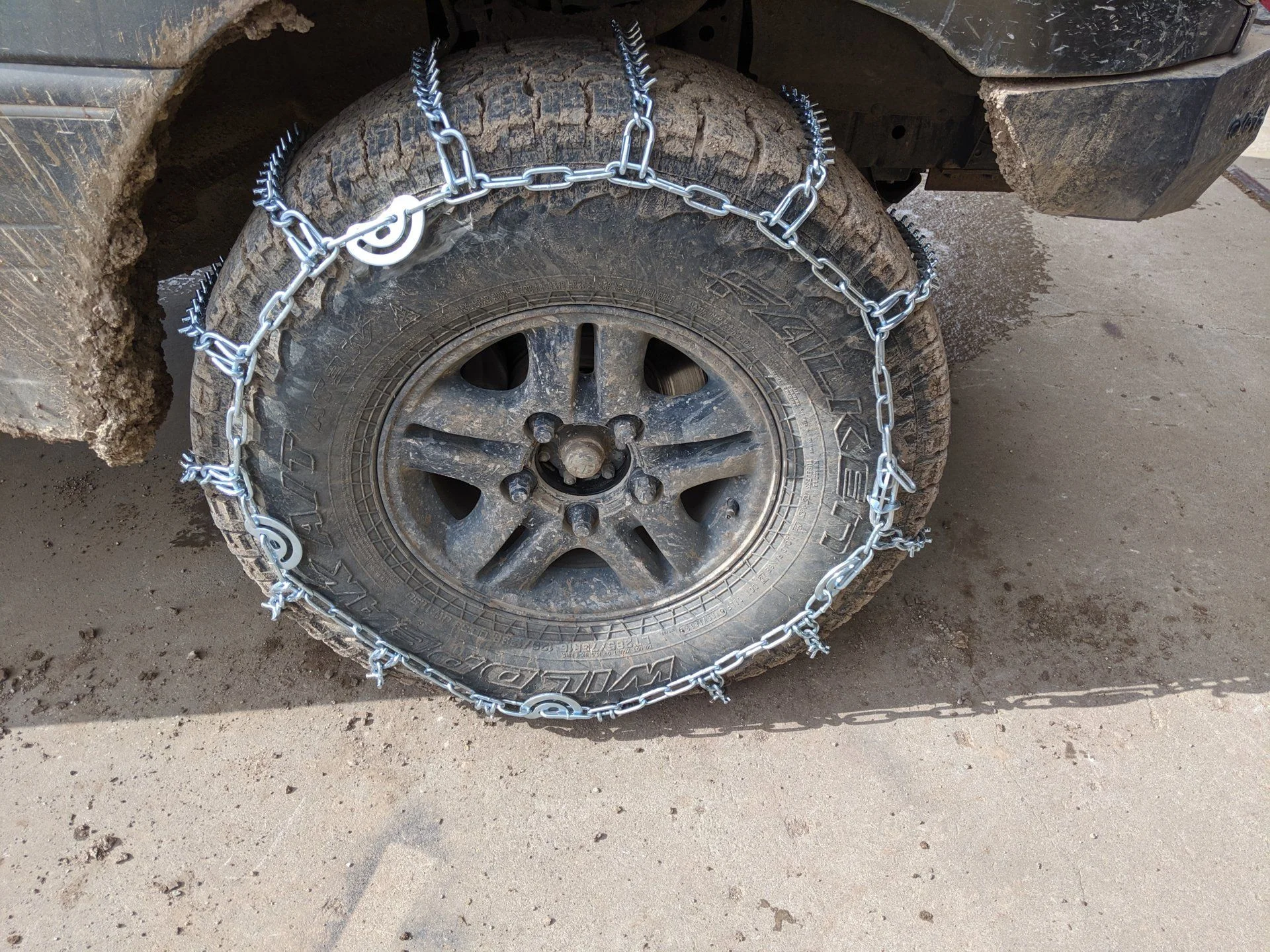

Had to put spacers on because I didn't have enough clearance between the tire and the control arm for snow chains. I like the way the wider stance looks, but hate the way the tires throw mud. I will take them off in the spring.
I really am liking how tight these cam type chains get. I will probably still use a rubber tensioner though.
