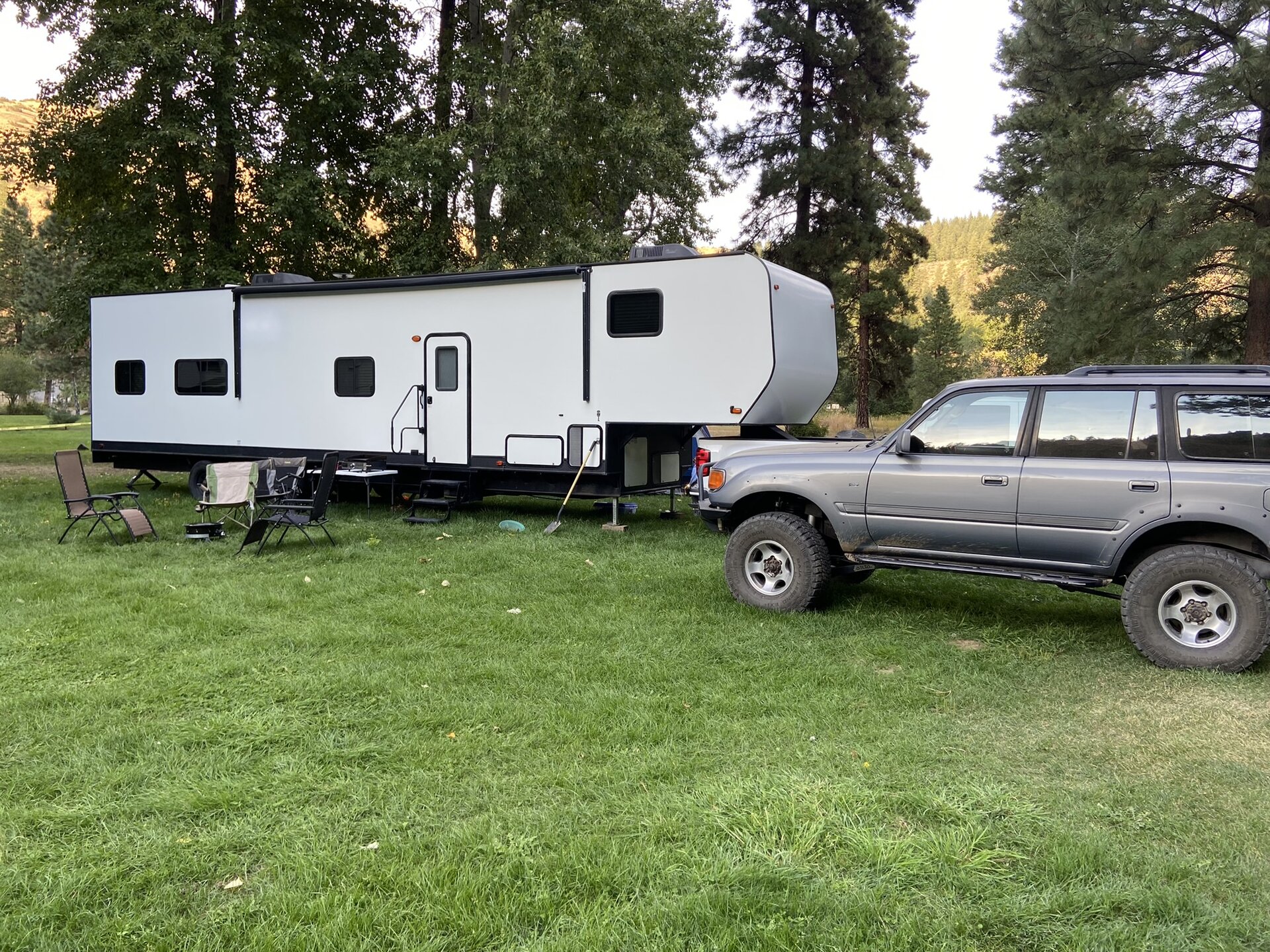

40' Dune Sport Toy Hauler towed with 2019 Chevy 3500HD dually (behind the cruiser). I had a F450 before this one but the fuel milage was terrible. I got less than 9mpg empty and about 4 loaded. The chevy averages 9 fully loaded and gets 20+ empty.
Yes, the land cruiser fits inside. It's a no frills trailer but its clean, comfortable and has everything we (4 people) need for weeks at a time.
