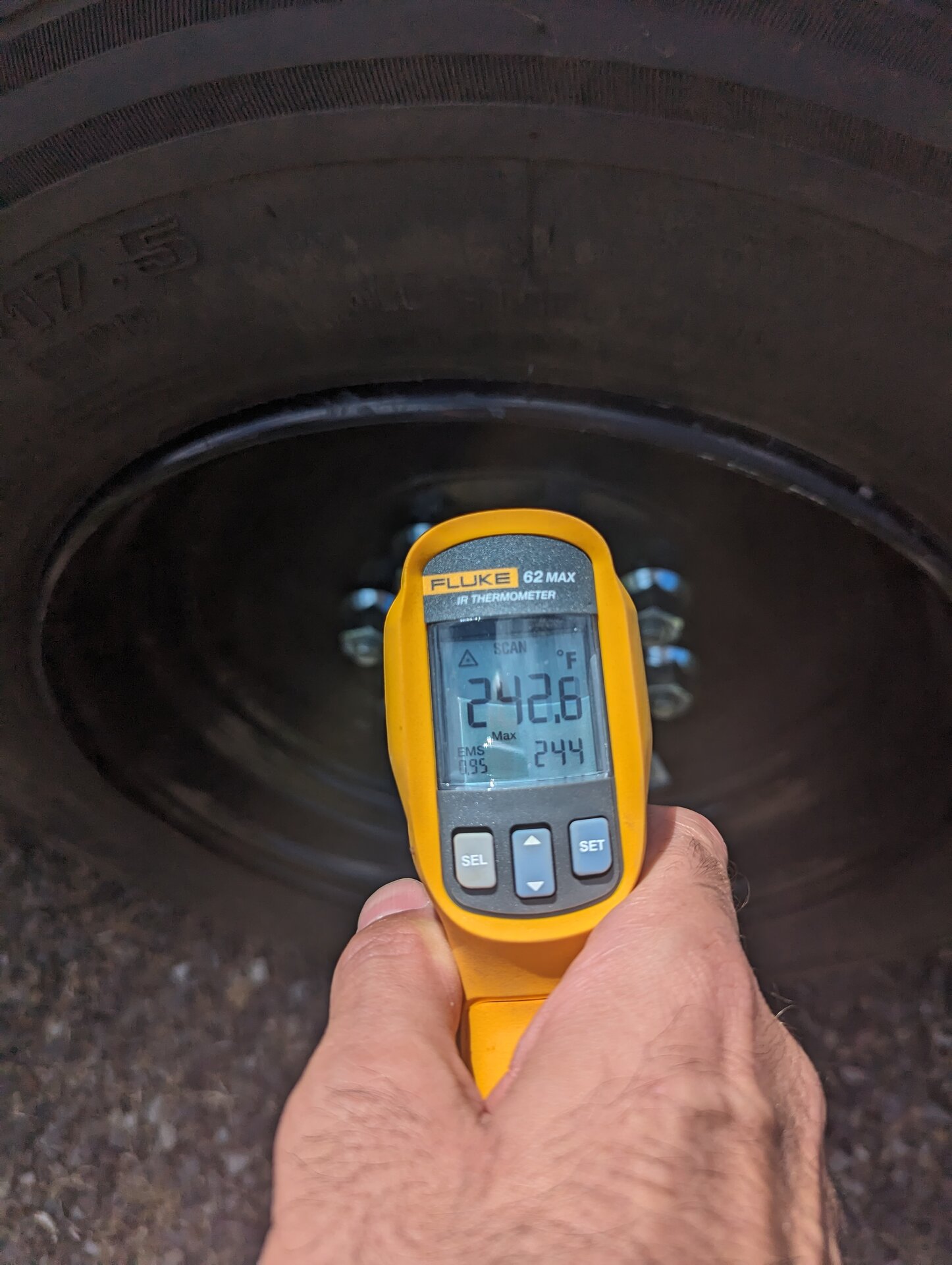

I figured oil bath axles would be a good idea - less maintenance and run cooler. I guess that's only if they're assembled right. I thought the heat was the brakes breaking in and maybe dragging a little. Given the amount of oil that's puked out in the first few trips i think a disassembly and wheel bearing torque check might be a good idea.
Interesting, I thought it would be a upgrade as well.
For comparison on my trip to Colorado at the beginning of the month with my 10K trailer with 5k axles it was 118 degrees out so I was checking the hubs at stops and was getting for 140* to 170* at the hubs, With no grease puking out.
Trailer has about 35k miles on it with last service 10k and 2 years ago
Trailer has about 35 miles on it with last service 10k and 2 years ago
The front axle hub happily sits at ~120F in ~90F ambient. Assuming they just messed up setup on the rear axle. I head down to Oregon for an event at the end of September - definitely going to get it squared away before that.
