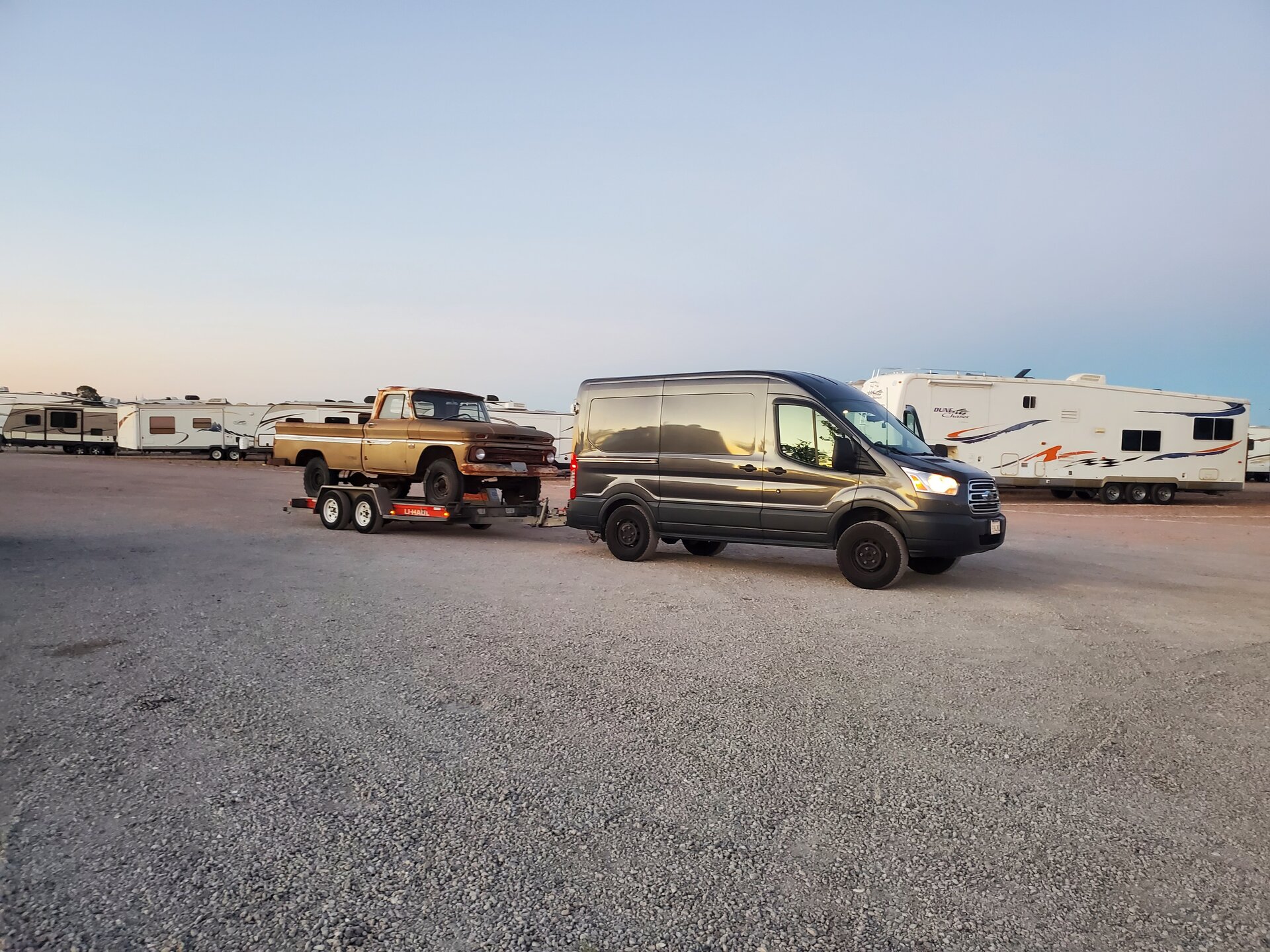

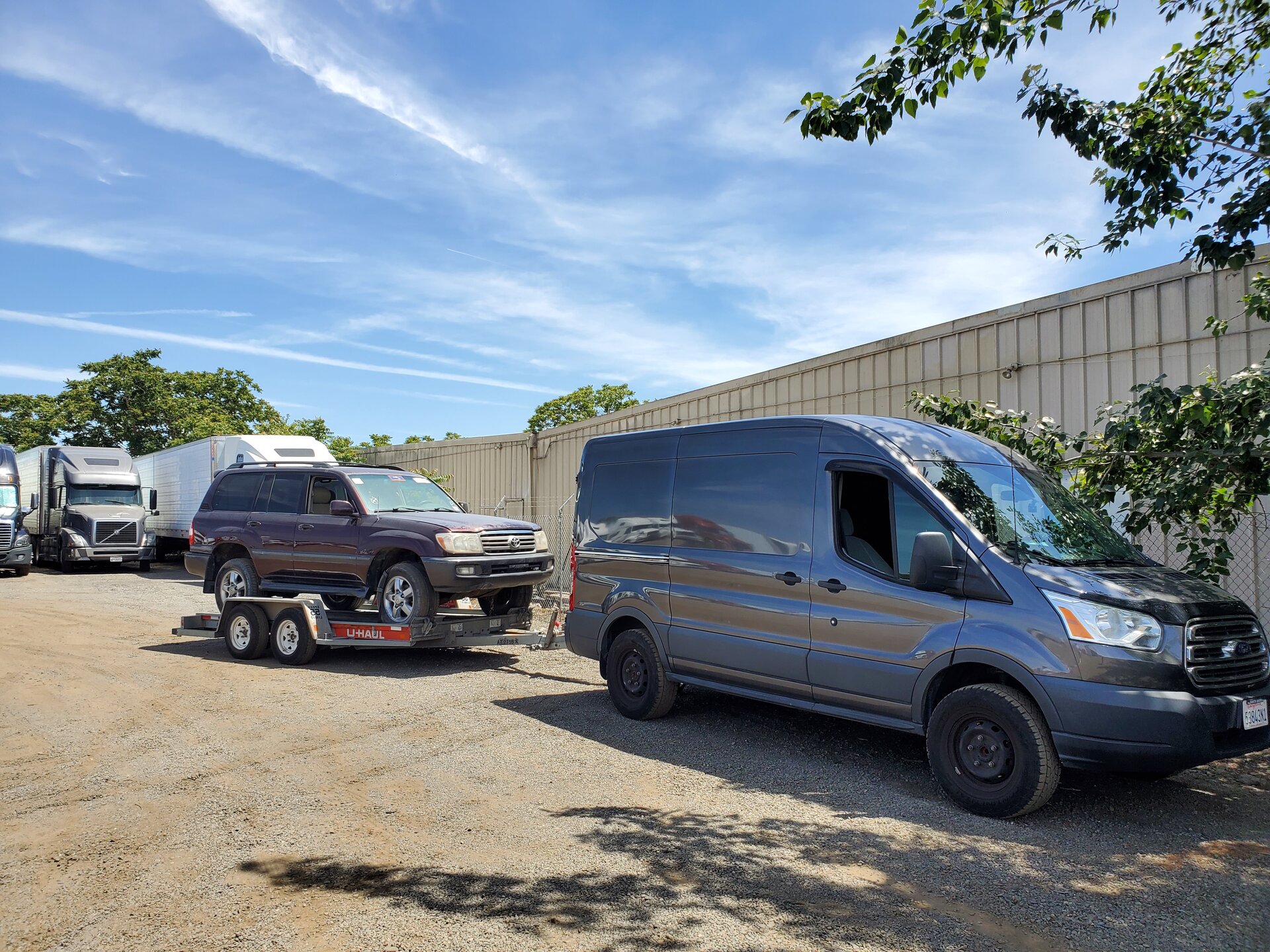

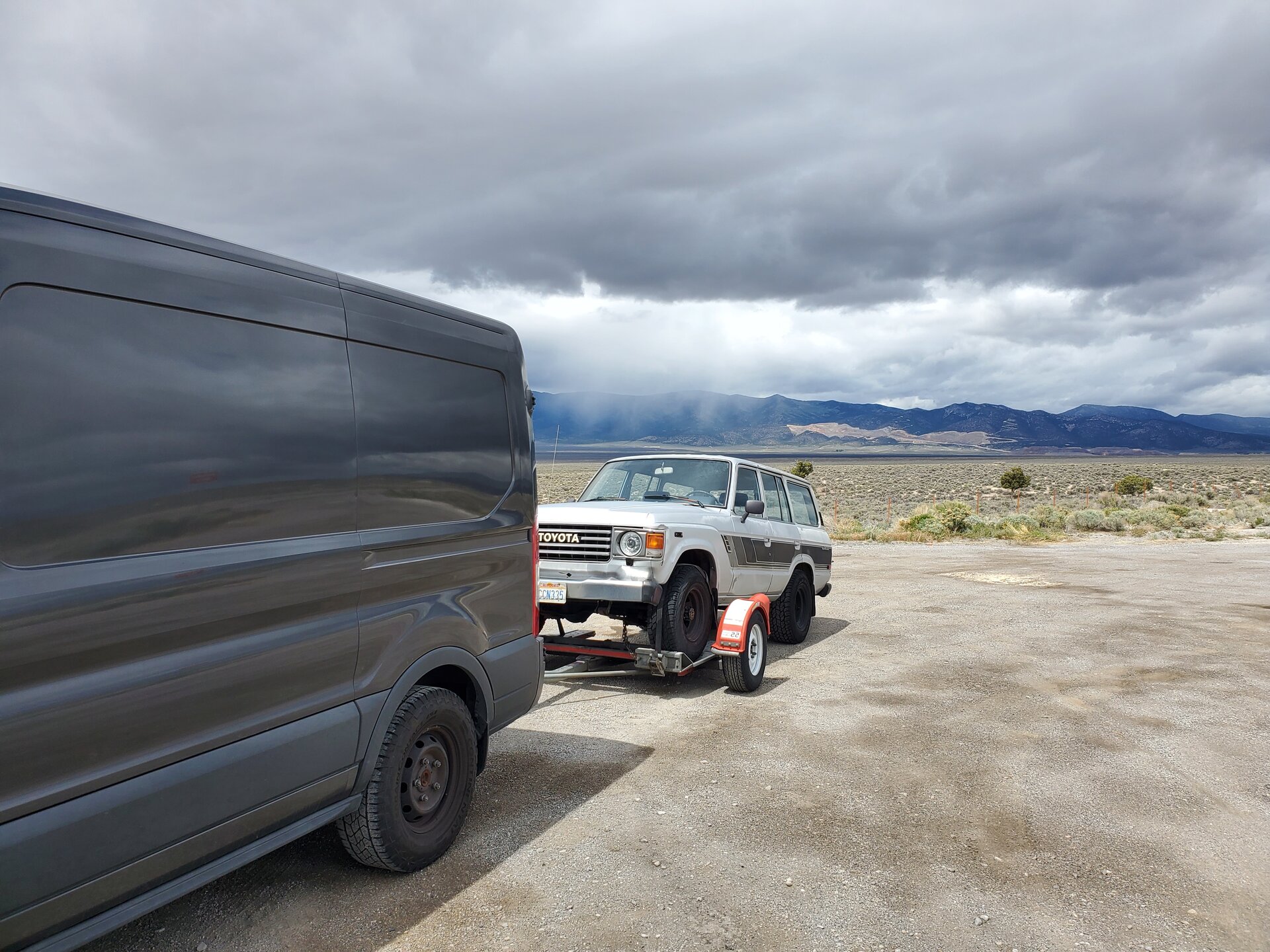

Much cheaper to setup for sleeping than having to purchase an extra camper for a truck. The important thing is getting a light enough trailer that can carry enough. I am eventually going to buy a nicer trailer but as you can see from the pics, she can do almost everything I ask.
