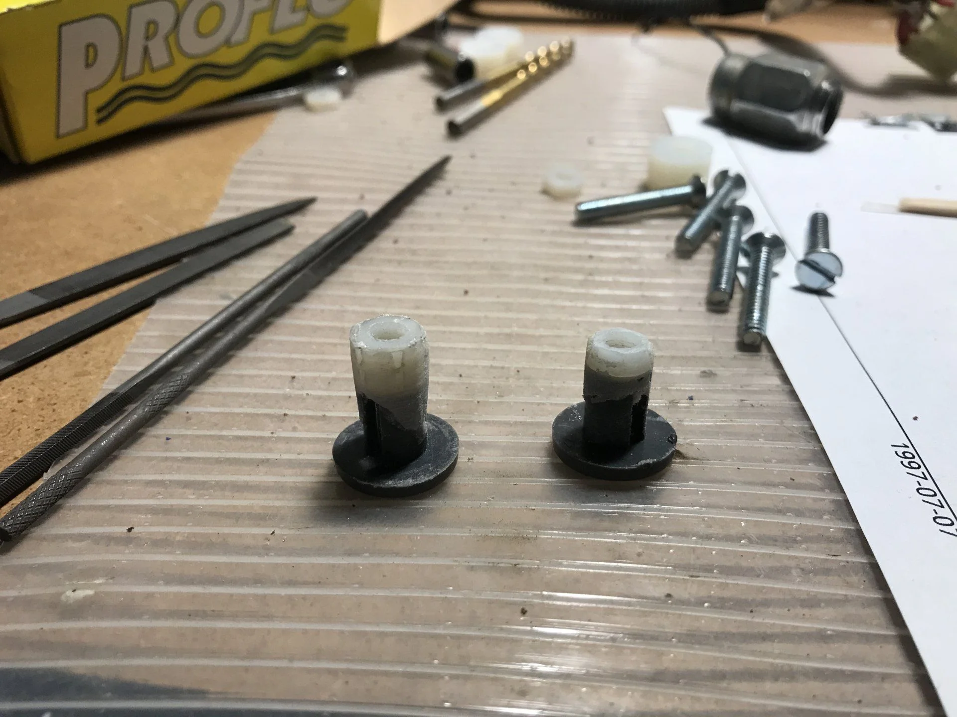

5. When removing the cargo carpet, remove from back to front. The front is attached with the same snap grommets as the second row interior steps. If you pull them out, you will strip them. I fixed mine with some JB Weld and #10 screw retainers.
6. It is a bit of work to do the same with the step grommets. You have to sand the epoxy to the point you loose strength. Mine are holding, but I expect they will fail with use.

I think @NLXTACY is making those step grommet thingies...
