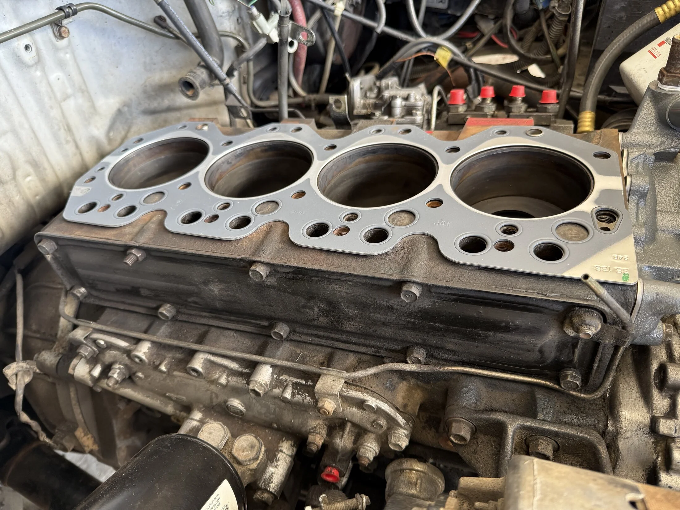

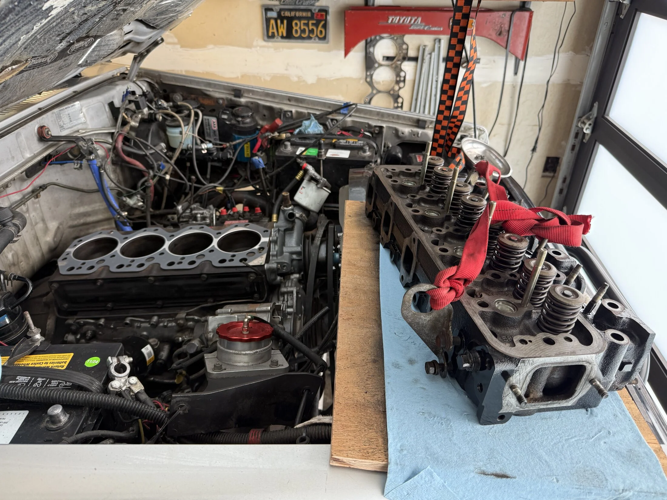

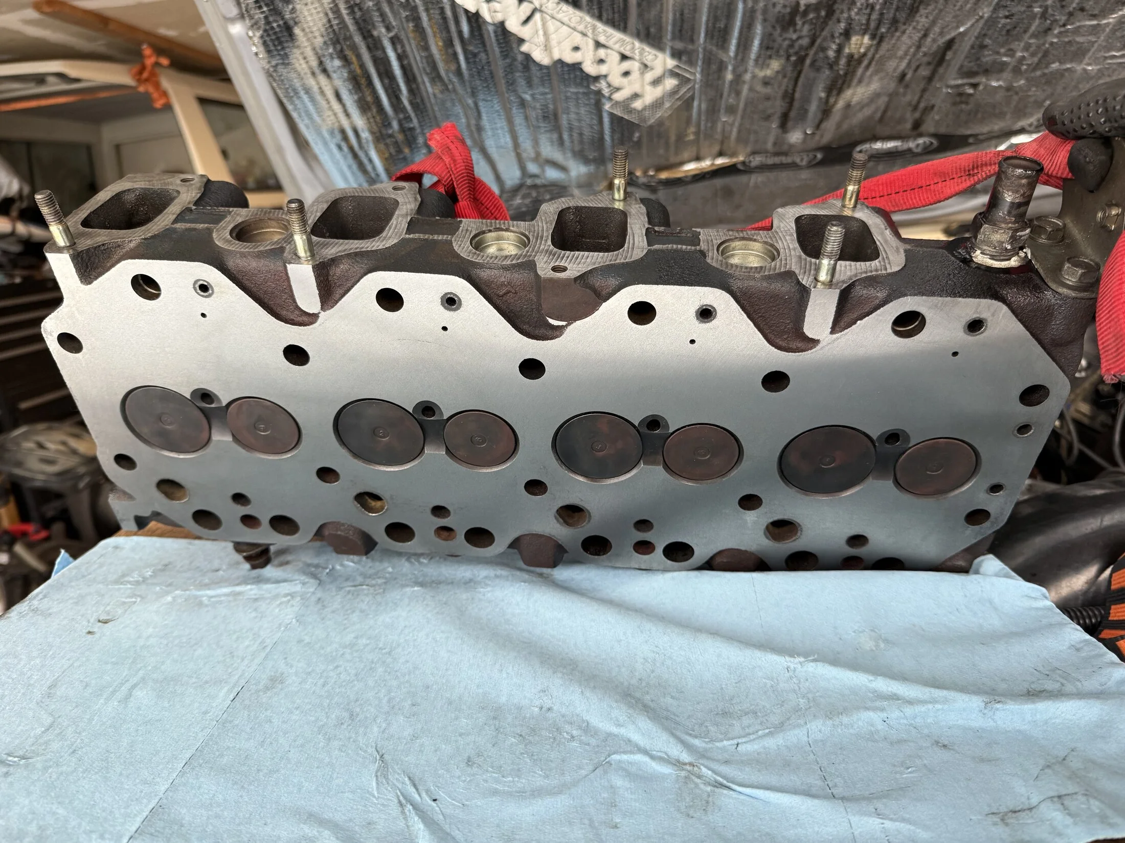

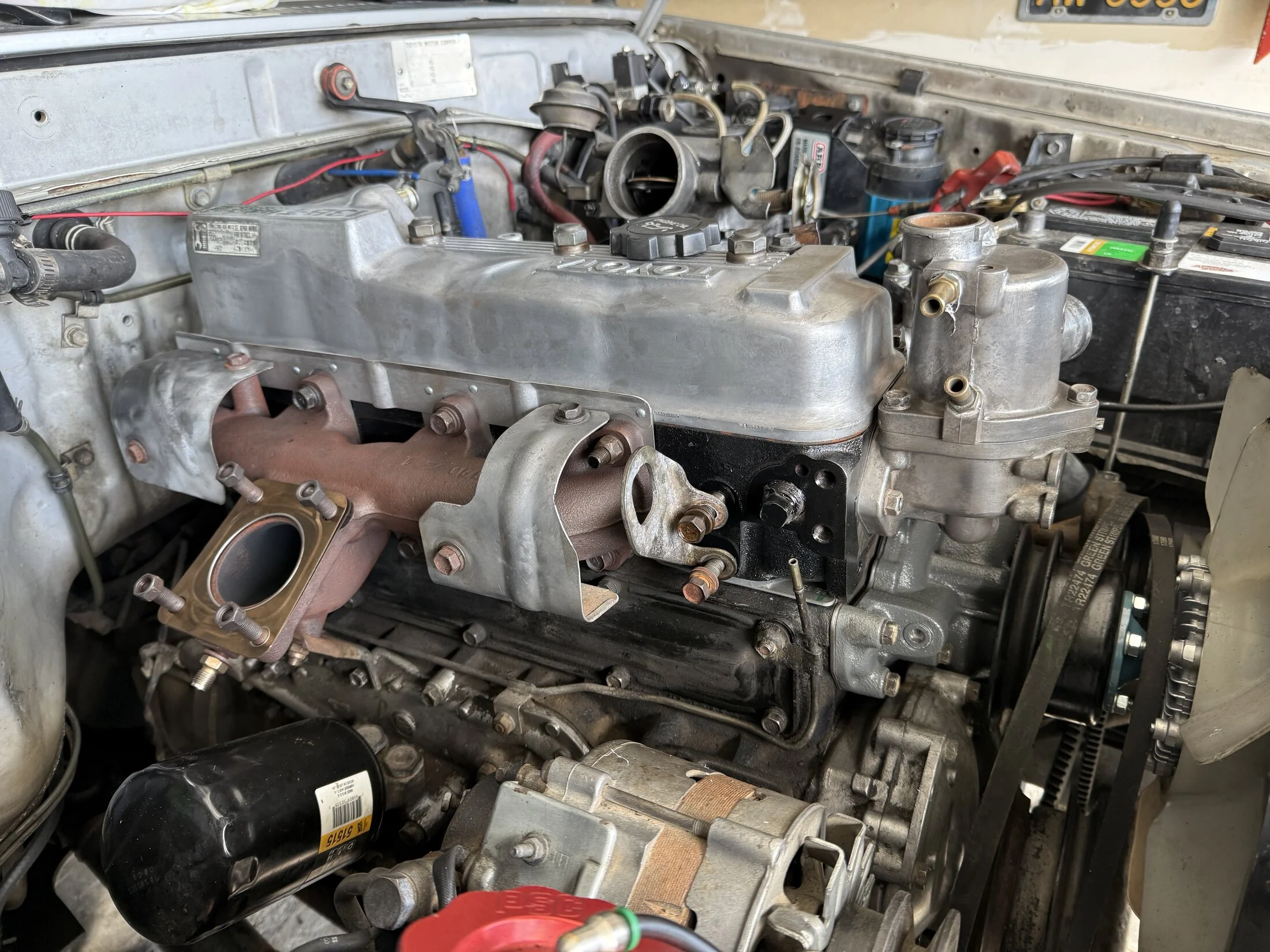

Head gasket job almost done. Waiting on my re built injectors and see if I did it right😂 all new hoses. The bypass hose was split inside.. glad I put all new rubber hoses on.

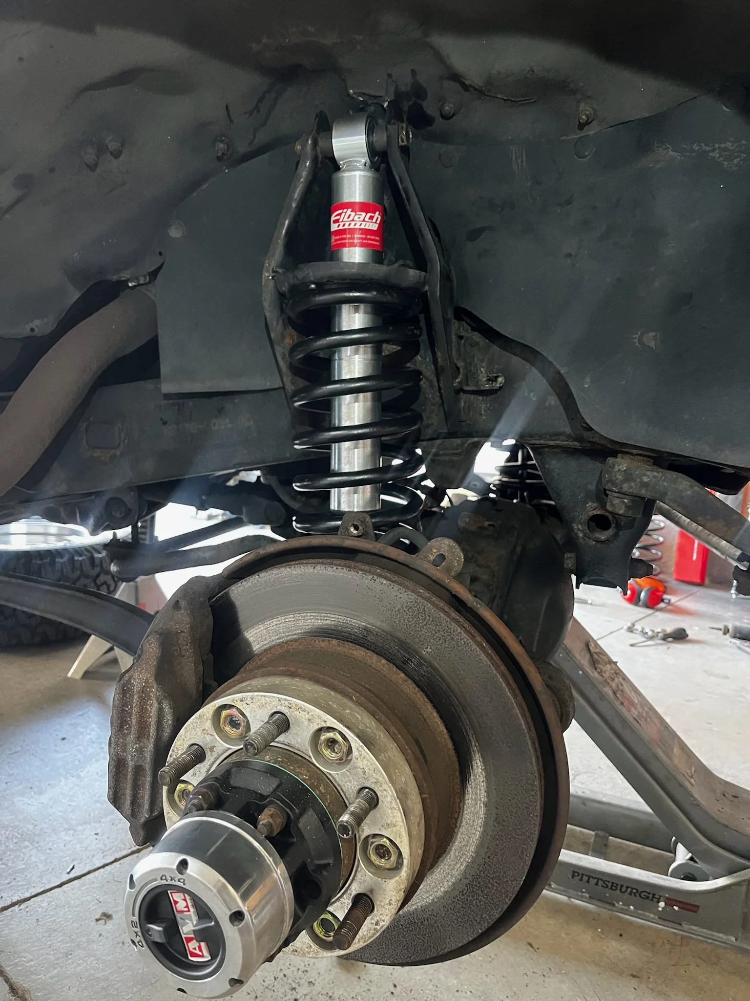

I work for a suspension company so I brought a couple home to test on my KZJ. We dont offer anyhting off the shelf for this platform. Lining up compressed/extended is no problem, but since my factory shocks are blown, its a bit of trial and error when it comes to the valving.
Also installed the infamous AVM manual hub locks. Time will tell if they hold up. After installing the hub locks, I soldered in a 50 resistor at the e-hubs plug to avoid the flashing hub lock light that most people run into.
I left the 4-stud mounting design in place in case I chose to go back to e hubs, but if these are ok then I'll swap the studs out for the included through bolts provided.

Hopefully your field research might lead to a couple Land Cruiser 70 Series entries on your companies Application Search. 😃

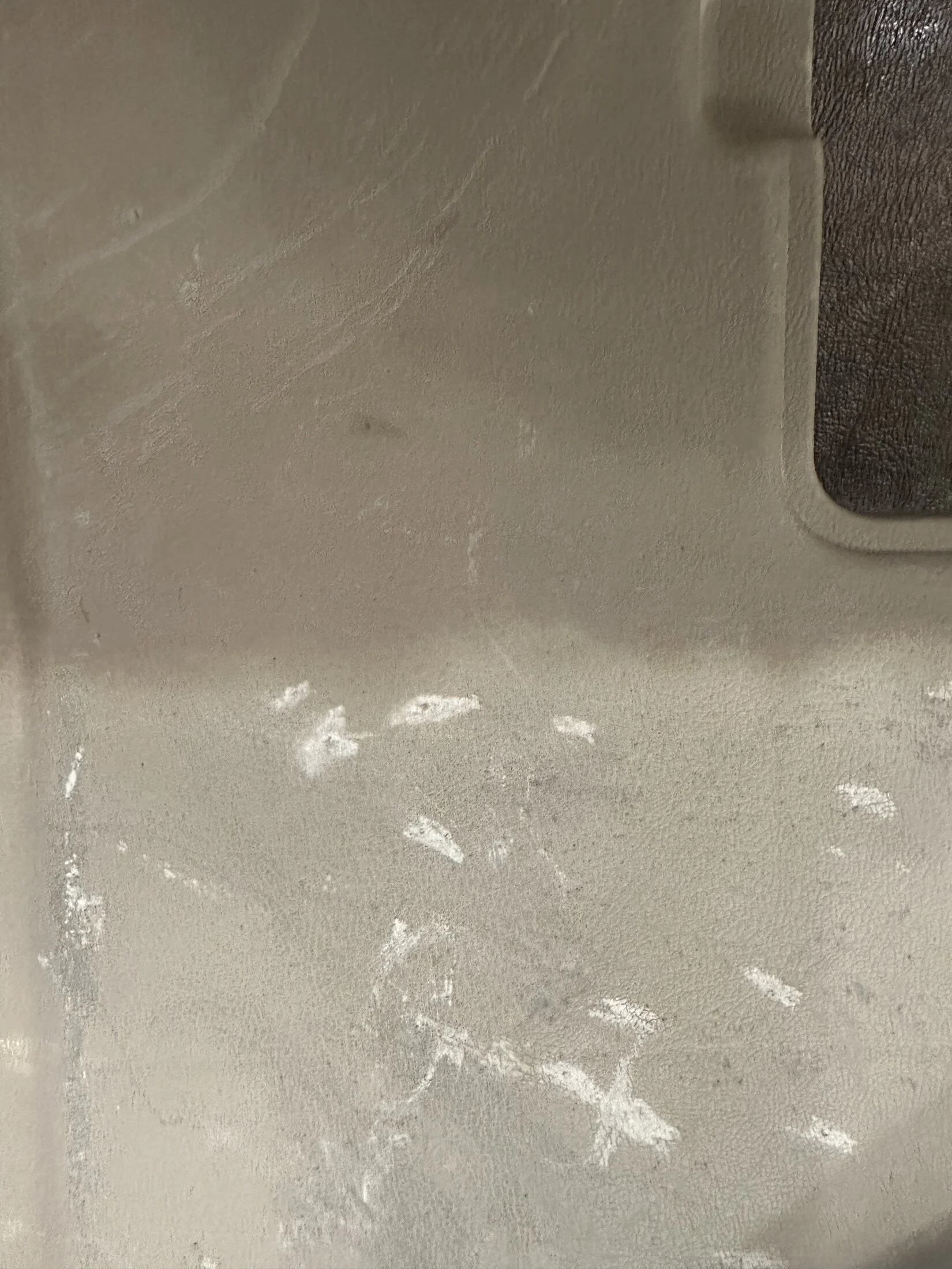

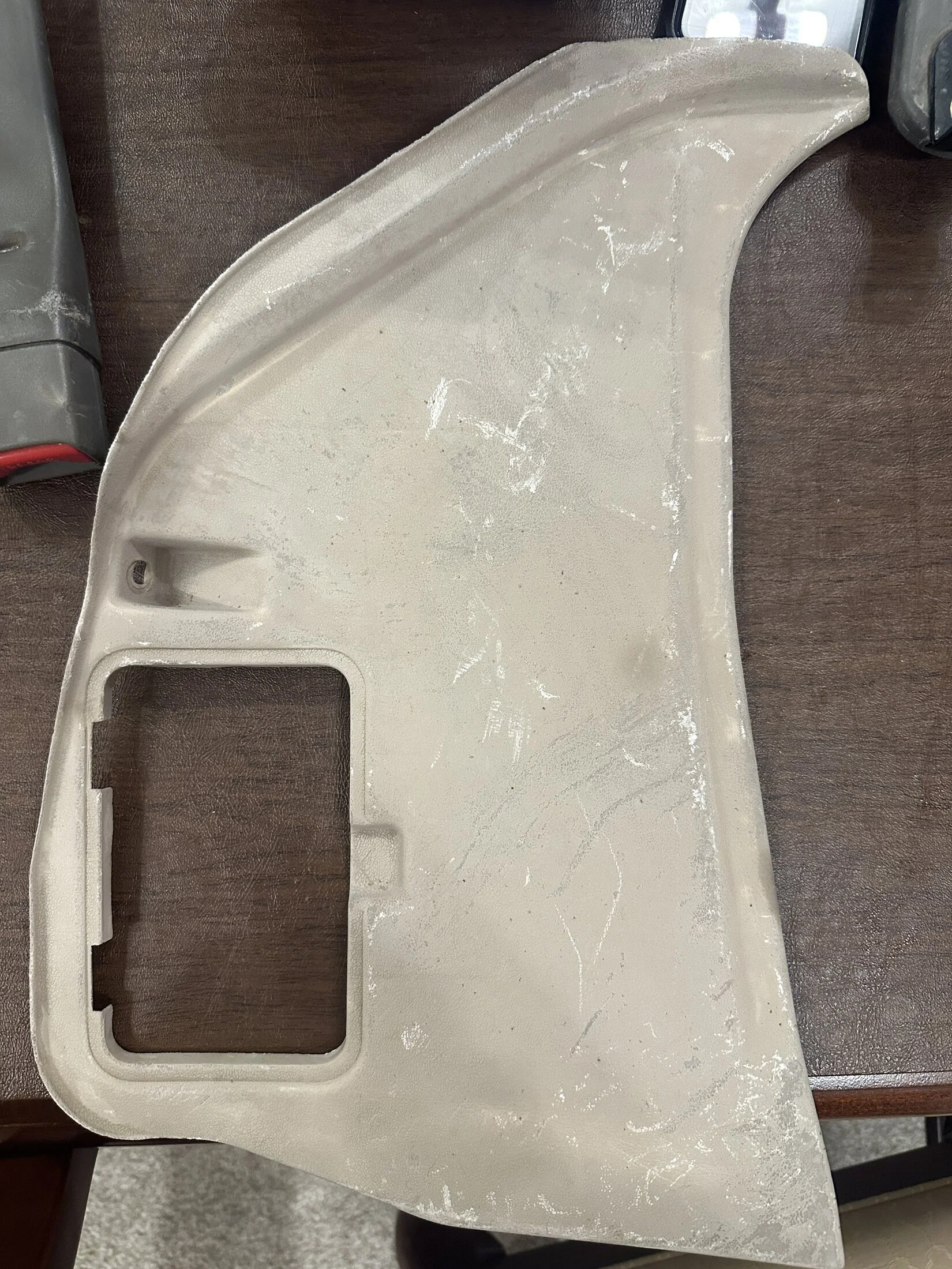

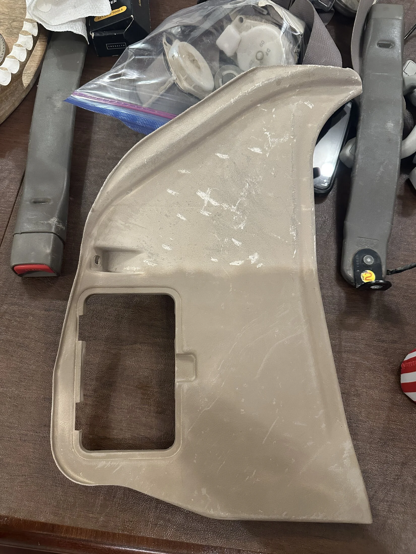

Did a little heat gun restoration on some rather rough interior plastic I grabbed from the salvage yard.
Quite far from perfect, but considering these had likely spent many years exposed to the heat, sun, and elements, and I am pleased with the results. One example below.
Before:
Top half of part heat treated:
Close up:
After with a healthy coat of ArmorAll:
Final photo accentuates the remaining scratches; looks even better in person. Still very clearly not new from the factory, but not too shabby at all for a piece of plastic that has lived a very rough life, in my opinion.
You can paint it with fine texture and it all will disappear. 🙂

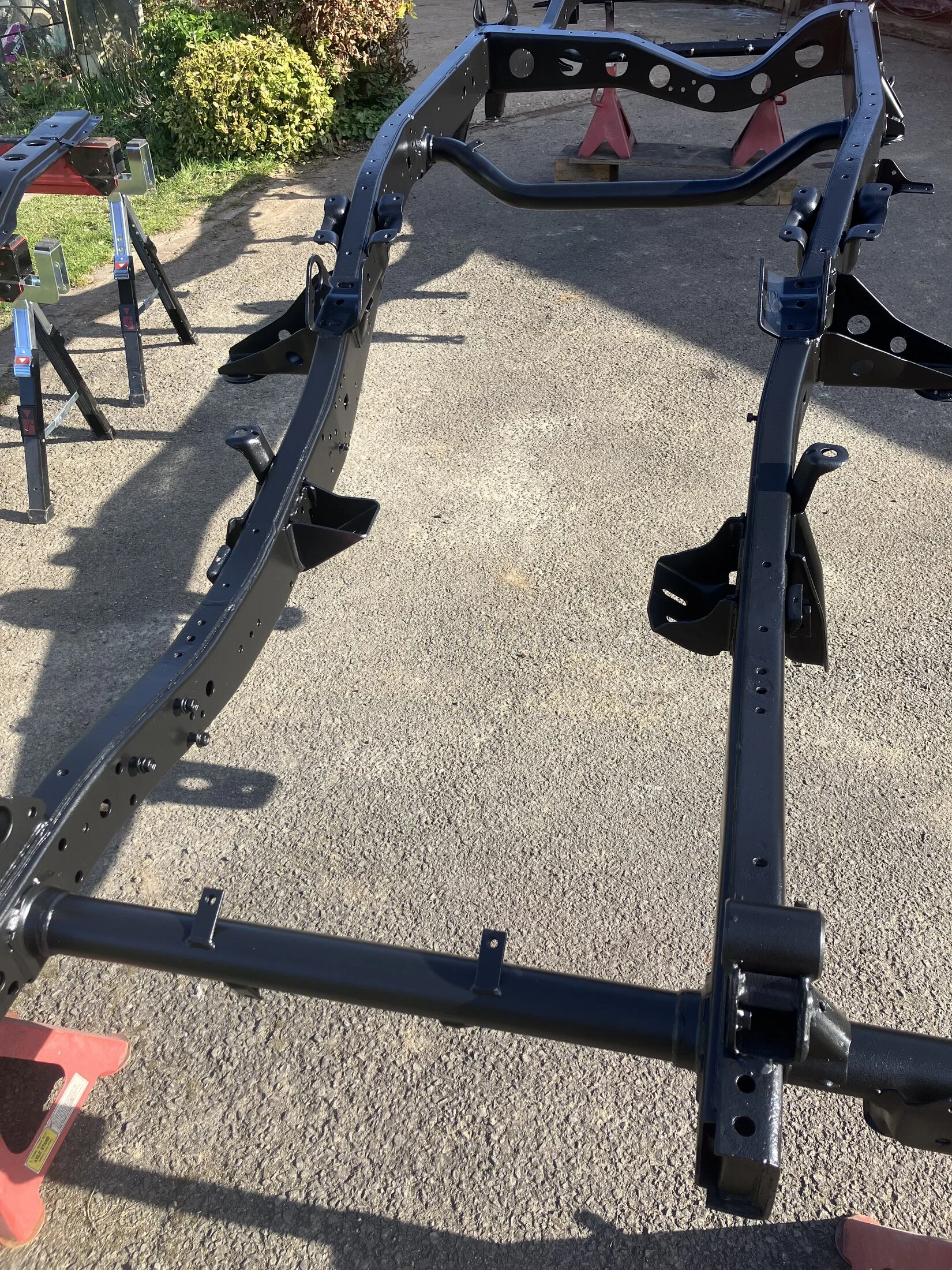

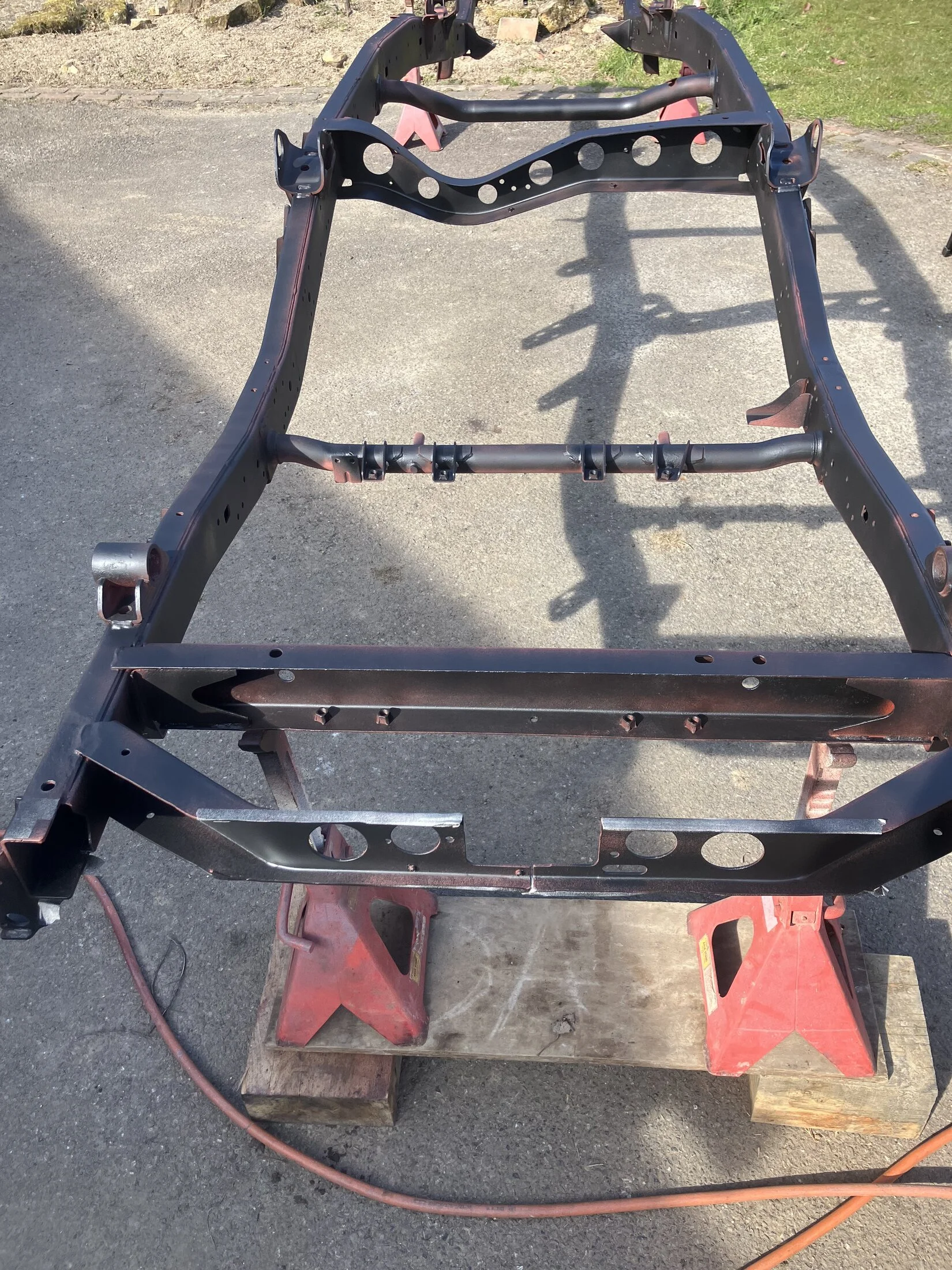

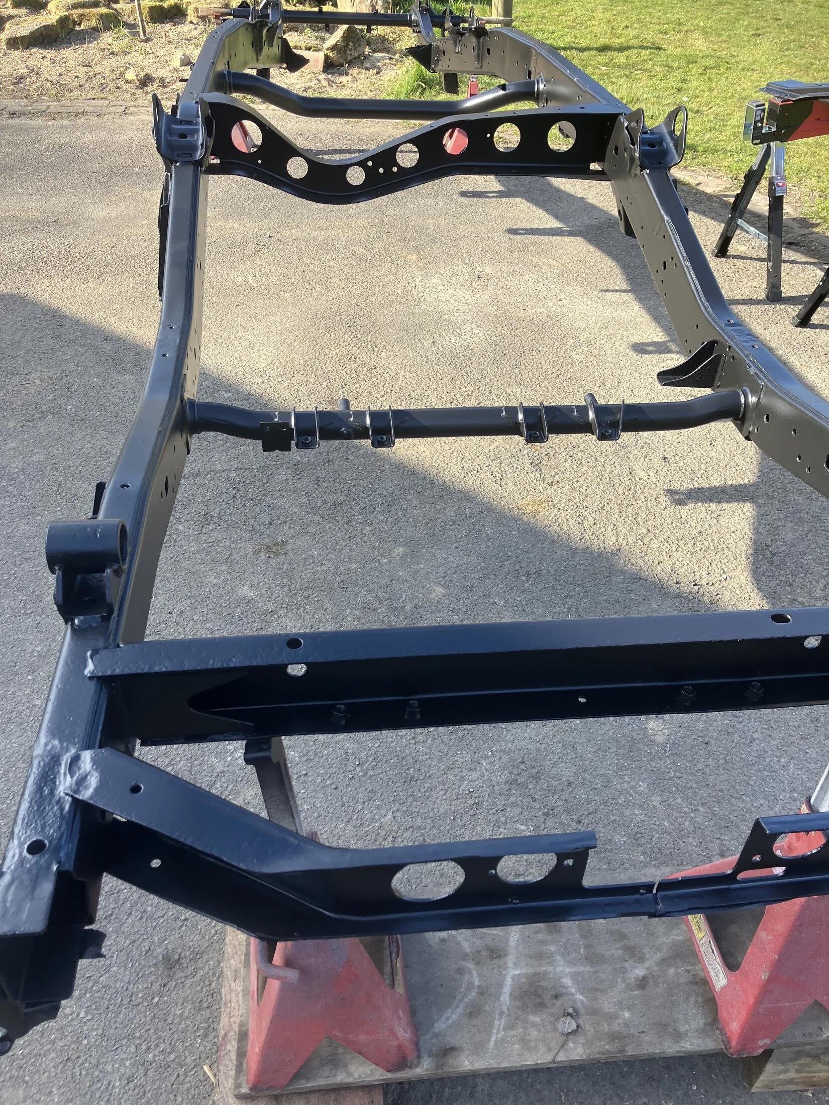

18 degrees, full sun, a slight low humidity easterly , and the Mrs went out!
Chassis paint then.
Two coats of semi thinned , to tack the next two neat coats. Thick old stuff, with the pressure upped, and spray pattern altered she’s all black and looking good.
Thought I’d do the underside as it’s the recipient of all the worst of debris , and under the chassis to do topside. On inspection it all seemed great. No doubt missed the odd bit, but easily rectified . Once cured Ill flip it .
