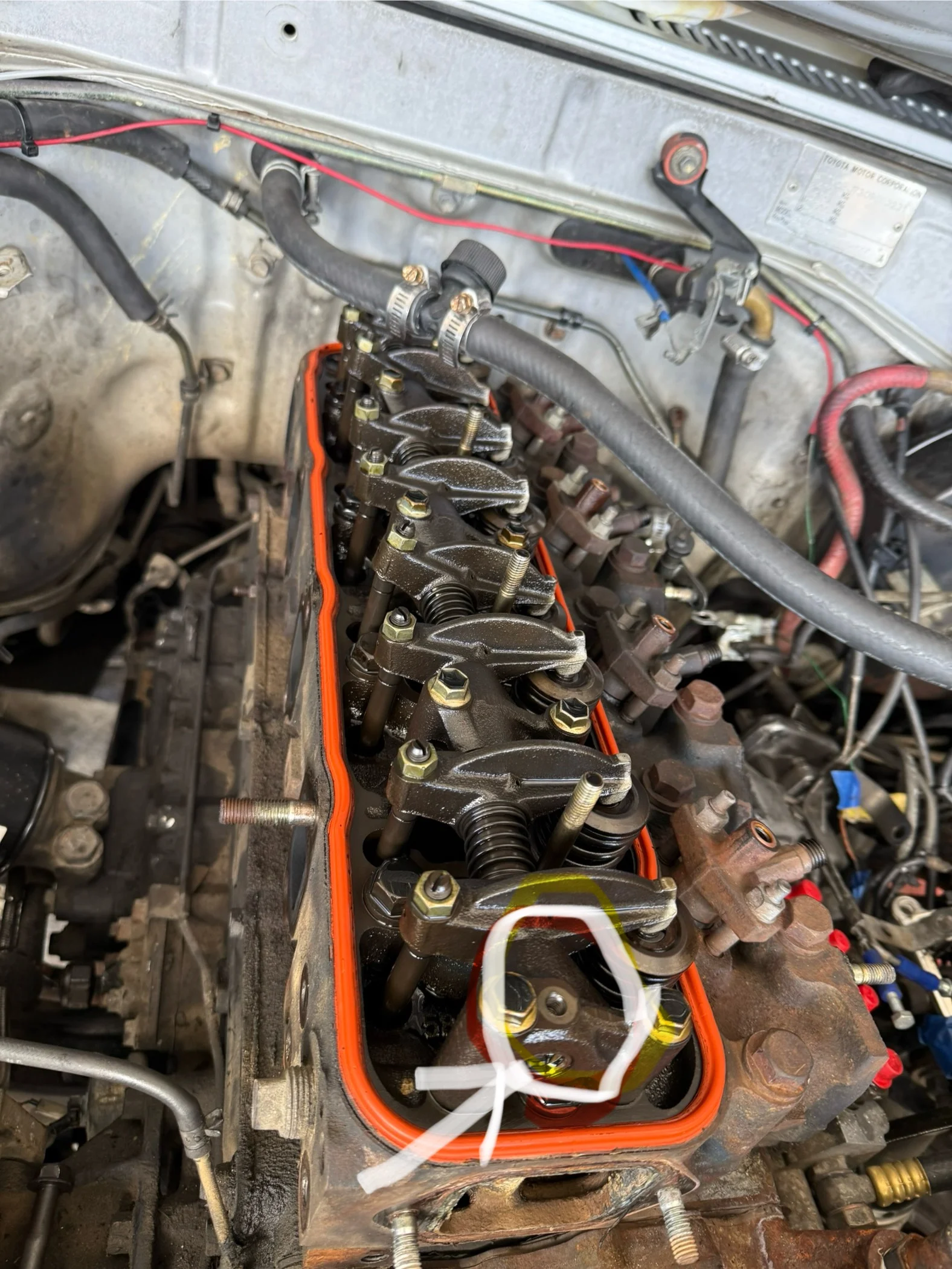

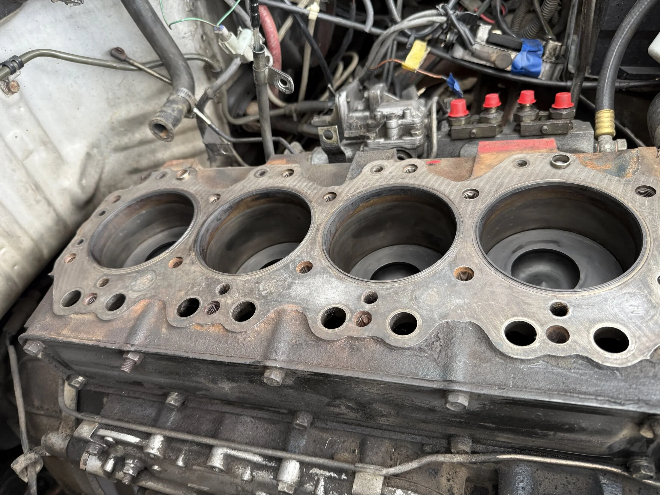

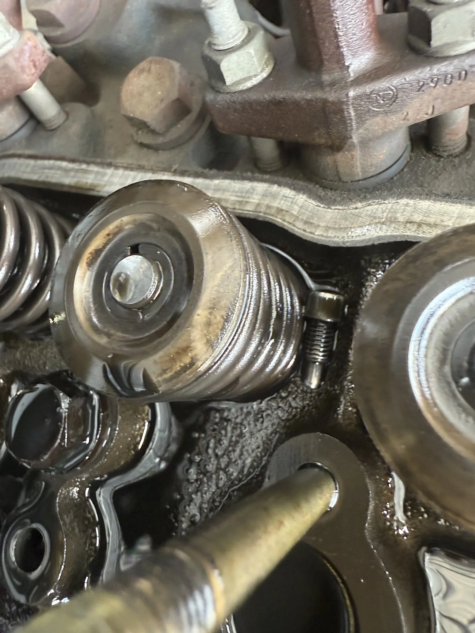

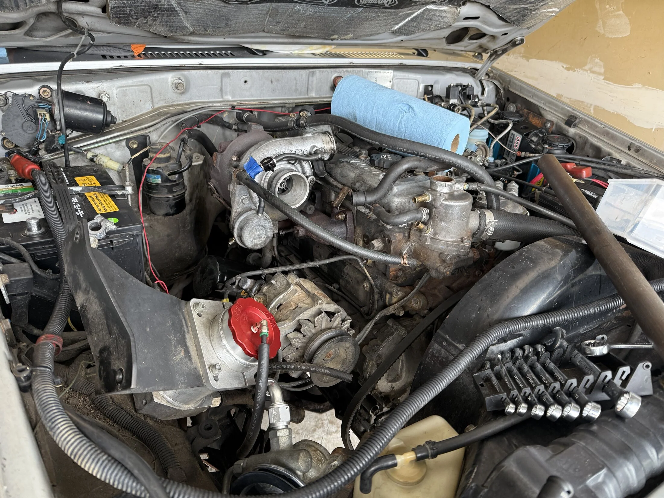

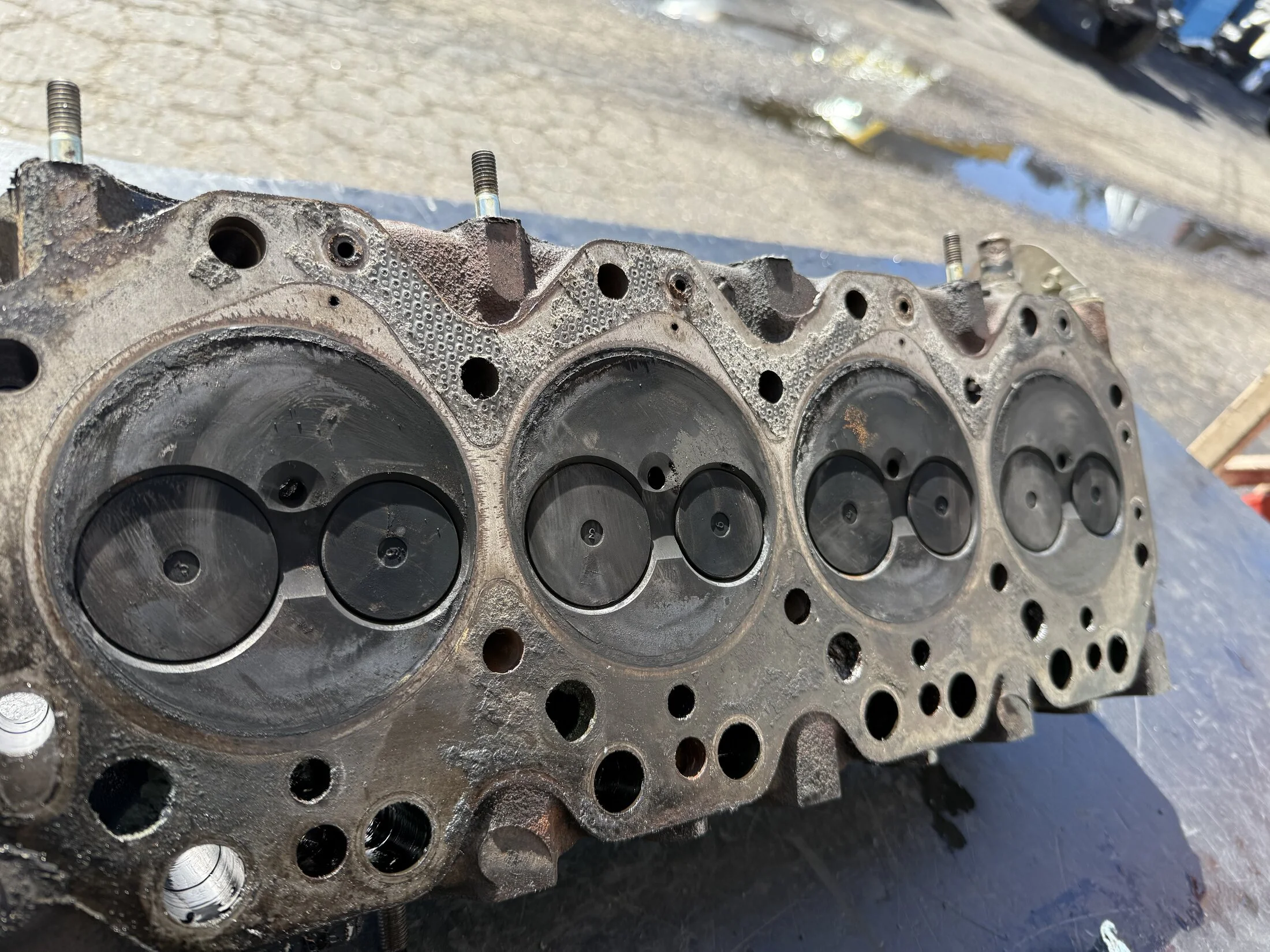

Head gasket time! Drove home 5.5 hours from Death Valley on it! These are stout little motors.Head is getting decked/ injectors tested, new water pump and thermostat/hoses being replaced.No cracks! Internals are really clean so hopefully will be good for another 2-300k. Glad I did it.. the set screw on rocker assembly backed out and luckily did not fall in lifter or oil drain hole.. it was wedged next to #3 valve spring

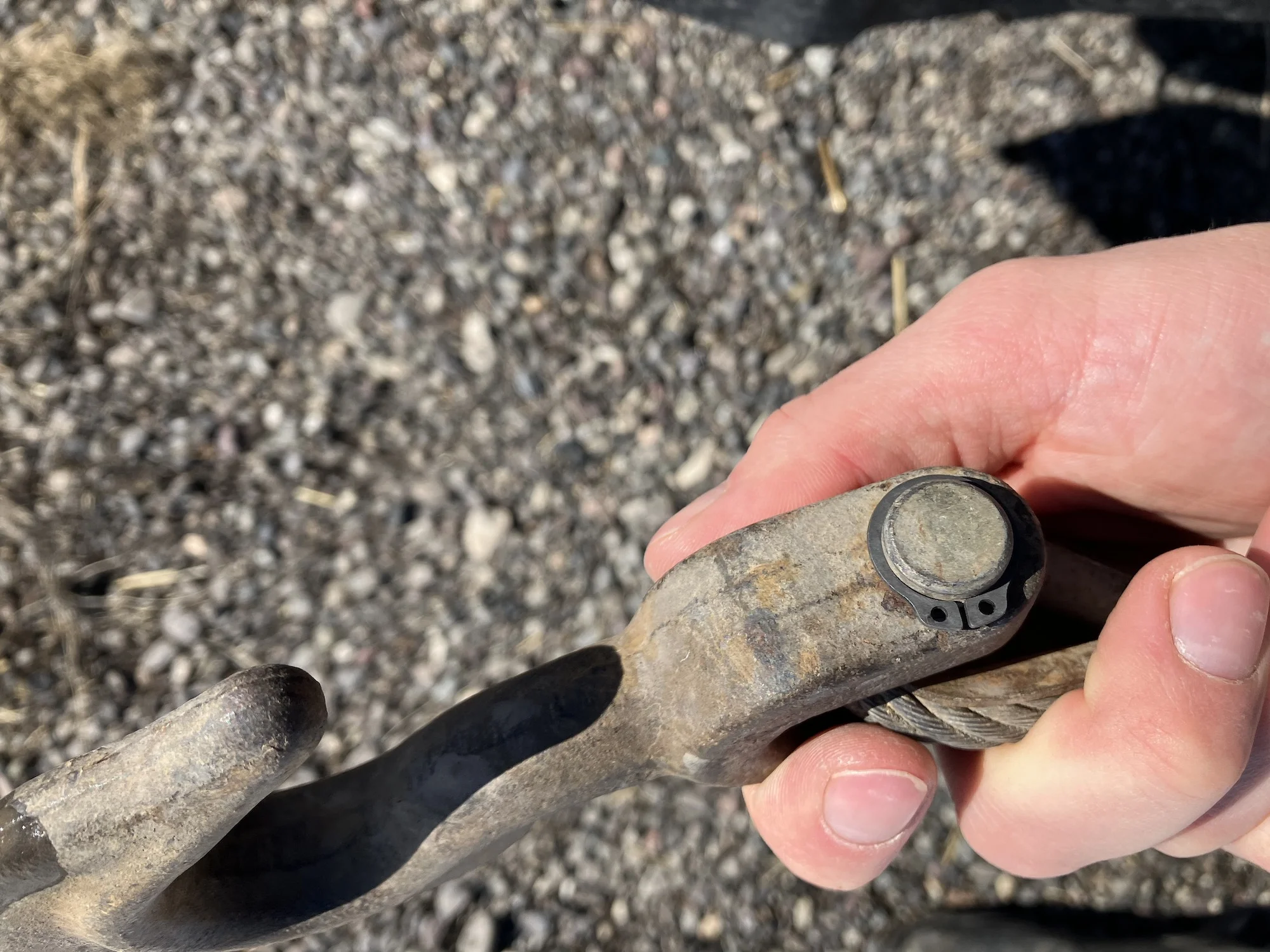

Discovered that the snap ring on my winch hook had come off again, so I got a new one from the local hardware store. Hopefully this style hangs on a little longer than the old one.

Any reason for the HG failure? Overheat ?
This was on my new to me BJ73 crawler. I’d say age, lack of coolant changes over the years caused it along with it being original composite Head Gasket not MLS. I’m going to preemptively change my other BJ73 3b turbo one next with a MLS one as well. I’m pushing 16psi boost and the long climbs under full boost did not heat up but rather filled the resivors to overflow. My other 3b is set to 10psi with the Diesel 42 kit.
Ahh yeah, the composite don’t like that extra boost. You should be good to go with the MLS one.

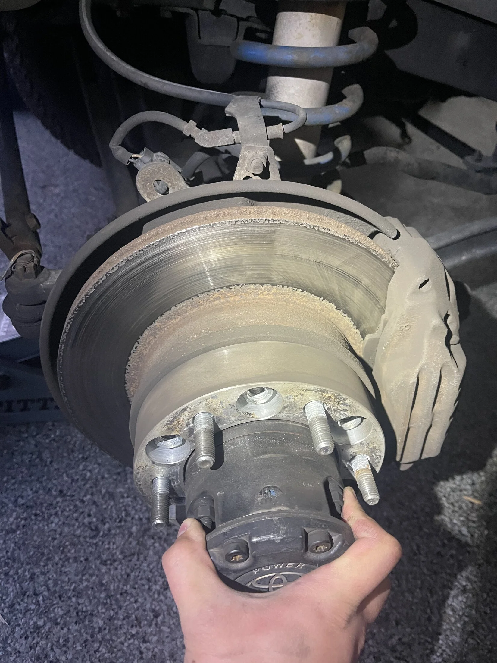

Driving my Kzj78 and within the last two days I’ve gotten some intermittent clicking sounds in the front passenger side. Lifted the vehicle and I can rotate the tire by hand to confirm it’s that side. Removed the wheel and I grab the hub as shown below, I can wiggle it and the brake disk moves, creating the same sound.
Is this a bad wheel bearing or something else?
Yeah, your wheel bearings are loose and should be replaced. Probably not a bad idea to tackle a knuckle rebuild at the same time depending on when it was last done and what kind of shape your knuckles are in.

We have our other car in the shop at the moment so this is our only car for now. Knuckles look good and they’re not leaking. Wondering if I can do just the wheel bearings for now until we have two cars again and worry about a full knuckle rebuild later.

For sure, if you really needed to you could probably just repack the wheel bearings and tighten them up a bit until you have time to do a rebuild. That is assuming that the bearings themselves aren't in really bad shape with pitting etc.

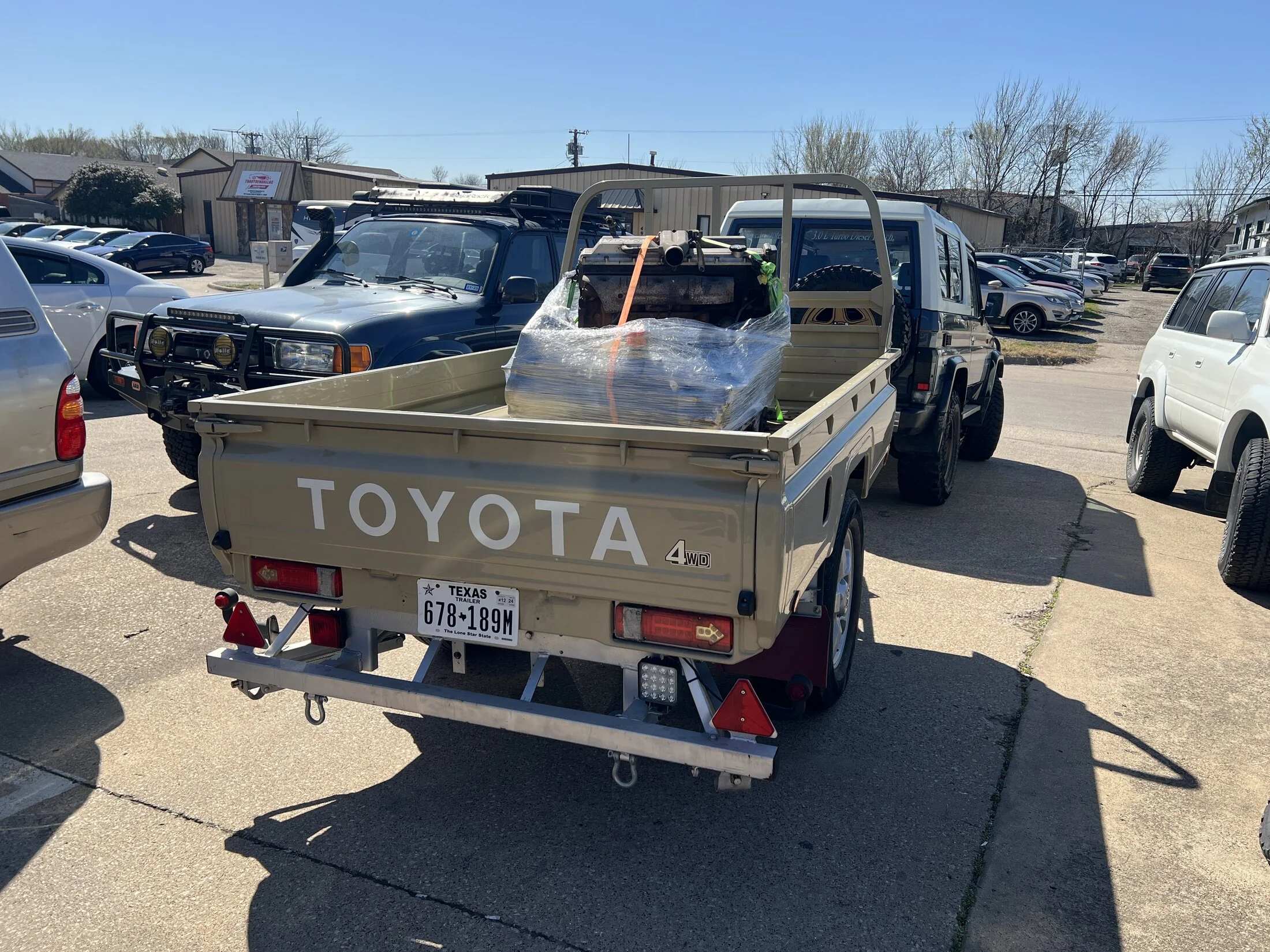

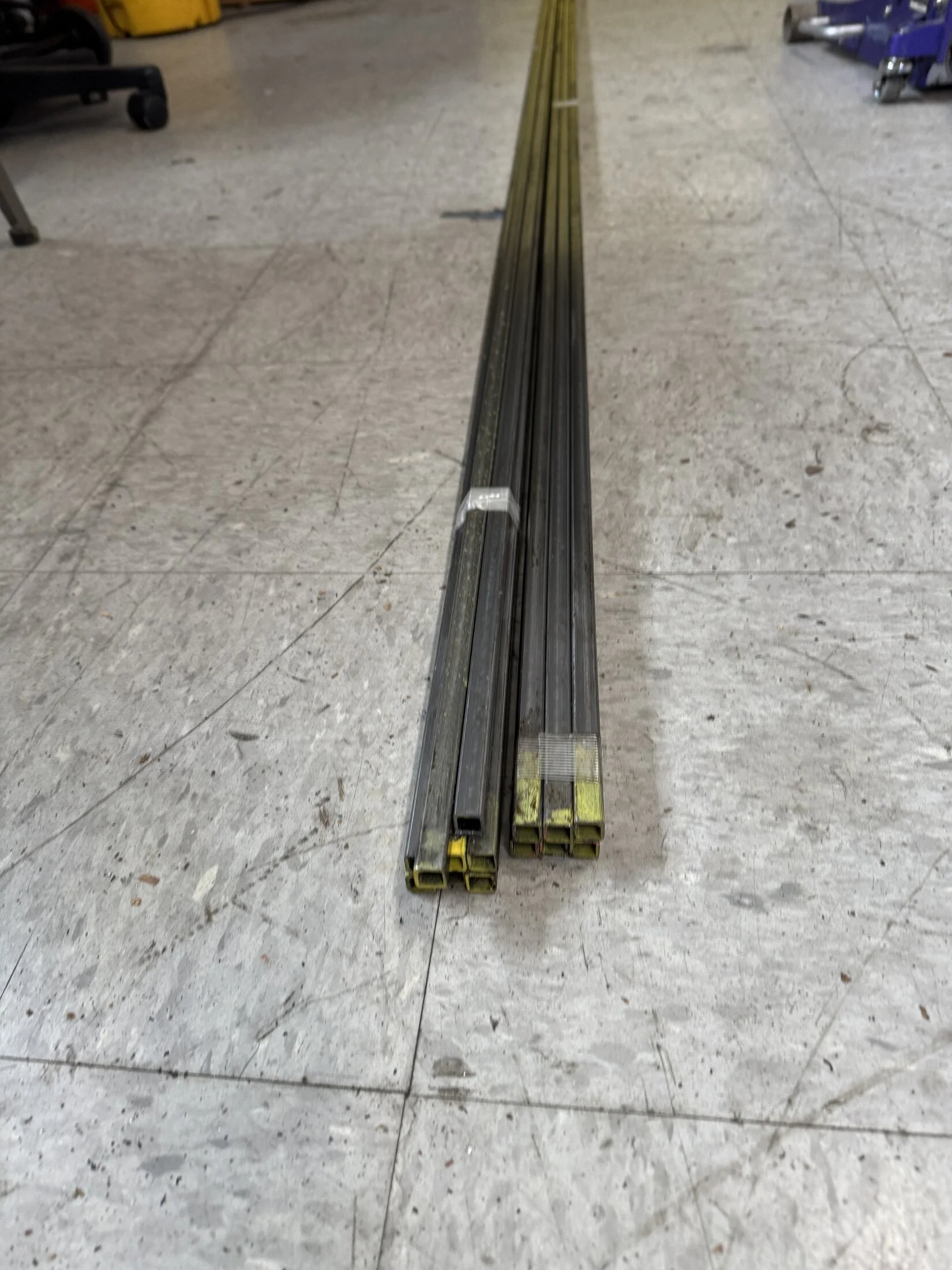

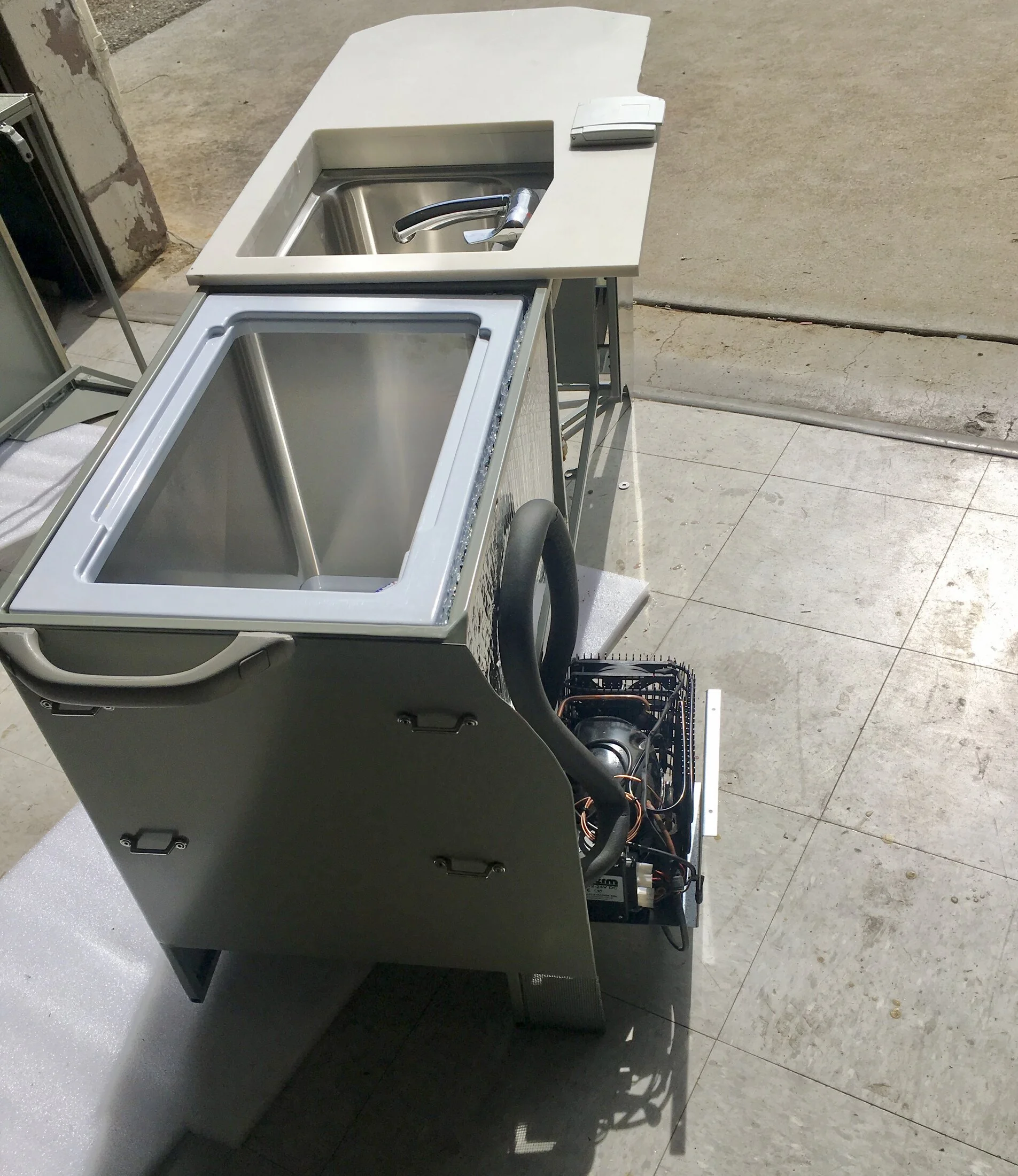

Just spent $110 on 1/2" square steel tubing (140') to build the frames of the cabinets in the back of the troopy. I am a fan of this material. It's cheap, light and easy to work with. Finishing can be with 1/4" plyboo or sheet metal powder coated. I've done similar in our 80 6 years ago and it is like new after 100K miles of travel. Photos of the 80 attached.
View attachment 3852847View attachment 3852848View attachment 3852843View attachment 3852846

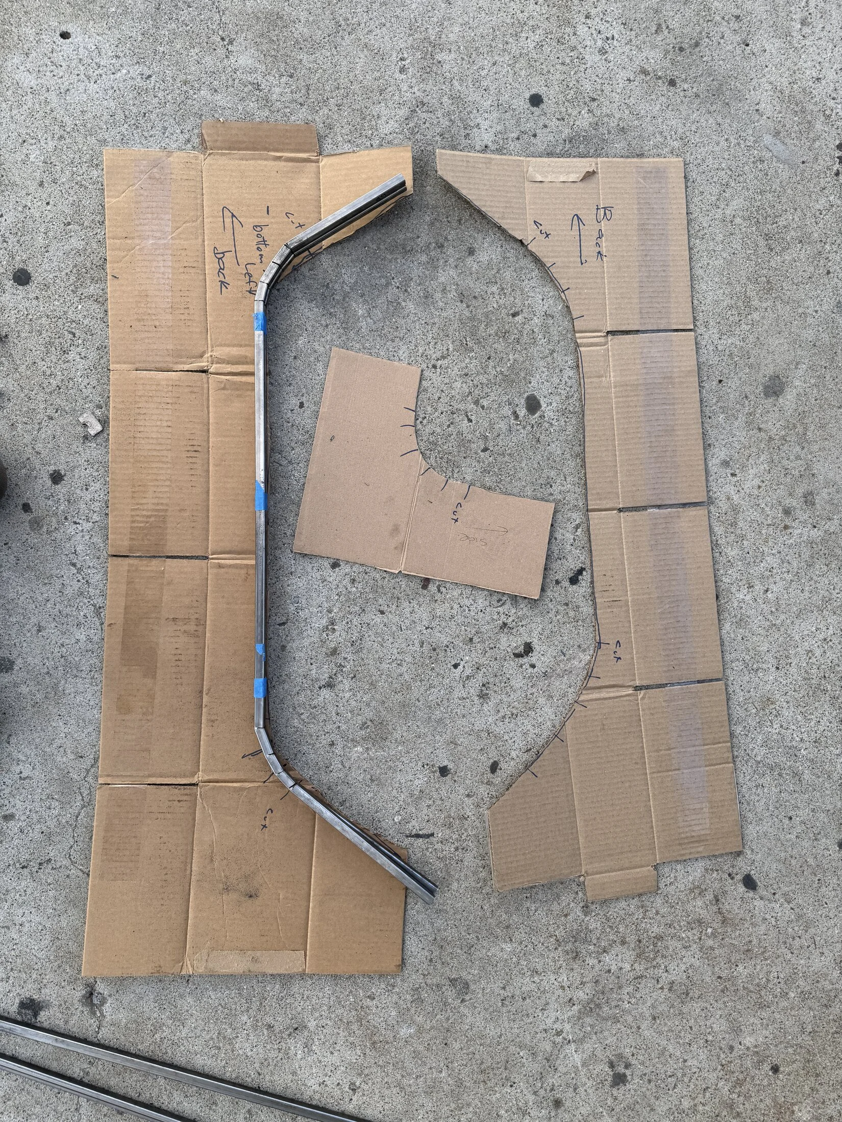

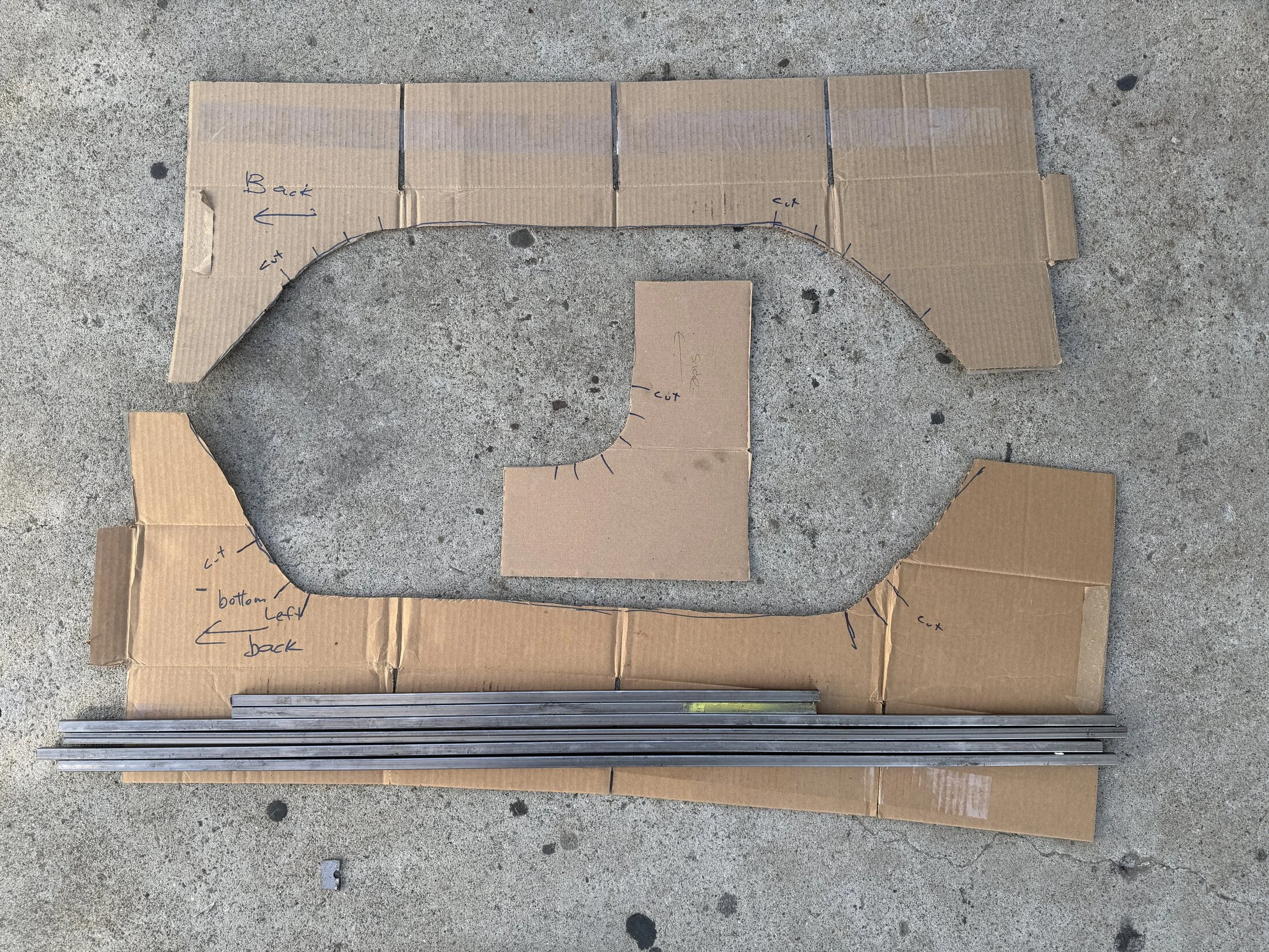

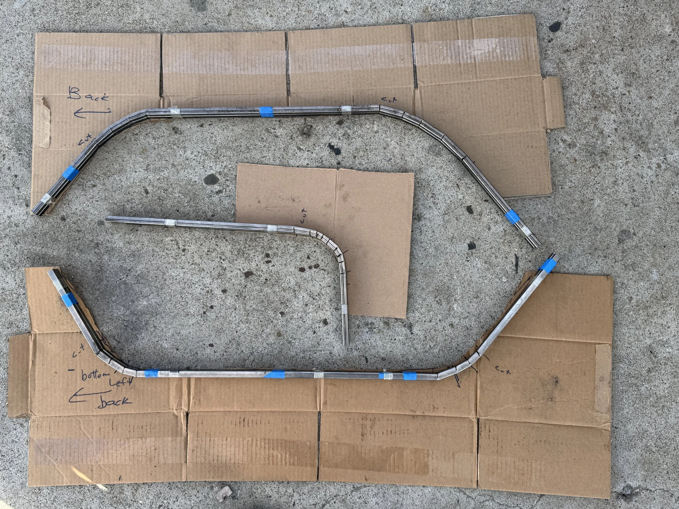

Started building the cabinets for the HDJ75/78. Hardest part is the rear fender location. I do cuts on the square tubings and then bend and weld the cuts. Use a low tech cardboard jig.
