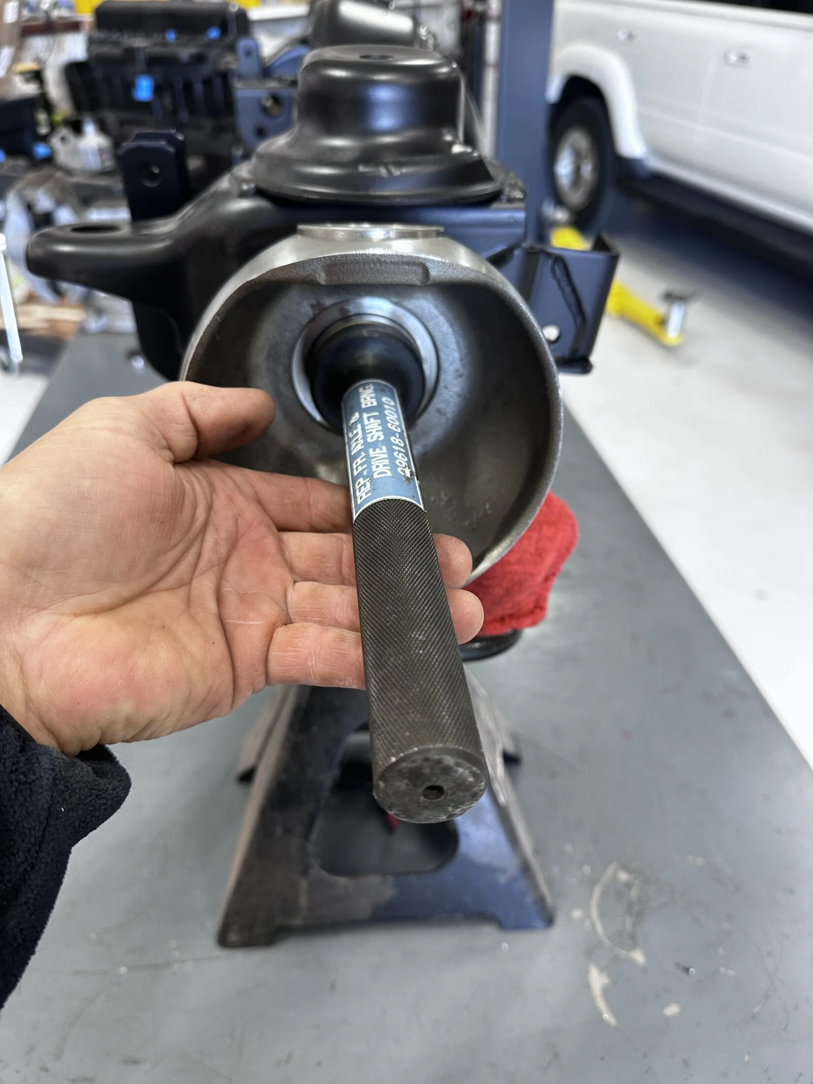

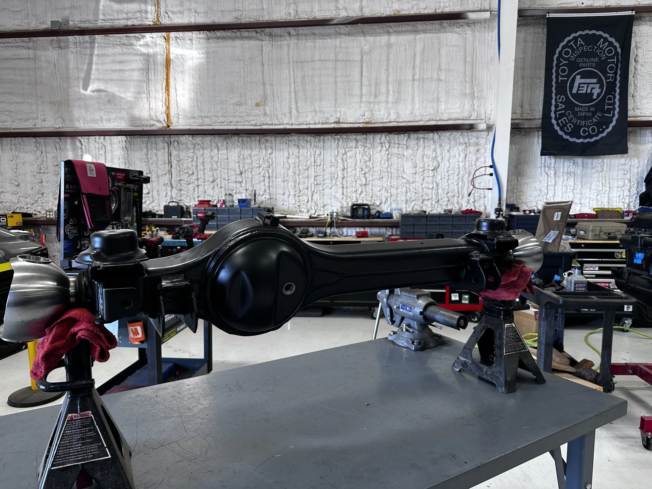

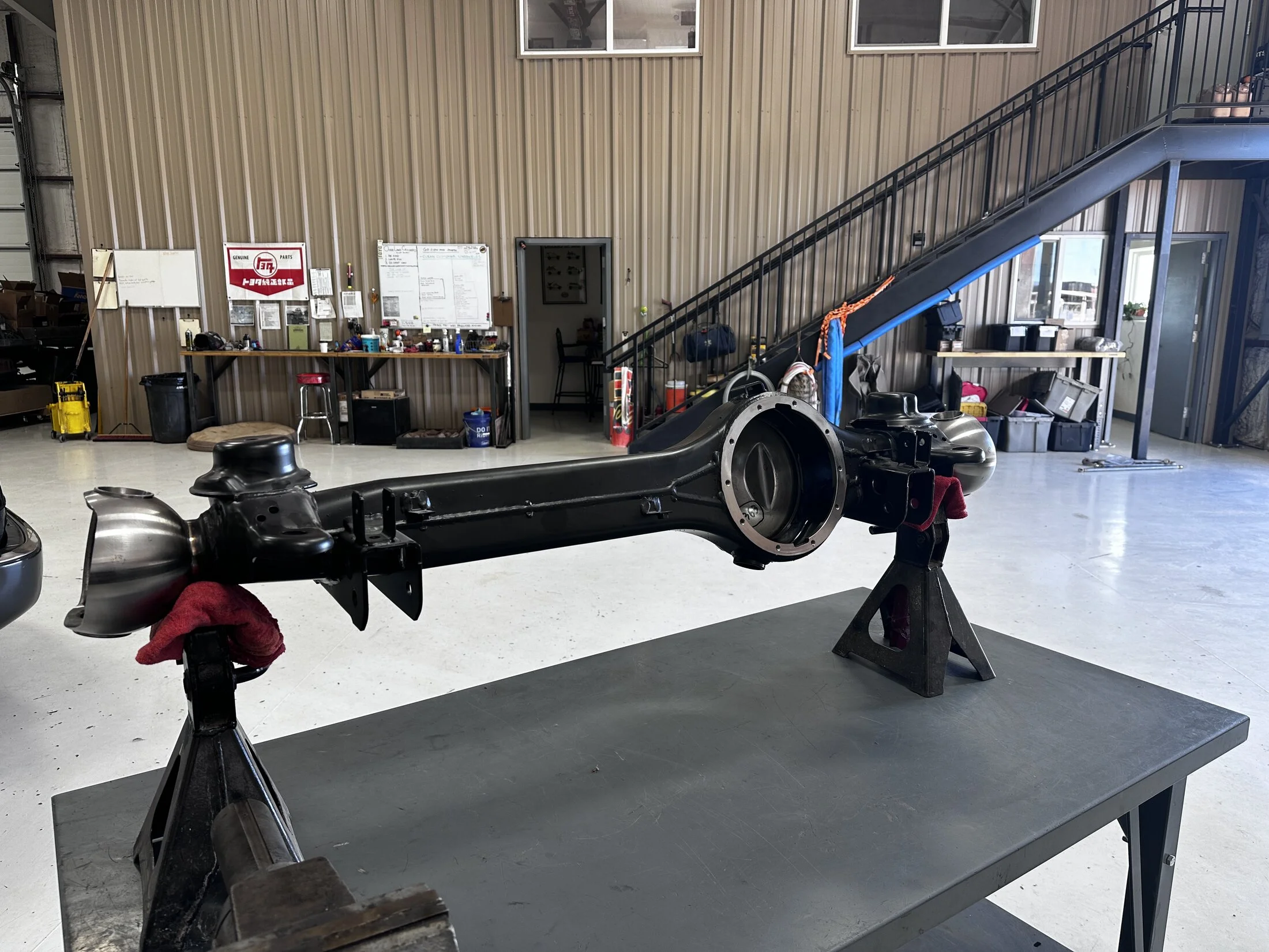

Axle building day!

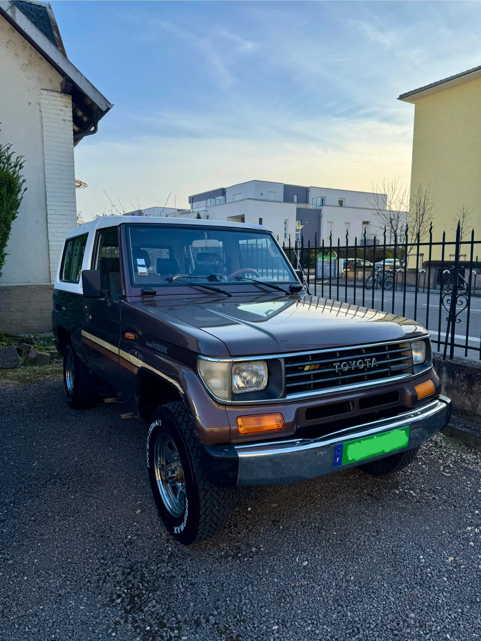

after the polish, installed a few accesories and stickers here and there, shine bright like a diamond !
the summer has shown itself already today, so sunny days are ahead !

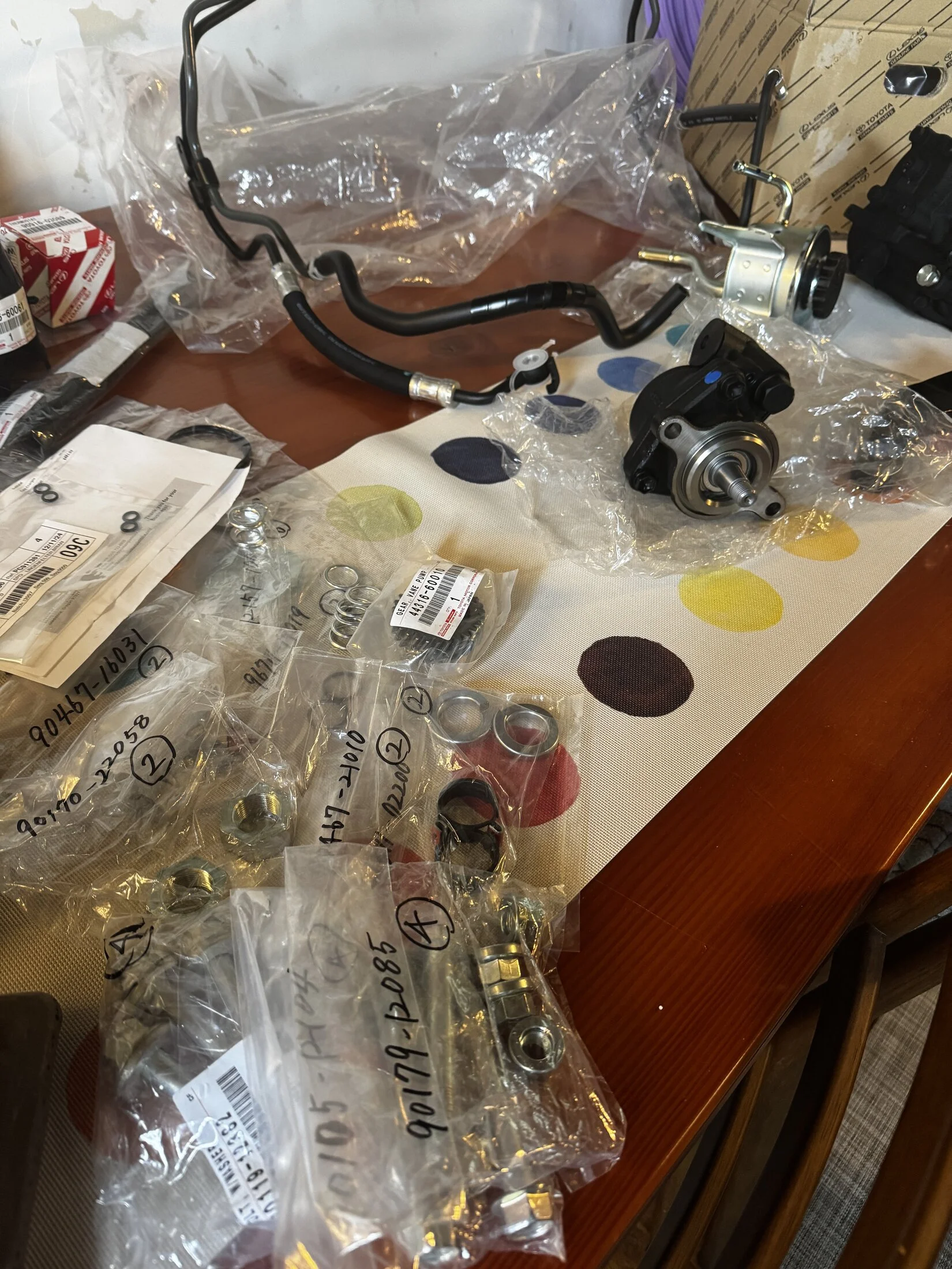

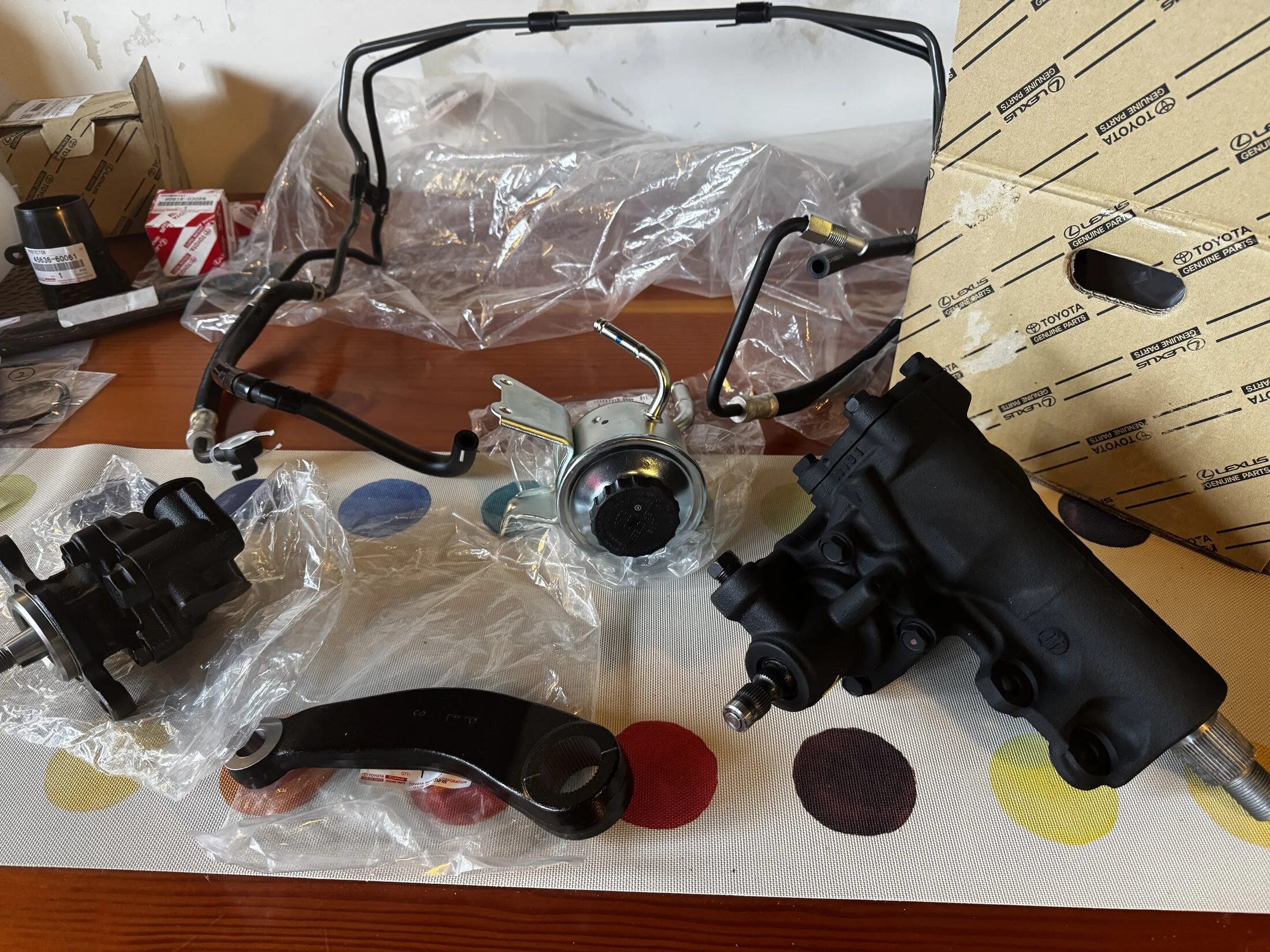

Pimp. Did you get the later gear box with the upgraded sector shaft?
You know it! Thanks to you and SNLC for your previous research/posts on the matter. Mostly RHD 79 series stuff. Made more sense than a 'rebuild' to me. But then I nickel/dimed myself with all new everything else in the area and now I'm in deep-deep.

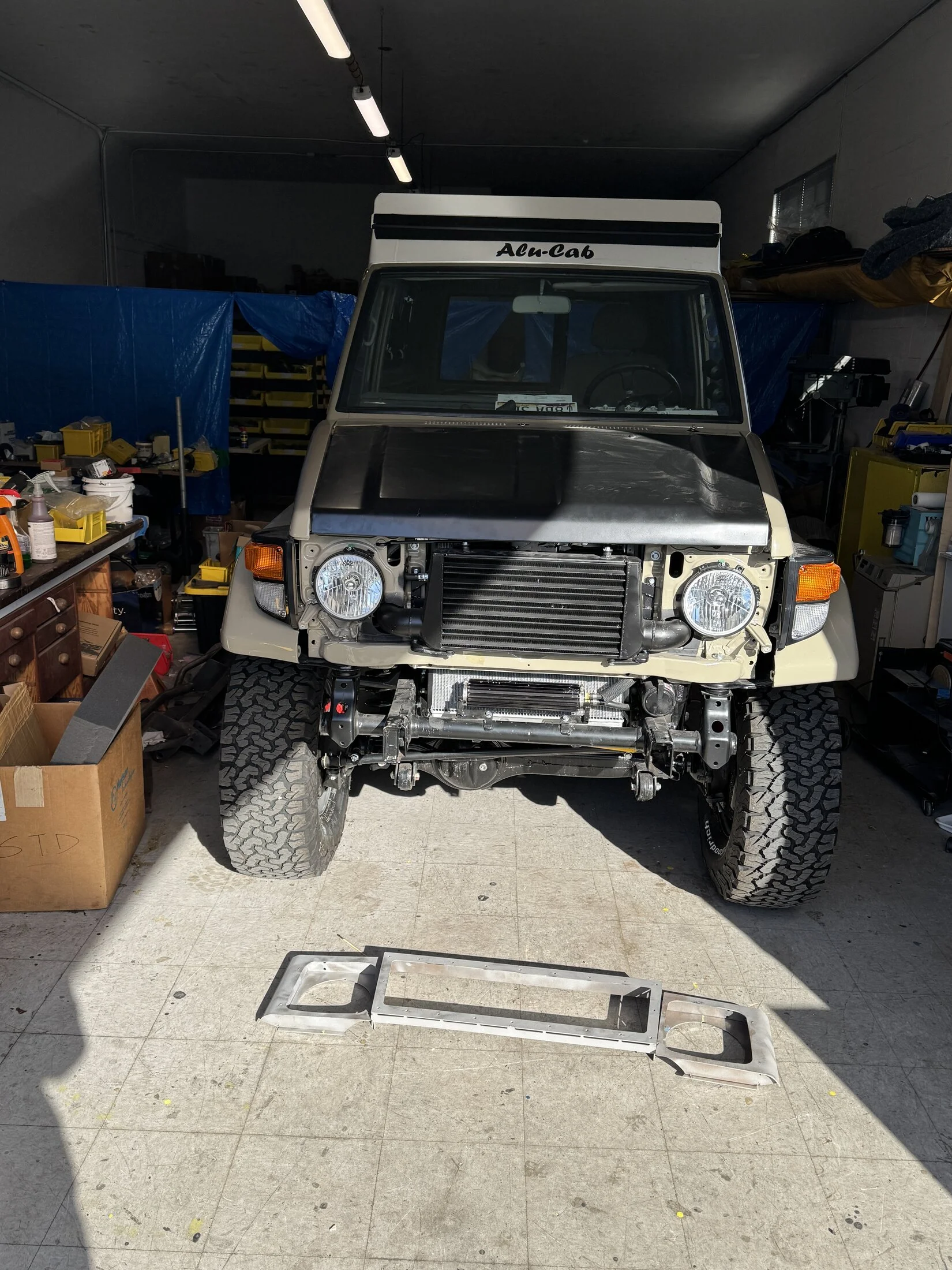

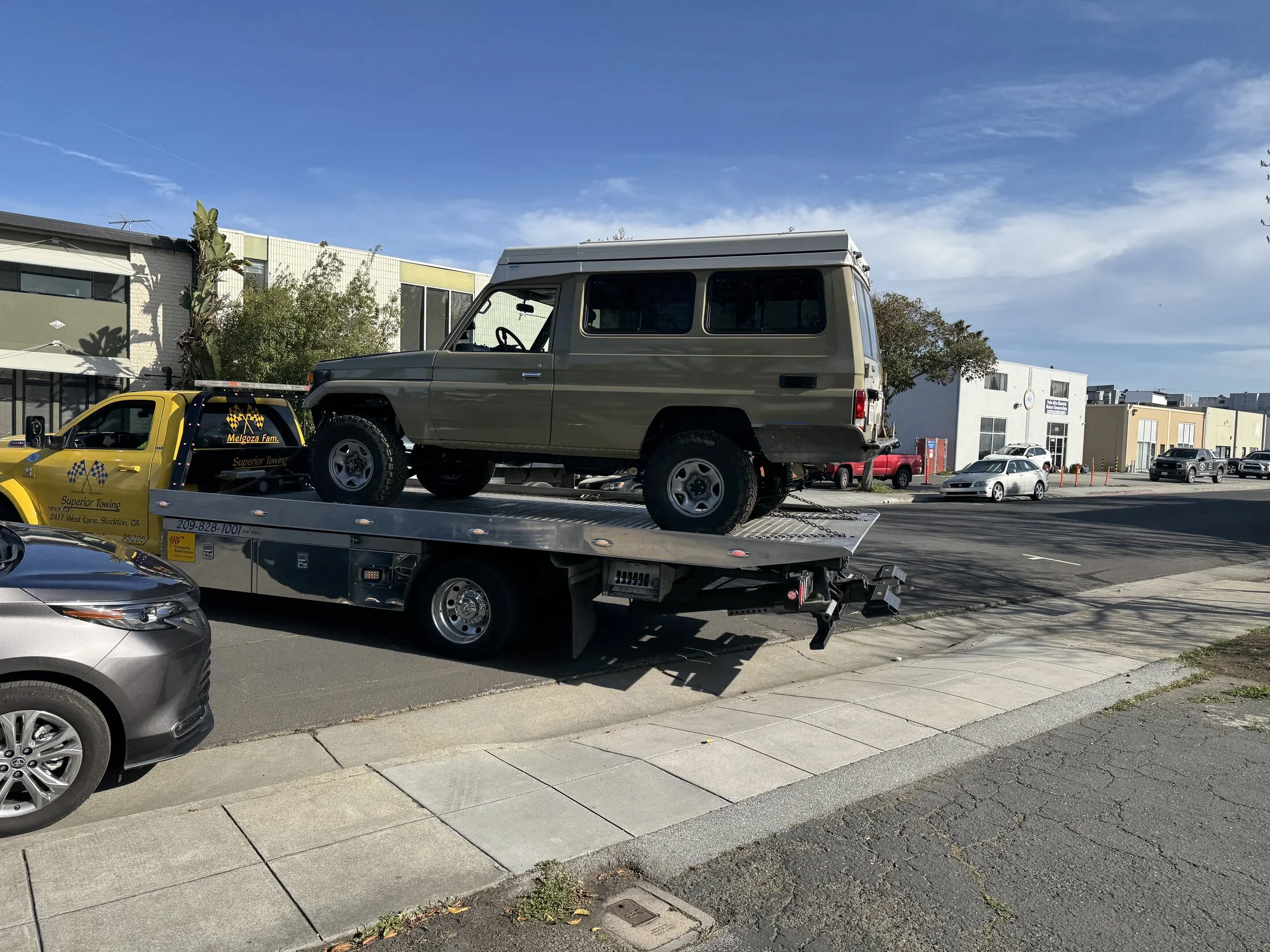

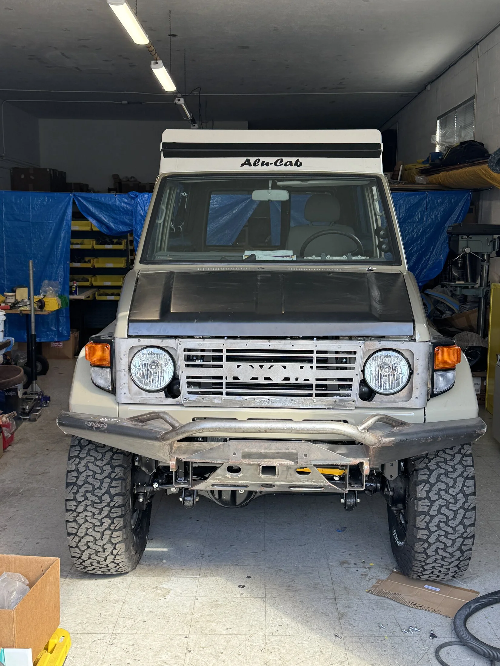

Finally troopy is moving by its own power. Picked up from @orangefj45. The crew there is fantastic. Towed it to my shop (we actually build very high end joysticks for the military drones) and spent the day today modifying the prototype grill that @kelly saad so it will fit with the intercooler. I’ll change the front screen to the small hexagons like my 80. I still need to adjust the hood and then take it all apart and install the new fenders that are being painted. Bumpers curtesy of Luke 4x4labs.

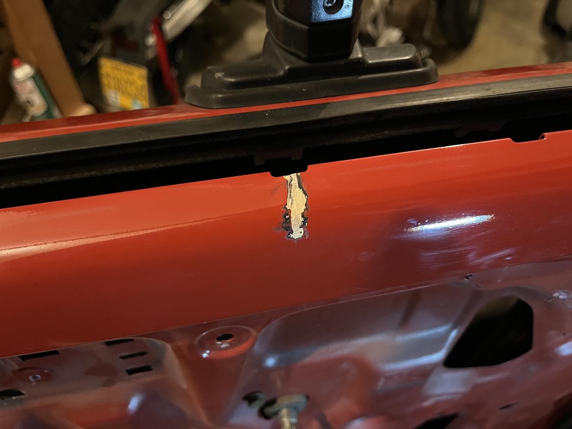

Today I worked on the Cruiser driver door a bit. I've got several issues to deal with:
  • Sticky/hard-to-crank side window
  • Crack in the paint/metal?
  • Wobbly beltline moldings
  • Missing vapor barrier
  • Dubious door card
  • Completely worn-out old door card trim fasteners that have been reused way too many times
  • It would be nice to add sound deadening
I hope to address all of these issues in one go while I have things torn apart.
I started by pulling the side window glass, followed by the beltline moldings. I have new plastic clips, so I wasn't handling stuff like a gorilla, but also figured I didn't need total kid gloves because if the clips break with standard removal, they are probably old/brittle and should be replaced anyway.
You may have noticed the yellow strip; I started sanding where the crack is to see what is going on below the paint/filler.
Yup, the crack looks to be down to the metal. 😫
Going deeper; quite a bit of filler feathered really far out to blend this in.
Hard to tell what is going on in the back side of the crack inside the door, but there is some sort of build up on the back, but not something that bridges/bonds both sides of the crack as I'm able to flex each side of the crack independently of each other.
I think the root of the problem is damage that was never repaired to the sheet metal on the smaller side of the hole for the beltline trim clip; the small return on the edge of the inner door skin that is angled towards the inside of the door. It looks like it got bent and cracked, which lead to the bigger crack that propagated on the visible part of the inner door skin.
The bend is highlighted by the yellow line. I believe this part is supposed to be flat/straight. Can anyone confirm? If not I will check by referencing the passenger door. The green arrow points toward the crack. With this part broken, vibration goes to work on the crack on the far side of the trim clip hole.

Following about that grill…still pondering the best way to intercool my bj74. This looks like a cool setup, would like to see more pictures.
