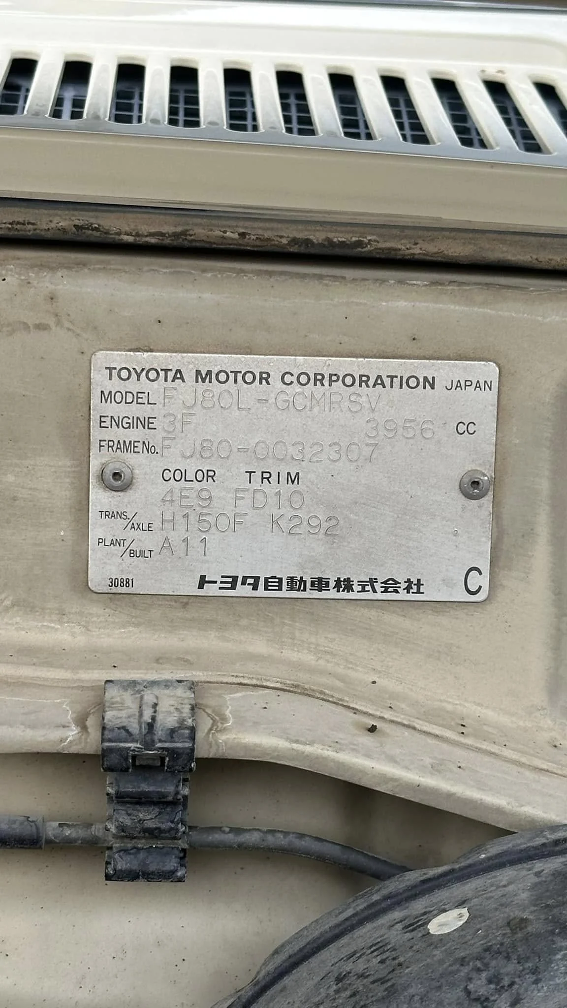

  • TOYOTA LAND CRUISER, FJ80, LHD
  • 1991, GCC, Saudi spec
  • AC and Heater
  • G spec
    "Just don't say poverty package, it is a cringe."

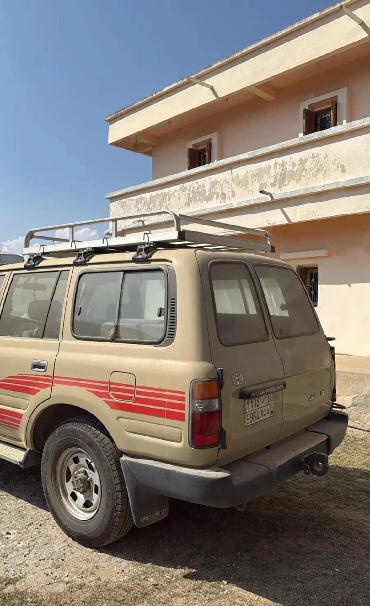

  • Tan with original body
  • About 140 km
    "86000 miles"
  • Manual five-speed, H150
  • 3F engine, carburetor

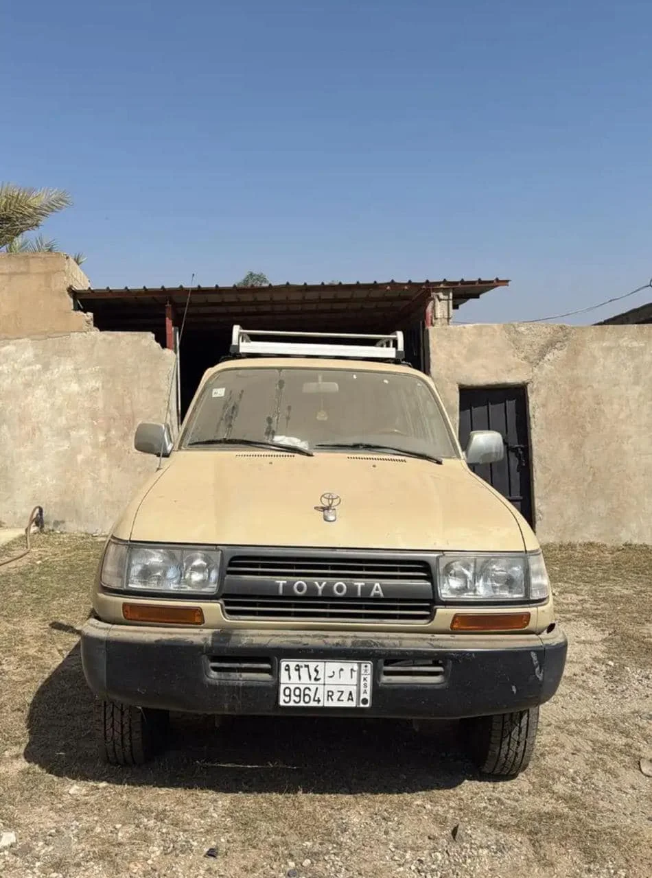

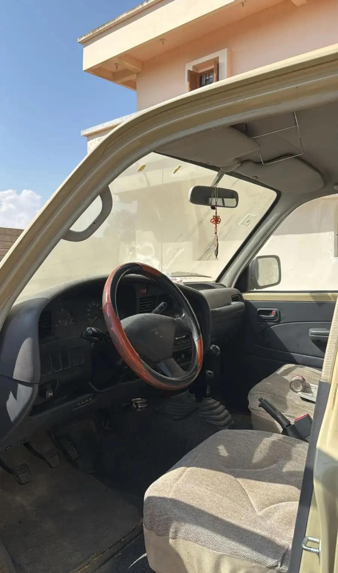

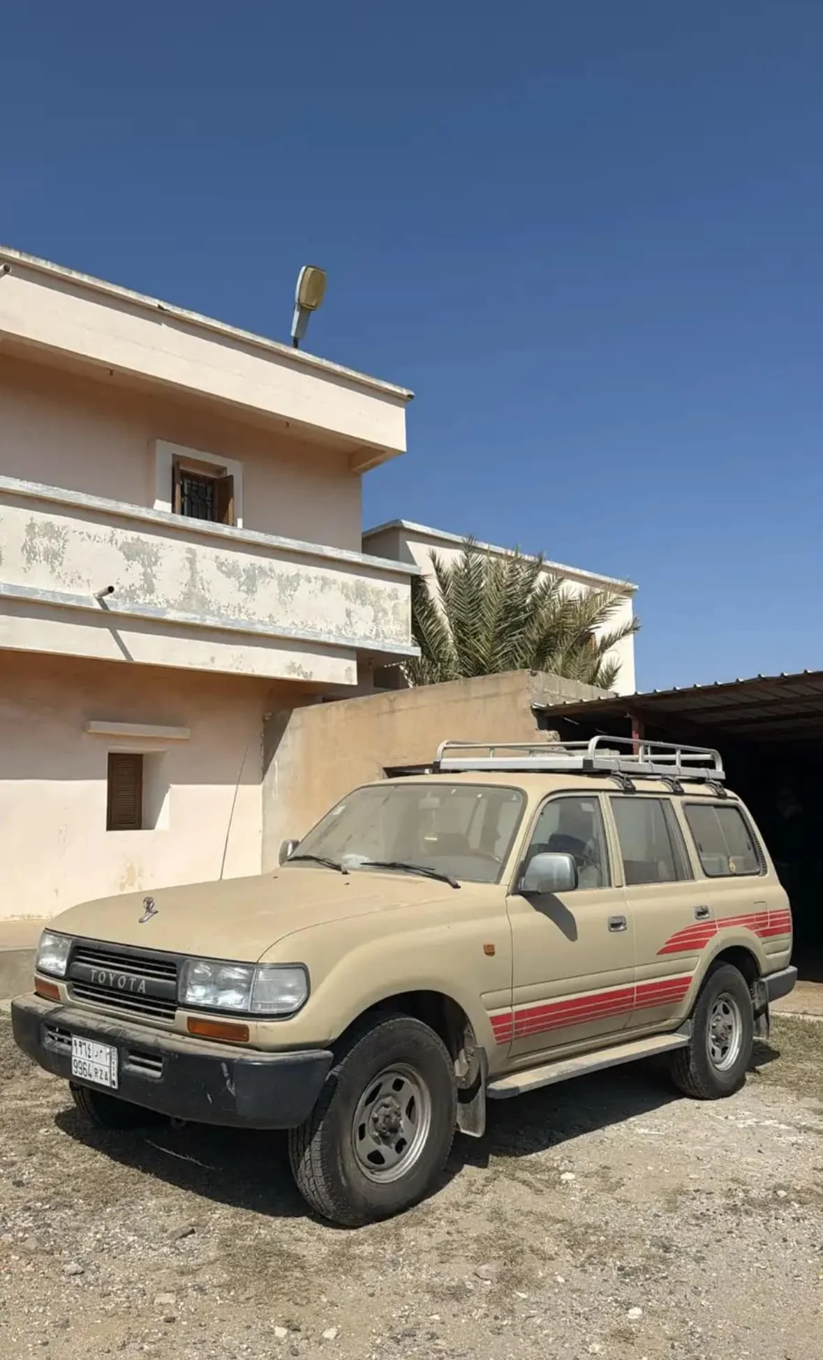

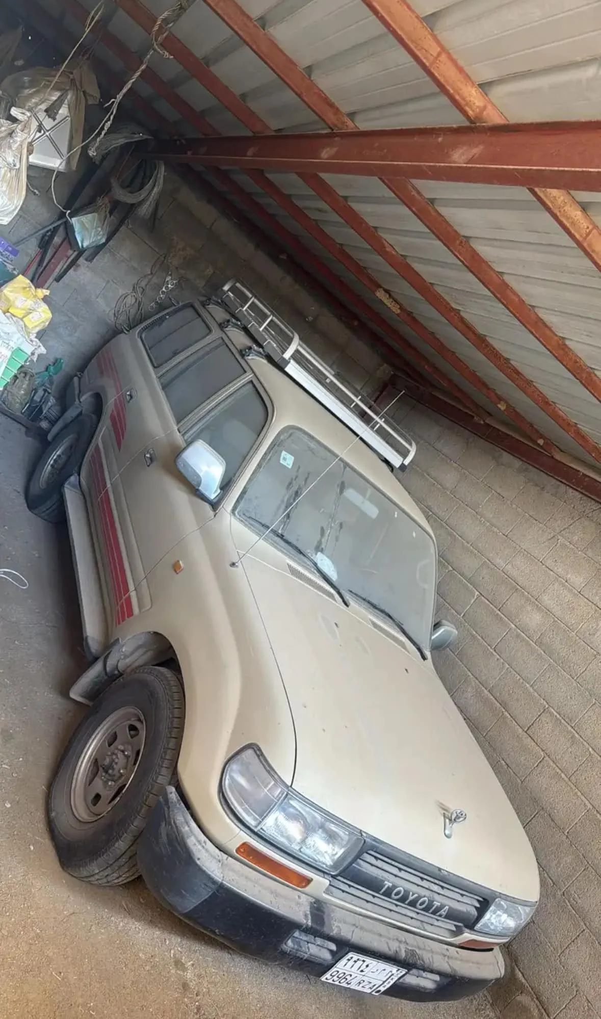

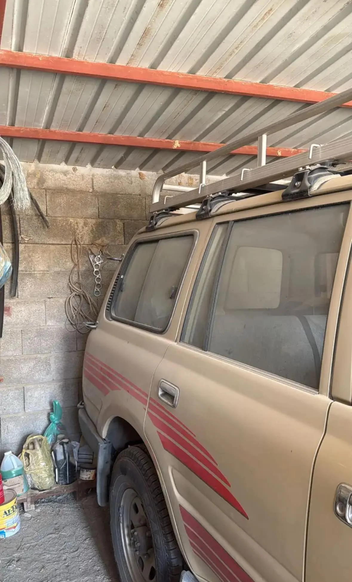

Last March, I found this low-mileage G for sale by its first owner; he claimed that he himself drove it from the transport truck when it was new, and now he wants to sell it before he dies. He is about 85 or so. The truck was primarily out of the sun's reach. The interior got a lot of covers, so it is new inside—NO cracks on the dash.
  • Then why did you get it where you can find FZJ instead of FJ?
    It is G, clean, I love 3F, and classy with its beautiful straps. The body is original except for one area that I am going to redo. Also, it could be a solid truck to be swapped with other engines.

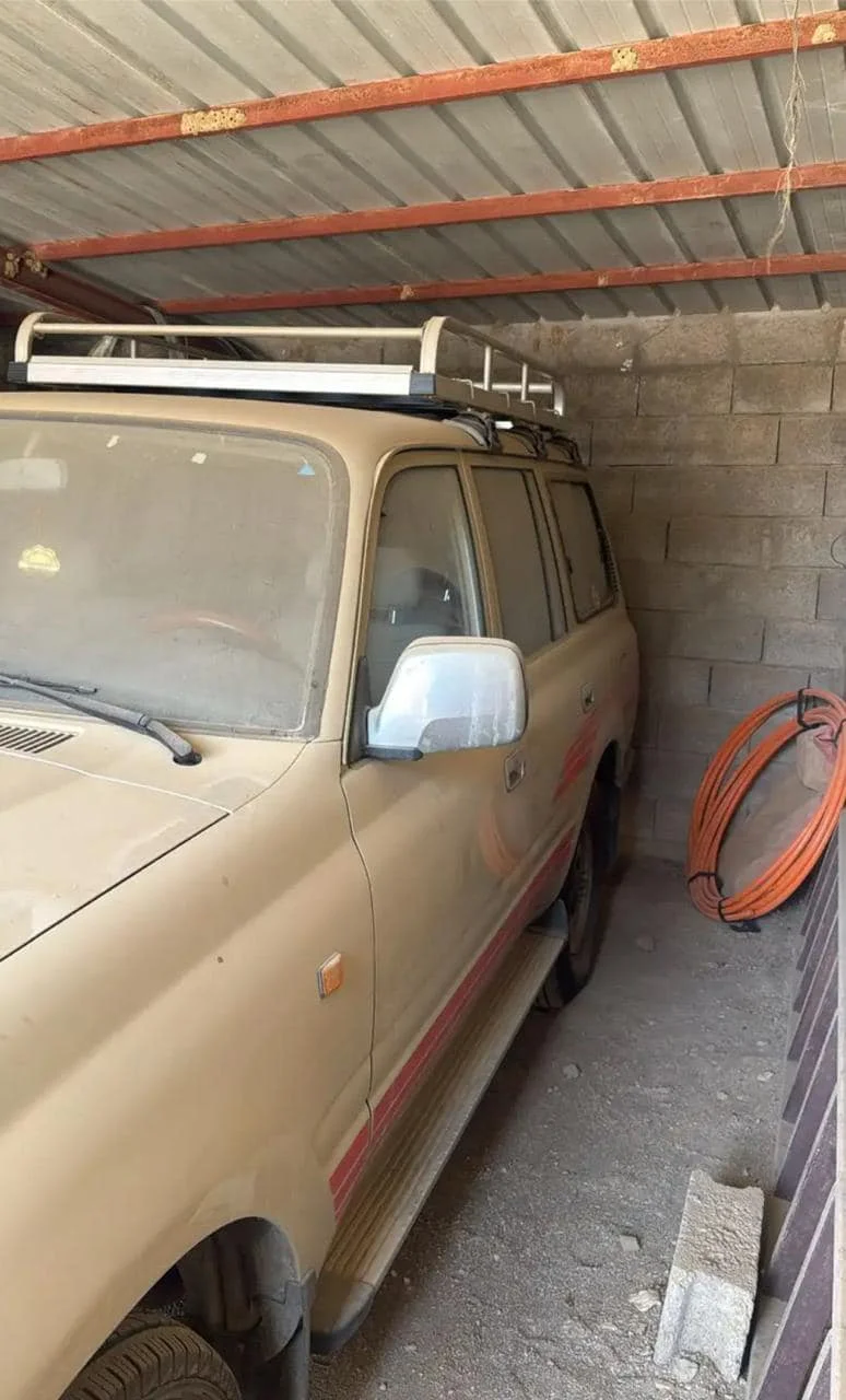

Got the truck, then first things first is taking closer shots to document what I got. It is pretty solid and drives smoothly because of the H150 trans.

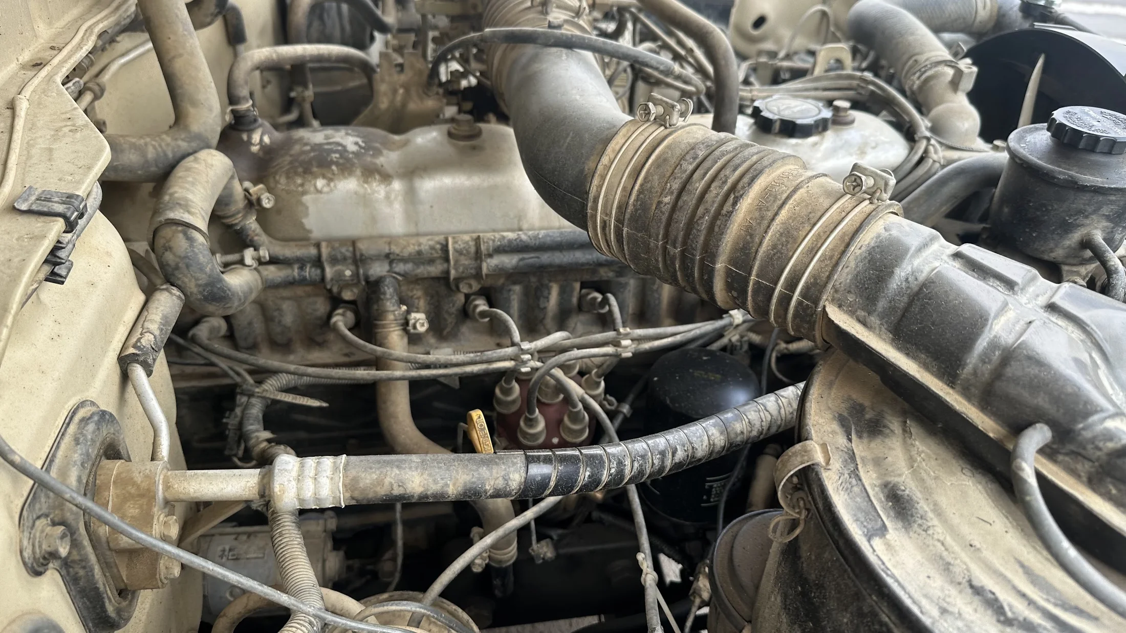

Dry dusty bay

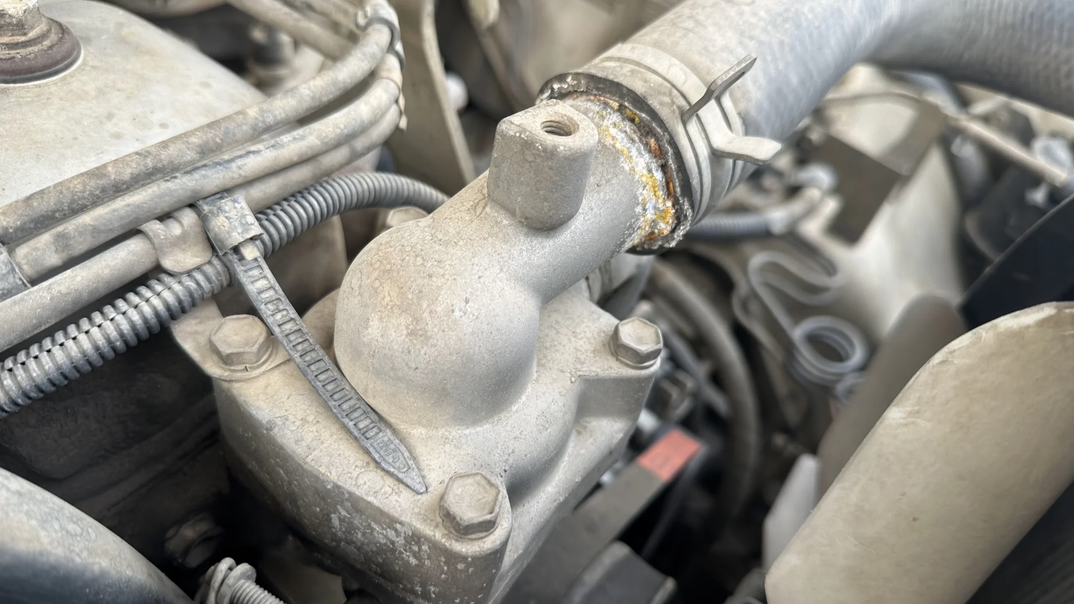

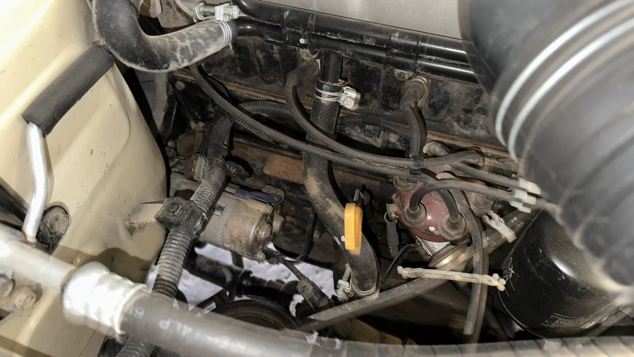

Engine bay after a quick wash
That starter is gorgeous with its blue link

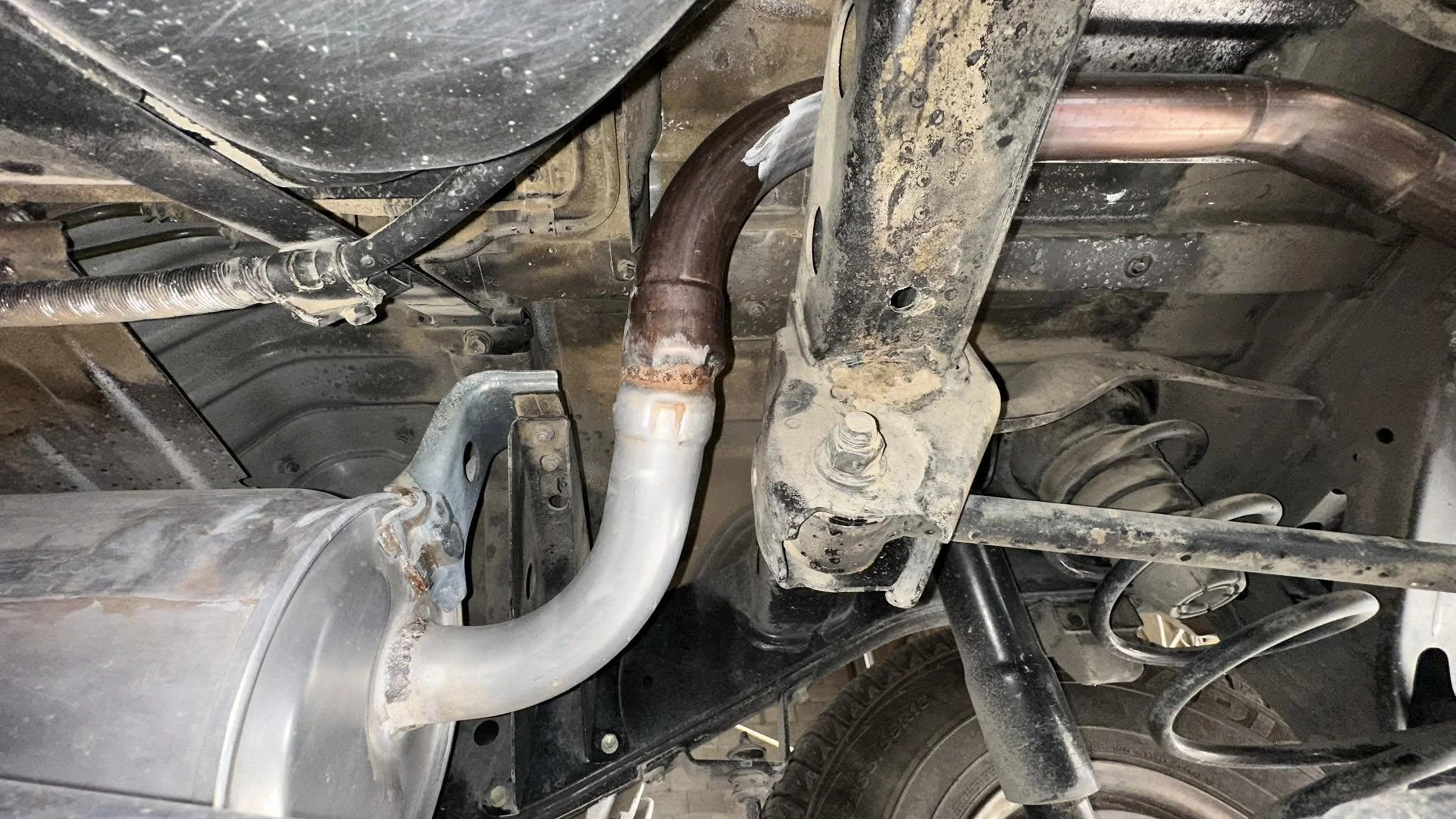

One more thing I need to address is that the rear end of the exhaust has been welded. Toyota, for some reason, made the rear end with a pipe clamp. Once it loosens, people tend to take off and then wield it

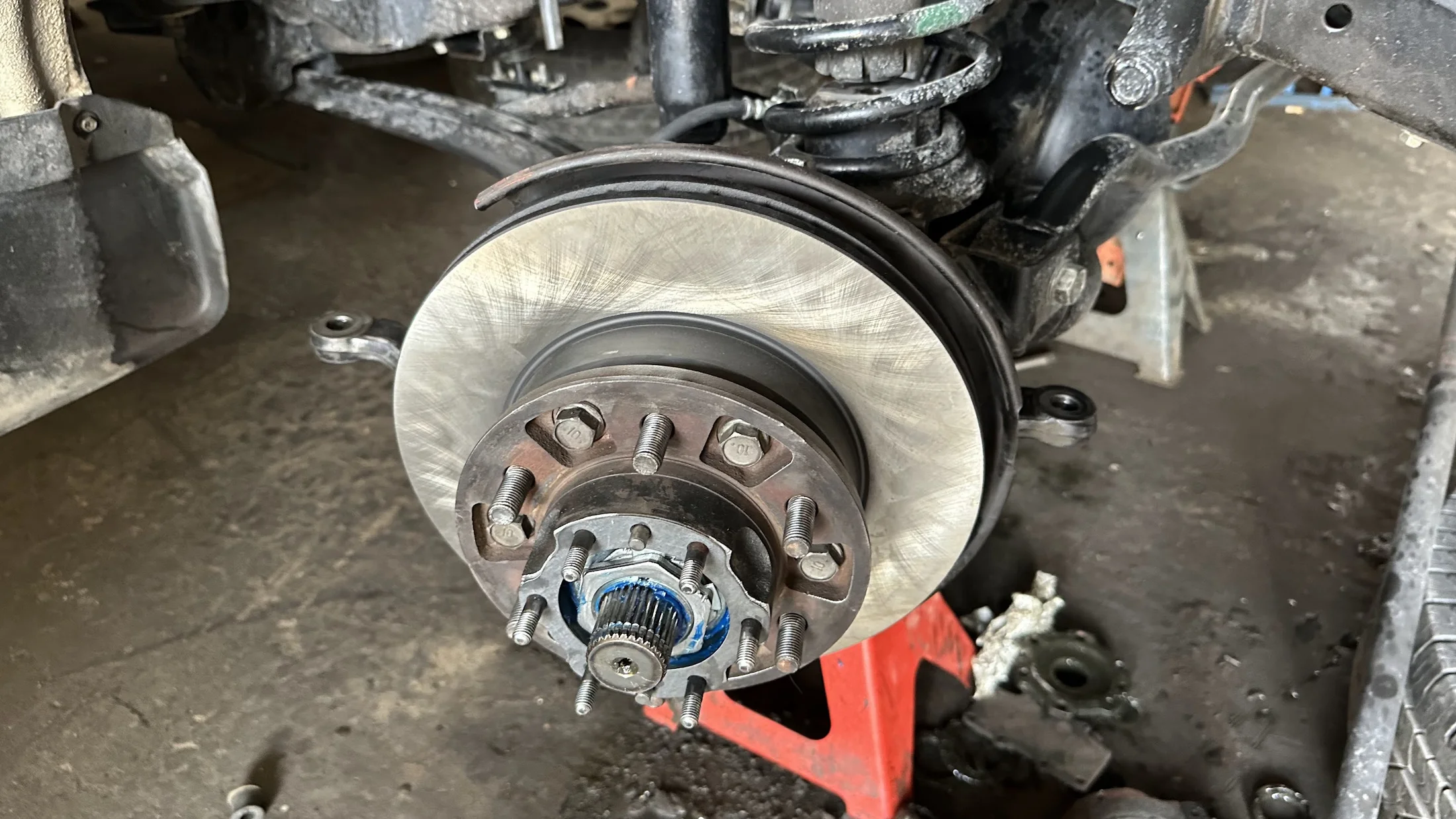

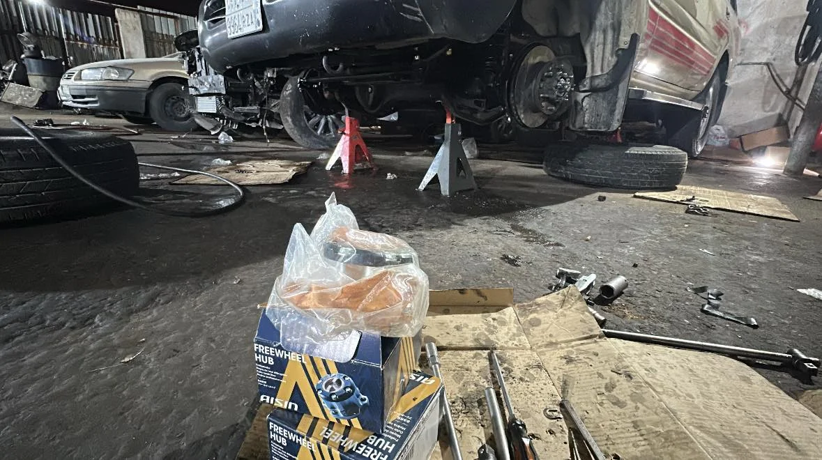

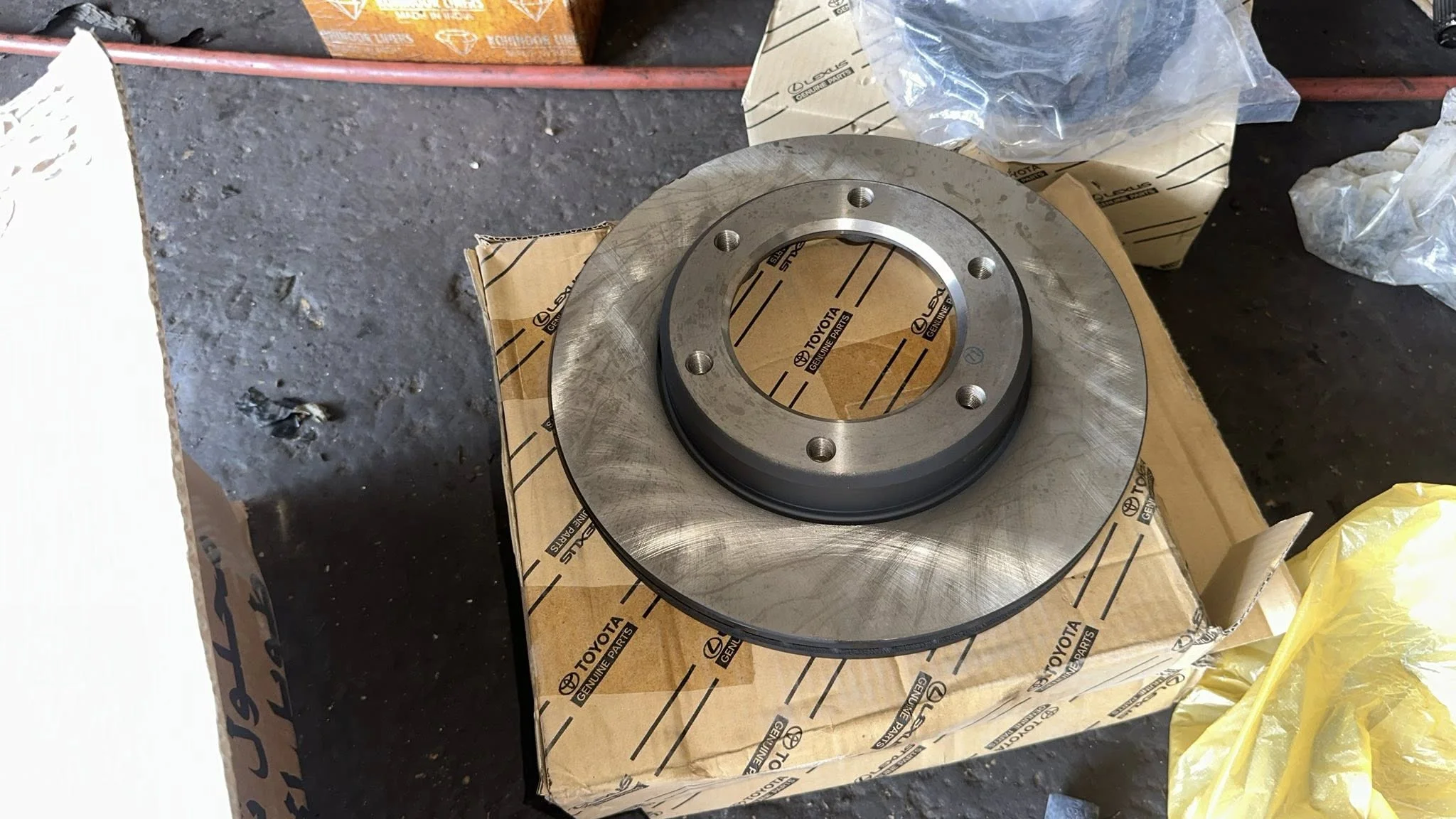

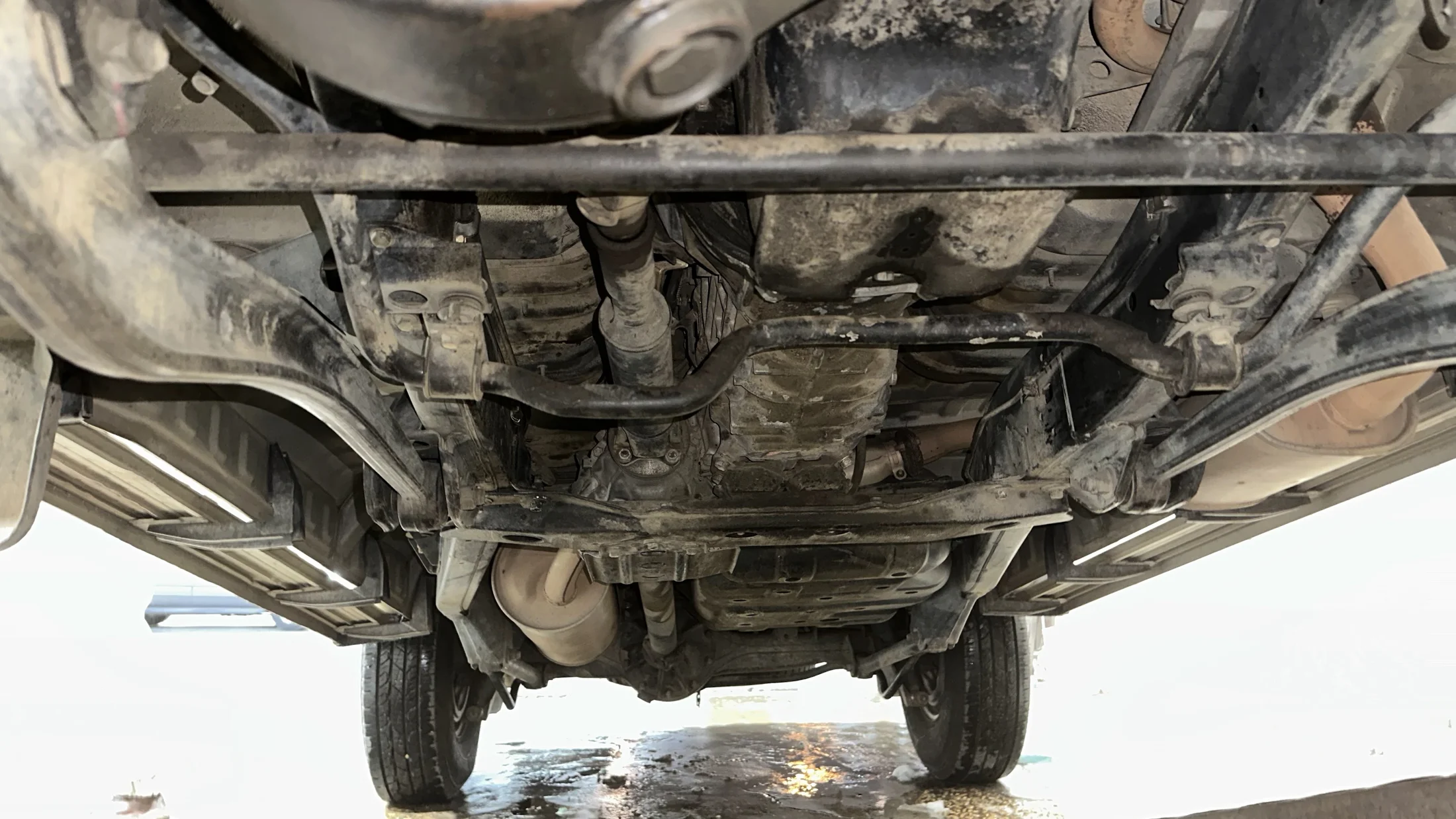

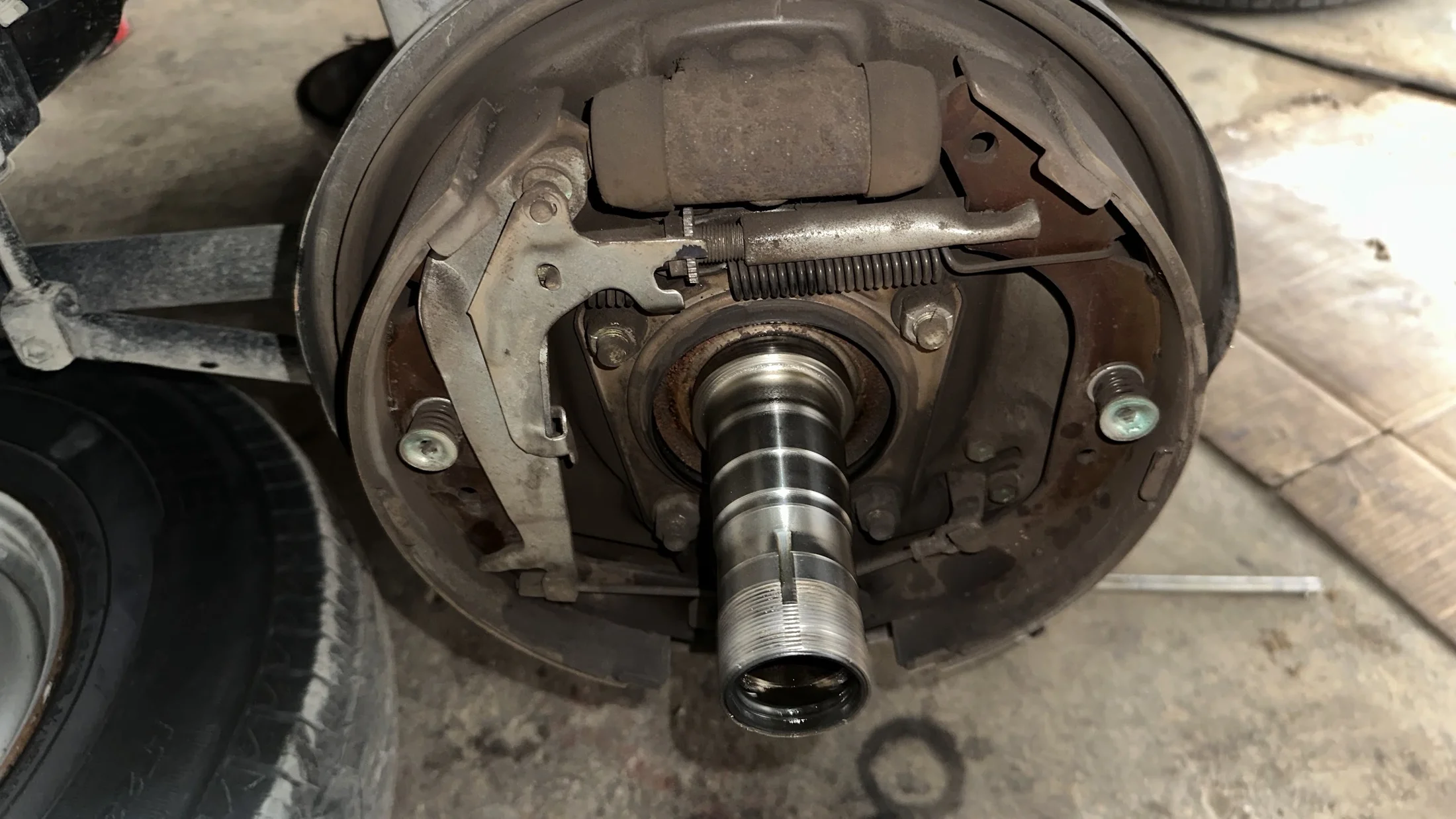

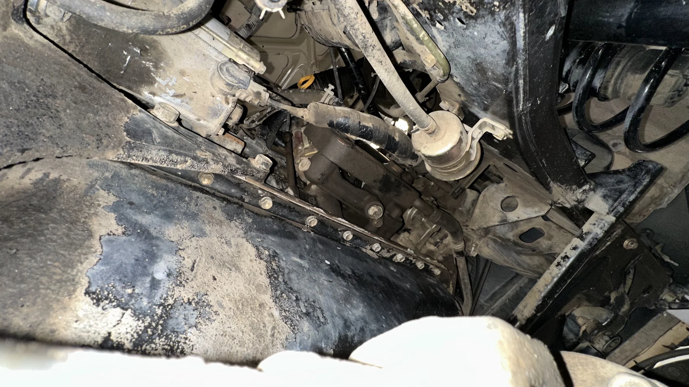

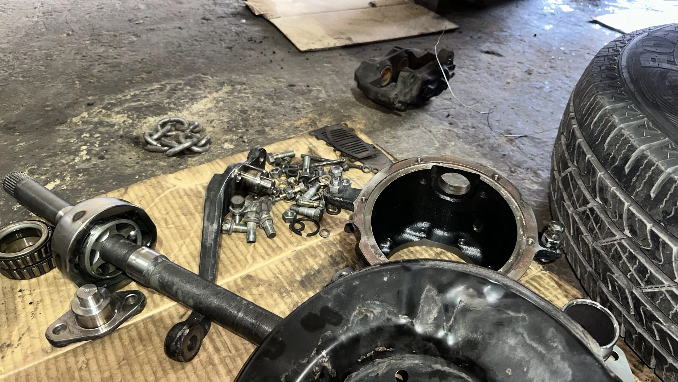

The truck went to the shop to be fixed underneath. This includes the following:
Roters and drums
All brake lines
All rear drum compartments
all arm control bushes

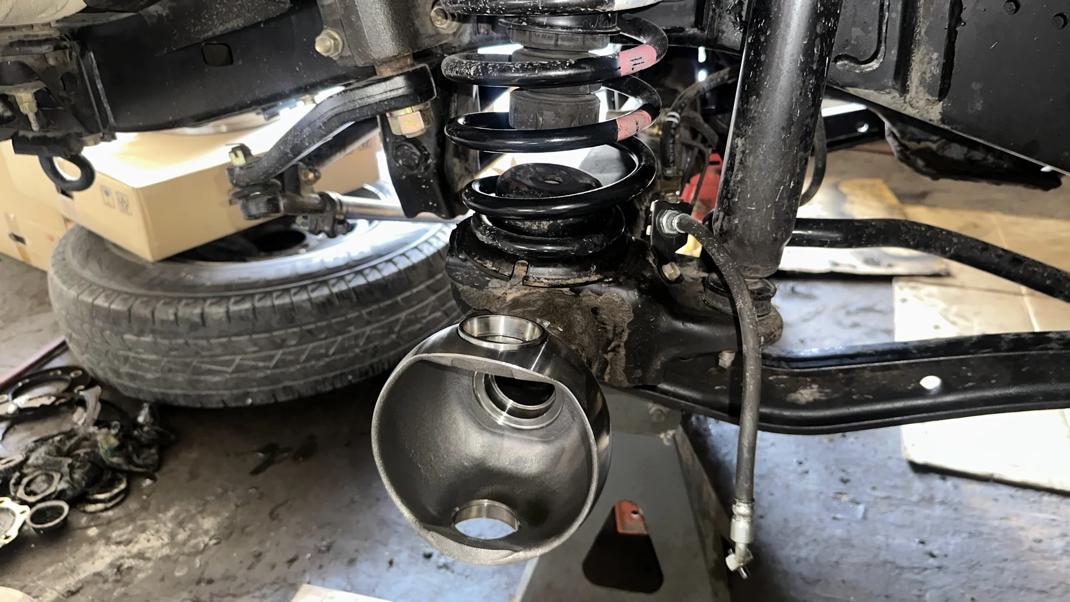

all seals and bearings for front and rear diffs
and more.

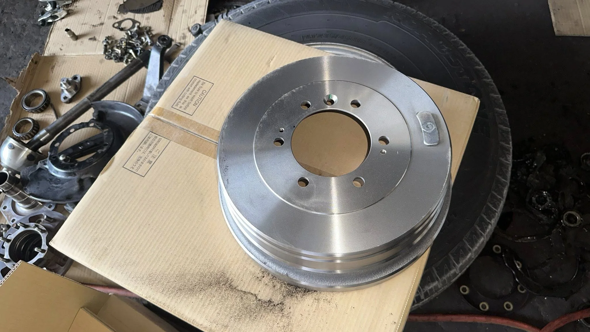

These nasty drum brakes are all new with new wires and cylinders
All parts have been washed with gas to be ready for the new parts.

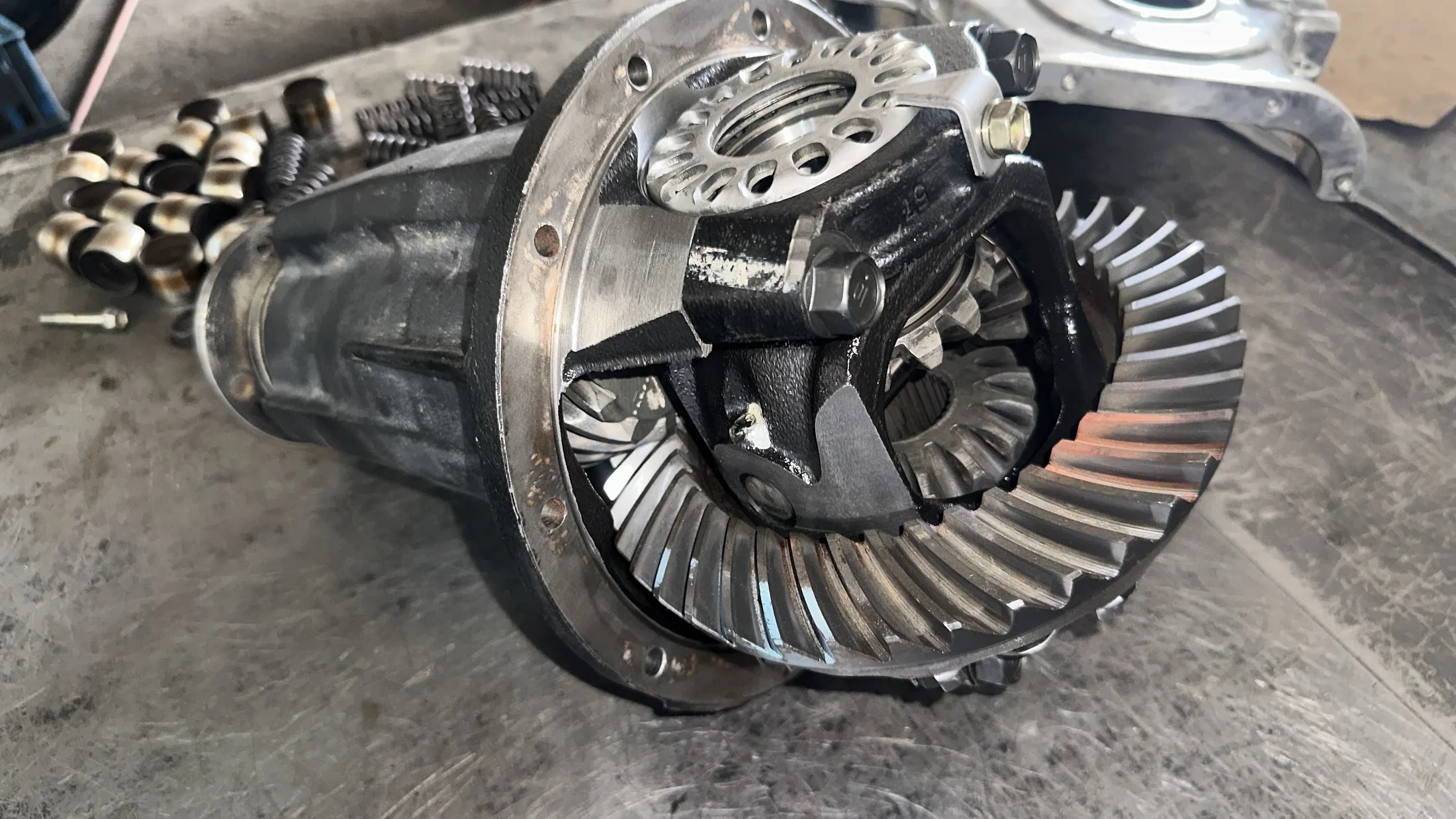

The oil in the front diff was soooo bad. I knew the previous owner would not open up such a part, so I thought to do so. So, we washed the carrier and ensured everything was in order inside.
Brakes are all new, and the front axle got new Aisin hub lockers as well. I did not replace the shocks. I tried to order monotubs from Dabinson, but unfortunately, no luck. I'll try later, maybe with springs as well.

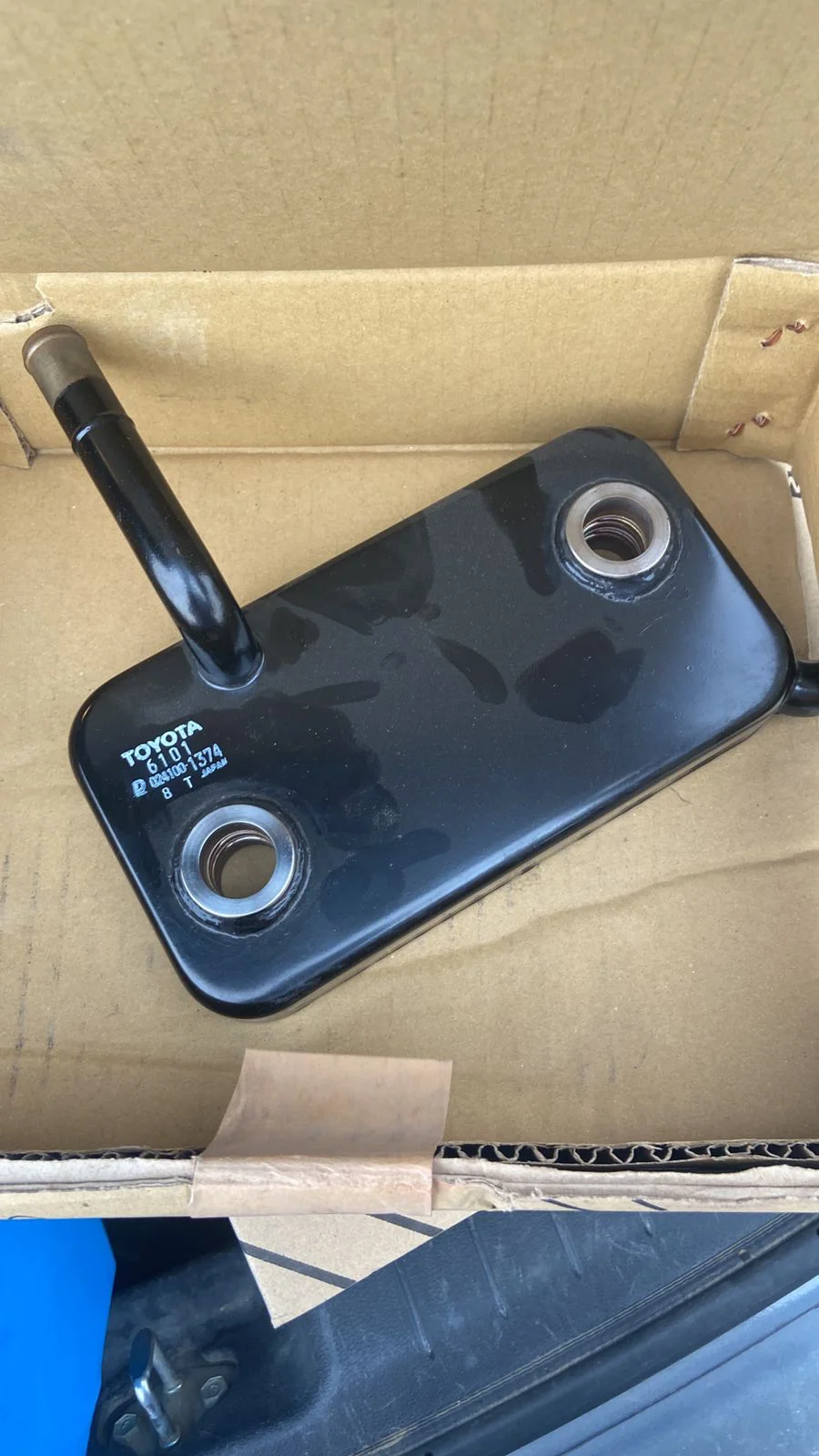

  • Let's hope that the oil cooler is not rusty. IF yes, I am obligated to replace it with OEM.
  • Rear muffler and the mess that previes ooner did, even tho I feel whoever's gonna buy it in the USA is gonna swap it.

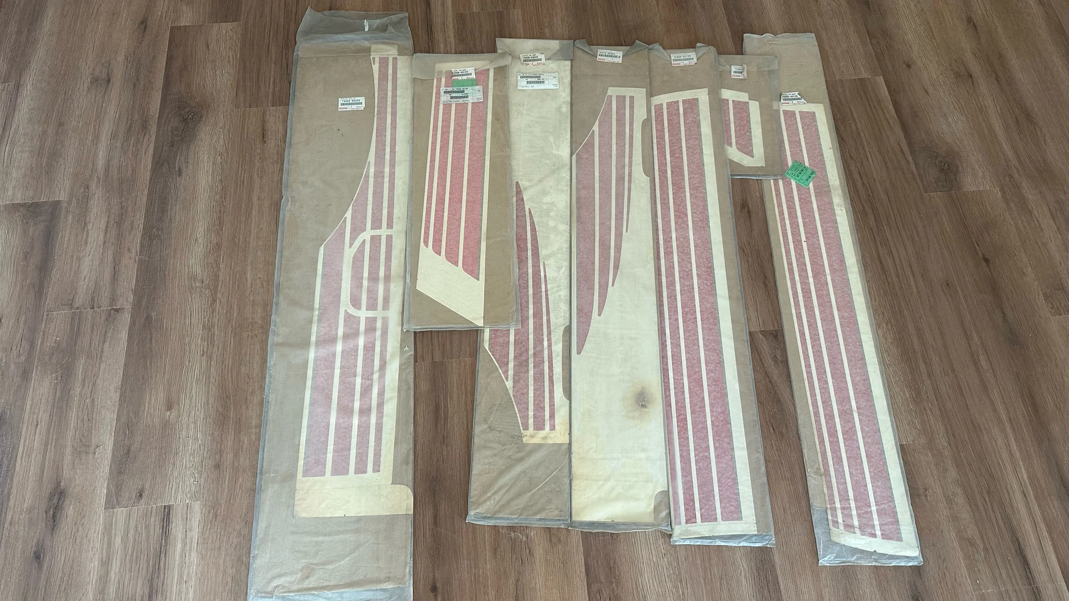

  • And put new OEM stripes on the right side only. "I have hoarded those red stripes in my shelf for Nolan, but he did a cut locally, so I'll use them for mine."

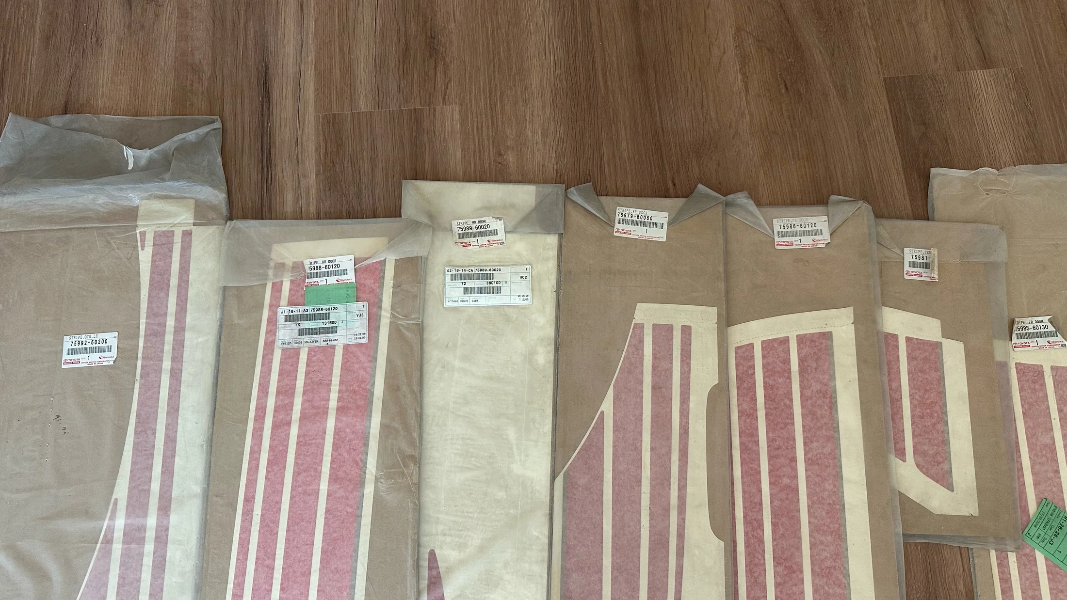

Looking at my strips collection to make sure I have a full set or only the right side. Good thing is I have the two door on the right where the dent at. will be looking for the rest if i can.

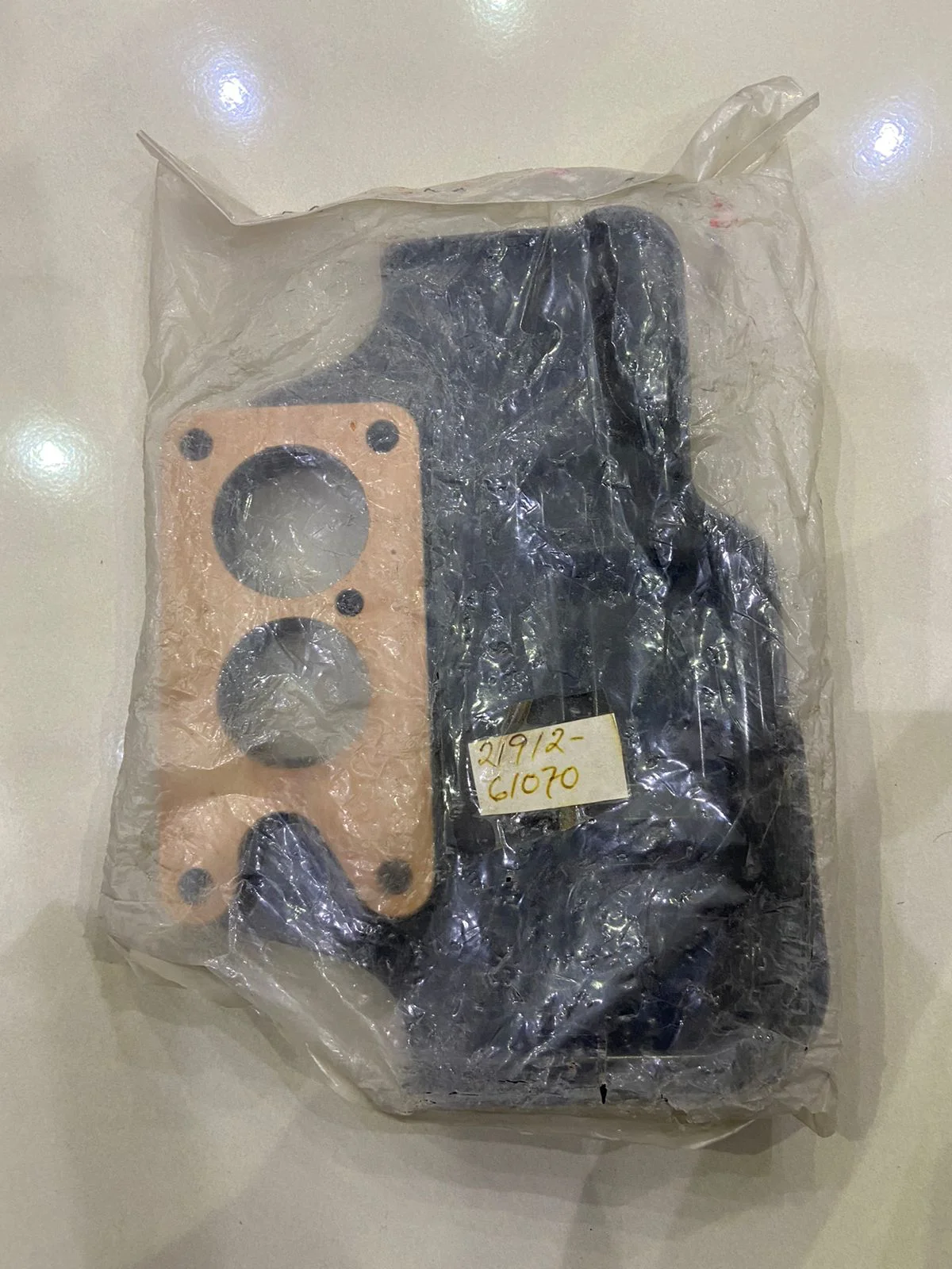

I have been shopping for parts for the engine refresh and have found some rare components, but I'm unsure whether to proceed with them. As I mentioned at the beginning, this project will be as stock as possible.
Some parts I found
