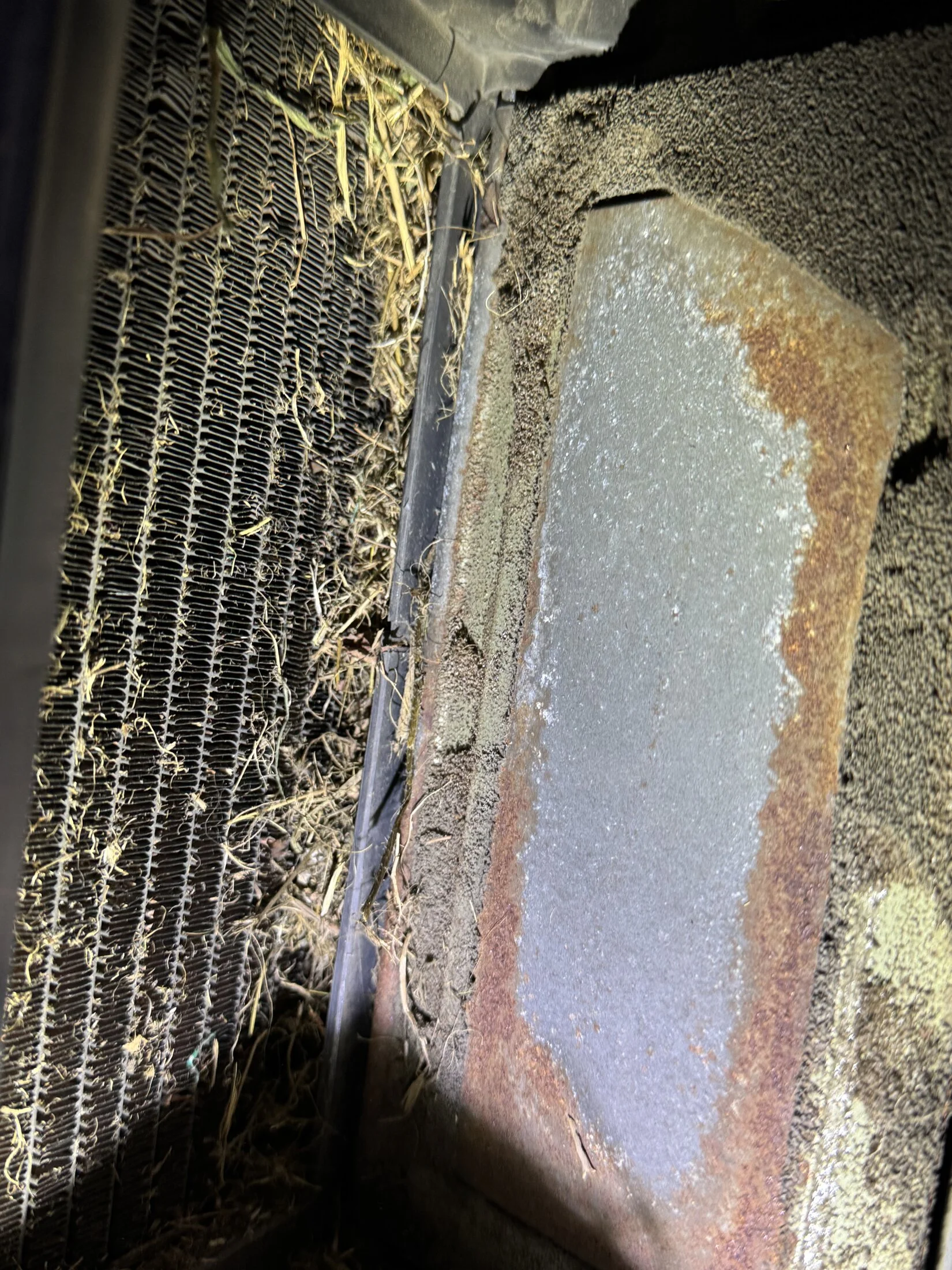

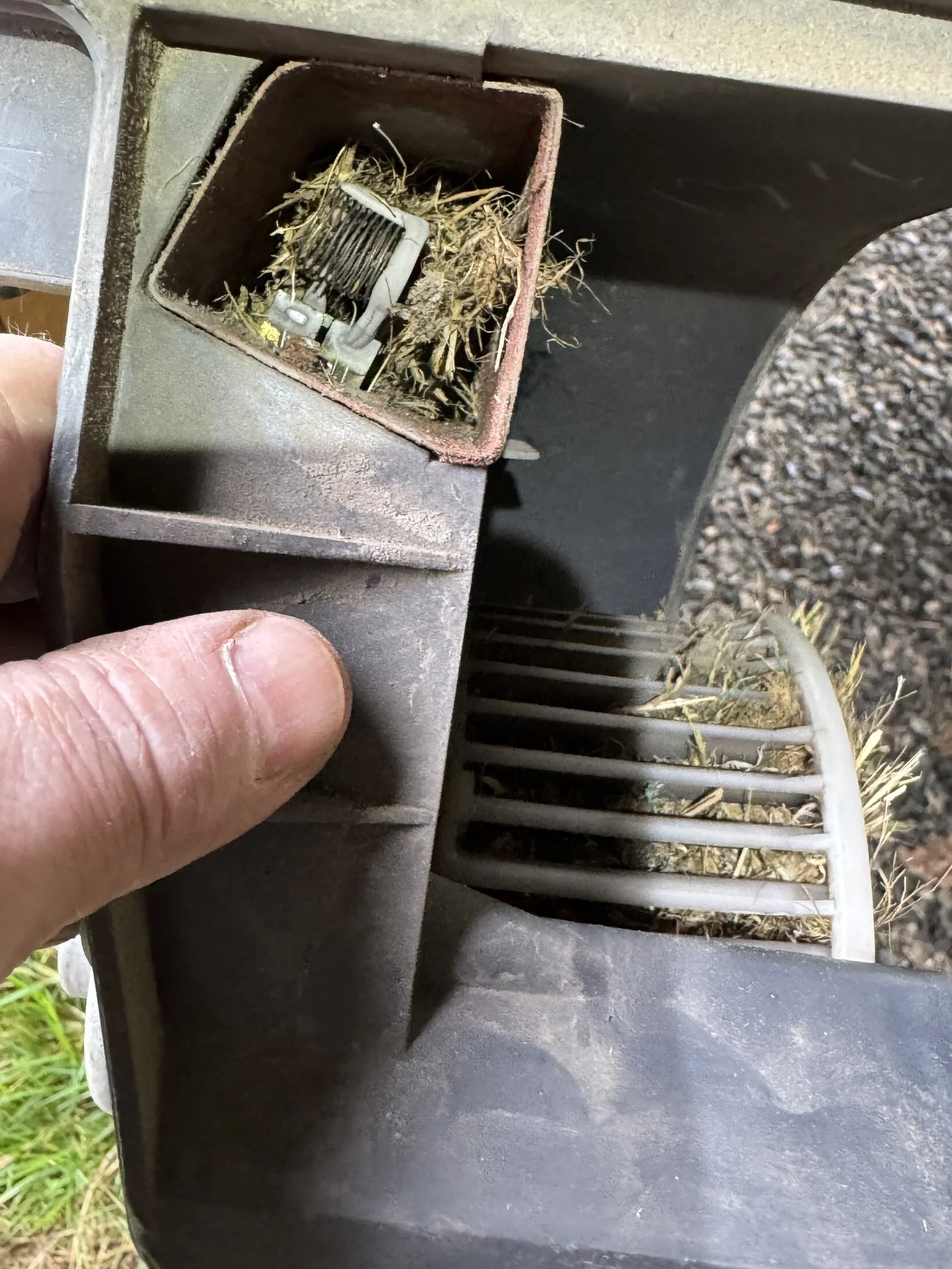

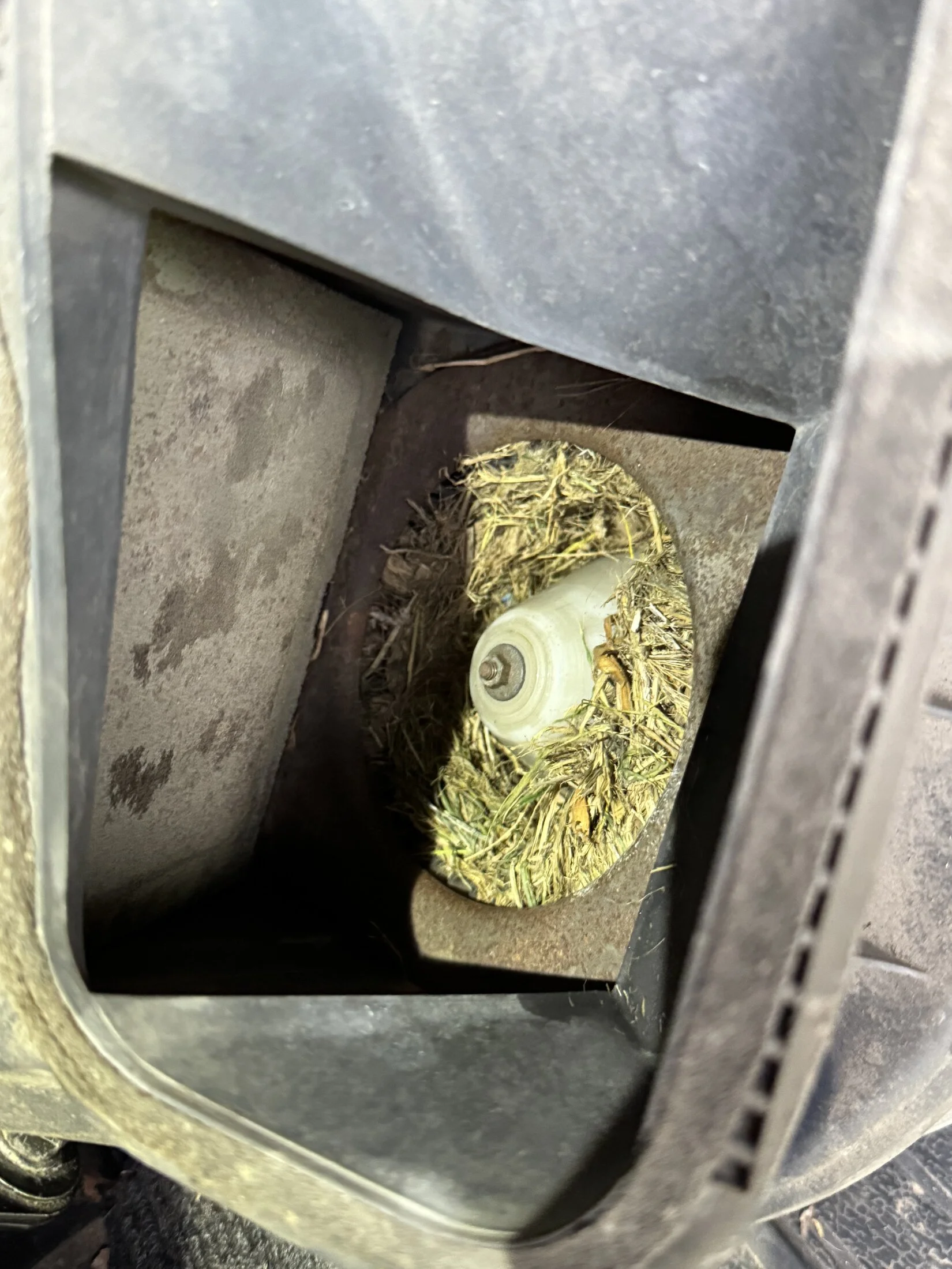

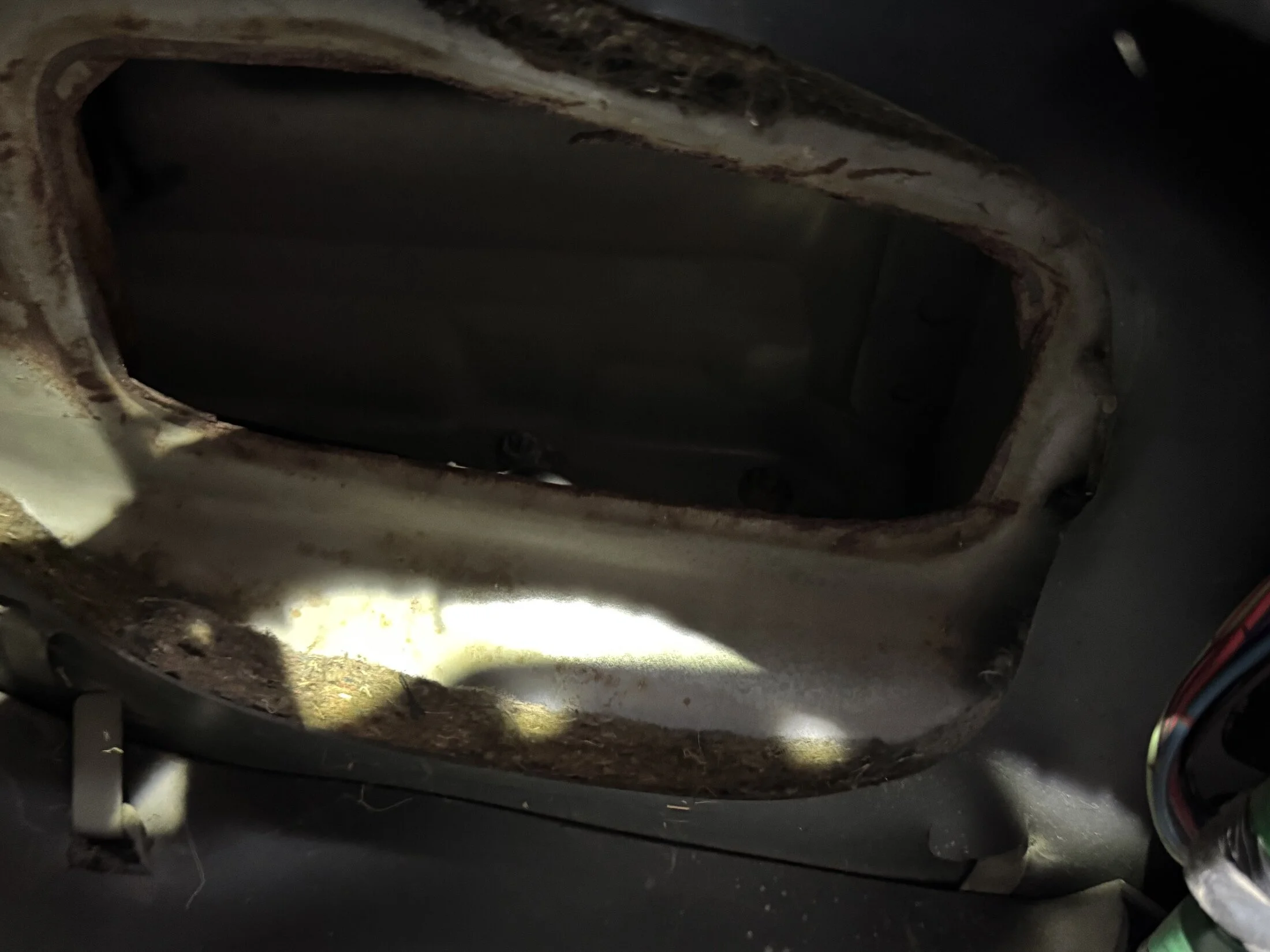

First indication was the little grey streak across the floor of the BJ74. I’ve set traps. His carcass will be used as bait for the rats. Little bugger!! Only parked there for about 3 days while working in the shop on the Tundra. Worst part is going to be vacuuming out the heater core and making sure it’s residual grass is gone. I also will be taping 1/4” galv mesh against the fresh air inlet hole. Had the thing for 8 yrs? now, never got around to rodent proofing the heater fresh air inlet.
For all you guys that want to know, rats won’t chew galvanized metal. 1/4” max size to stop them just sliding thru. I know, I’ve terminated over 300 rats on my farm in the last decade. Most places where I don’t want them, I don’t have them. This was overlooked. Darn!!
Missed one, this is the opening up into the wiper transmission housing. It’s big enough for a cat, let alone a mouse or rat. I recommend screening it. As I will be doing. Pic to follow.
I bought an oil based undercoating material that has peppermint oil in it to deter rodents.
at first i thought that was your turbo stuffed full of straw 😄

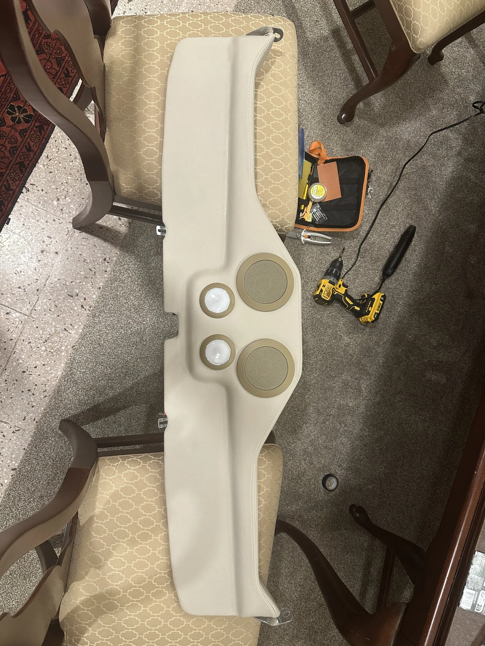

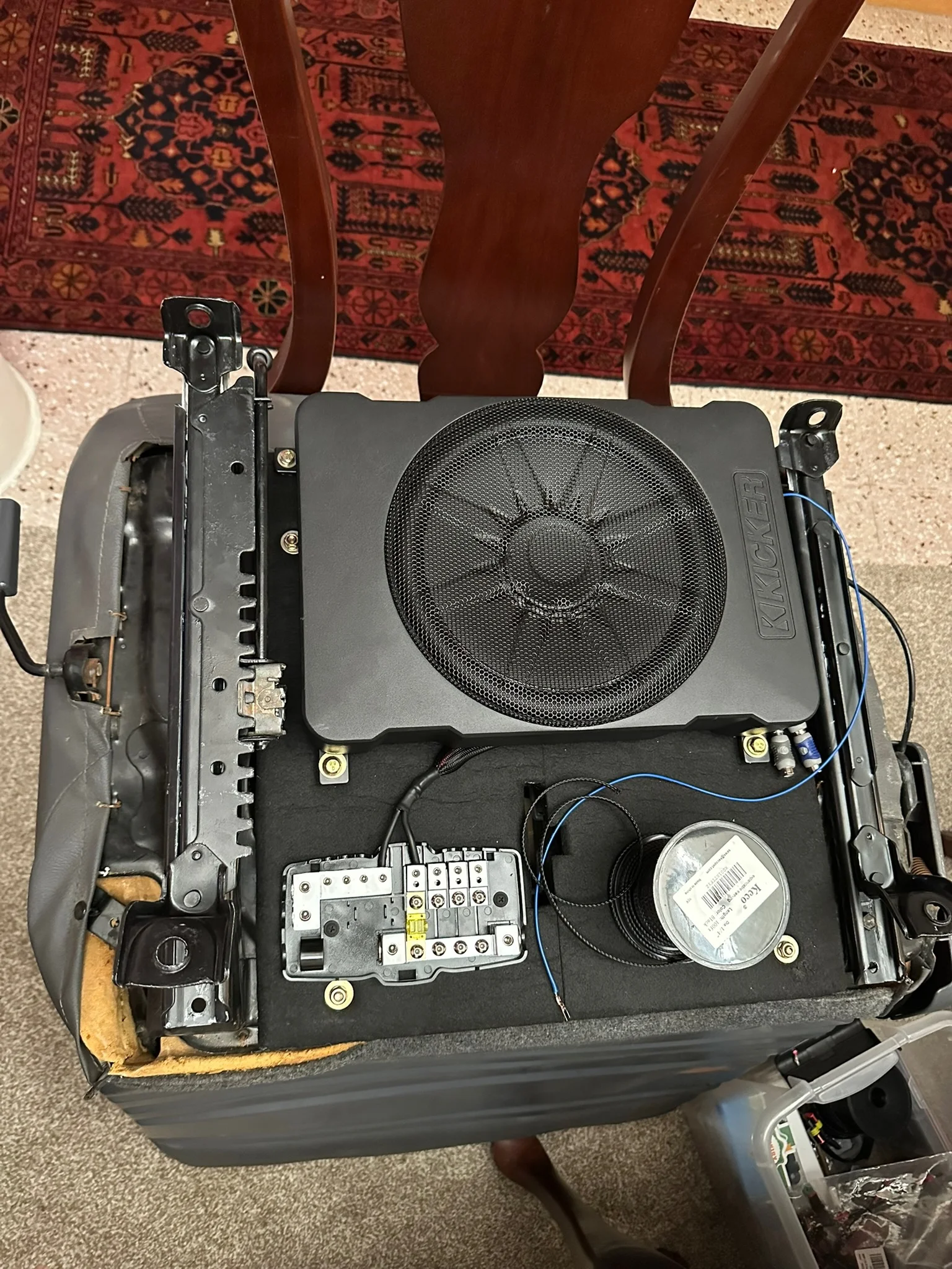

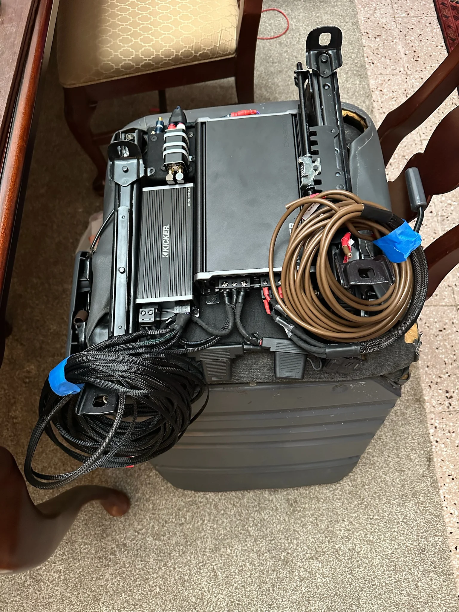

Been working on my audio system while the truck is in the shop. And no, 11 speakers is not too many speakers. At least not for me…
Aftermarket roof console from Alibaba, recovered to match headliner with two 3.75” coaxials, which will be a mono “center channel”. Added some USB ports to it as well.
Under seat subwoofer mounted on 1/4” ABS isolated from passenger seat frame with rubber spacers.
Amp rack also fabricated out of 1/4” ABS.
Will be replacing dash speakers, plus 6.5” components with 1” tweeters in the doors, and 6x9s coaxials in the rear side panels.
Maybe a bit excessive. Maybe.

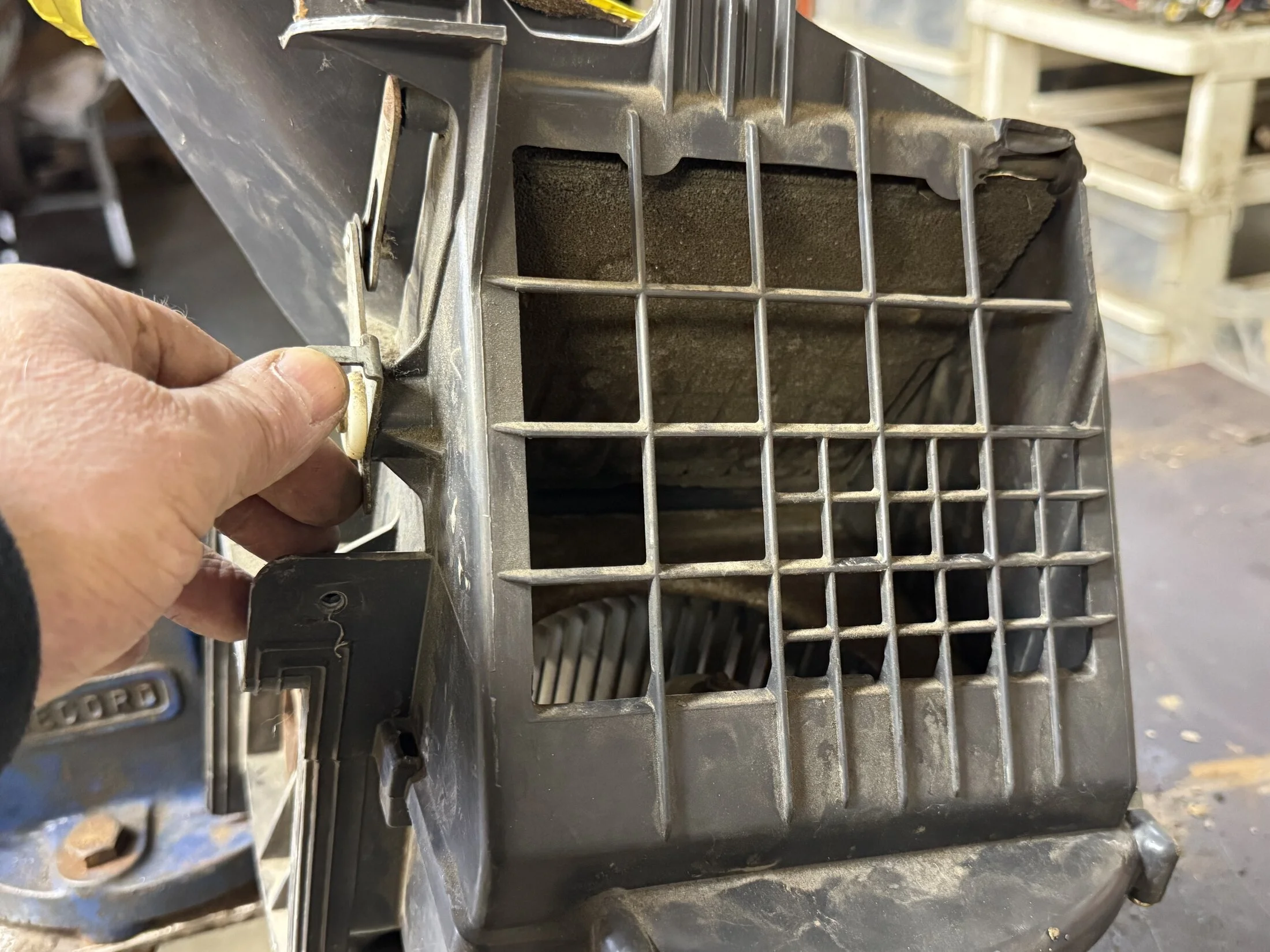

I know that feeling, that's why my BJ70 has stalled... I've got to find the time to wash all the plastic ducts and then refit them before putting the dash back in...
I used to sneak grotty plastic ducts into the dishwasher and put it on low heat gentle cycle and they come out great.
High pressure karcher can smash holes in the brittle items too.

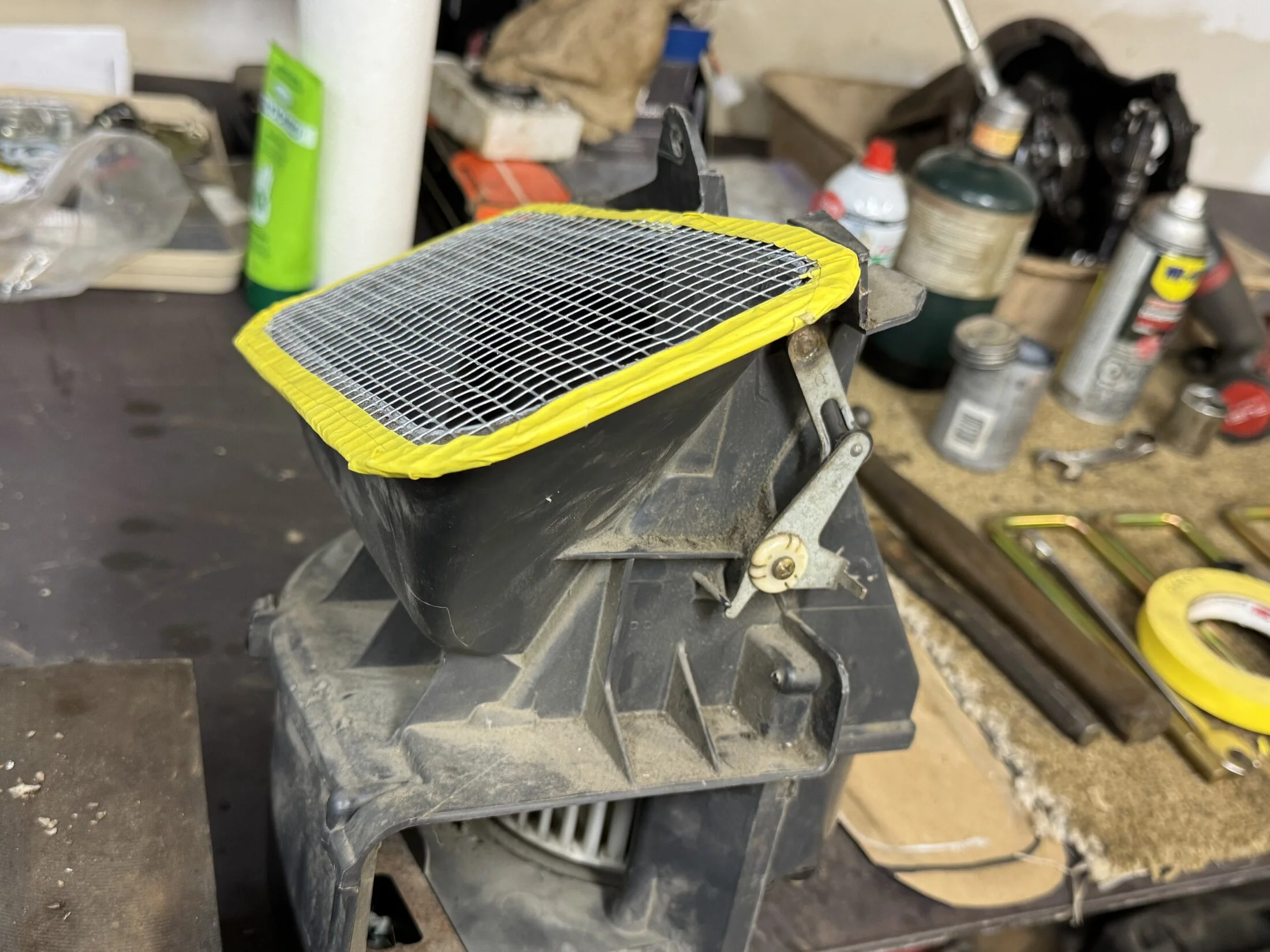

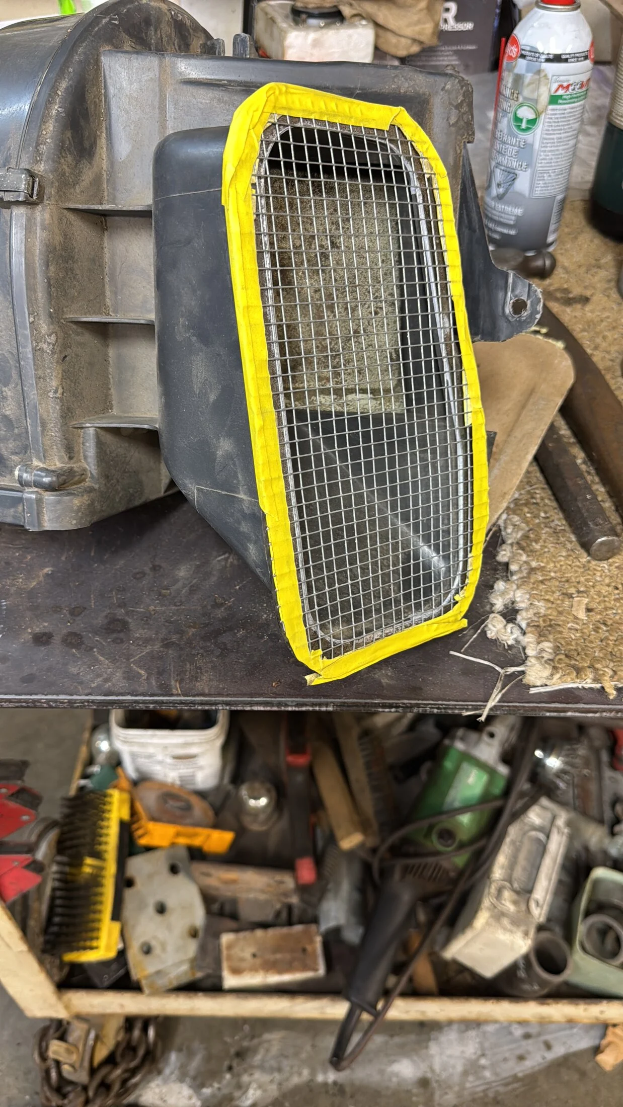

I just bought a sonic cleaner, but the only thing needing real cleaning is the fan so DAWN dishsoap and a scrub brush it is. I highly recommend leaving the selector on RECIRC, this will stop access. Problem is there is enough of a spot right on top of the door inside the opening to allow them to nest. So as soon as you select fresh air the whole damned thing falls into the heater. Anyhow, yellow painters tape is really strong and thick. Almost a gasket! It will last forever and I taped the screen around the edge of the inlet. Good to go. Happy with the results.
Ya know, when you drive that thru a river and the seats get wet you’re gonna have troubles with that stereo?! But that being said I wish you were closer and could come over and help me figure mine out.

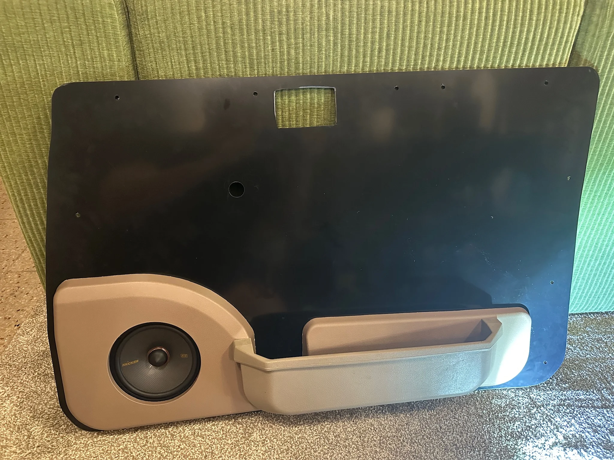

Today I worked on the Cruiser driver door a bit. I've got several issues to deal with:
  • Sticky/hard-to-crank side window
  • Crack in the paint/metal?
  • Wobbly beltline moldings
  • Missing vapor barrier
  • Dubious door card
  • Completely worn-out old door card trim fasteners that have been reused way too many times
  • It would be nice to add sound deadening
I hope to address all of these issues in one go while I have things torn apart.

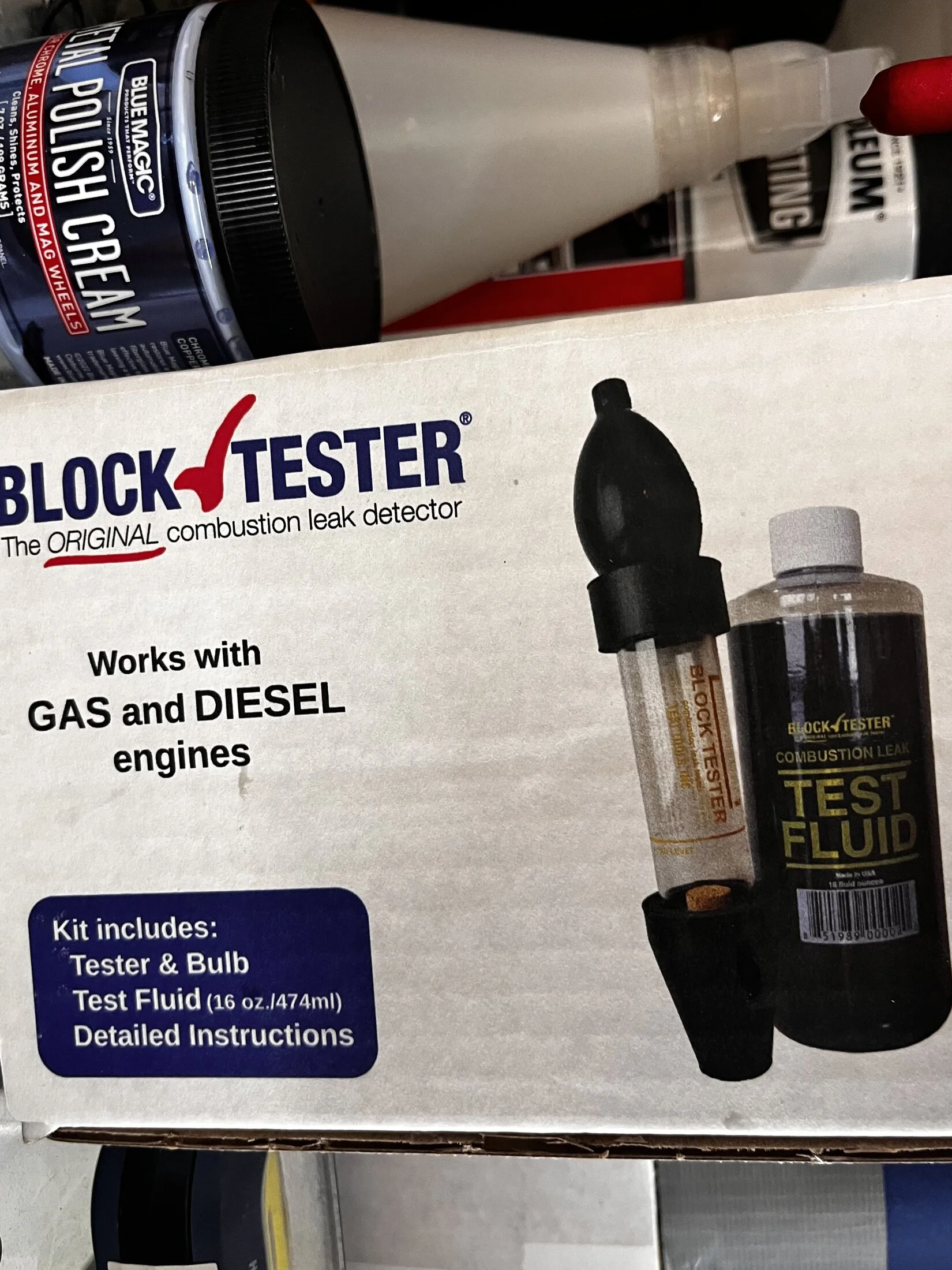

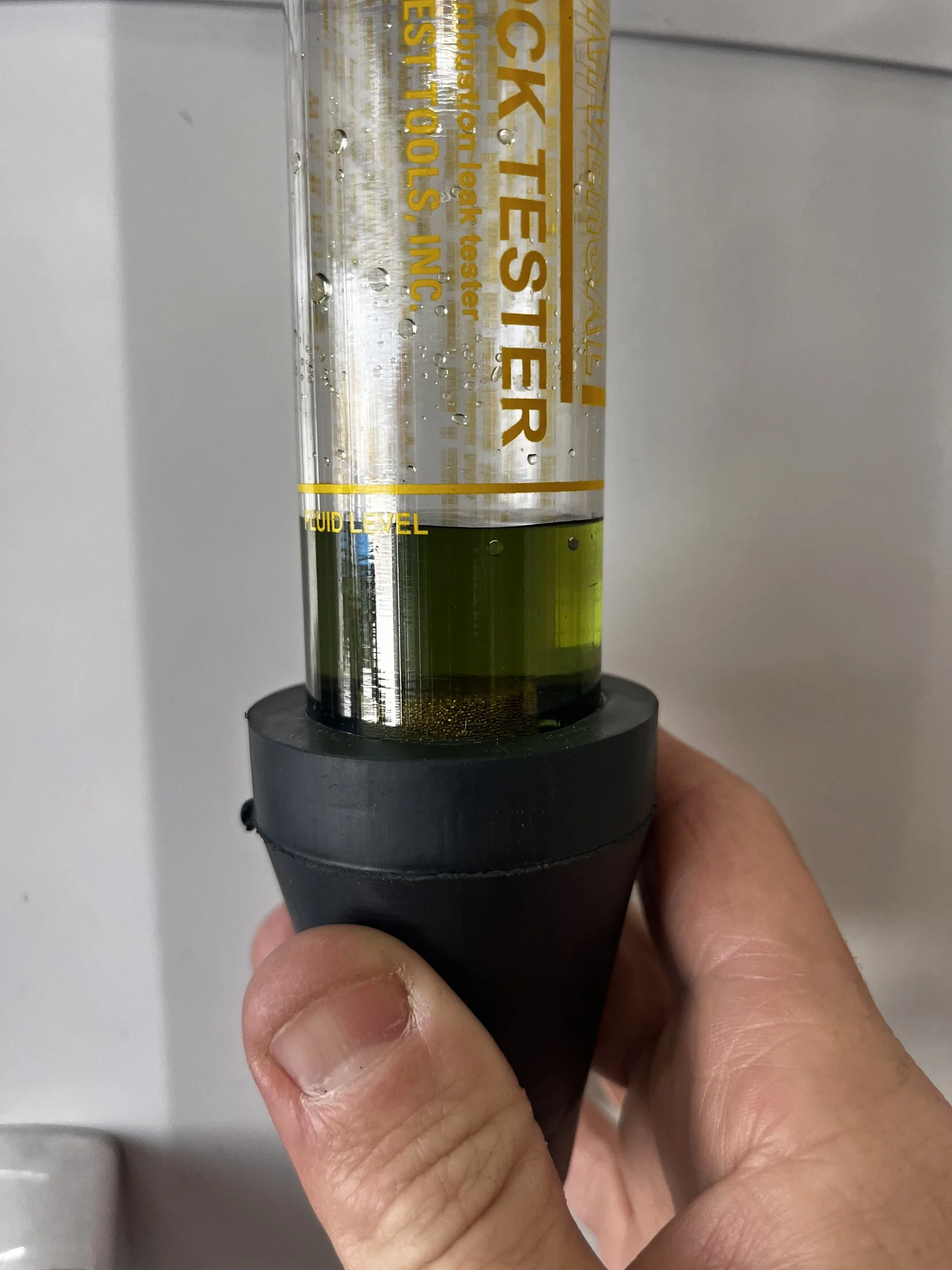

Got this tester kit and unfortunately, it changed from blue to green fluid indicating a combustion chamber leak. This is my sneaking suspicion unfortunately so head gasket potentially bad or cracked head. now I have to tear into it….FML!!
@Redtexan What symptoms were you experiencing that made you test it? Just wondering.
Good luck! I just went thru this. Just get all oem gaskets and you will be good for a long time!
Unfortunately it seems that for both the L and KZ engines the head gasket is rarely the failure point, it is almost always the cylinder head.
