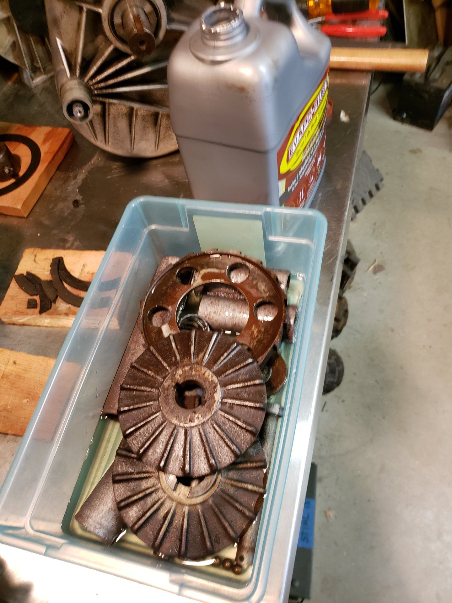

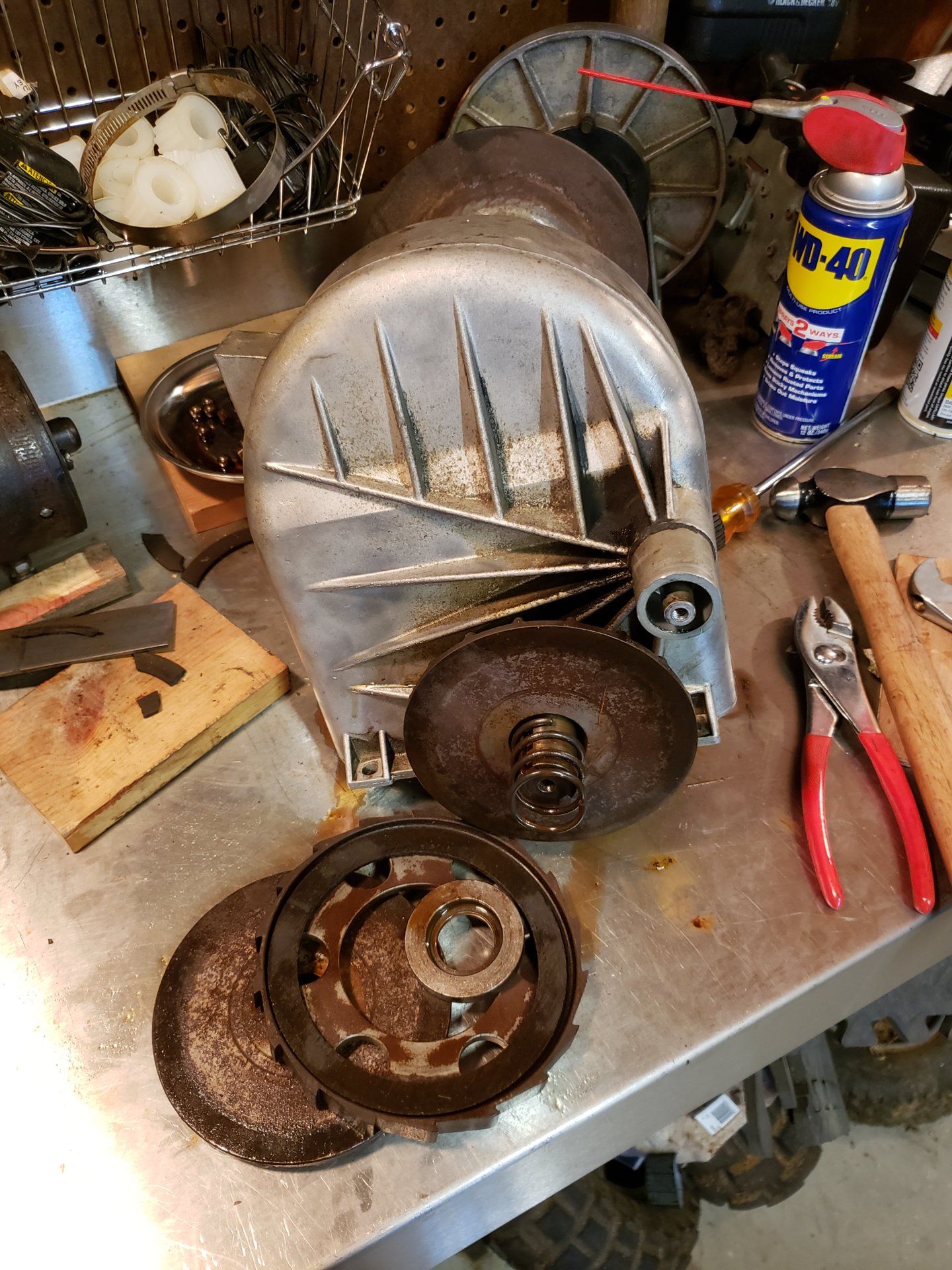

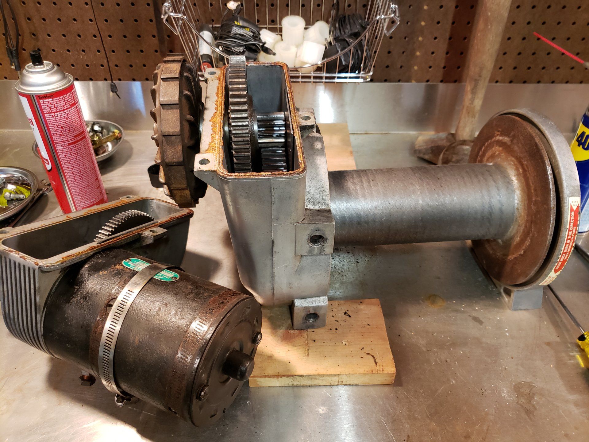

Using the current circumstances to finally dig into my "new" 1978 vintage 8274. Bought it from the original owner out in western PA. He used it on an old Scout. He sold the Scout a long time ago and kept the winch in the garage. Winch works great but I have a little freshening work to do before mounting it to the FJ40. The steel cable had some real stories to tell so it was the first to go. Next, I popped the top to see if any /how much oil was present in the housing. Turned out to be ~1.5 ounces. Enough to bench run but certainly not enough for field use! Even though I could have put in fresh oil, buttoned it up and mounted it, the look of rust on the brake got the better of me. So I decided to take the brake off and give it a soak in Evaporust. And that's where the fight began. Most advise that before removing the circlip that retains the outer brake housing onto the shaft, you should secure the front and back of the housing with a vice grip to keep it all from "leaping" off the shaft from the spring tension kept at bay by only the circlip. So, I was prepared to stop the explosion of ball bearings and other bits as I carefully removed the circlip. After removing the circlip, nothing happened. It took a week of PB Blaster soaking, tapping, heating and coaxing with a gear puller to get the rust to let loose of the brake assembly. Finally got everything off last night and into the rust removal bath!

Using the current circumstances to finally dig into my "new" 1978 vintage 8274. Bought it from the original owner out in western PA. He used it on an old Scout. He sold the Scout a long time ago and kept the winch in the garage. Winch works great but I have a little freshening work to do before mounting it to the FJ40. The steel cable had some real stories to tell so it was the first to go. Next, I popped the top to see if any /how much oil was present in the housing. Turned out to be ~1.5 ounces. Enough to bench run but certainly not enough for field use! Even though I could have put in fresh oil, buttoned it up and mounted it, the look of rust on the brake got the better of me. So I decided to take the brake off and give it a soak in Evaporust. And that's where the fight began. Most advise that before removing the circlip that retains the outer brake housing onto the shaft, you should secure the front and back of the housing with a vice grip to keep it all from "leaping" off the shaft from the spring tension kept at bay by only the circlip. So, I was prepared to stop the explosion of ball bearings and other bits as I carefully removed the circlip. After removing the circlip, nothing happened. It took a week of PB Blaster soaking, tapping, heating and coaxing with a gear puller to get the rust to let loose of the brake assembly. Finally got everything off last night and into the rust removal bath! View attachment 2259097 View attachment 2259076View attachment 2259077View attachment 2259078

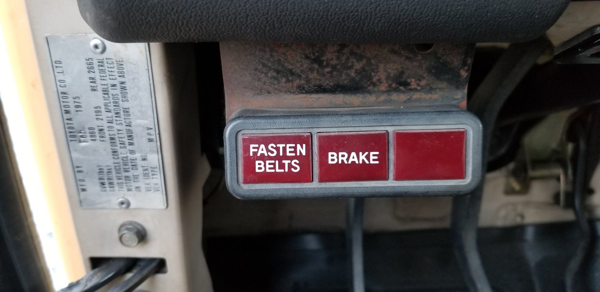

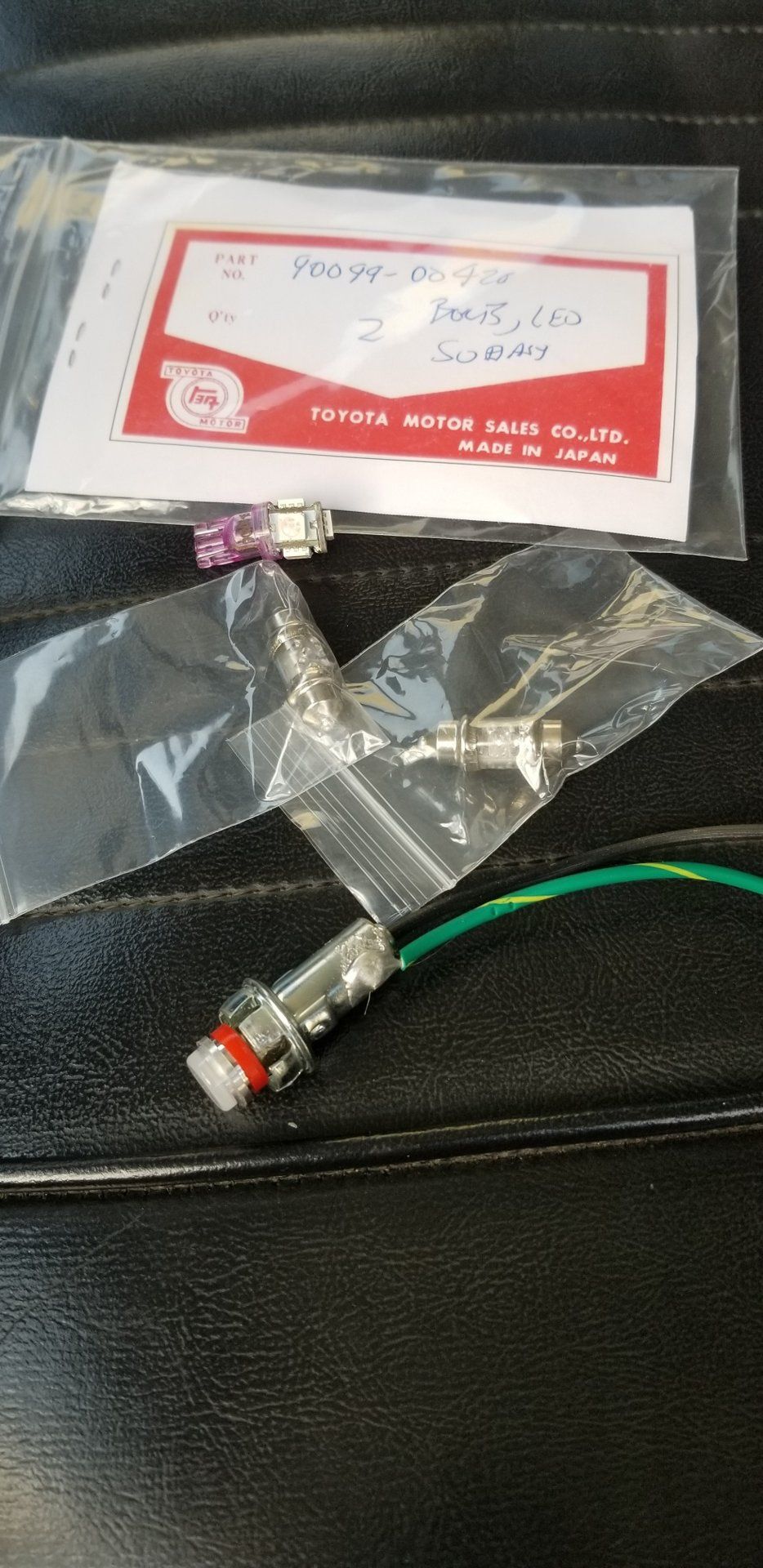

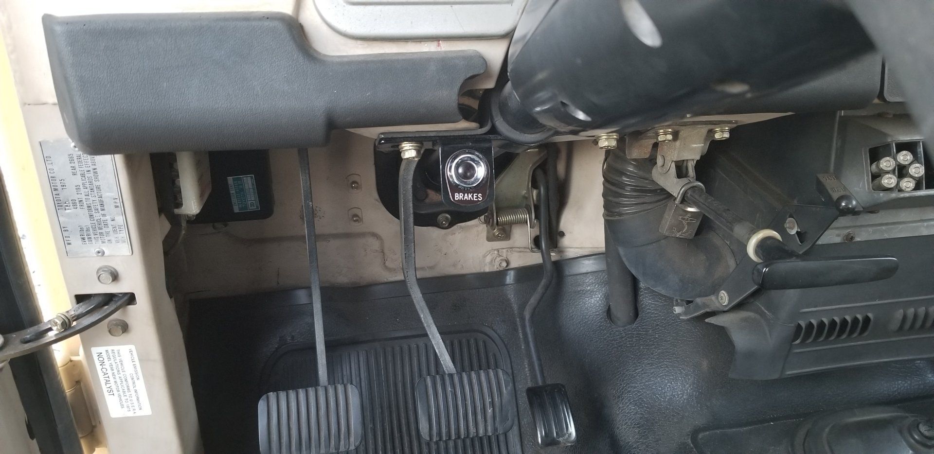

got some lights from toyotamatt and gave in to a little obsessive compulsiveness and started swapping stuff around on the dash of the '75 to get more of the "correctness" back, which stemmed from using a '77 wiring harness instead of the '75.
first order of business was to replace the '77 brake, erg, seat belt warning light array with a correct '75 brake warning/parking brake light ....albeit in the wrong spot....for now.
like most..if not all 40 series, the green lense for the dash knobs was removed long ago so that the ever so dim bulb even had a chance of providing any illumination on the knobs...well, apparently matt offers direct replacement green led bulbs, and they are pretty darn bright. i also orderd on for the heater control light, but my housing needs the ground wire reattached before that one will work again.
also ordered his super bright blue light for the high beam indicator light in the cluster. additionally he had a new switch for the parking brake light, once that arrives, hopefully tomorrow, i'll pull the cluster to swap that light, replace the erg light thats currently residing were the brake warning should be. i can then install the new bulb and holder for that light..using an led in that one as well. meanwhile the non-functional erg warning light will then take its rightful place to the lower left of the steering column were it should be.
Wow! That green light is a huge improvement! Definitely getting one of those, thanks!
