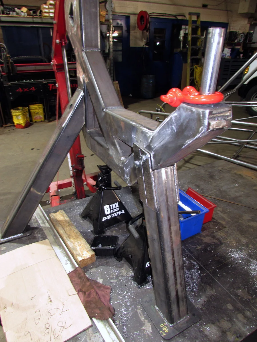

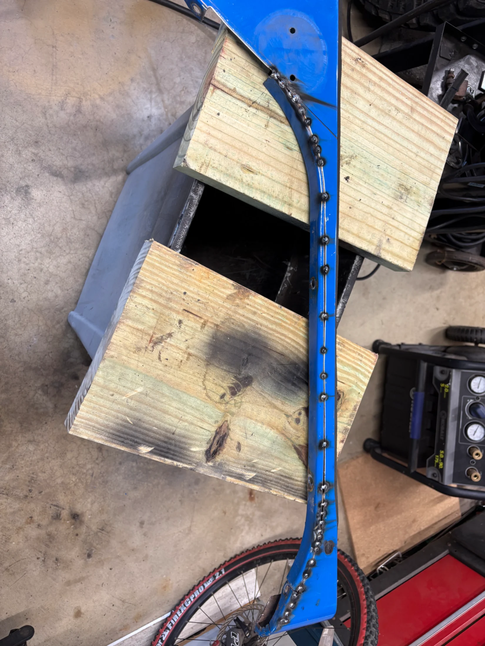

I have the bulk of the work done on the rear legs for the English Wheel. I wanted both the front leg and rear legs to be removable, because then the main frame of the English Wheel is mostly compact and flat, so it can be laid down for transport or stood against a wall for storage. However, with the weight of the assembly, I wanted something that could be easily aligned to get the legs on with a few hundred pounds of steel hanging in the air.
I moved the English Wheel onto the jig table so that I'd have a flat and level surface to work off of to make sure that everything was aligned. With everything aligned, I clamped the legs in place and drilled through from the pocketed holes in the legs through the body of the English Wheel and stuck bolts in the holes to hold things in place. I then drilled first a small hole through the rear gusset on the legs and into the body of the English Wheel and then with a hole saw cut a larger hole through the gusset. The bolts were removed, English Wheel suspended, and a larger hole was cut into the English Wheel body.
A 1.5" tube with an internal cap was aligned and welded into the English Wheel body and then ground smooth. A 1.25" tube was then aligned and welded to the gusset on the legs, both sides were capped, and ground smooth.
Now, with the English Wheel body suspended, the tube on the gusset (tenon) can be inserted into the tube on the body (mortise), which aligns everything to put the bolts in place without trying to wrestle several hundred odd pounds around for alignment.
The front leg has a similar joint and will have bolts through the gusset plates.

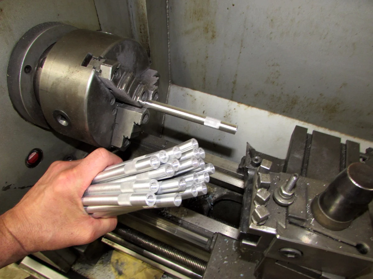

Production run... Drill each end; tap each end - one left hand threads, the other right hand threads; knurl the end with left hand threads; and polish everything up. They're rods for a body support kit for dune buggies with rod ends on either end.

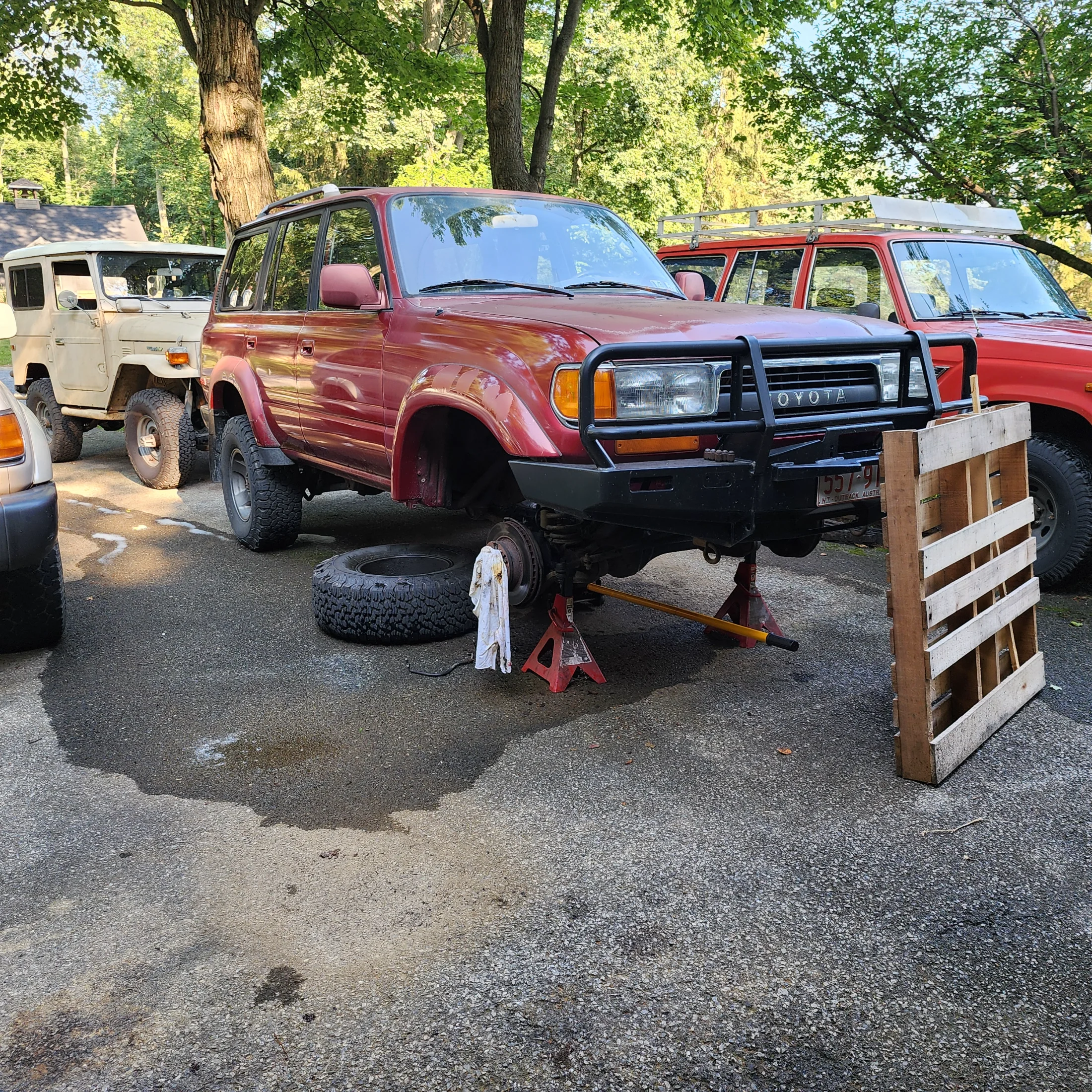

Gave it a wash this afternoon. But need to get brakes on the 94.....never have i had more of a problem with rusty brake lines than on 80 series....Friday made the 6th time I drove one home with a popped hard line.

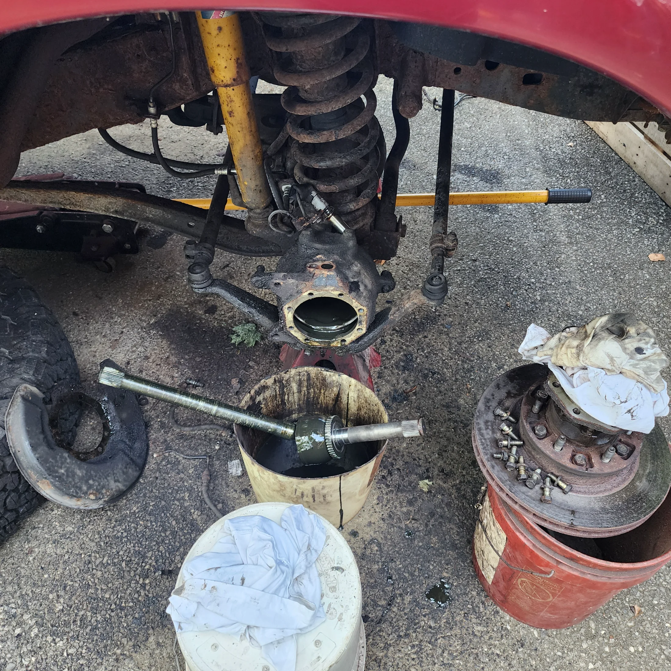

Ended up not having to run up to albany this afternoon, so onward with an inner axle seal on the rusty red rocket.
I finished up mounting the legs to the English Wheel. I have been a bit worried about making the legs detachable, but everything sits very solidly with things bolted together.
Now have to work on the adjuster assemblies for the top and bottom wheel and that will finish up the fabrication. The "post" on the bottom (with the shackle hooked on it) is just a placeholder while I was trying to judge how high I wanted the frame to sit.
The 94 is finally ready for inspection..only ran out in may, but more importantly I'm finally able to get to the 60.
I alway forget how nice it drives...pretty much every hose under the hood needs replaced at this point. It took a minute to get it fired, but it still purrs like singer sewing machine.
Very happy to have it out of the dirt and sitting on pavement.

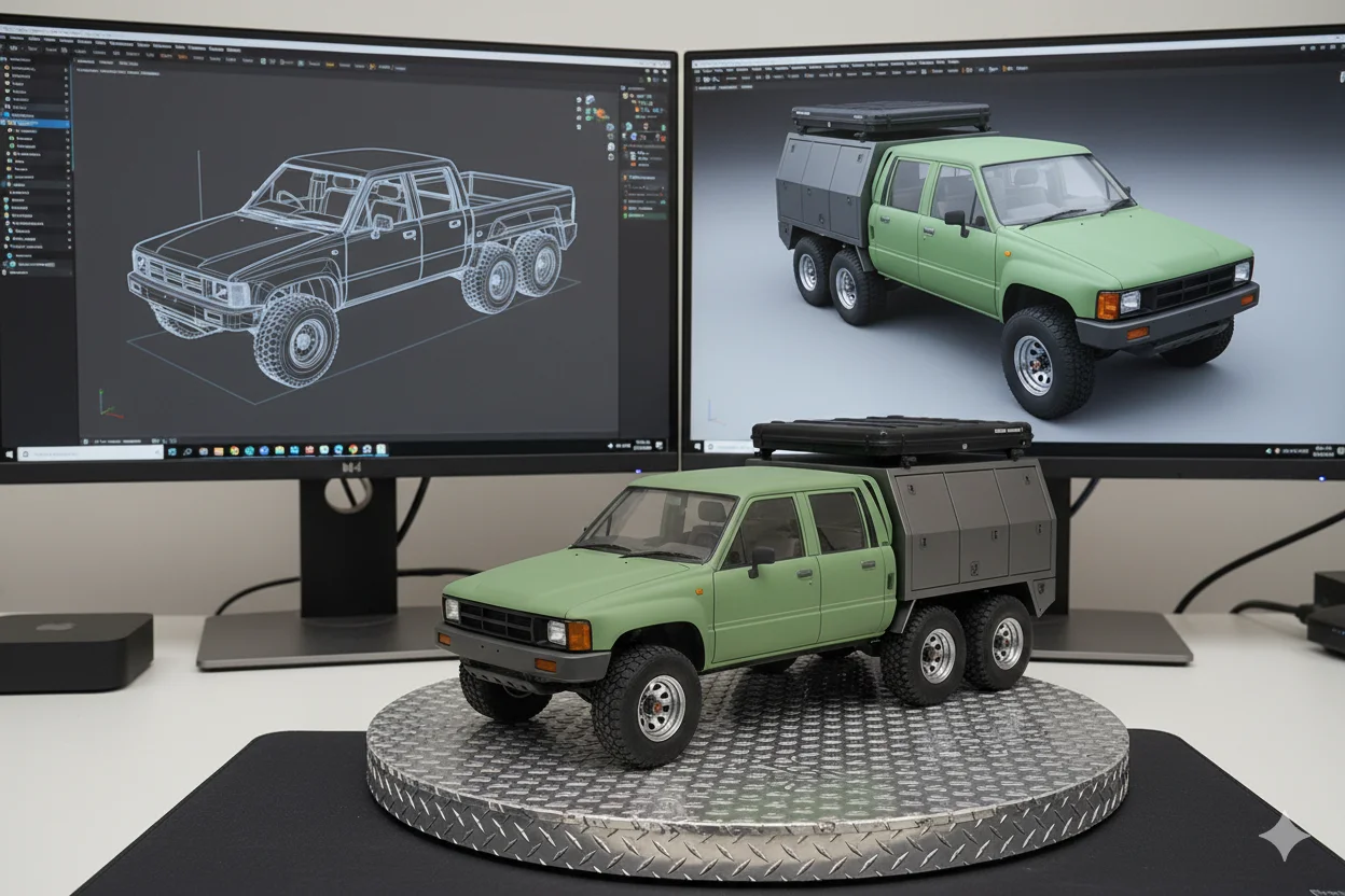

I've been playing around with Google Gemini. I had spent some time playing around with AI about a year and a half ago and just got frustrated because I could sorta get what I wanted, but not nearly close enough to be what I really wanted. It's a bit scary how far it has gotten in that time.
It got a little weird with the latches on the bed - and swapping from RHD to LHD between images.
But it gets interesting for building concept vehicles.
