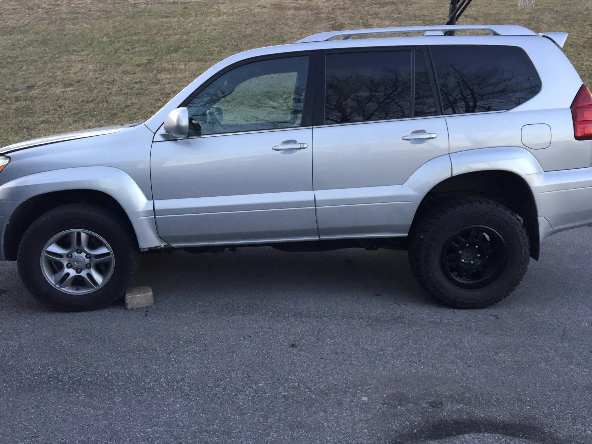

And Current State.

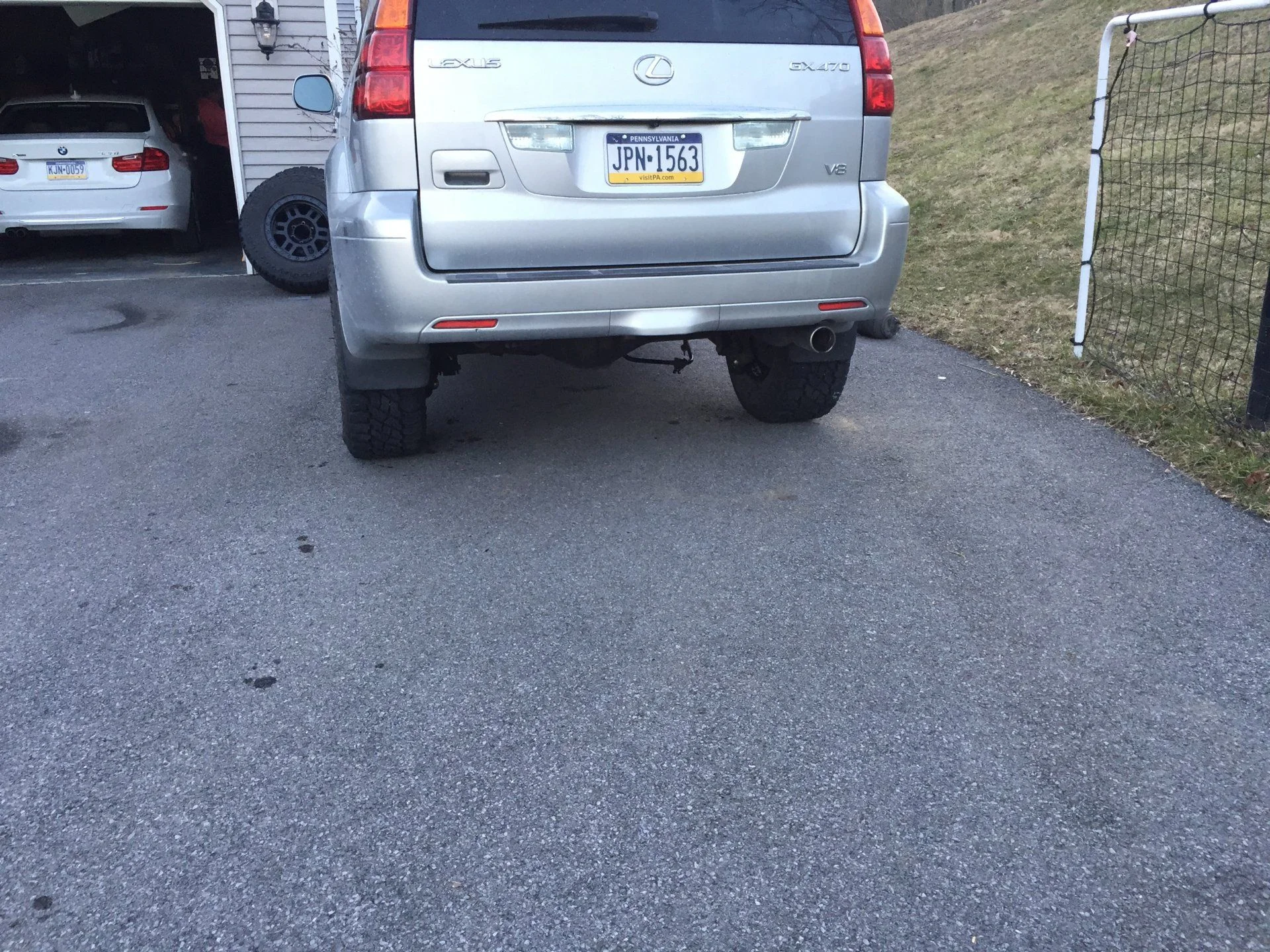

Took delivery over the weekend but was out of town. Finally had the opportunity to actually drive the truck today and really enjoyed it. The air suspension actually decided to work today and I was able to cycle through the adjustments but already have parts laying in the garage ready to go.
Spent the afternoon doing a thorough PB blaster treatment with more to follow before I start stripping the rig.

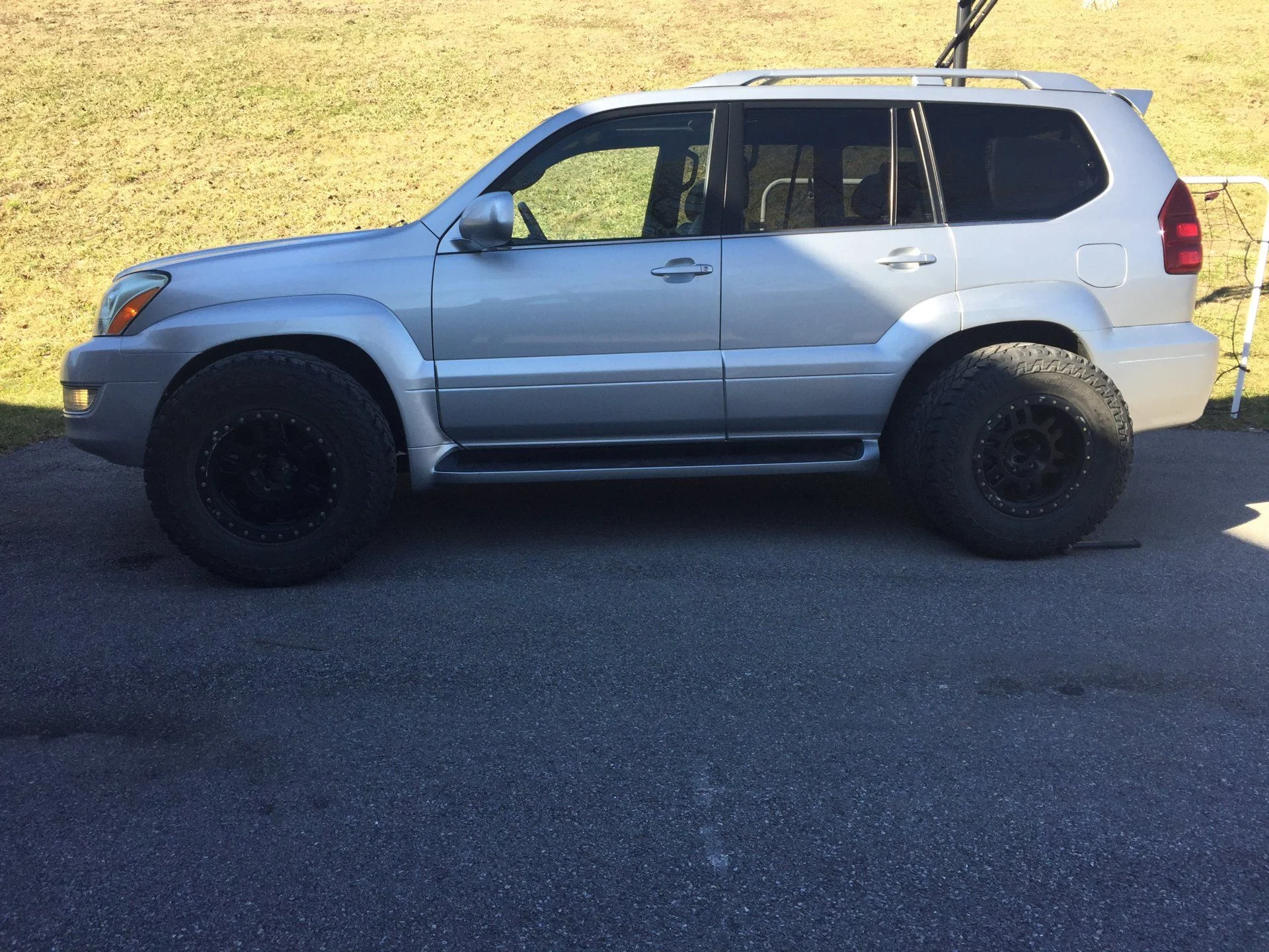

Rolled my wheels and tires over to get a visual. My driveway photoshop!

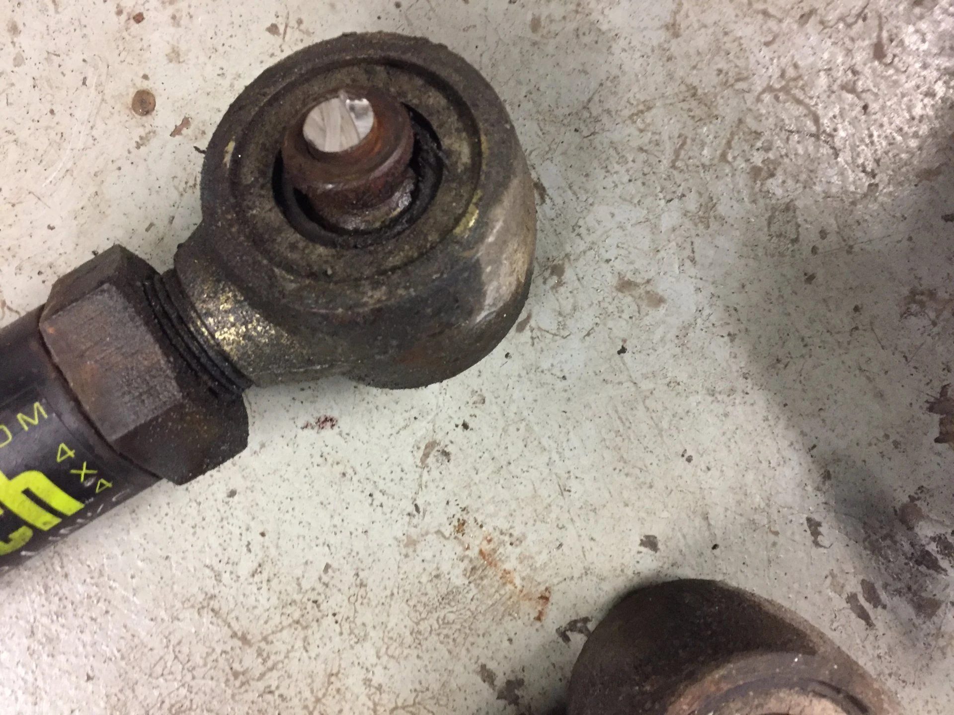

Thanks Mark but I do blame you guys for the switch!! No KDSS on this one. Was just on the phone with Jon today ordering the conversion kit and a few miscellaneous items that I didn’t take with me. Had a seized RLL bolt that decided to give me trouble and had to get heavy handed with it. The Johnny joint has seen better days now. That, some extended brake lines and bump stop and I should be back in business!

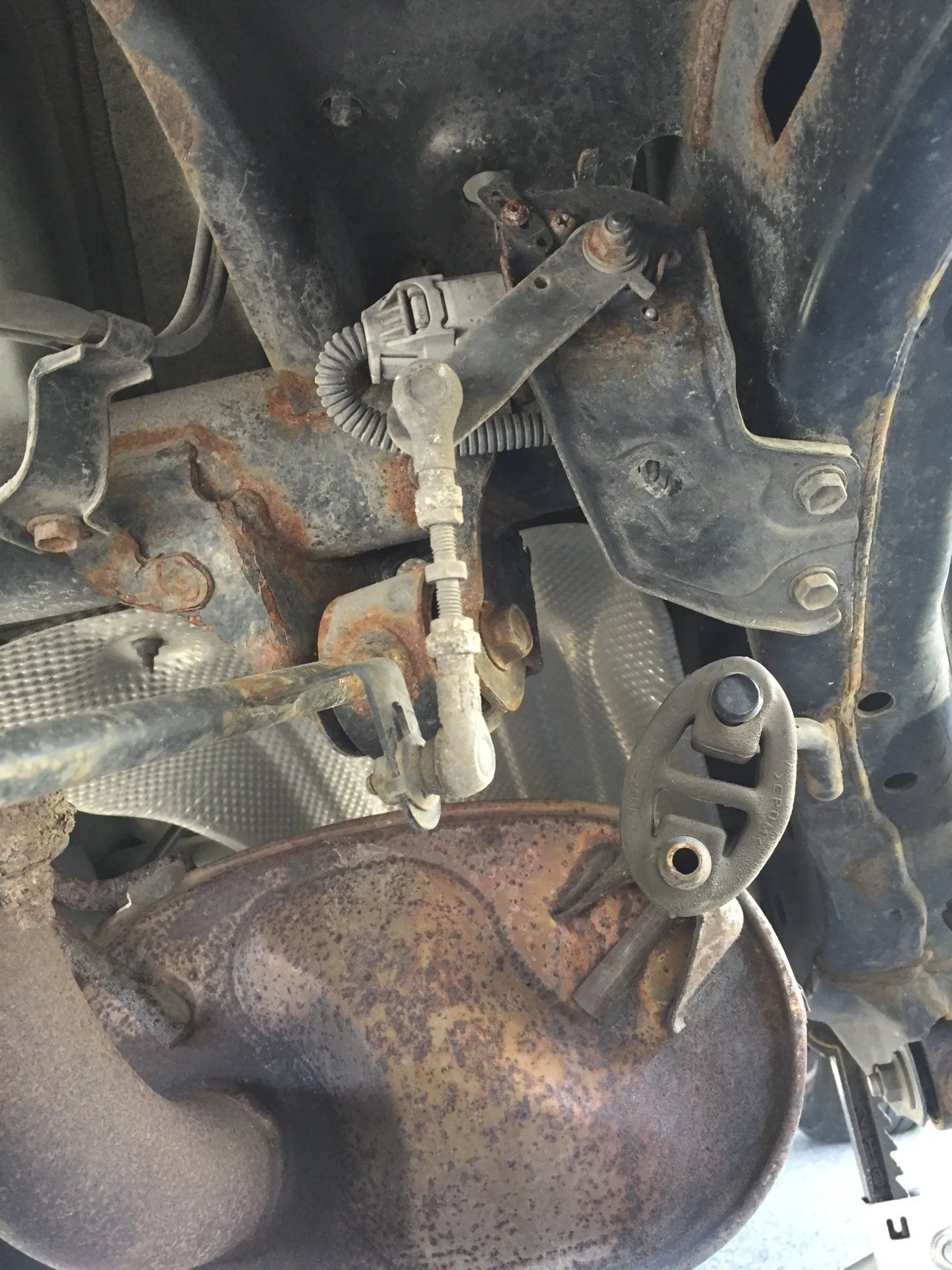

Can somebody answer what this is? I’m guessing something to do with the air ride?? Can’t see another purpose for it. If so, have most of you removed the hardware as it seems like it will be in the way and limit travel.
That is the ride height sensor. The "trick" is just changing the length. Think lspv for air ride.

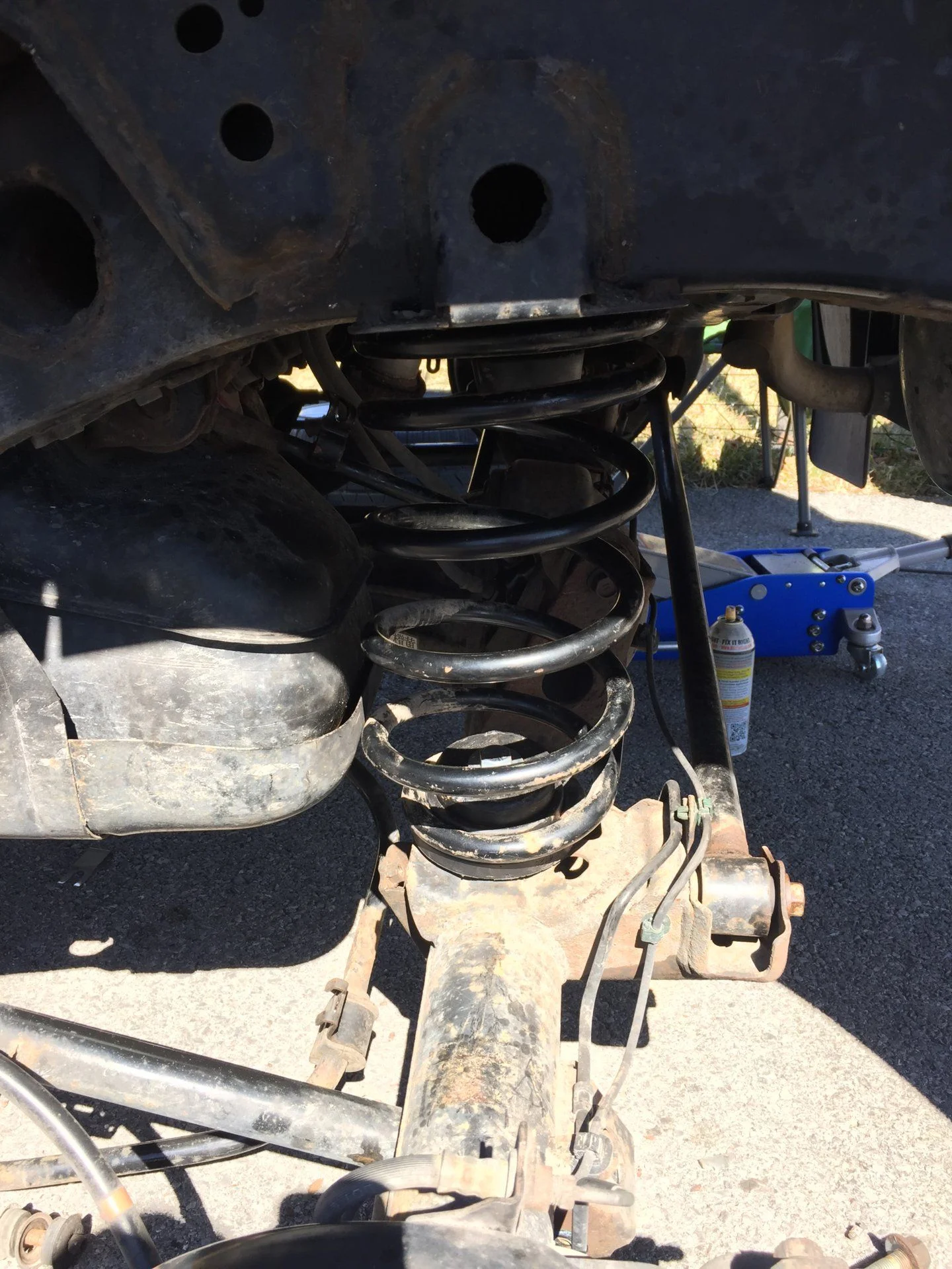

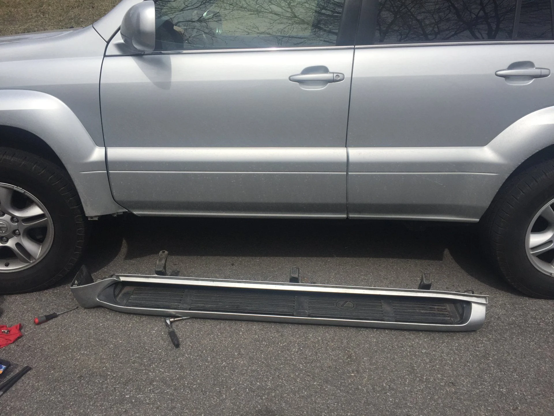

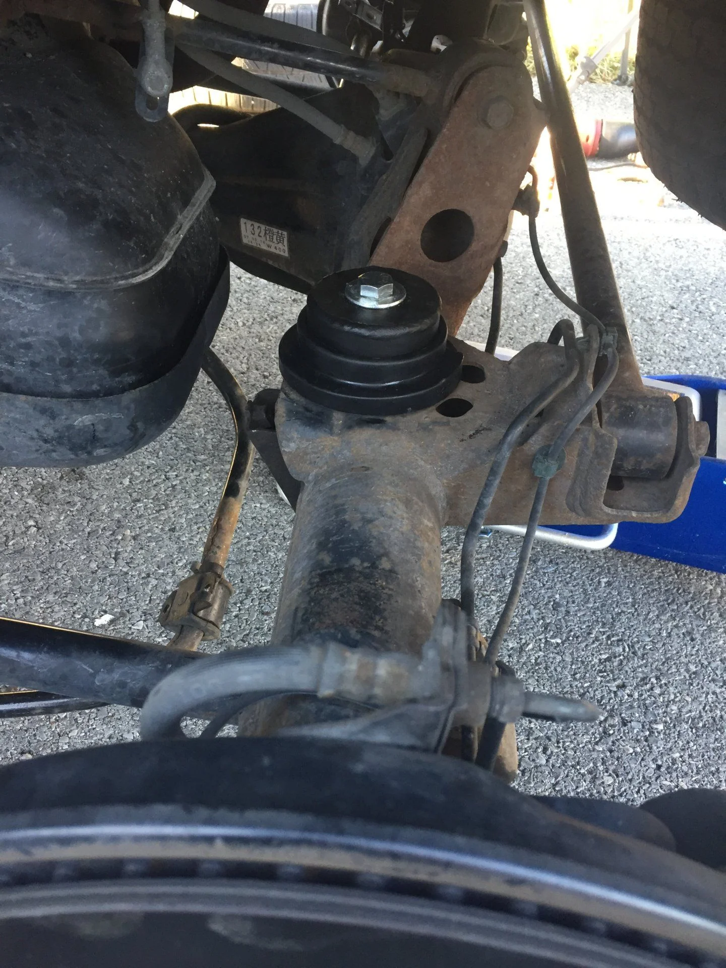

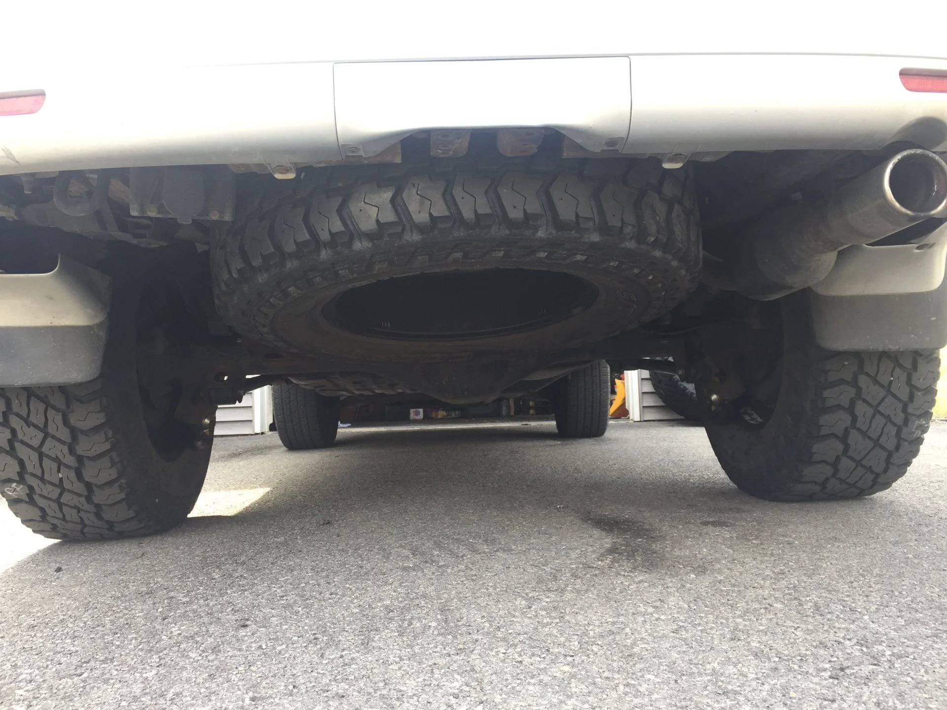

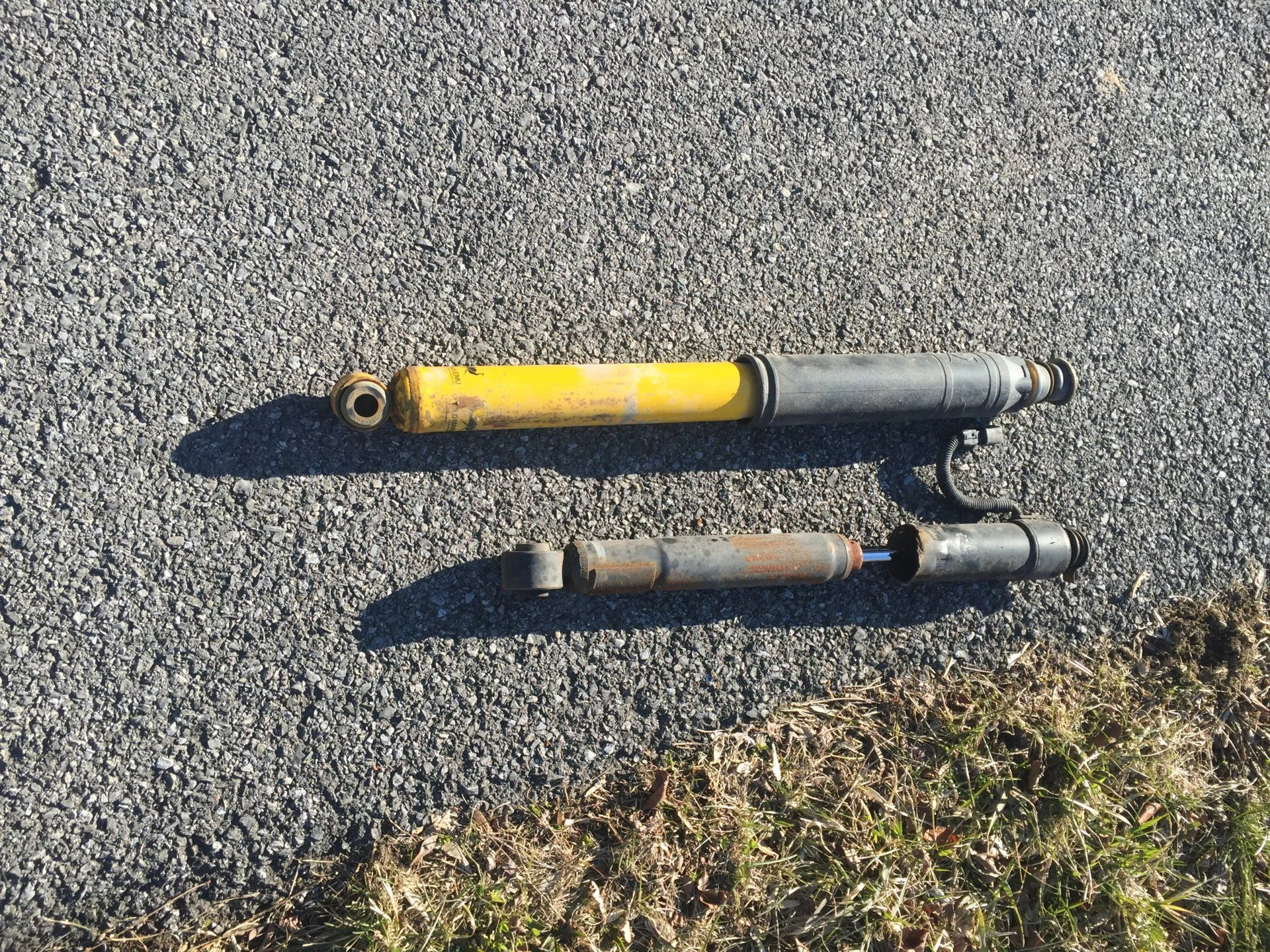

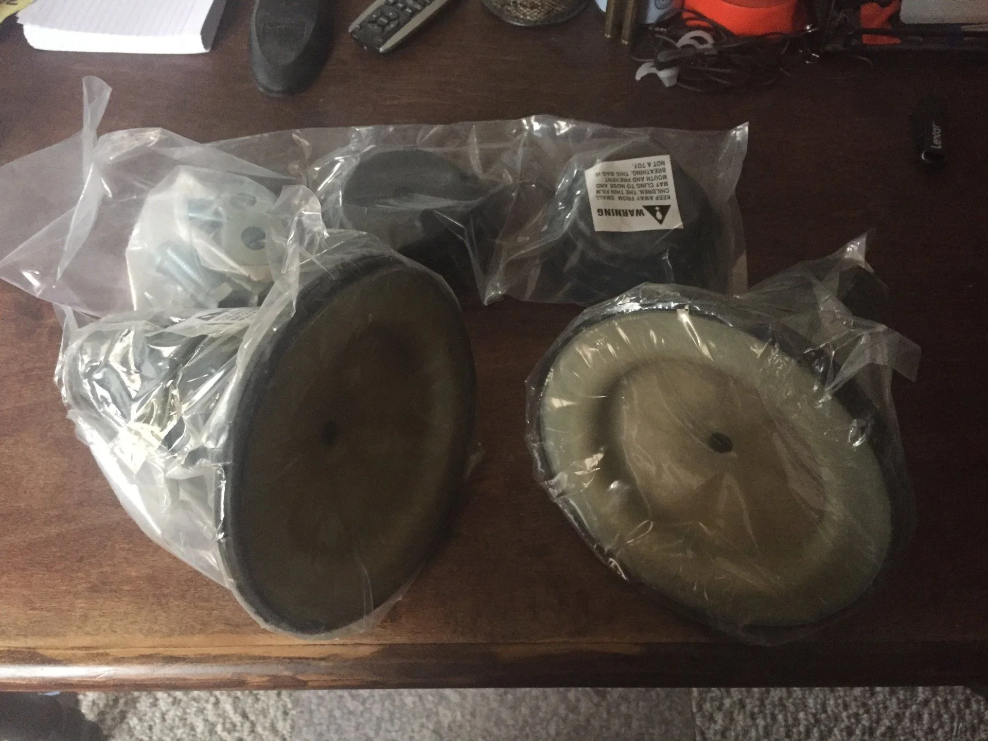

Ok good, thanks for the replies. It, along with the air lines and swaybar are gone. Had a tough time of it today... nothing decided to cooperate so all that was achieved was removal of the running boards, swapped out (cut out) the rear shocks, removed air bags and added my MT rear coils and bumpstop drop. Forgot how much of a joy that they are to stuff in there. The Metaltech coil conversion kit went smoothly but that was about it. Just getting over Bronchitis so I don’t think I had the strength or patience that was needed.
