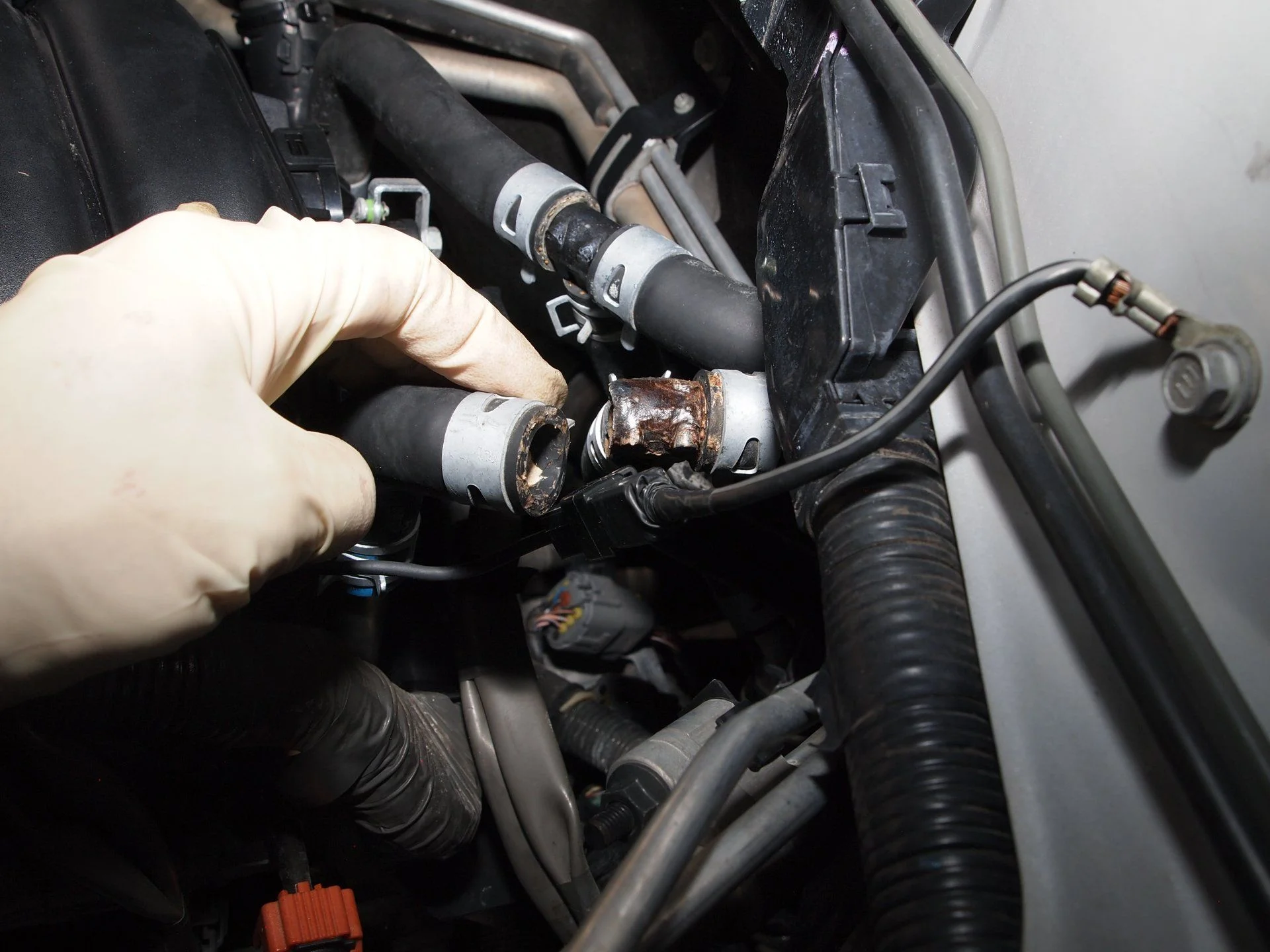

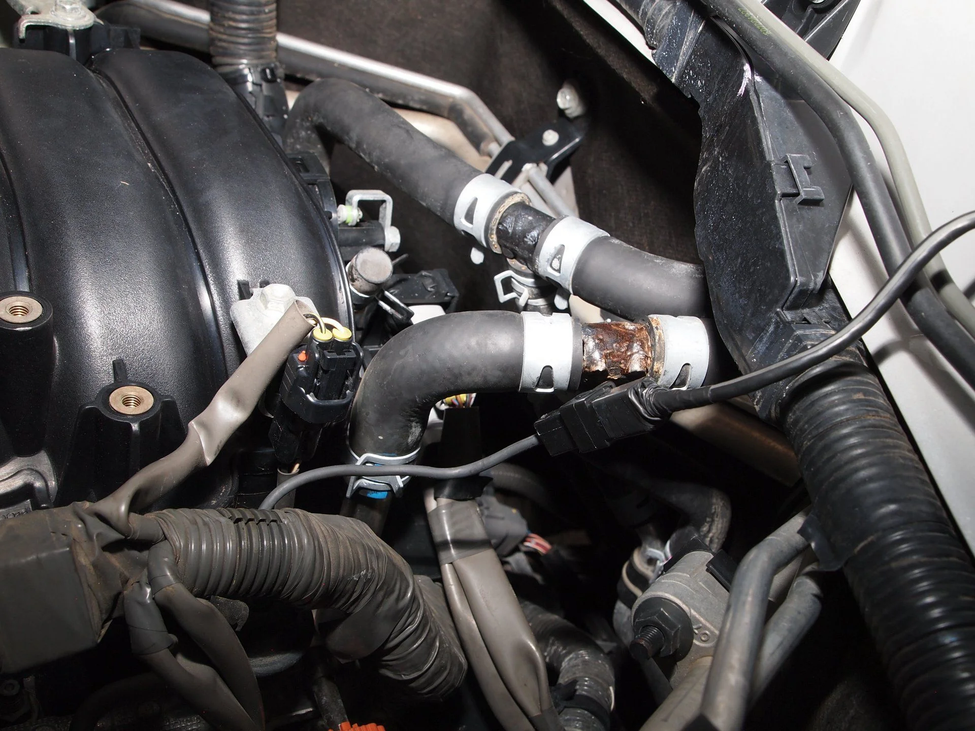

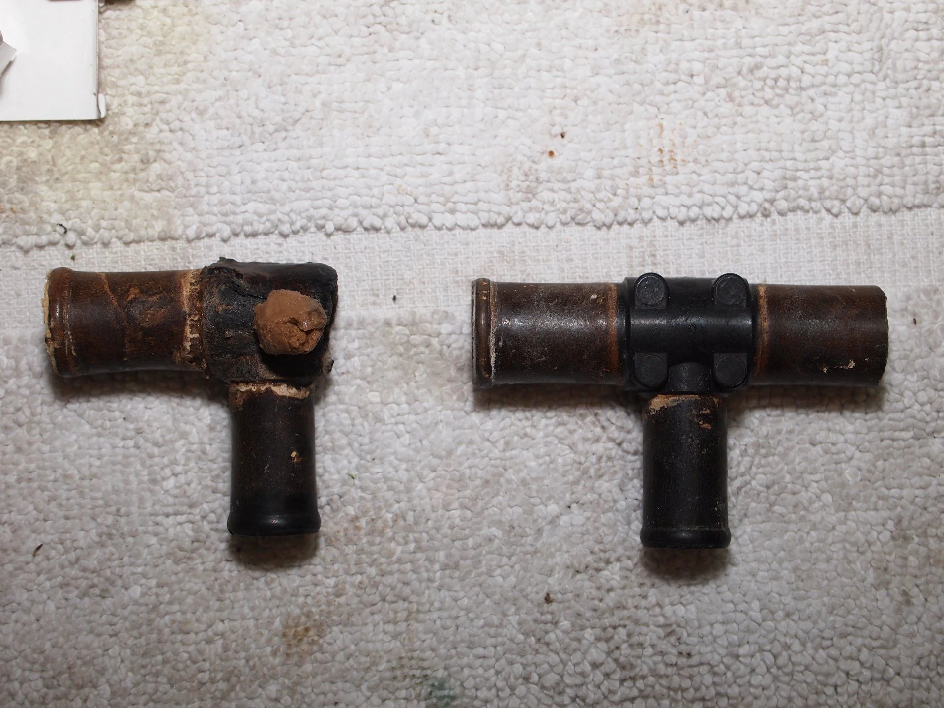

Heater Tee blew, combustion gas coming out the rear water by-pass joint water outlet hose.

Here the Tee's after I washed the engine:
Have you owned it for long? Mileage? It must have been driven for quite some distance to cook the head gasket(s) out of it...
Nope, just arrived. PO said; "stop as soon as knew something wrong". I just posted above pictures/video, as I knew people would wonder why I'm asking about engines. I'll say this; rig has low miles, was pampered and Toyota Dealership maintained "by the book" with history of coolant flush.

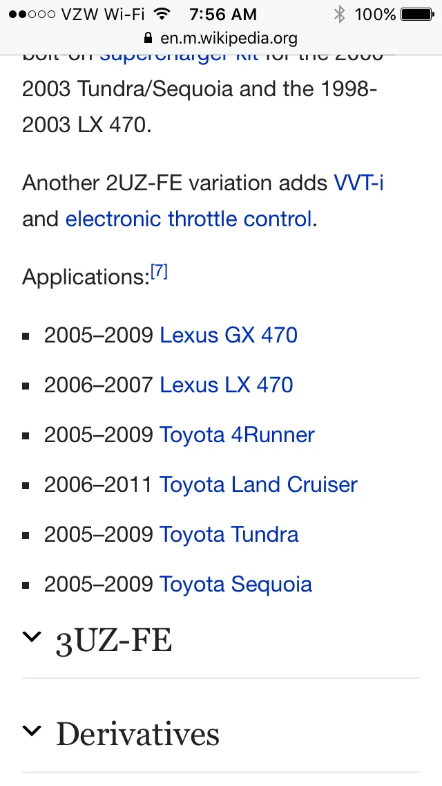

Here is a good start
Uz wiki
Toyota UZ engine - Wikipedia
Should be plenty of engines out there to choose from
Thanks, that's a good start.
I was thinking Lexus had a sedan 4 door with the 2UZ-fe VVti engine. Do you think this list is complete?
One thing I've read(i haven't confirmed for sure) is that there are US made 2UZ engines(maybe for tundra and sequoia) and the engine components are different- cast pistons vs forged pistons etc. You might look into that and stick with the imported platforms that have the Japan made 2UZ.
The list came from Wiki so prob worthy of verification through other sources.
