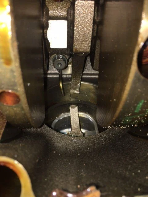

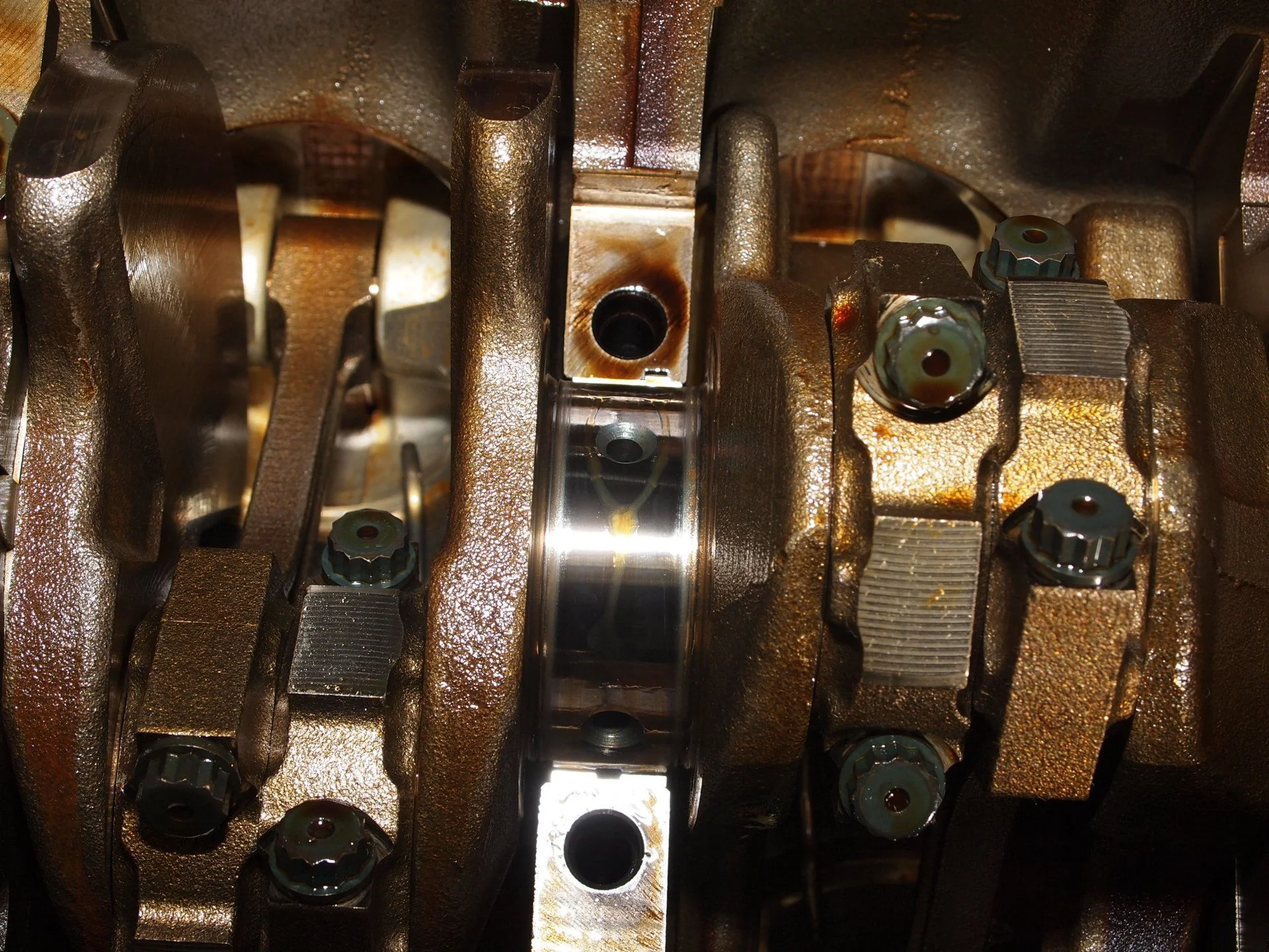

Hey fellas, In the effort to better understand our beloved 2uz's I thought I'd chime in with a 2005 VVT-I motor that I have in my shop at the moment, Tundra motor FYI...broke a rod, then got ripped out and a junkyard thrown in and I scooped up this one for some exploratory surgery...just getting started let me know if more info is desired...
seeing carnage is always cool, so here you go...
Very cool, thanks for posting. How did the bearings, wrist pin look, good or bad history of LOF any signs something contributed to failure?

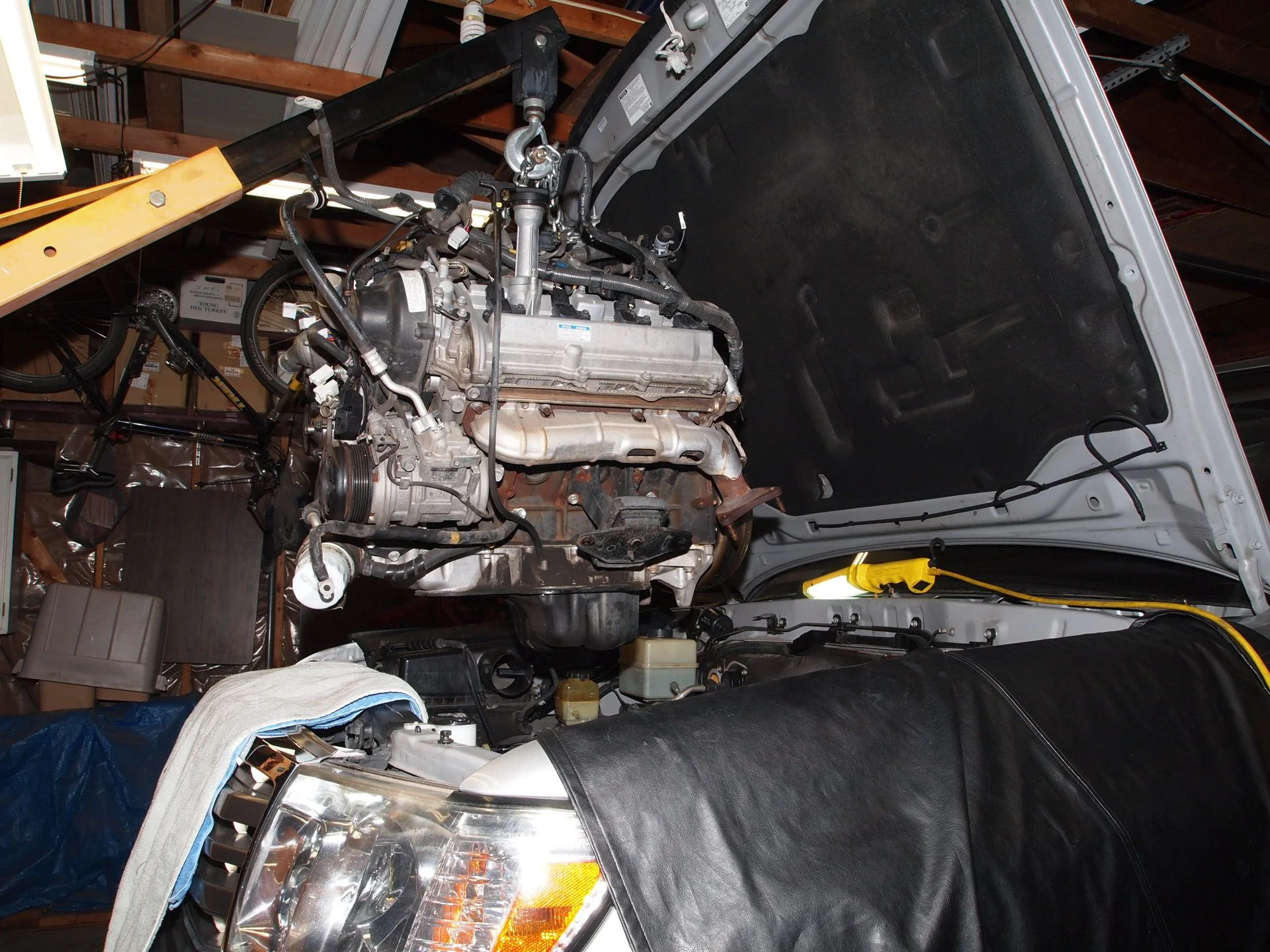

I pulled a 100 series VVti engine yesterday, took longer than I thought it would. Was going to pull pan, but just ran a little too late. I did this leaving the transmission behind in the rig. Do you do with or without transmission attached to engine?

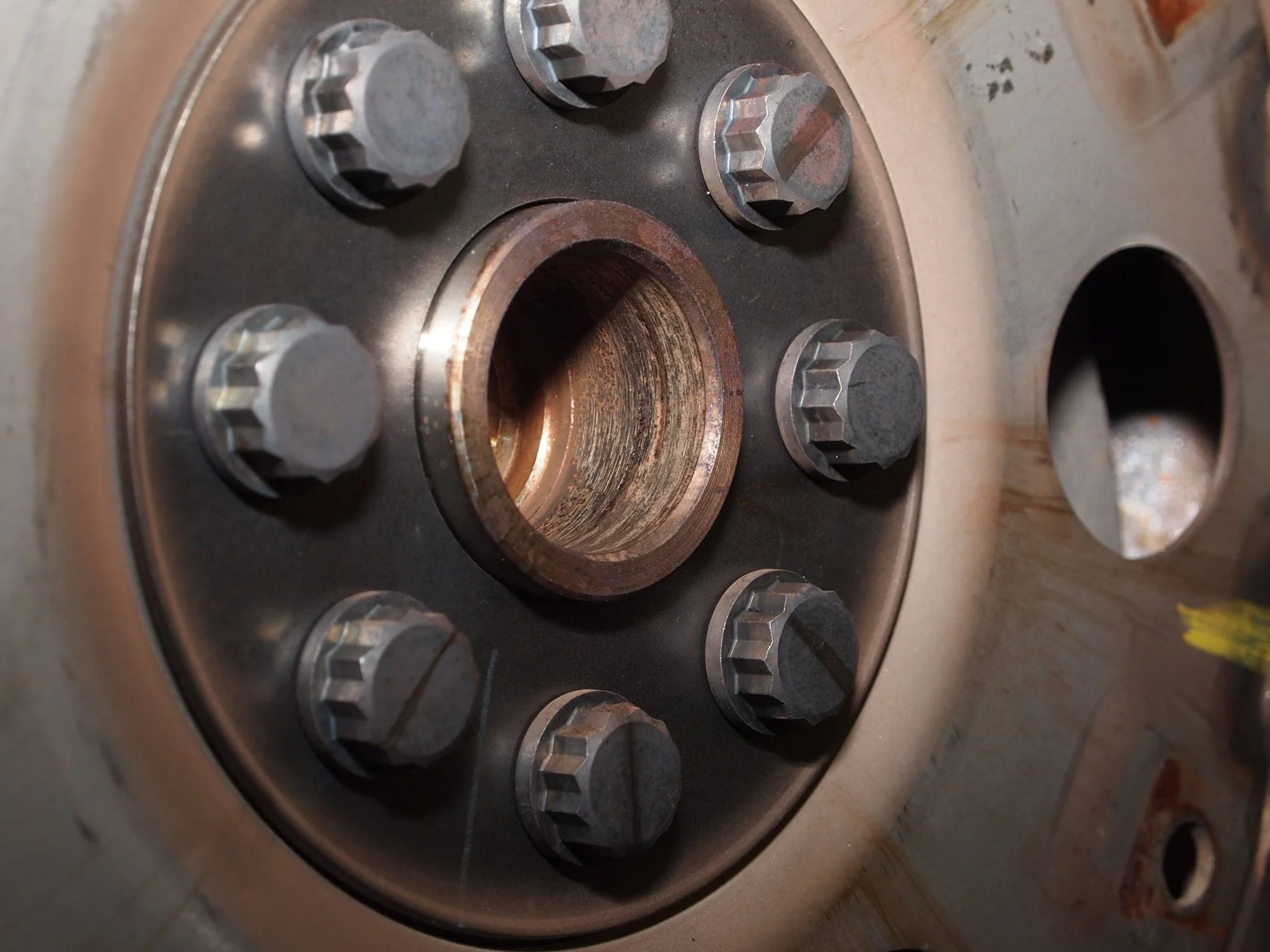

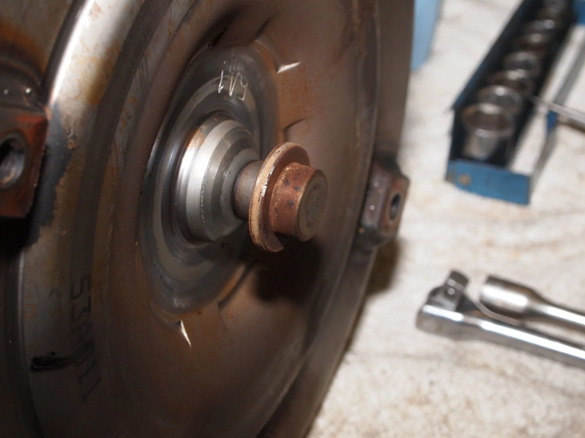

My darn torque convert was frozen on engine as it came out. I was concerned it would fall on floor, until I tried to pull off finding pilot near frozen/glued in crank. Good advise on procedure and the blue lock tight is very good idea, thanks. I'll be on my on during intestall and will make sure to not bolt up until seated, Thanks.

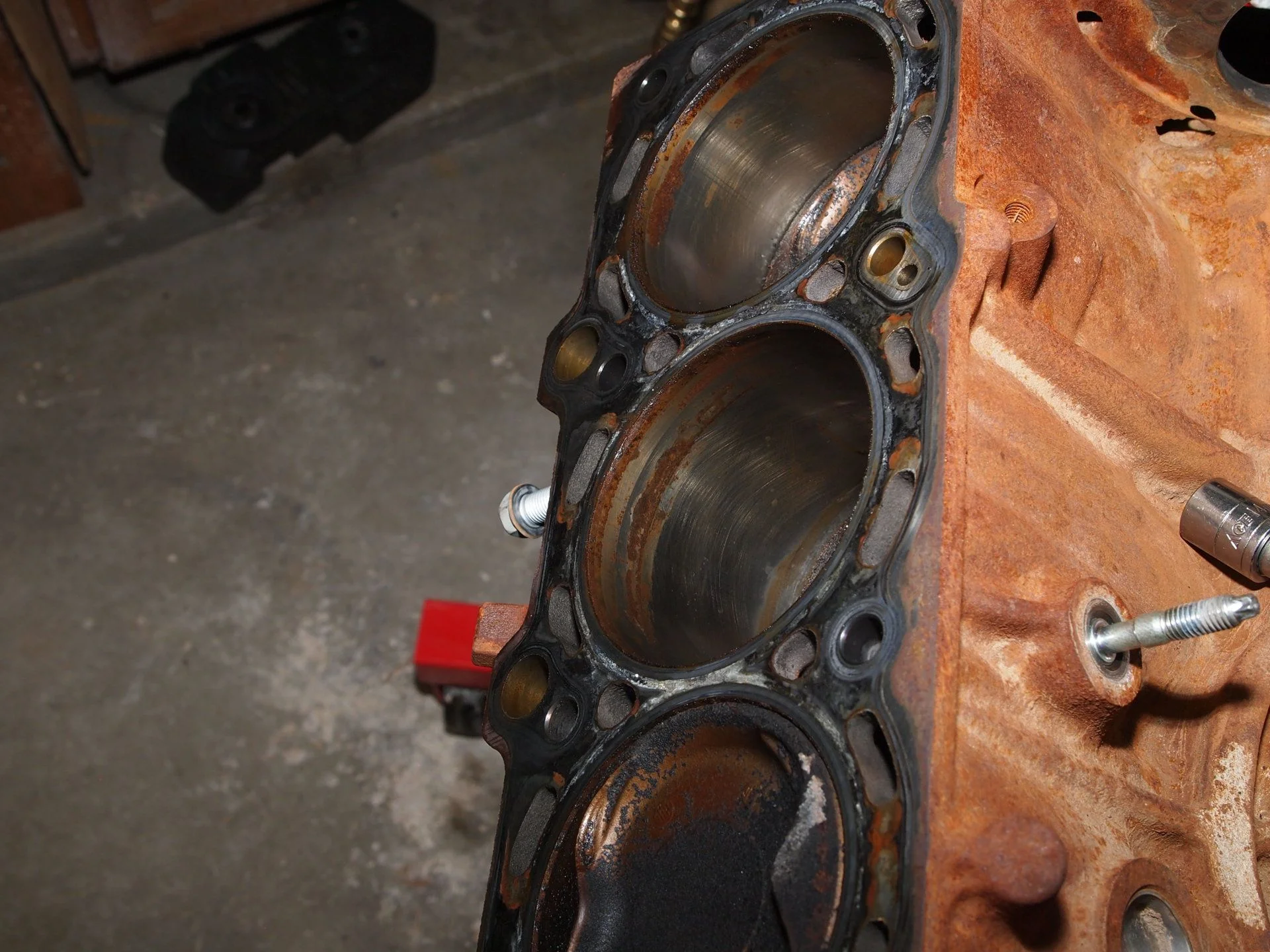

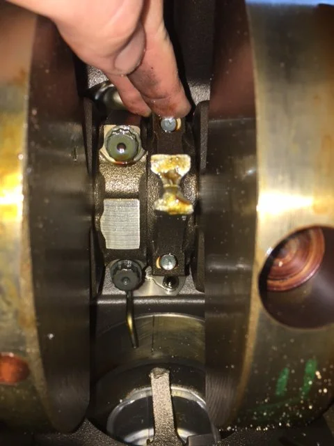

I bought a 08 w/131K 4.7L VVt 4Runner engine w/trany and all harness. Unfortunately I did not scope cylinders before buying. I think engine was washed after being left in the elements. Found minor rust pitting in two cylinders. It can be honed out but then my ring gap will be 9 to 12 thousand over where they are now. It parts (all broken down to short block) for me now taking up a lot of room.
So back to square one, with parts one engine and a whole engine just pulled take up my limited space.
