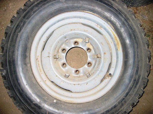

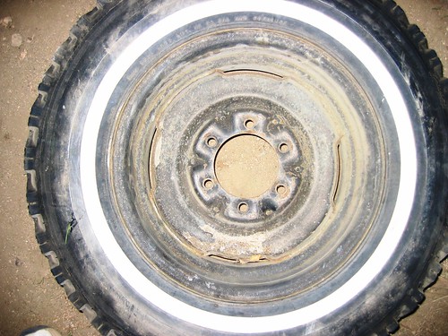

Well, here's some definitive proof from the pile of wheels I had buried in the build up of my house:
I did, however, also find a couple that were black on the inside and outside (both welded and riveted types) and one that was entirely gray. So, the verdict is still out. I'm gonna go black on the inside with a gray face.....like the pics above.
As that wheel was used for several models through the 70's and 80's and the color varied they were only painted on the face. The backs were still black.
Shane
That's what I figured AATLAS1X......I even have some that came on a '78 with this same style wheel, but painted cygnus white (not repaints, either). Looks pretty good as it ties it in with the roof cap and bezel, but I think I'll go gray since that's the way it would have come from the factory in '76.
