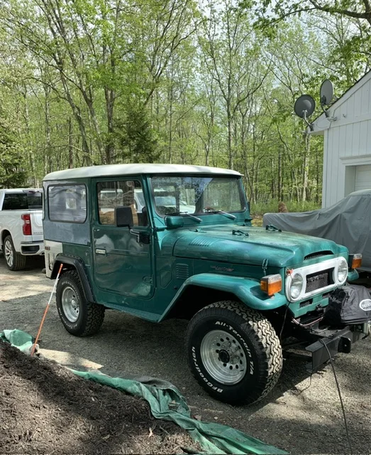

The spacers on my FJ40 disc brake conversion are 1/4” but the stock studs simply pass thru the spacer . Every thing then just bolts up as stock.
These are the wheels I have

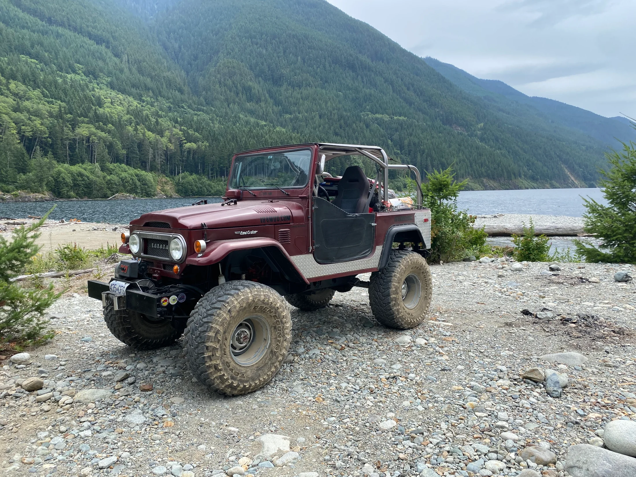

I opted to do both. In the past I ran 15x8 steel rims with a 4" backspace and used 1/4" spacers. I was also considering running aluminum mags with the same dimensions. The mounting surface was thicker than the steel wheels, so I installed longer studs too.
