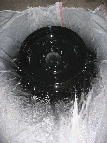

Now, I'm shooting the backs and sides semi-gloss black:
Of course, now they look pretty much like they did when they came in the mail! The Massey Ferguson Gray (for the wheel faces) will be in on Wednesday. I'll post pics of the finished product....

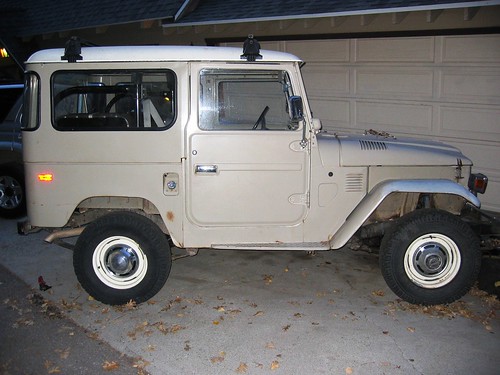

Here's my rig with the factory wheels in white (BTW, they are black on the sides and backs):
Two of them have date stamps of 2/80 and the other two are stamped 12/79. They came off a 1/78 truck that my dad bought used from a Toyota dealership. Like I said earlier, I like the way it ties the white roof cap and bezel together (but I still prefer the stock gray).

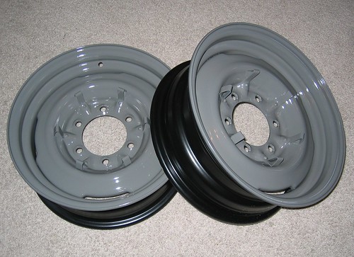

Just got the Massey Fergusson Gray spray paint yesterday ($8.49 per can....ouch). I'll be spraying over the next few days and will post up the finished product....
Two down, two to go:
First impression is that it looks darker than the stock color, but I haven't had them outside in the sun or compared them side-by-side to any of my other rims yet......we'll see.
Massey fergusen is browner than the stock color and lacks enough blue. I had some paint matched at my local paint shop tonight. It was the only true match I was able to obtain (after blowing a bunch of $$$ on other paints that were supposed to match!). It cost me a fortune but it's good stuff and it matches!

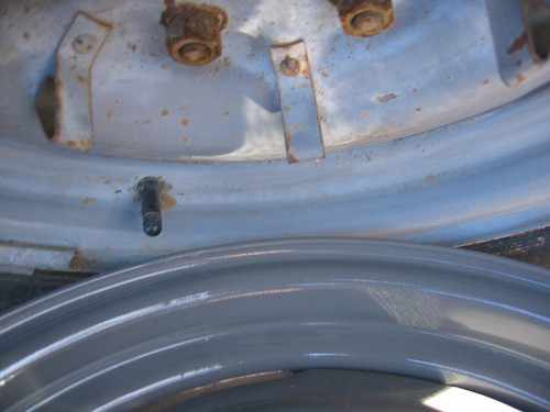

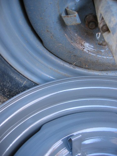

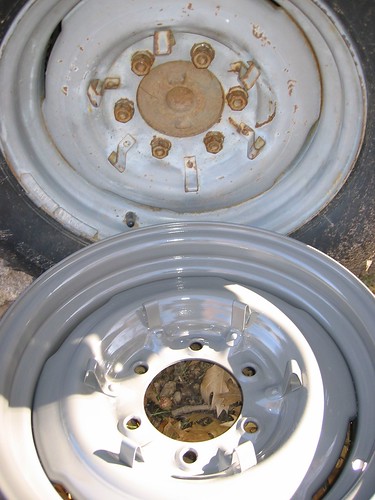

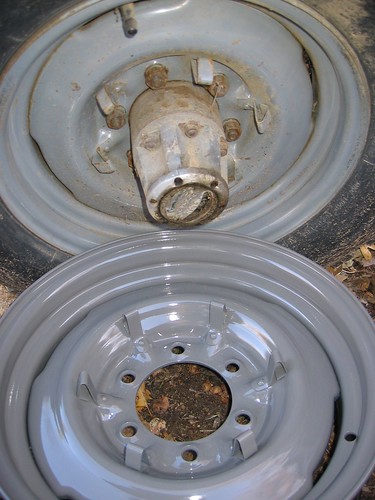

So, I took one of my completed rims out to the yard to compare to some other stock steelies on another truck.
This one is more weathered and faded:
and closer up:
The second one is almost spot-on.....less weathered and faded:
and closer up:
Compared to the first one, there's definitely not enough blue in it. I wonder what some rubbing compound would do if used on this one to get through the layers of oxidation....
The second one is pretty darned close....maybe just a touch less blue and/or a touch more brown. Honestly, it's close enough for me (and I'm pretty picky). :meh:
So, overall, I'm calling it good. What do you guys think?

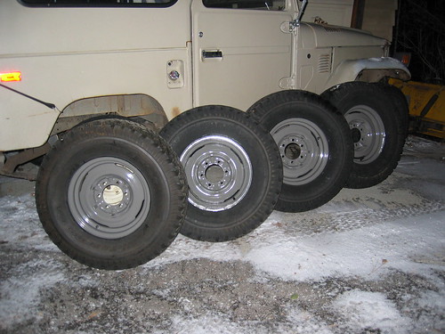

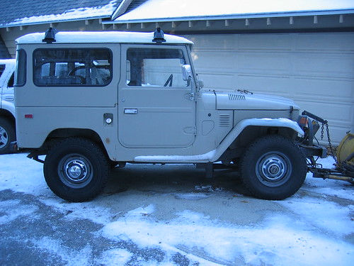

Finally got the tires mounted and balanced (31x10.5x15 BFG AT's) on the rims. It was about 20 degrees outside last night, but I was determined to get this project done. Here's the finished project:

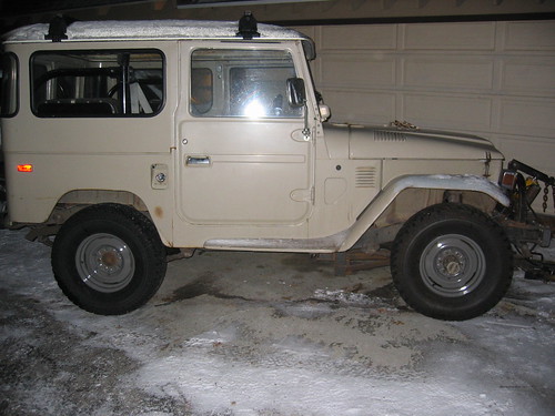

Here they are on the truck:
And here they are this morning complete with hub caps:
