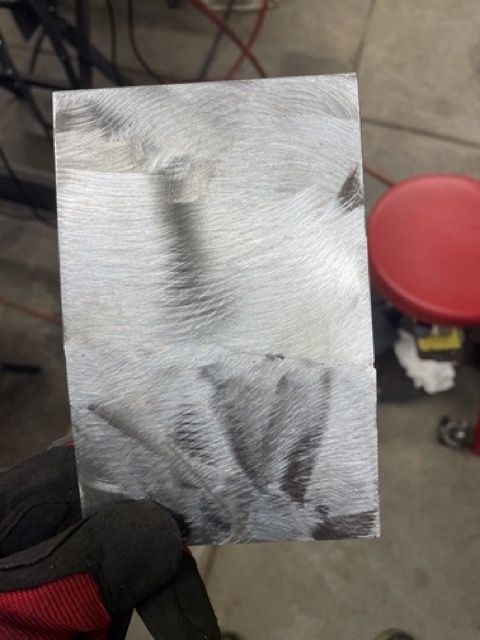

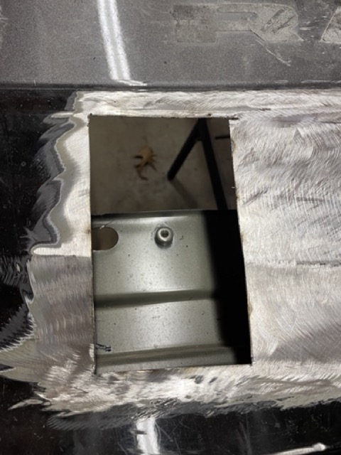

Update - I made the patch panel along the body line, welded it up (inside and out) and tacked it to the door. I bought a 0.040 cut-off blade that I was going to use to perform the cut-and-butt technique mentioned earlier. I didn't drill the corners like I should have.
The welding was fine. The fitting was fine. Oh my goodness, the cutting was AWFUL. I ended up having to just cut it all out and remake the patch. The new patch is larger, which is Ok for practice, but would not be ideal on the vehicle.
<sigh>. Keeping on practicing. Any advice of the dang cut-off wheel? I am thinking 4 1/2 wheel is a bit too big for this job?

Making the new patch was no big deal. I probably should use clecos and overlay the old piece while it is made. Then just cut the whole and massage the patch to fit.

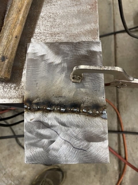

Top stitch-welded and sanded. Looks pretty good?

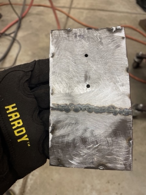

Decent amount of penetration.

I don't have any trouble with the thin .040" 4 1/2" cutting wheels on my Metabo angle grinder. If I need to get in a tight spot, I'll use a die grinder with a cut off wheel or even an air saw with a fine tooth blade. I have used my corded jig saw with a fine metal blade as well.
Try different methods and use whatever works best for you.
The back side of the weld seam will look like another bead when it is completely fused.
As mentioned, there shouldn't be the black soot. Lack of shielding gas for whatever reason. A breeze, wrong flow setting, wrong nozzle.

Thanks. There is a breeze. I had AC installed in my garage and it is blowing pretty good. Maybe will turn it down.

So I should stay on the trigger longer? I was blowing holes earlier and backed off a bit.
Well I guess not if you were blowing holes through. I can just judge by the pic as best as I can. It just looks a bit cold to me anyway. If it was me on my machine I would either change the settings or a little bit more on time. In your case you said it burned a hole so I guess I'd play with the settings.
You're very motivated and trying hard so I have no doubt that you'll find your ideal setting/technique.
