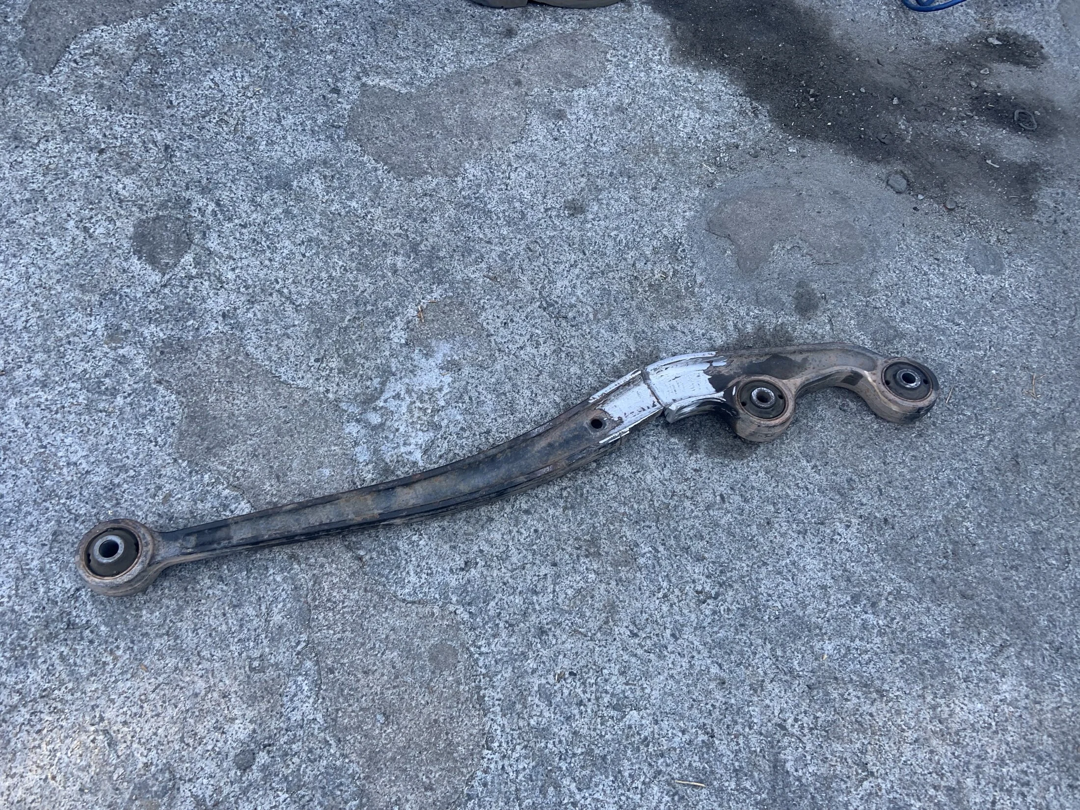

You start talking about grinding on radius arms and I get flashbacks of the time we we on Rubicon and had to repair a snapped radius arm which had been compromised by too much grinding action.

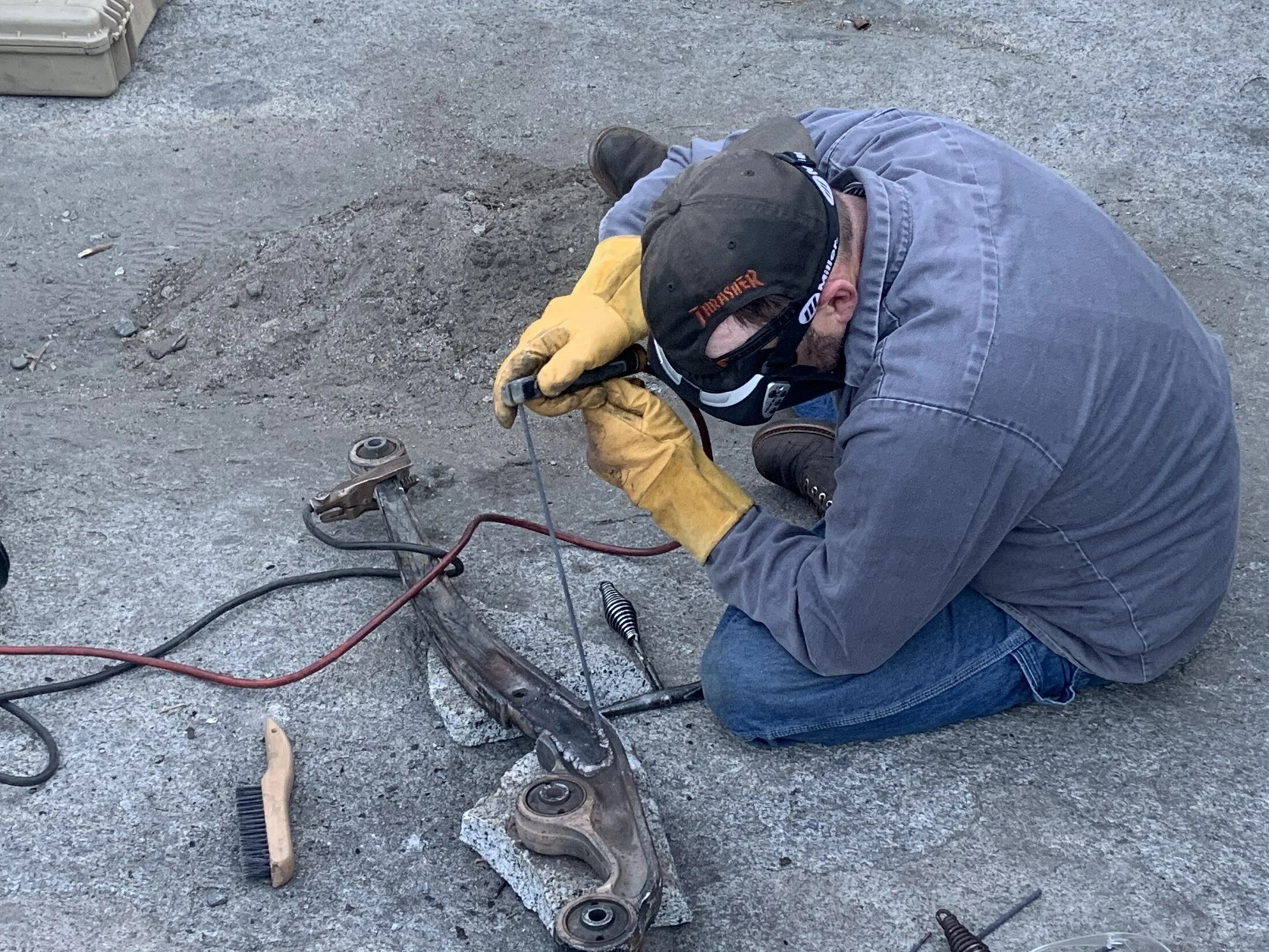

If that's the case, here's a little trick i learned a long time ago that you can use to remove that ring with no need for a saws all,
If you have access to a stick, mig, or Tig welder just weld a bead about an inch long on the inside of that metal ring, once the weld cools it will shrink that ring just enought and it will push/slide right out of the radius arm bore,
This trick also works to remove pressed in bearing shells/races in blind bores that you have no way of pressing, or pulling out of the bore,
